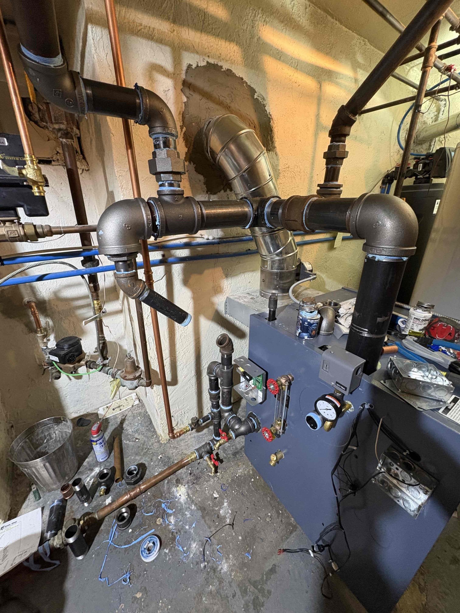

Equalizer
Would this be an issue to pipe this boiler like this with the equalizer on a 45.

    No — that will work fine. I'm not wild about a 90 degree bend in the header, but if there is enough pitch it should be OK.

    Why didn't you just pipe the equalizer on the other side of the boiler? or use the other riser coming out of the boiler to make the piping a little cleaner?

    why the 90 degree dislike? It gives any water droplets another wall to slam into, no?
    I like the equalizer too fwiw

    Nothing wrong with the 45 in the equalizer as long as the pipe size meets the min. mfg. requirement. I'm more concerned about the 1st main takeoff from the header. It shouldn't be horizontal. Either 45 from or fully vertical.

    I don't mind the 90. it makes for a great chin up bar!

    @Captain Who i think that's a coupling. you can see the horizontal line in the fitting. I was thinking the same until i saw the line.

    Would they void the warranty if the boiler is piped like this?
    ethicalpaul Member Posts: 8,578
    I don’t see anything that would void the warranty. What are you referring to?

    Can you show a pic off the right-hand riser connects too? I agree the fitting on the header looks like a coupling instead of a tee.
    Other than that riser everything looks ok

    Is that a Tee at the Yellow arrow ? If not where does the pipe at the Orange arrow go ?

    I dislike the bushings. They make reducing 90s that most manufacturers prefer. Also reducing from 3 to 1 1/2 at the end of the header? Rule of thumb, although probably not actually necessary, is only reducing 1 pipe size from header to equalizer.

    I am also not a fan of the bushings. But not such a big deal. That rule about reducing one pipe size is really counterintuitive and I don't agree. And neither do any of the boiler manufacturers. The larger the header, the less condensate you'll have, because velocity is reduced. So if anything, the bigger headers, should get smaller equalizers. But in reality, the only driving factor is really the boiler size.

    Bushings seem to get a lot of dislike in general.
    Like all of those who say you cannot use them on gas piping. The only note I've seen is cast iron bushings shall not be used. The rest are fine along with street fittings, except some areas don't allow them in concealed locations.
    I am curious what that other pipe coming down in the backround is though. Looks like it's about 1 1/2" or 2" with a union?

    The issue with bushings, is that in theory , and in practice, they can create a water dam. Reducing elbow, would give you better flow. But not a big deal, in strait vertical application.

    Again, I think you need to check the manual to make sure that equalizer is not smaller than the minimum recommended by the manufacturer.
    What is the Boiler model and size?
