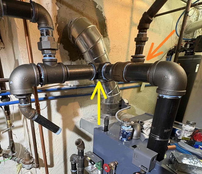

Would this be an issue to pipe this boiler like this with the equalizer on a 45.

    No — that will work fine. I'm not wild about a 90 degree bend in the header, but if there is enough pitch it should be OK.

    Why didn't you just pipe the equalizer on the other side of the boiler? or use the other riser coming out of the boiler to make the piping a little cleaner?

  • Nothing wrong with the 45 in the equalizer as long as the pipe size meets the min. mfg. requirement. I'm more concerned about the 1st main takeoff from the header. It shouldn't be horizontal. Either 45 from or fully vertical.

    @Captain Who i think that's a coupling. you can see the horizontal line in the fitting. I was thinking the same until i saw the line.

    Can you show a pic off the right-hand riser connects too? I agree the fitting on the header looks like a coupling instead of a tee.
    Other than that riser everything looks ok
    109A_5 Posts: 4,759
    edited February 17
    Is that a Tee at the Yellow arrow ? If not where does the pipe at the Orange arrow go ?

    Here is the illustration from the manual on the left and I have made your piping arrangement on the right. I do not believe that your main rizer on the right side should be connected the way you did it. Red piping is not a good design.
    Captain WhoCLamb
  • SMH. We need a sticky to tell people to give a few different view angles when submitting a photo. I didn't realize that was a Tee. A bullheaded Tee is a disaster in steam piping, when the steam flows in the other direction that it does here because it generates wet steam. In this case it is almost like another equalizer would be needed because you don't want the end of the header to be an elbow up into the main.

    i'm not sure if that is a tee or if the tee is to the right of it and the tee happens to have a casting ridge in the bottom of it.
    EdTheHeaterMan Posts: 12,946
    edited February 17
    It is a Tee
    here is what I see behind that 3" header coming off of the riser.
    What I see coming off of the 3" riser is from left to right: Yellow arrow is pointing to a 3" TEE < 3" pipe nipple < 3" coupling < 3" pipe nipple < 3" 90° elbow ^ 3" riser out of the boiler. The Tee in the header puts the steam in two directions ← → to get to to the different main risers. Not a good design!
    Here is the same photo with the hidden pipe covered by the header:
