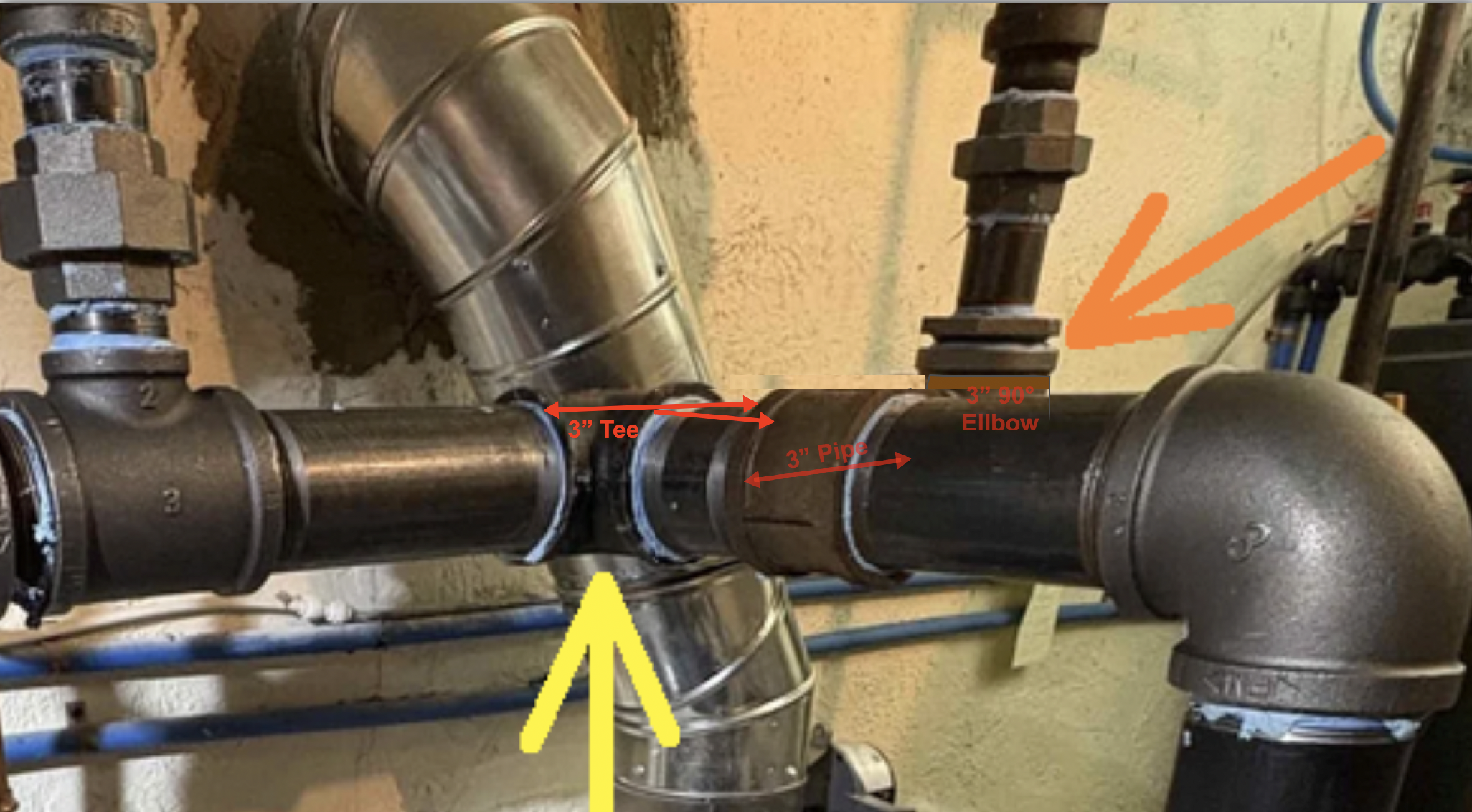

Would this be an issue to pipe this boiler like this with the equalizer on a 45.
    Jamie Hall Member Posts: 27,167
    No — that will work fine. I'm not wild about a 90 degree bend in the header, but if there is enough pitch it should be OK.

    EBEBRATT-Ed Member Posts: 20,018
    Can you show a pic off the right-hand riser connects too? I agree the fitting on the header looks like a coupling instead of a tee.
    Other than that riser everything looks ok
    109A_5 Member Posts: 3,823
    edited 6:37AM
    Is that a Tee at the Yellow arrow ? If not where does the pipe at the Orange arrow go ?

    mattmia2 Member Posts: 16,295
    i'm not sure if that is a tee or if the tee is to the right of it and the tee happens to have a casting ridge in the bottom of it.
    EdTheHeaterMan Member Posts: 11,927
    edited 7:05PM
    It is a Tee

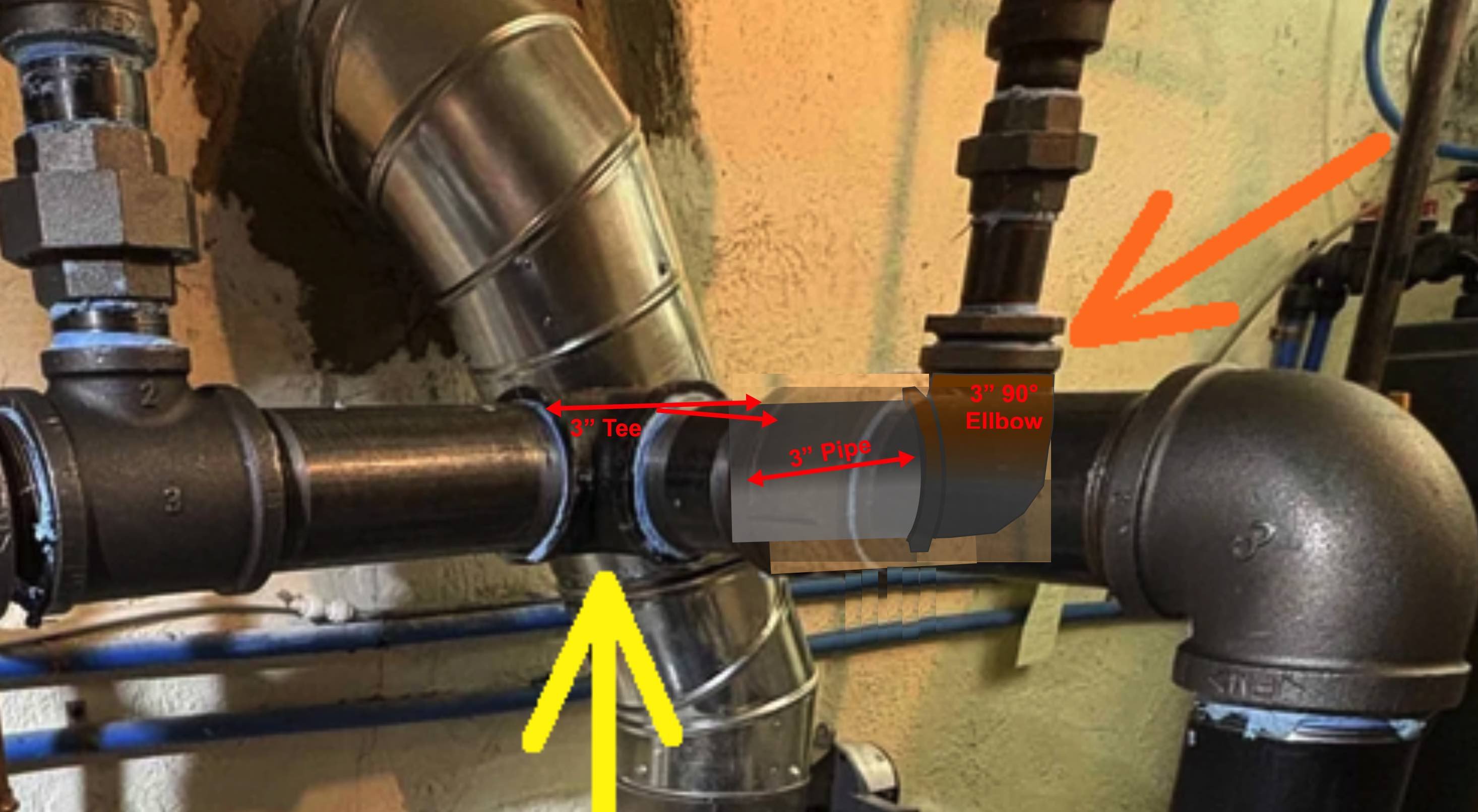

    here is what I see behind that 3" header coming off of the riser.
    What I see coming off of the 3" riser is from left to right: Yellow arrow is pointing to a 3" TEE < 3" pipe nipple < 3" coupling < 3" pipe nipple < 3" 90° elbow ^ 3" riser out of the boiler. The Tee in the header puts the steam in two directions ← → to get to to the different main risers. Not a good design!
    Here is the same photo with the hidden pipe covered by the header:
