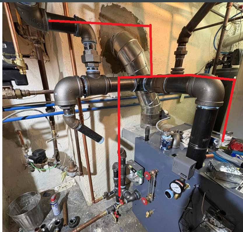

Would this be an issue to pipe this boiler like this with the equalizer on a 45.
«1
    Jamie Hall Member Posts: 27,599
    No — that will work fine. I'm not wild about a 90 degree bend in the header, but if there is enough pitch it should be OK.

    Why didn't you just pipe the equalizer on the other side of the boiler? or use the other riser coming out of the boiler to make the piping a little cleaner?

    Nothing wrong with the 45 in the equalizer as long as the pipe size meets the min. mfg. requirement. I'm more concerned about the 1st main takeoff from the header. It shouldn't be horizontal. Either 45 from or fully vertical.

    @Captain Who i think that's a coupling. you can see the horizontal line in the fitting. I was thinking the same until i saw the line.

    EBEBRATT-Ed Member Posts: 20,548
    Can you show a pic off the right-hand riser connects too? I agree the fitting on the header looks like a coupling instead of a tee.
    Other than that riser everything looks ok

    Is that a Tee at the Yellow arrow ? If not where does the pipe at the Orange arrow go ?

    I dislike the bushings. They make reducing 90s that most manufacturers prefer. Also reducing from 3 to 1 1/2 at the end of the header? Rule of thumb, although probably not actually necessary, is only reducing 1 pipe size from header to equalizer.

    I am also not a fan of the bushings. But not such a big deal. That rule about reducing one pipe size is really counterintuitive and I don't agree. And neither do any of the boiler manufacturers. The larger the header, the less condensate you'll have, because velocity is reduced. So if anything, the bigger headers, should get smaller equalizers. But in reality, the only driving factor is really the boiler size.

    Again, I think you need to check the manual to make sure that equalizer is not smaller than the minimum recommended by the manufacturer.
    What is the Boiler model and size?

    Some call for 1 1/4, others 1 1/2.
    That looks like an EG-30. So a single 2" riser, 2" header and 1 1/2" equalizer.

    Here is the illustration from the manual on the left and I have made your piping arrangement on the right. I do not believe that your main rizer on the right side should be connected the way you did it. Red piping is not a good design.

    SMH. We need a sticky to tell people to give a few different view angles when submitting a photo. I didn't realize that was a Tee. A bullheaded Tee is a disaster in steam piping, when the steam flows in the other direction that it does here because it generates wet steam. In this case it is almost like another equalizer would be needed because you don't want the end of the header to be an elbow up into the main.

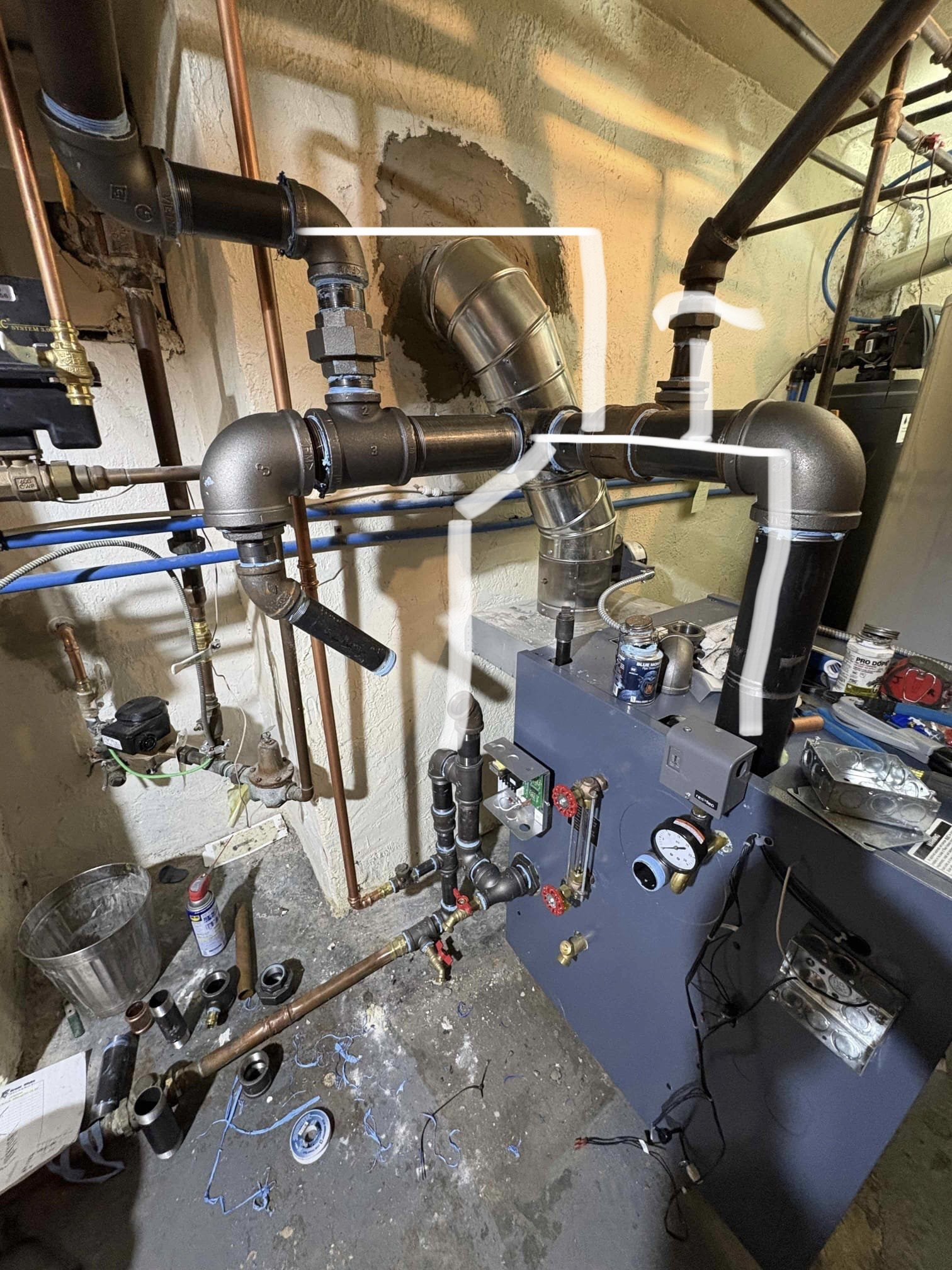

    I'd use the other tapping and plug the one that's currently being used.
    I'd also extend that left main over quite a bit so my equalizer is straight.

    @ChrisJ But that could get him in trouble with Weil McLain regarding warranty because the manual specifies that "Steam supply must be on the same end as controls"
    @jmerrill Make sure your equalizer is 1-1/2" min. because that is what is specified in the manual.

    @jmerrill could always go overboard like Paul did and use a double riser from the boiler into a drop header the there sill be plenty of room to put the two main risers into the header. Wouldn't that look nice?

    i'm not sure if that is a tee or if the tee is to the right of it and the tee happens to have a casting ridge in the bottom of it.

    It is a Tee
    here is what I see behind that 3" header coming off of the riser.
    What I see coming off of the 3" riser is from left to right: Yellow arrow is pointing to a 3" TEE < 3" pipe nipple < 3" coupling < 3" pipe nipple < 3" 90° elbow ^ 3" riser out of the boiler. The Tee in the header puts the steam in two directions ← → to get to to the different main risers. Not a good design!

    Why scare the OP off? 100 people look at this and you get 100 ways to pipe it. Its done. Is it textbook? No will it work? Yes.

    if everything lines up just the wrong way and the tee is indeed in the corner that could cause some problems but it probably will be fine.

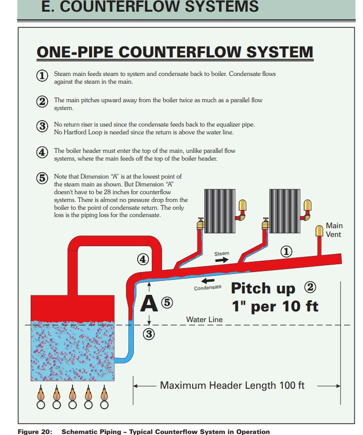

    @jmerrill If you pitch the header downward towards the equalizer at 1" per 10 ft., then the section to the right of the Tee that feeds the main on the right will work as a counterflow header and the condensate will flow back wards towards the equalizer.

    Steam and Condensate don't give a rat's a whether they are in a pipe that humans call a header or a main. The diagram from peerless depicts the concept of proper pitch needed when steam and condensate flow in opposite directions, as will be the case in that stub extension of the OPs header (if he pitches it correctly), to the right of the Tee. Don't know how to explain it any more than that, except to say that anything he can do to keep condensate from being blown up into that main on the right will be a benefit. Basics matter most when things go wrong……
    PS (lol): Peerless says in the diagram "maximum header length 100 ft."
