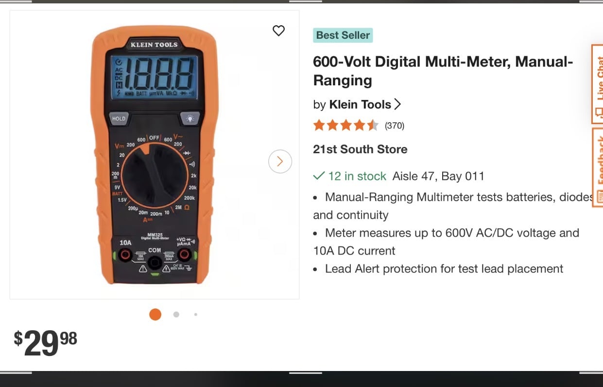

    hot_rod Posts: 28,350
    multimeters have become very affordable if your search does not turn up yours. Home Depot example
