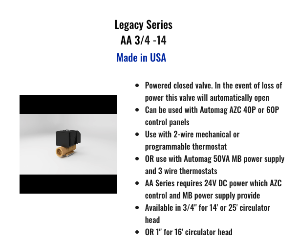

    hot_rod Member Posts: 27,468
    I think these are basically a solenoid type valve, powered close.
    There are two versions of the Automag zone valve the AA is a DC, they offer an AC version also.
    So if you start changing components be sure they are all "on the same page" regarding current and voltage.
    It looks like a bit of a homemade wiring and power source for those zone valves?
    Maybe the electrician worked for "Ma Bell" at some point based on the wire and terminal block :)
