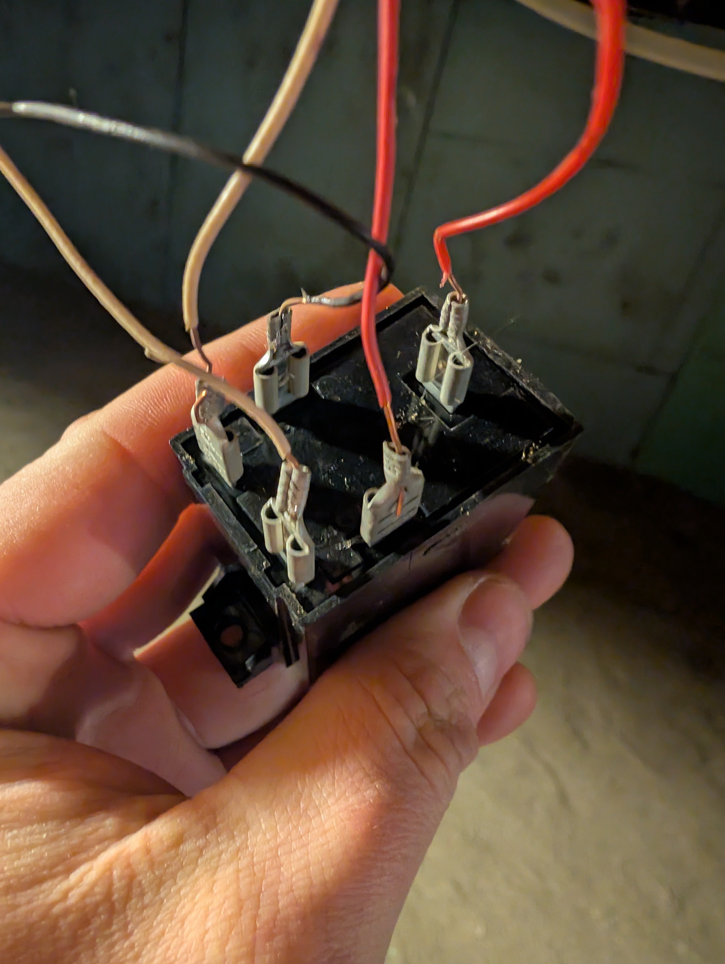

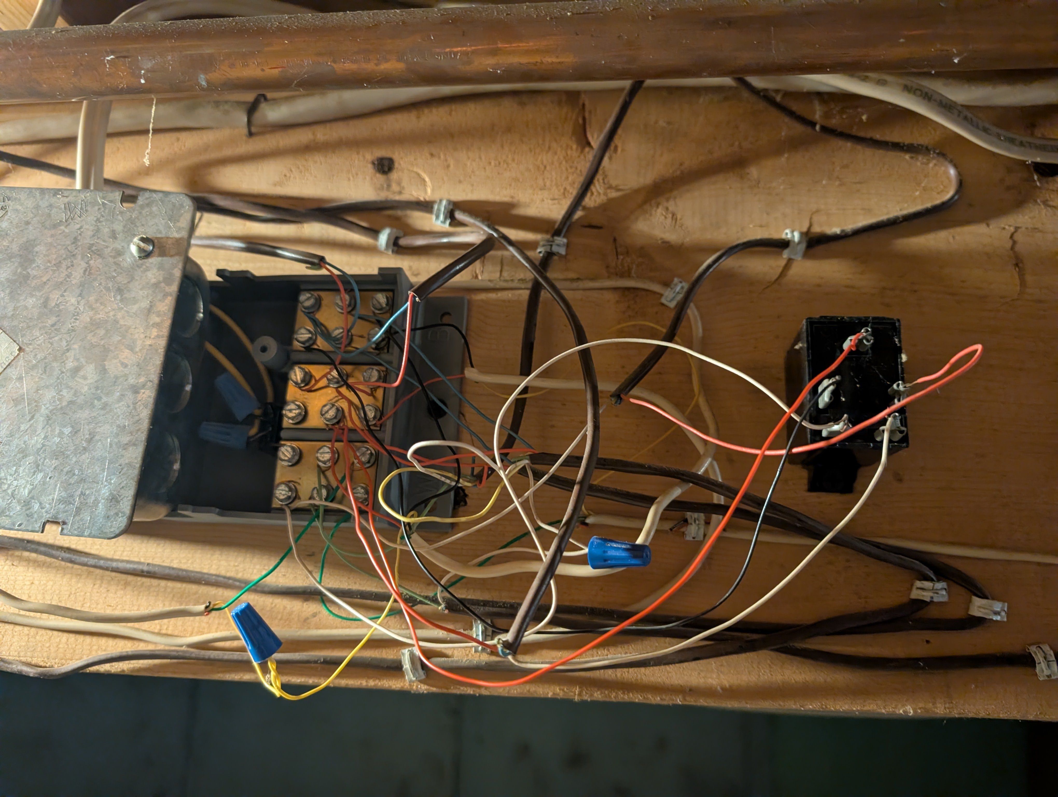

I recently purchased a home with an older Automag zone valve system. Oil furnace, hot water baseboard heat.
A recent problem has come up where all zones are heating when one zone calls for heat. I know that these automag zone valves fail open so I am thinking that this is an electronic problem as opposed to all of the valves being non-functioning. I have even replaced a few of the valve heads with new ones to confirm that and no change.
My question is I cannot seem to figure out what this separate relay is, it is on the side of the control board. It is hooked up to the hot water tank which I believe is the priority zone.

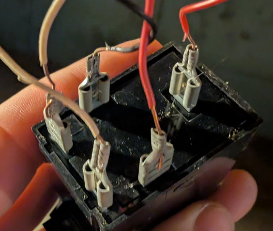

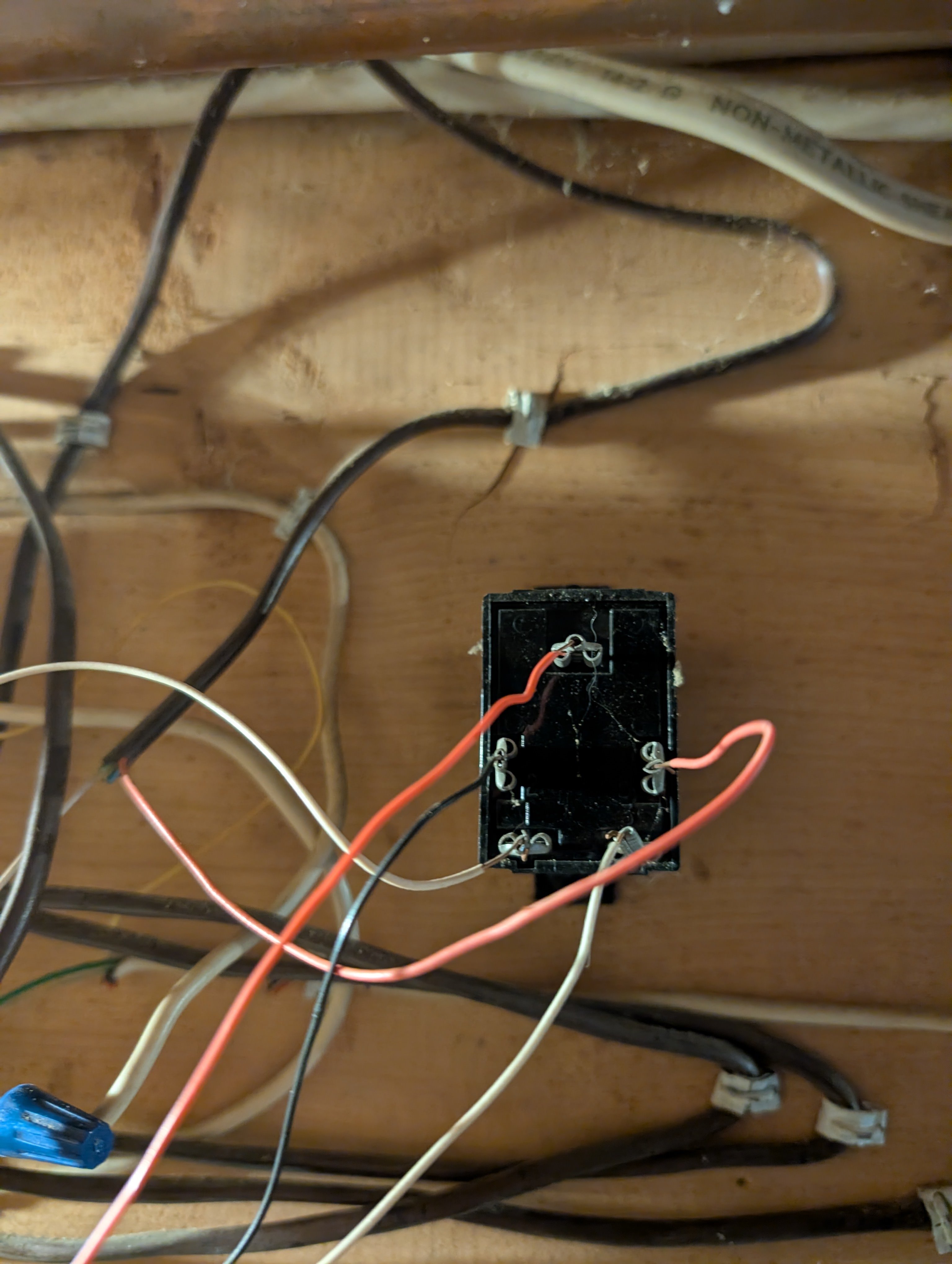

Here are some photos of the relay. There are no markings on it. The only similar relay that I was able to find is the Automag CNV84 ( picture attached)) which is a 3 wire to 2 wire relay. Is this what I should be changing out?
I dont think the problem is with the main control board, as thermostats are working correctly and kicking on/off furnace when it calls for heat. The problem is that power is not going to the valves to close them, and that the hot water tank is not regulating a constant temperature.
Thanks for any help or guidance you can give.

    That looks like a standard run of the mill relay. 24 volt coil 24 volts to terminal 1 & 3 powers the coil.
    contacts 2 & 4 are normally closed with no power to the coil
    contacts 5 & 6 are normally open with no power to the coil
    The contacts reveres operation when the coil is powered. Look closely at the relay the terminals are usually marked
    I think the 24 volt coil is the two white wires. Terminals 4 & 6 are connected internally. It is a single pole double throw relay

    you have to trace things with a meter. there could be a transformer or fuse that is bad or something like that or a wire that is broken off somewhere. that type of wire will snap off really easily if you nick it when you strip it. i can't really think of a reason why there would be a single relay in front of all of the zone valves. the relay that is screwed to the framing might turn off all of the heating zones when there is a dhw call.
    that is just a standard inexpensive hvac relay, it has nothing specifically to do with thermostats.
    Toothed

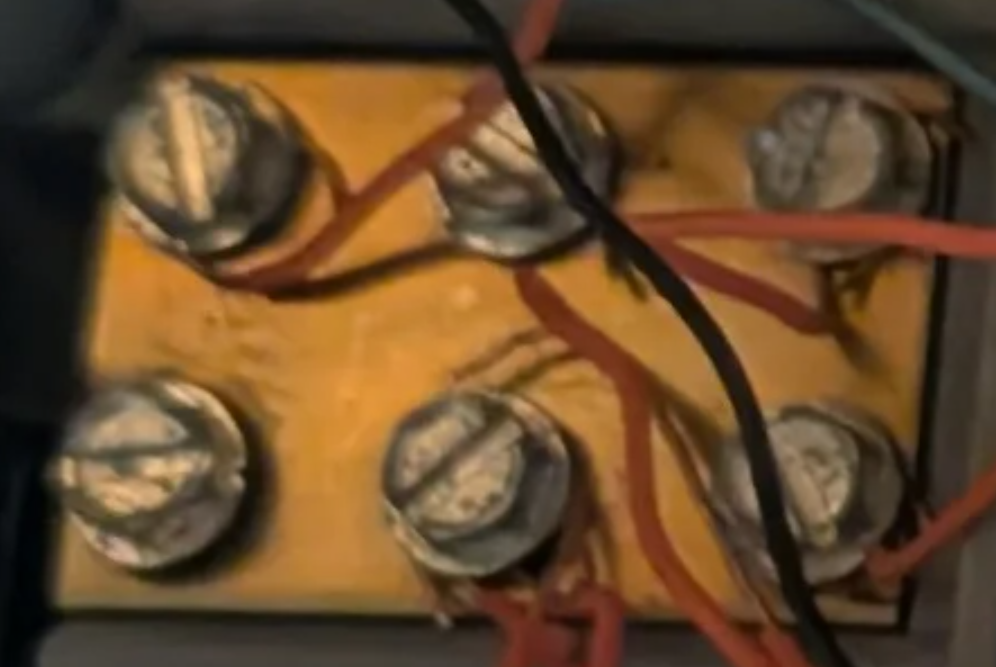

    i don't think there are any electronics there, i think that is just a set of insulated bus bars from the telecom or alarm industry repurposed to wire the zone valves.
    Toothed

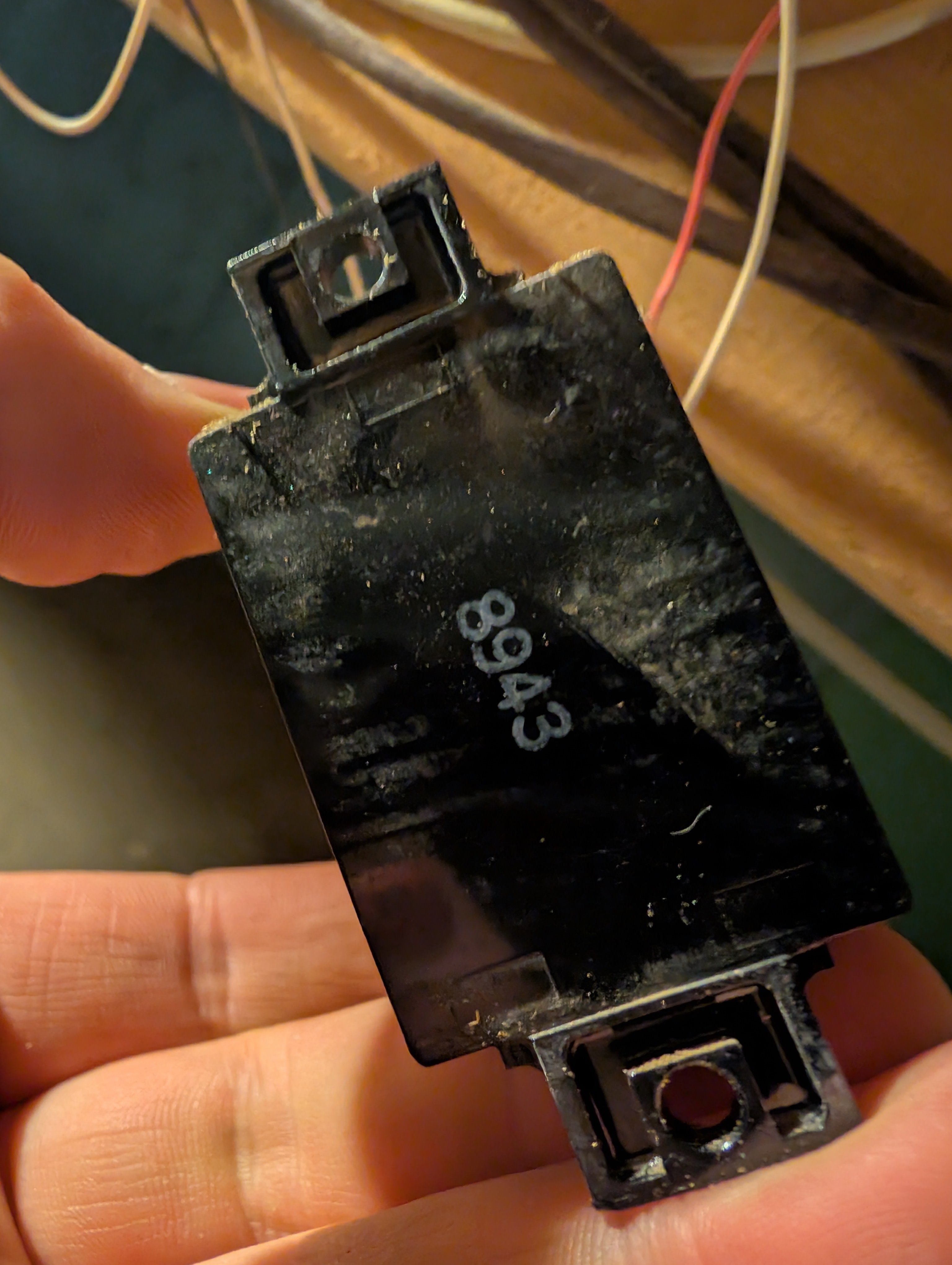

    Your black plastic box looks like a relay with a date code 8943 (43 week of 1989), and the crimp connections look pitiful.

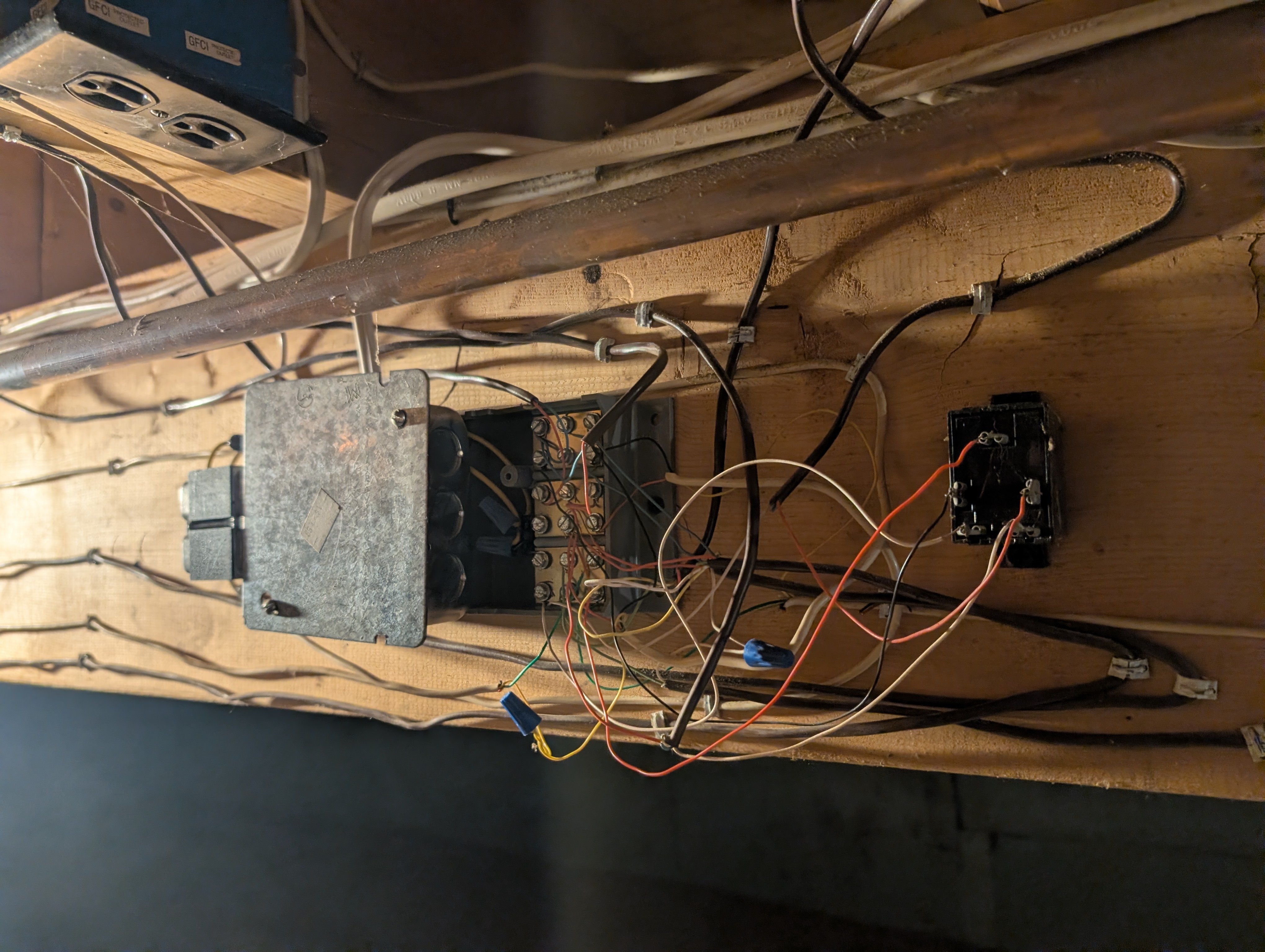

    I suspect the thermostats energize the zone relays and the zone relays then cut off the power to the zone valves so they open allowing the water to flow.
    I also suspect for DHW (Domestic Hot Water) priority it is controlled by an aquastat or DHW thermostat that controls the black plastic relay and it simply may disable power to the space heating thermostats or the zone relays' coils, so they can't be energized to shut off the DC power to the zone valve coils.
    Not sure where the AC to DC conversion is, maybe in the junction box. What is under the cover of the junction box ? I suspect the relays are all AC powered but that is just a guess.
    More pictures of the whole control system may help.

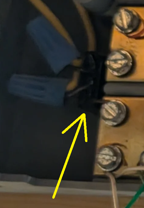

    pretty sure these are bus bars, don't see how the screws are insulated from the metal.

    It looks like this may be a full wave bridge rectifier, the AC to DC conversion. If the yellow wires are the 24 VAC and all the zone valve control equipment may be after the rectifier and all the relays may have DC coils.

    there aren't any relays other than the one that is probably doing dhw priority(or firing the boiler from the end switches). those are the busses that supply the zone valve and thermostat for each zone and the combining of the end switches. the rectifier could be bad and keeping the zone valves from closing but the end switch fires the boiler.

    Yes that would make sense and the thermostats open for a call for heat, the black plastic relay is for DHW priority, it interrupts power to the upper bus bar.
    I've seen older equipment where the whole base plate is the insulator like the plastic relays are now, however I like the bus bar theory. Makes more sense with the wiring and screw count.

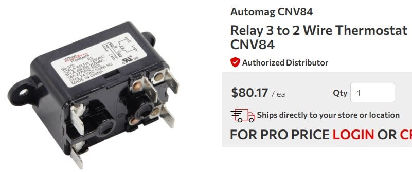

    Thanks all for the replies, much appreciated. During my research I did find that this is a standard SPDT relay. I have one on order that will be here Tuesday. I will update once I change that out. I will also take photos of the control board.

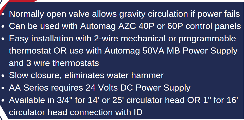

    There are two versions of the Automag zone valve the AA is a DC, they offer an AC version also.
    So if you start changing components be sure they are all "on the same page" regarding current and voltage.
    It looks like a bit of a homemade wiring and power source for those zone valves?
    Maybe the electrician worked for "Ma Bell" at some point based on the wire and terminal block :)

    I kind of doubt the full wave bridge rectifier for the AC to DC conversion is defective. If it is defective it would probably short out and that would probably cause the 120 VAC to 24 VAC transformer to fail. Diodes and bridge rectifier like that rarely fail open like a blown fuse.

    it is a little messy and made out of scrounged parts but it isn't bad(someone other than the original owner may have worked on it and not put things back when they were done). maybe they worked in an industrial setting that used those valves.
    it isn't impossible but it isn't likely that a relay would fail in that particular application, it has enough load to keep the contacts clean but not enough to wear them out.

    Another test. If you understand the black relay's switching you can temporally disconnect the switching wires and do the switching manually to see if it restores the normal system functionality.
    I would venture to say it is a SPDT (Single Pole Double Throw) relay.
