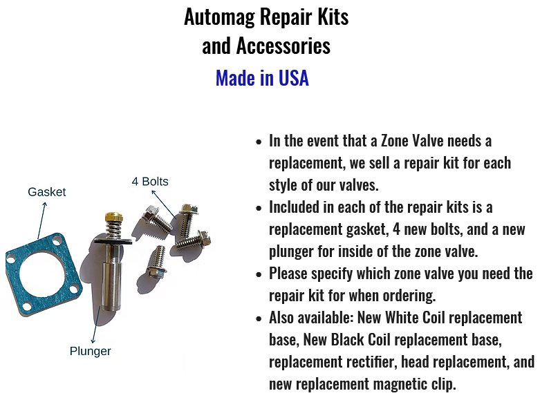

    109A_5 Member Posts: 3,620
    Depending on what is actually wrong, I would think a repair is a lot less expensive than replacing all the zone valves and starting over. However some good troubleshooting has to be done to determine the actual defects.
    Lets say that some or all of the space heat zone valves are sticking open even though the DC power is applied to all of them. Since the DHW priority is electrically controlled, you have lost DHW priority control if any of the zone valves are are sticking open. Does that seem like that is whats going on ?
    It may not even be an electrical problem.
    Not sure if you can get rebuild kits for those zone valves.
    Seems like the Zone valve repair kits are available.
    https://www.automagzonevalves.com/automagrepairaccessories
    edited 9:22PM
    If it were me I'd turn down all the space heat thermostats, let the pipes cool a bit, run the DHW water to force a DHW priority (boiler running), feel if hot water is leaking by any of the space heat zone valves and measure if the 24 VDC is present at any space heat zone valves that are leaking by.
    If the 24 VDC is present, hot water leaking by, the zone valve needs repair or replacement.
    The zone valve coil resistance should verified too. An open coil will cause the valve to not close. It appears replacement coils are available too.
