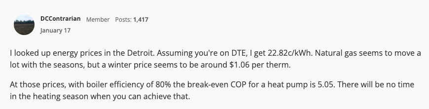

  • DCContrarian
    DCContrarian Member Posts: 1,425
    I looked up energy prices in the Detroit. Assuming you're on DTE, I get 22.82c/kWh. Natural gas seems to move a lot with the seasons, but a winter price seems to be around $1.06 per therm.
    At those prices, with boiler efficiency of 80% the break-even COP for a heat pump is 5.05. There will be no time in the heating season when you can achieve that.

    hot_rod Member Posts: 26,989
    Are @DCContrarian energy assumptions correct?
    If so the heat pump will be more expensive to run compared to the boiler.

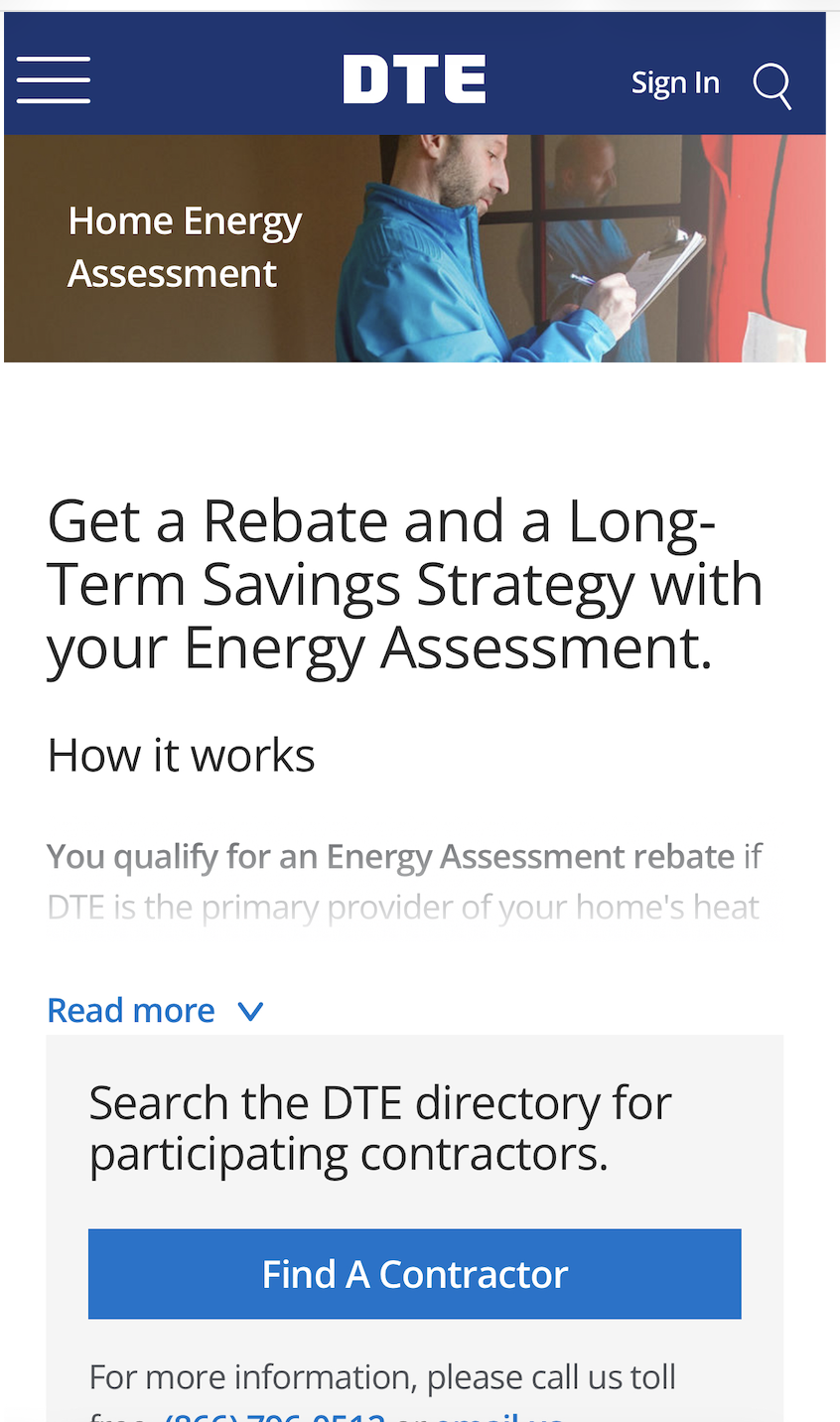

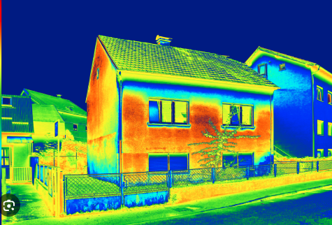

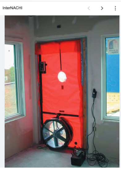

    One option for reducing energy costs, regardless of the type of heat, is to have an energy audit done.
    This includes a blower door test to locate all air leaks and an infrared scan to show where insulation deficits are. Any improvements you can make reduces the energy costs now and going forward. Even small improvements to air sealing (infiltration) can make sizable differences in fuel consumption.
    In some locations you energy supplier, gas or electric will pay for some or all of the cost for an energy audit
    go here, put in your zip code for info www.dsireusa.org
