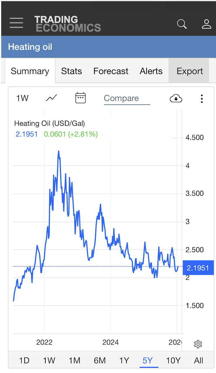

    Past fuel oil bills could help you determine the operating cost comparison.
    While electricity may be $$ in your area, it is probably consistent, whereas fuel oil can vary, even month to month. In 2022 fuel oil went over $6.00 per gallon to some customers, what are you paying today?
