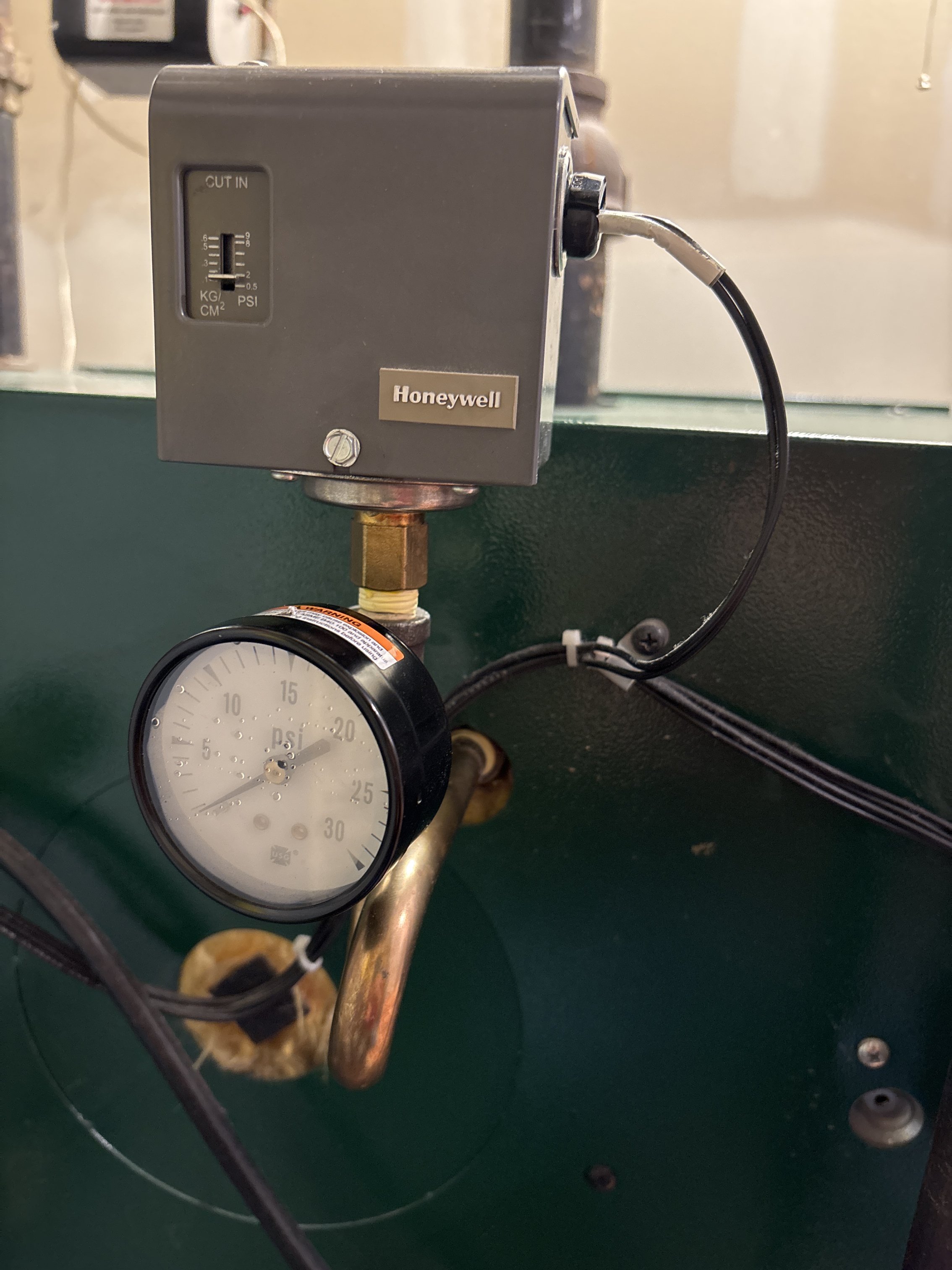

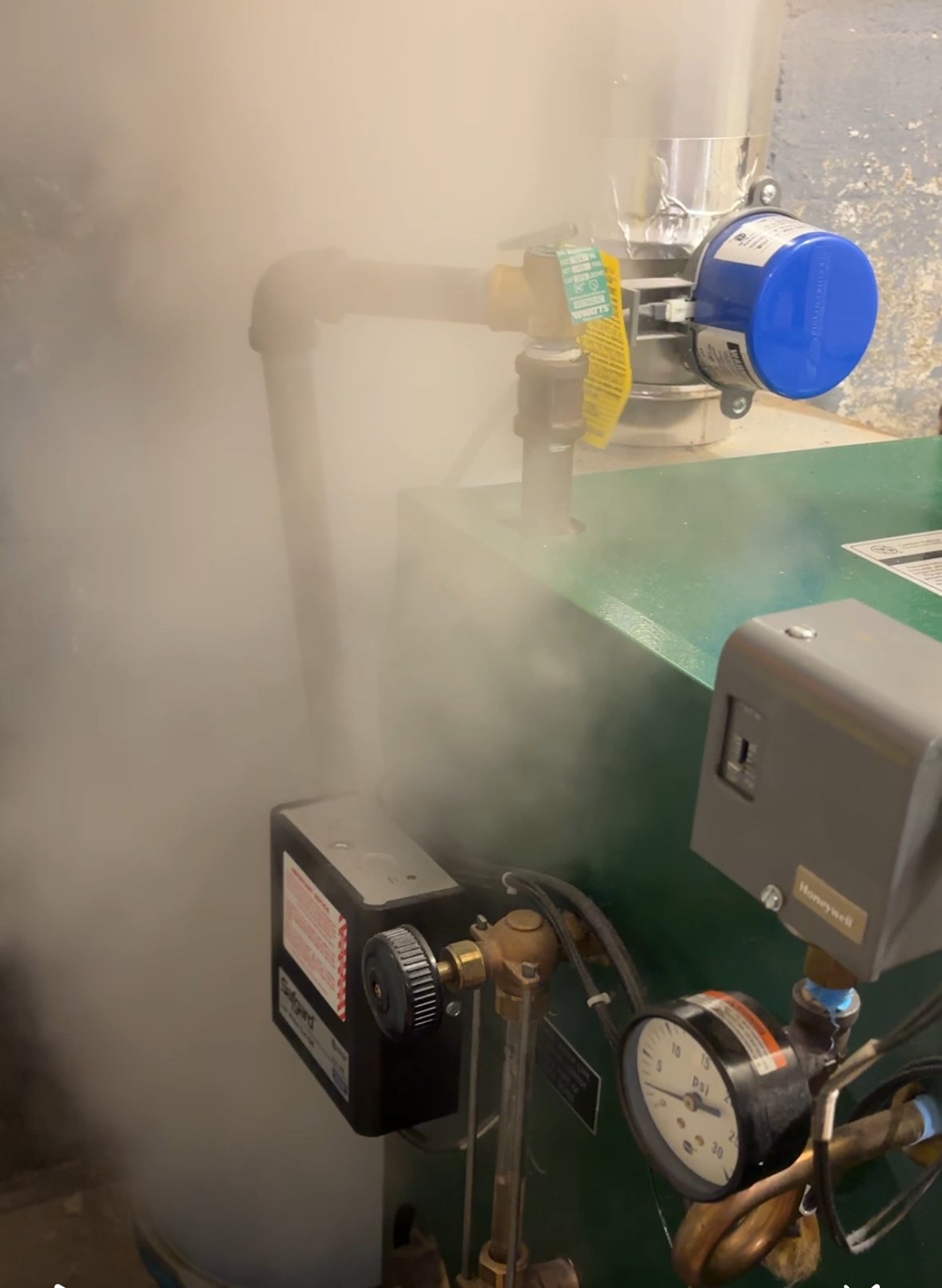

I have a Williamson steam boiler gsa 125 n sp. Had it for about 18 years in my home. Just had the main steam vent and discharge relief valve replaced. But now, when the system heats up (all radiators are working well) there’s an explosive bursts of steam that comes from the discharge pipe. PSI is 1 and sufficient water in the boiler. What’s going on? Appears to happen only after everything is heated up Maybe 2-3 bursts a few minutes apart. See attached photo
Please help!

    Is your gauge accurate?
  • Lastname1
    Lastname1 Member Posts: 17
    Gauge could be bad as PSI is 1 prior to steam release then jumps to 2 per picture. Which valve could be bad? The discharge valve was just replaced.

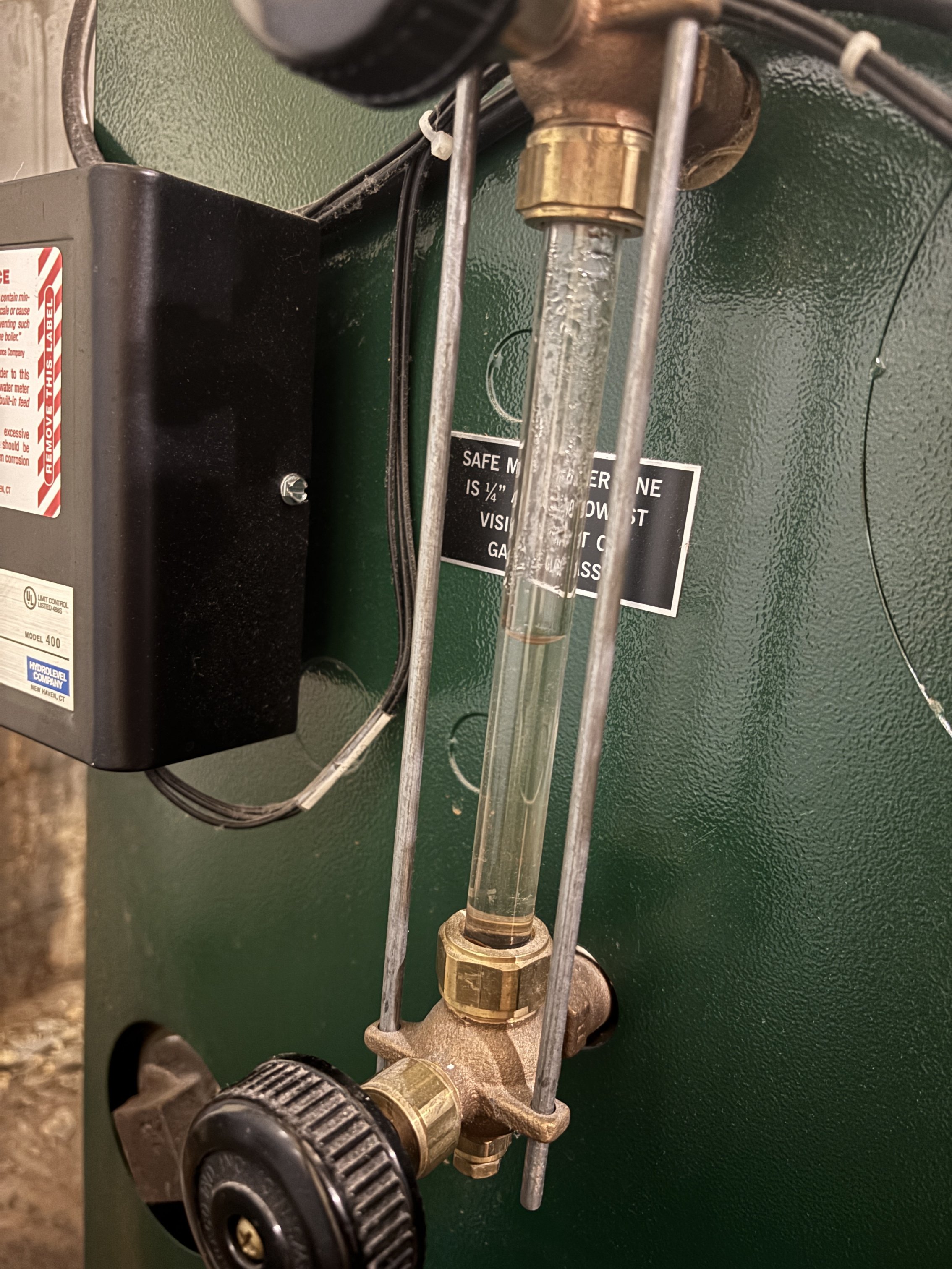

    Your boiler water does not look clean. Does the water in the gauge glass surge up and down when the boiler fires?
    Your pressure gauge appears to show 2PSIG.
    Does the boiler have a skim port?
    When was last time that the boilers base and mud leg were cleaned and wanded?
    Has the pig tail ever been cleaned?
    Is the pressuretrol original to the boiler?

    ethicalpaul Member Posts: 8,360
    edited December 2025
    The important question of the above ones is: has the pigtail been cleaned and checked to be clear of blockages.
    Although I admit it's very suspect that this just started happening after the PRV was replaced (if that is in fact true). Why was the Pressure Relief Valve replaced?

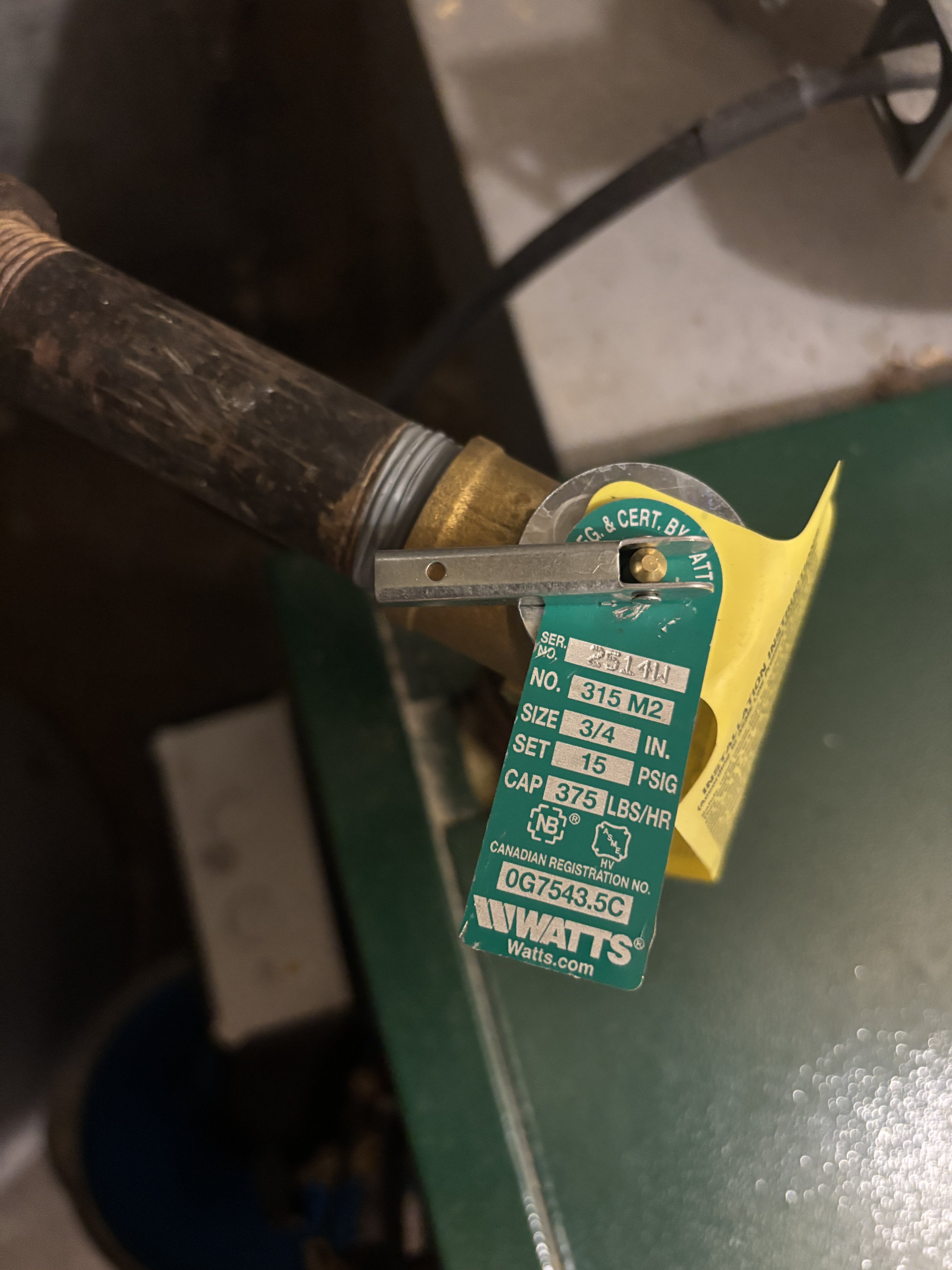

    Intplm. Member Posts: 2,906
    I cannot see from the picture. What pop safety relief valve is on there?

    Plumber replaced a ruptured main steam valve on the main line. Then I started getting this explosive steam. Plumber thought it was the relief valve (guess he thought the steam was constantly being discharged and figured there was some sediment keeping the valve partially open).
    He seems to think it might have to do with the automatic feeder but I’m not so sure that’s right. This is a pressure problem not a water feeder issue.

    Please let us know what information is on the PRV tag.

    OK, thanks. Well to get to the bottom of this if it were in my basement, I would buy a low-pressure gauge and some 1/4" brass fittings to add it onto the pigtail along with the existing pressuretrol. This would let me know the true pressure at any given time.
    When installing that, I would take off the pigtail and run water through it to determine if it was blocked and to clean it. If it is blocked, the pressure is not "seen" by the pressure control.
    Actually let me edit that to say I would just clean the pigtail now before waiting for the gauge to arrive.
    Then see what the gauge tells me on a call for heat.
    I have a feeling the old Pressure Relief Valve was doing its job and the new one is too.

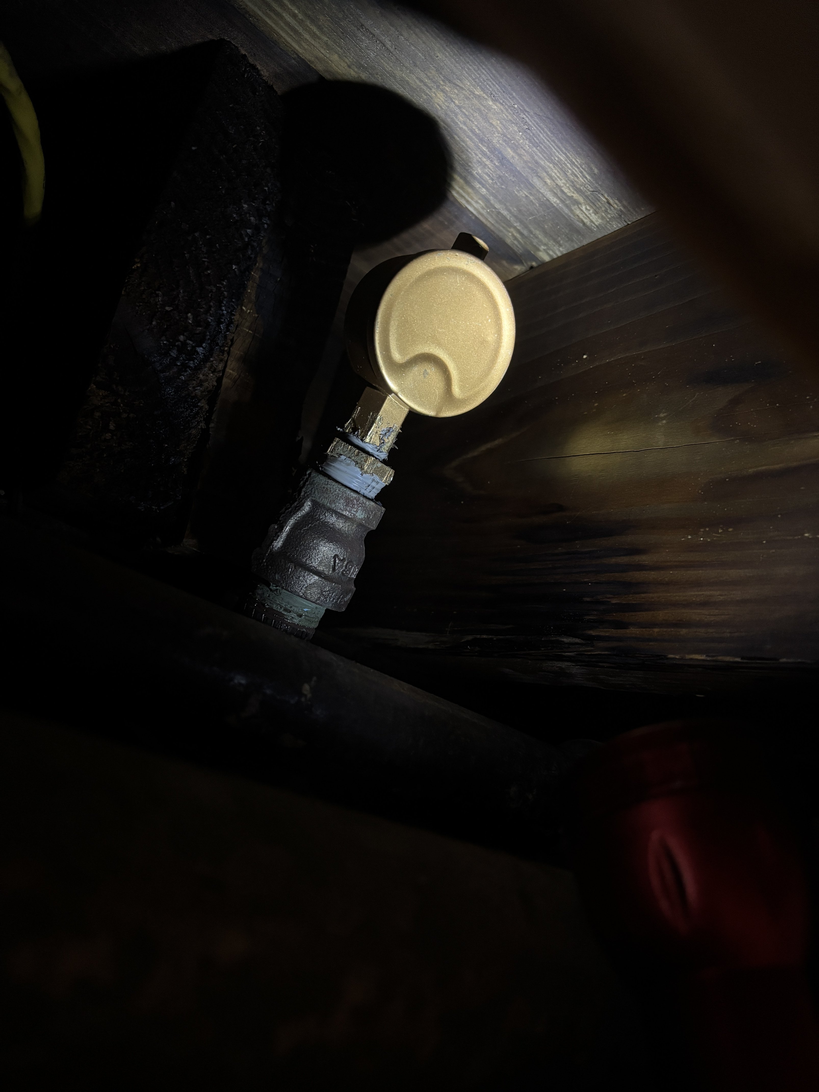

    Was the original main vent replaced with the same size vent?
  • Lastname1
    Water does seem to be clean. Heres another picture. I agree about the pigtail
  • Lastname1
    yes, the ruptured main steam valve was replaced I’m sure. I had to cut the Sheetrock away because I heard the steam coming through. He replaced it (and I was able to see the rupture) with a bigger valve. When he came back and replaced the pressure release valve, the steam issue was still present. I said we only had this issue after he replaced the main valve. So he replaced it with a different model again.
    As for the water in the boiler, when I drain it (which I did a few minutes ago) it only runs rusty for maybe 2-3 seconds and then turns clear.

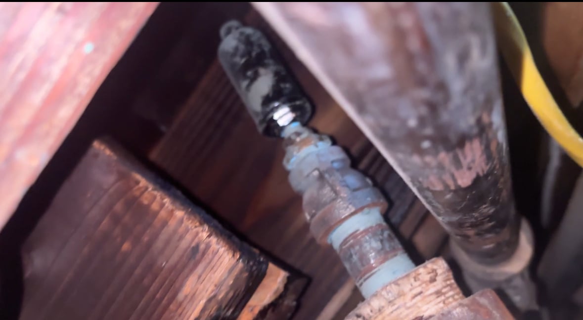

    Yeah please clean the pigtail now. The water is fine.
    I suspect the old main vent (I don't like to call it a valve) blew out because it was holding 10-15 psi for extended periods. Its failure is probably what kept your pressure from going above the 15 psi rating on the pressure relief valve.
    When he put on a new main vent, then the system pressure was able to go above 15 psi and make the PRV open.
    Lastname1
  • Lastname1
    old one (silver)
    is first picture, new is the brass one

    I agree with @Steamhead , @ethicalpaul and others about the pigtail being plugged.
    Also the gauge is on the same pigtail as the pressure control. so that could be why the gauge is not reading high pressure when the relief valve blows off.
    This is not rocket science. If you can turn a wrench you can fix it yourself.
    Kill the power and take the pressure control gauge and pigtail off the boiler. Make sure everything is clean and re assemble . You can use teflon tape or any pipe dope.
    If the pigtail proves to be plugged and you can't clean it put a new brass one on.
    If you cant get a new pigtail easily just use 1/4" brass or black fittings nipples elbows and tee to get it running. You can change the fittings later when the weather warms up

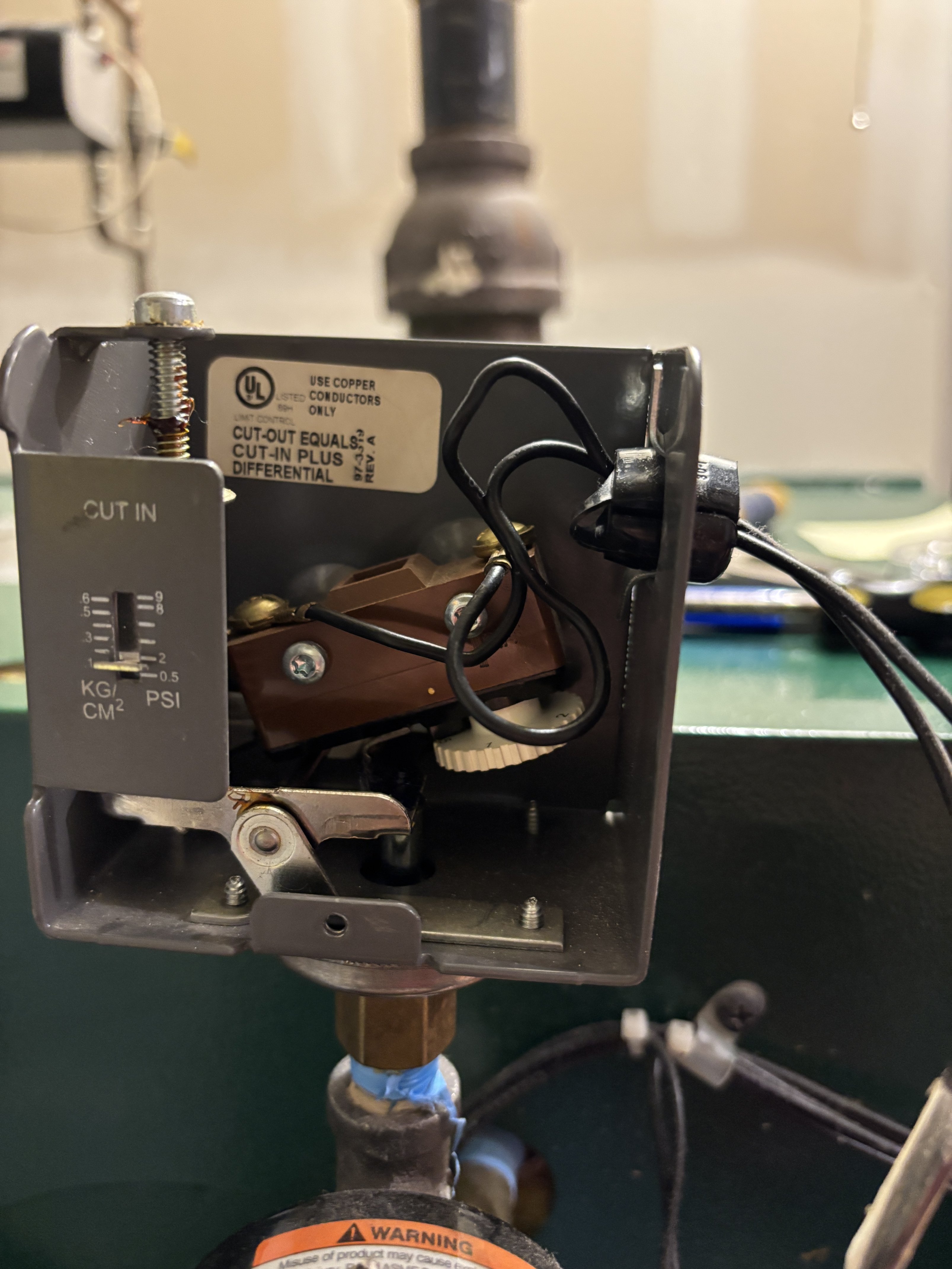

    Now, lower your pressuretrol cut-in pressure on that from scale to .5 psi (the bottom)
    The pigtail will fill with water and block steam from getting to your gauge (which commonly is already broken anyway)
  • Lastname1
    done! Just dropped to .5 psi.

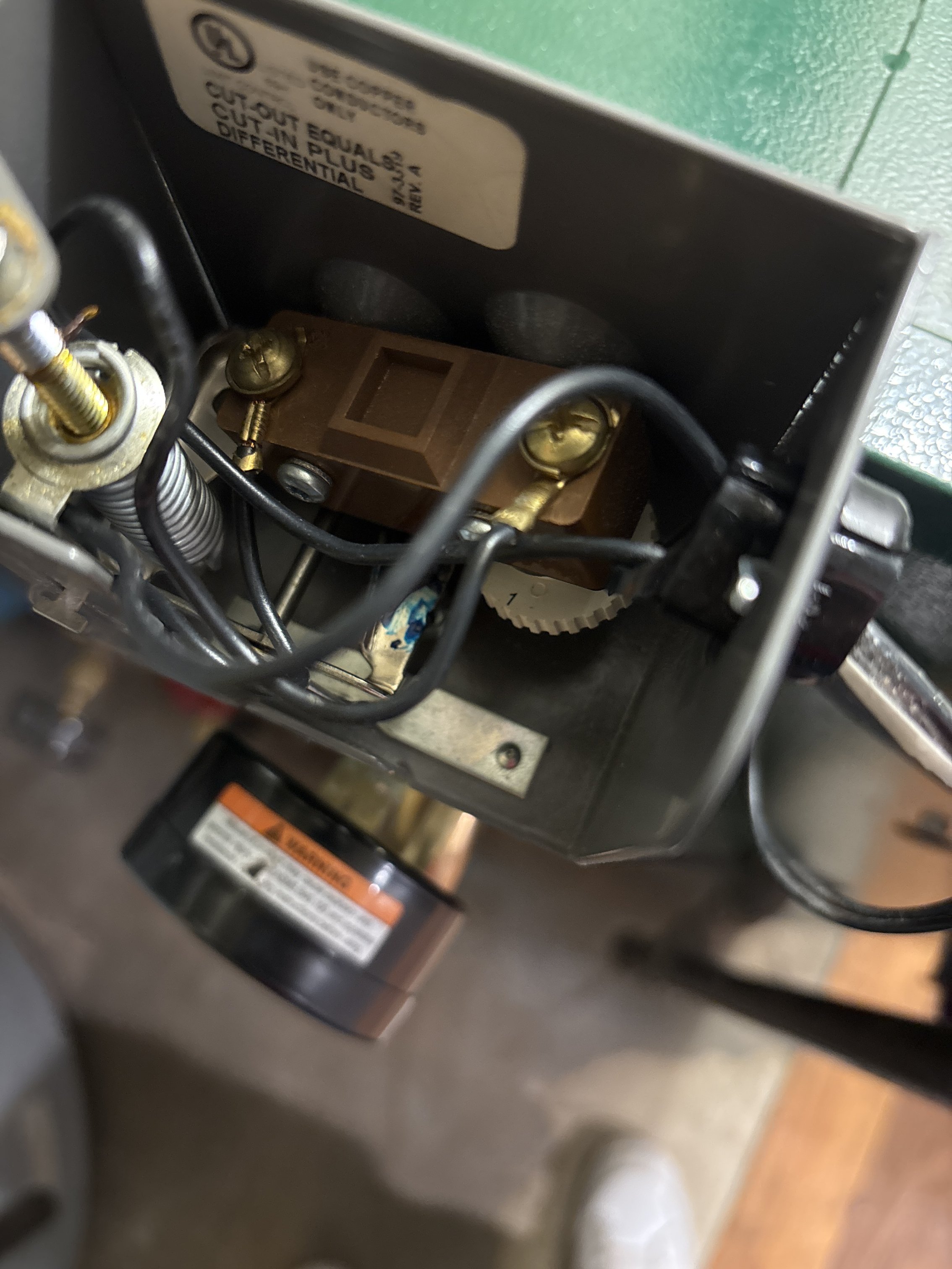

    also check the differential wheel inside the Ptrol, it should be set to 1,

    make sure it comes back on after it cycles off on pressure, sometimes the actual cutin ends up below atmospheric pressure, they aren't very accurate.

    I don’t think I have that option to adjust the differential wheel.
    Yes, you do, it's that white dial wheel on the right there. It should have a number "1" visible from above. It looks like it might be there already. It comes set to "1" from the factory.

    oh! Ok, so if my cut in is .5, the differential is 1….and if my math is mathing, then my cut out should be 1.5?
  • Lastname1
    Looks like it was set to 1 at the factory
    Yes your cutout "should be" 1.5 but these devices are notoriously mal-adjusted from the factory and so your cut-out is more likely to be 2.5 or so.
