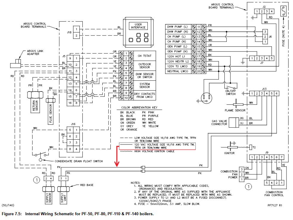

    If this was my boiler, I'd build a wiring break-out device to put between the gas valve's connector and the wiring harness connector, to measure voltage and current to each solenoid individually. Connector parts are available from Digikey.com and Mouser.com and others, dimensions may need to be measured to determine the correct connectors. Also with the gas valve I would measure the resistance of the Gas valve solenoids for future reference.
    I'd verify the Gas valve's voltage, the replacement one shows 120 RAC (Rectified AC), also I'd want to know if it is just AC coming from the control board or if there is Phase Angle control also (modulation). I'd devise a means to manually control the gas valve to better test system pressures.
    Manometer, water manometer (clear tubing) or Dwyer Magnehelic Gage (inexpensive on eBay.com) to measure the pressure of the outlet side of the gas valve myself. And the differential pressure between the exhaust vent and the air intake. Future reference for failing inducer or other restriction.
    Inspect the outlet side of the gas valve orifice port, maybe there is just a piece of Teflon tape that migrated along and is floating around in there. And inspect the venturi / air inlet swirl plate too.
    I'd be doing a lot of my own testing to find out why the flame is going out in 3 seconds.
    Variable DC power supply and a Resistor (100K or 1 Meg maybe) to verify the flame current monitor operation.

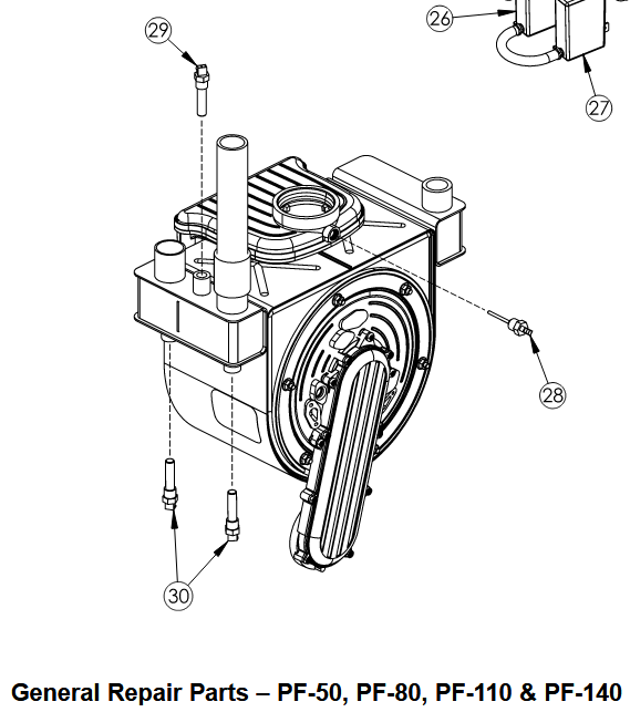

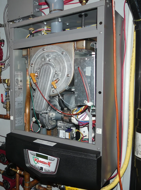

    @Alan (California Radiant) Forbes I don't think you can separate the fan like that, in this case the air and fuel goes through the fan.
    @Redrum Folks speak like that when they hit the frustration level. Parts Cannon type troubleshooting is another source of frustration. With these these 'High Tech' appliances and automotive stuff it is common to have problem that are hard to chase out. The unit in the video was only good for a year. And to me it seems there was some confusion if that is a thermistor or a temperature switch and there is a change in the parts list, so I'm thinking it may have been a factory screw up or update.

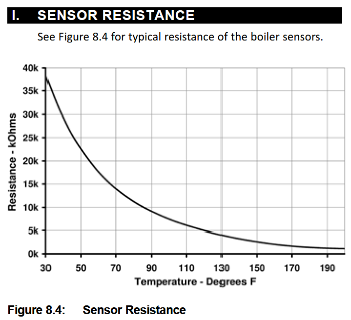

    Sensors (thermistor or switch) go bad all the time and can be strangely intermittent, the connections to them have to be intact too, I find bad crimps all the time. If someone put a thermistor where a switch should be things are not going to work correctly. With your unit who knows what was done before you got there. Personally I like repairing the tough ones and enjoying the fruit of my labor, everyone is different.

    So did you test the sensors ? If the gas valve is not getting the correct power (Supply Limit switch closed), I would not expect it to work correctly. Cleaning the heat exchanger more may be a waste of time since the guy in the video said he cleaned his every year and yet his boiler still has the exact same issues as yours does.
    109A_5 Member Posts: 4,158
    "Lochinvar WB80 not lighting, many new parts already. SOLVED"
    Look familiar ? Different brand, different gas valve. Replacing the sensor fixed it.
    " After getting the new Output Temp/Hi-Limit sensor a couple days ago I can finally say the unit is fixed. I opted to install myself; it was pretty basic, just drain off the pressure and let a little glycol out. I also replaced the Inlet Temp sensor, figured might as well, now just about everything is new. Crazy, all that money spent on parts because the Service Tech didn't make the correct diagnosis of the fault in the first place. "

    First you need to check and make sure the swirl plate is not damaged. the swirl plate will start to warp out and it will effect you combustion at ignition. What you see in the sight glass as a good flame might not be the same where the flame rod sits due to bad air/gas mixture. I'm leaning this way for your problem because I used to see this quite a lot but commercial condensing boilers use venturi for the air gas mix. When you have a bad swirl plate it will start off with a slow rumbling at first and get gradually worse overtime and then you get ignition failure.
    I guess my troubleshooting strategy is different than others. Especially when things are behaving strangely.
    Power; No electrical / electronic device works well or properly if the power is insufficient.
    Easy resistance checks. Although not as thorough as power on loaded measurement it still may catch something obvious.
    Multimeter measurements can usually be done relatively quickly. So not much time is wasted doing them and it gives you a better baseline at to what is most likely good and not causing the issue.
    Troubleshooting strategy is largely about eliminating what is good and moving on. Eliminate the things that are quick to test and then move on to the more time consuming items.
    I have a saying or a Troubleshooting rule, "Check the power supply first, if you don't you wish you did hours later".
    BTW when the power goes out and a utility re-closer device does not restore it quickly I just shut off all the breakers and/or the main, it is one central point and it is quick. Once the neighborhood shows some sign of normal stable power then I will turn my stuff back on.
