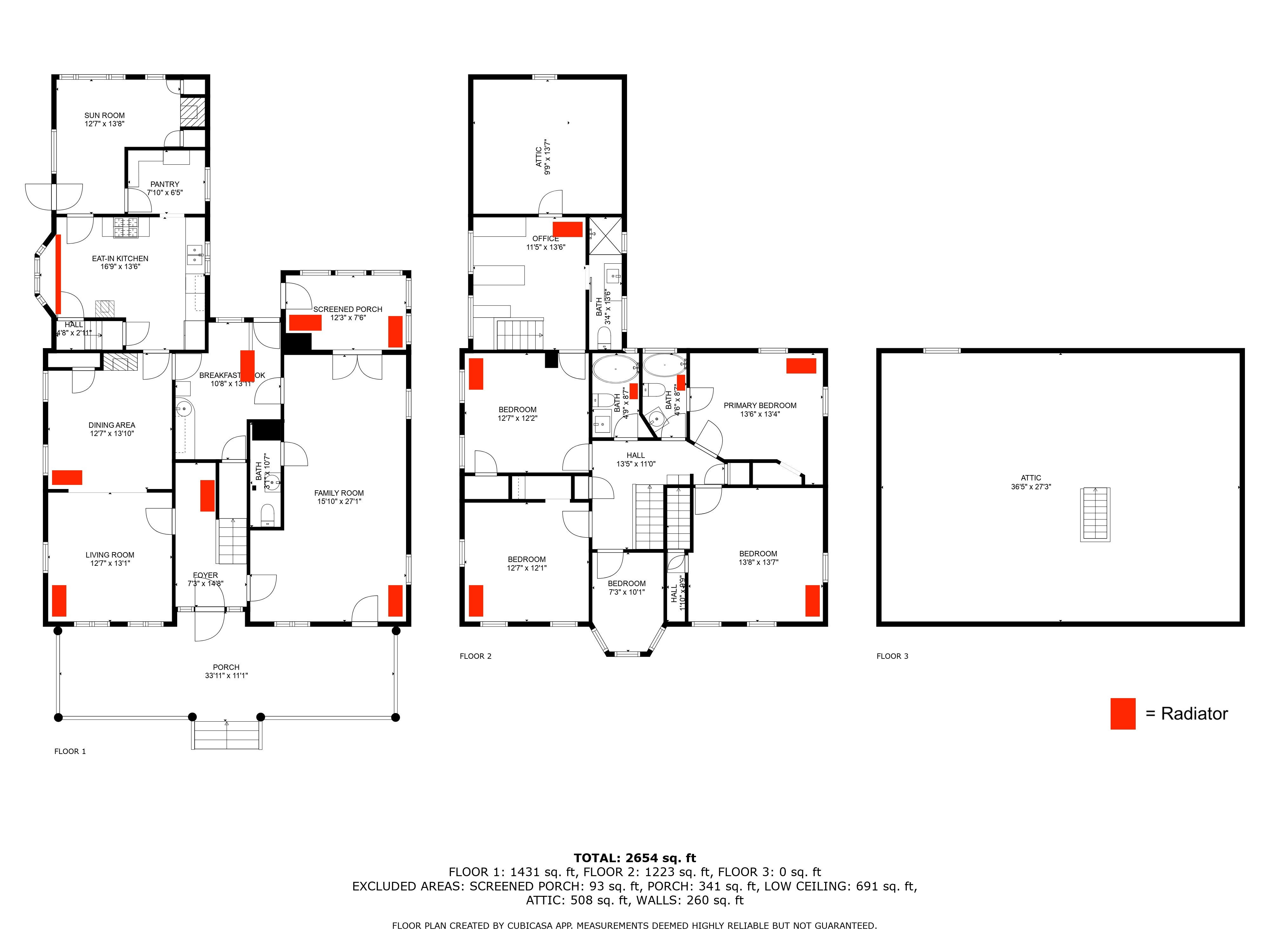

Are the rads steam or hot water? Pictures of some, showing both ends.
Is there a full basement? Pictures of existing boilers and piping would be helpful.

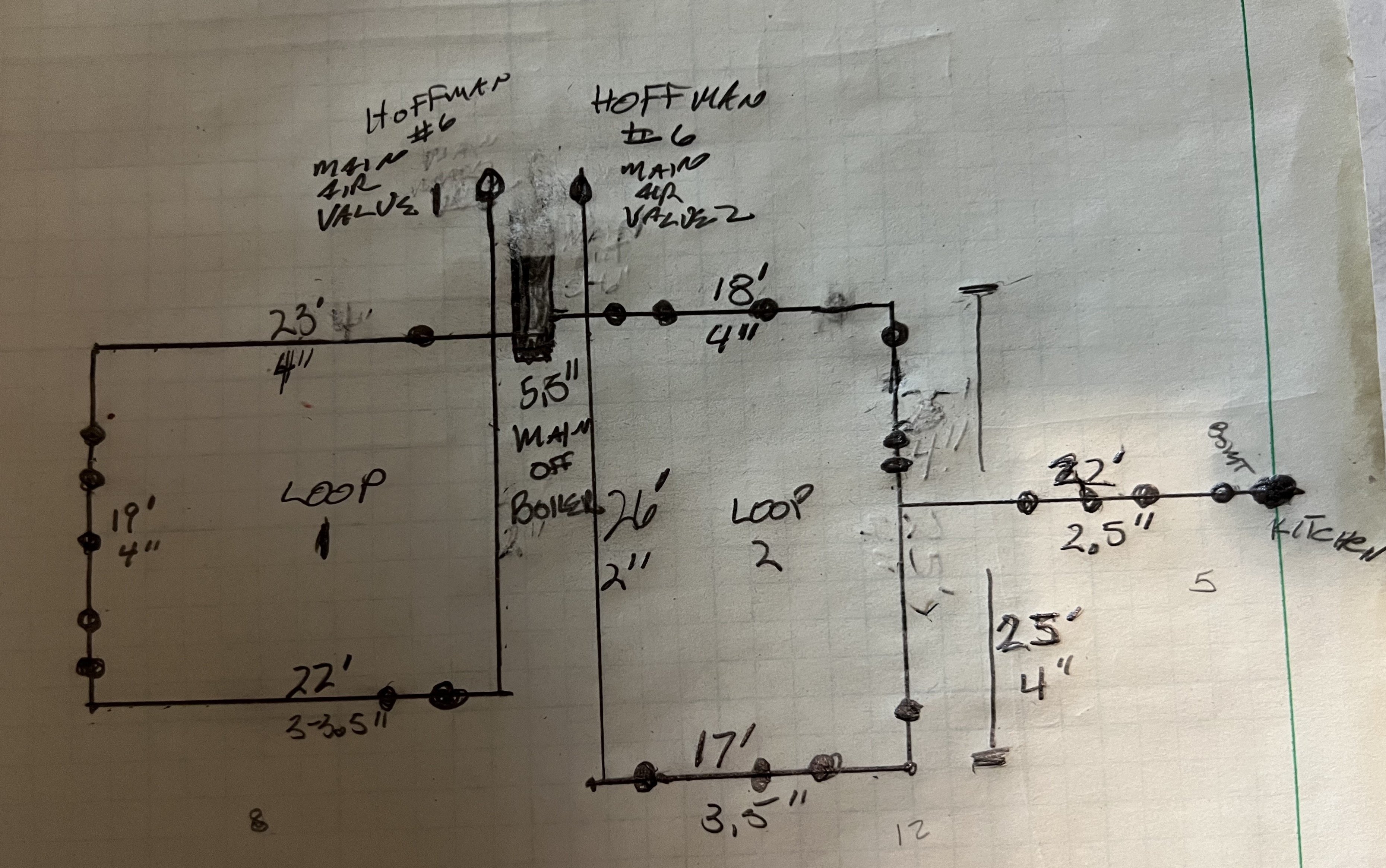

I'm including a rudimentary drawing of our basement piping showing dimensions, lengths, and radiator taps. The Main vents have since been replaced with Gorton #1s, and the dark black circles are each of the 25 taps to go to the installed radiators.
