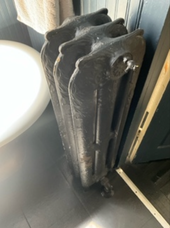

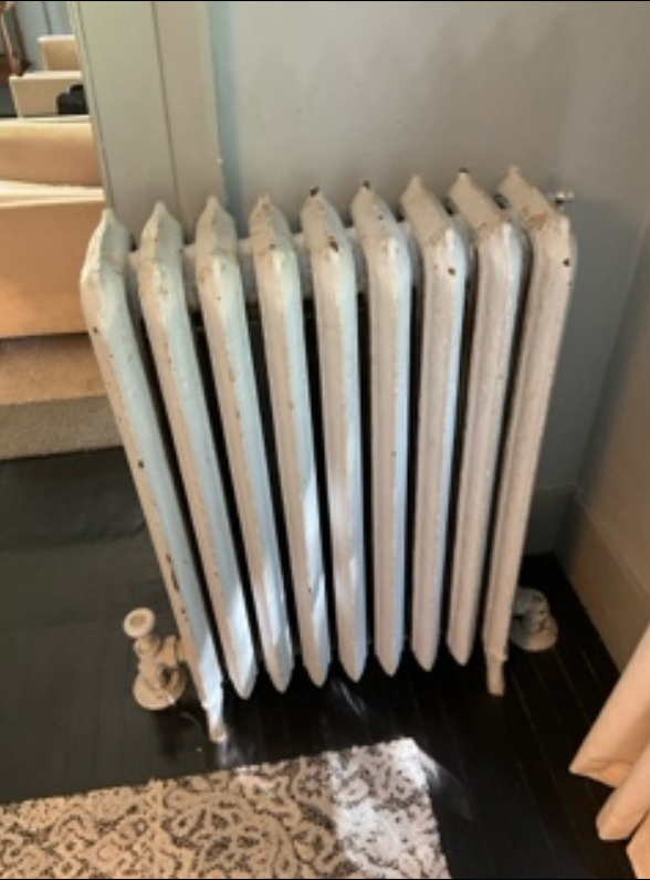

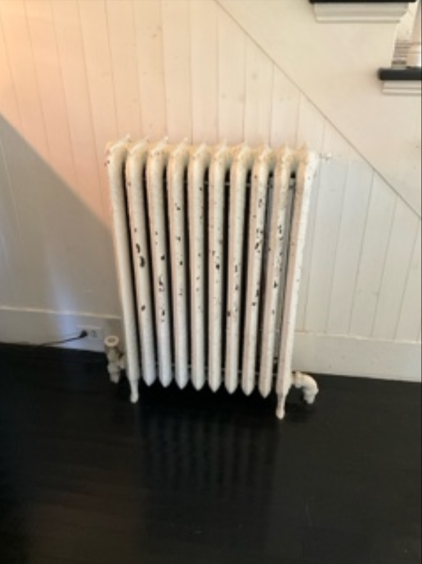

Are the rads steam or hot water? Pictures of some, showing both ends.

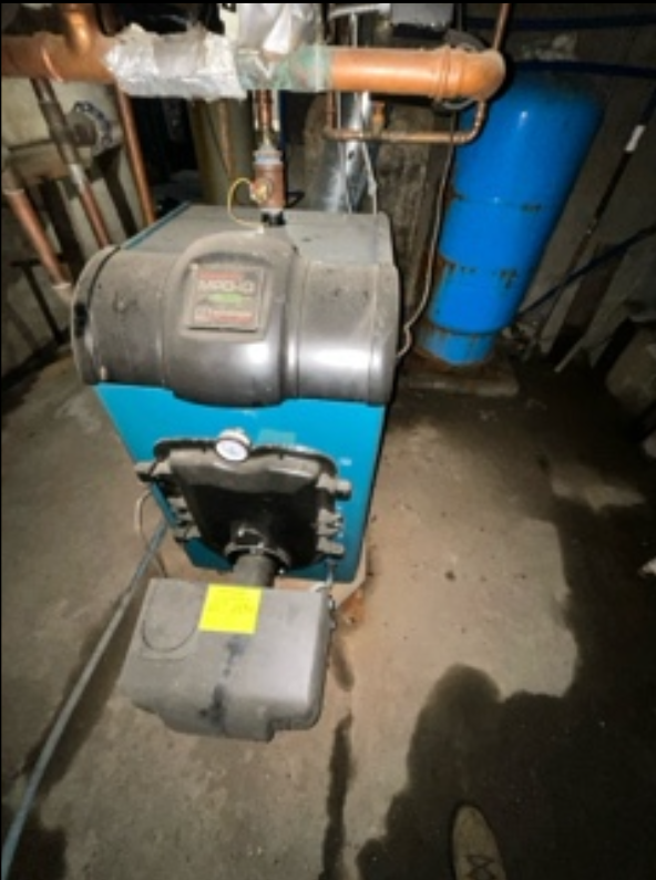

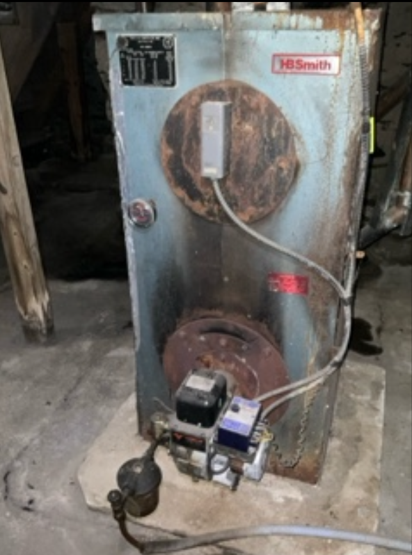

Is there a full basement? Pictures of existing boilers and piping would be helpful.
You will regret it if you take out the CI rads, house that old will never feel warm with forced air heating system……..also most here will never come visit if you do!
6 -
@JUGHNE Thanks for the reply! The radiators are hot water. I've attached a few pictures of the boilers and radiators.
There is a full basement below the original house but not below the 1930s extension (kitchen in the floorplan).

And regarding boilers, the Burnham (not Buderus) MPO you have is a first-class unit. Burnham throws a temper tantrum when we talk about putting gas conversion burners in these, but it can be done with the right burner. I know of several that run well using the Carlin EZ-Gas Pro.
The Smith is older- I think it's a BB14 series- and though it's built like a tank, if you're looking for efficiency I'd replace it.
