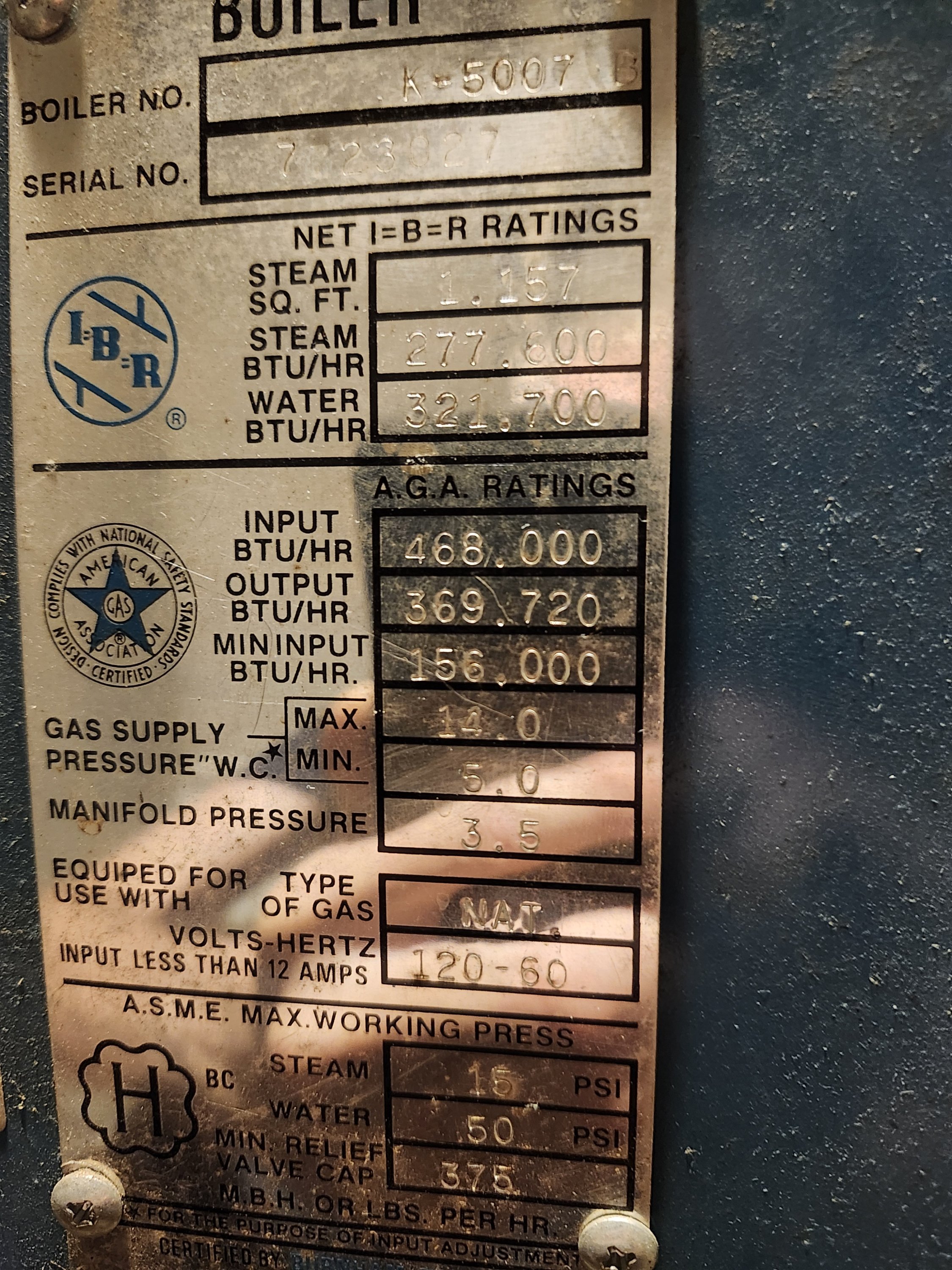

    @dandub1960 , what make and model is the boiler?

    How did it go from 480K to 225K? Was gas pressure adjusted, or burners removed?

    Nameplate on the K-5007 says it can go from 468 down to 156 kbtu or 33%. I didn't initially believe it either but it lights off smoothly, makes steam quietly, and doesn't drive my 1950s remuddled distribution system to conniptions like it did at full firing rate. Been at this setting since 2013, through numerous polar vortices. I love my steam heat; I just hate the crazy draft it pulls.
