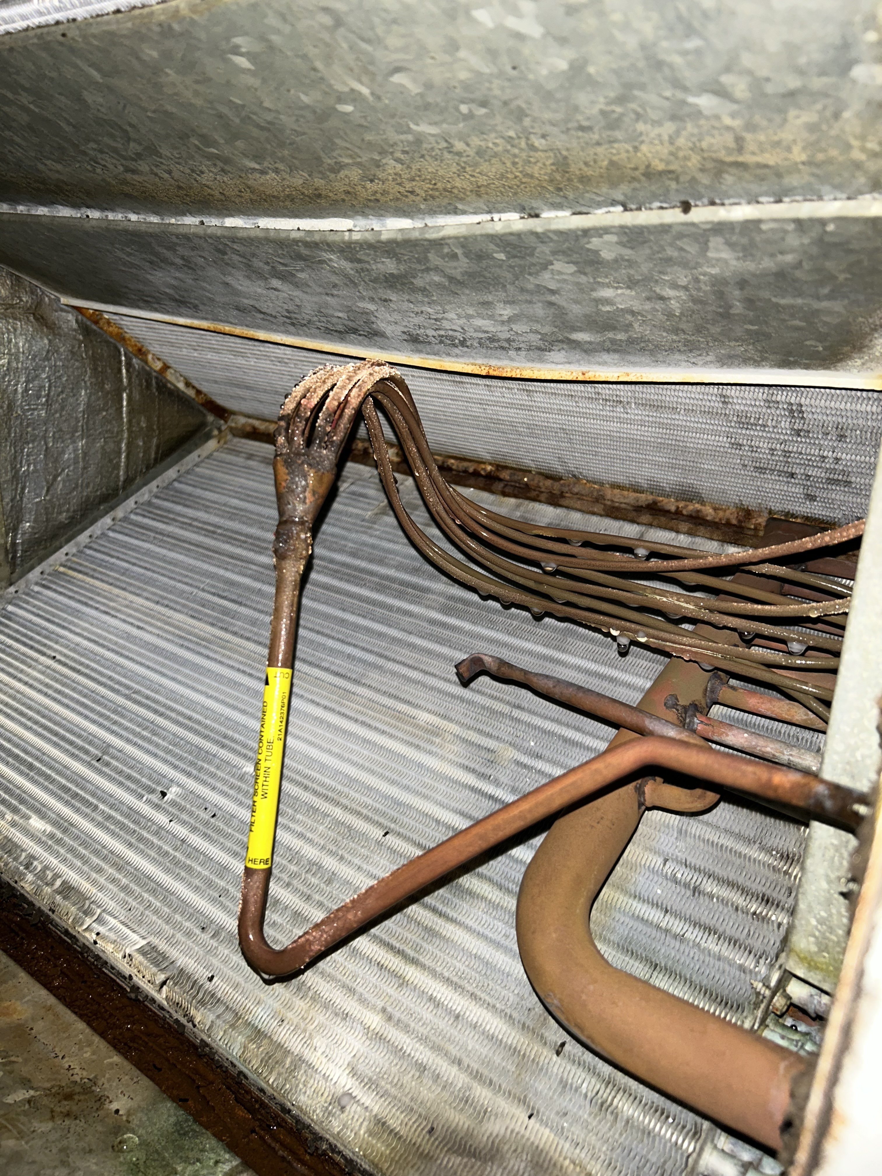

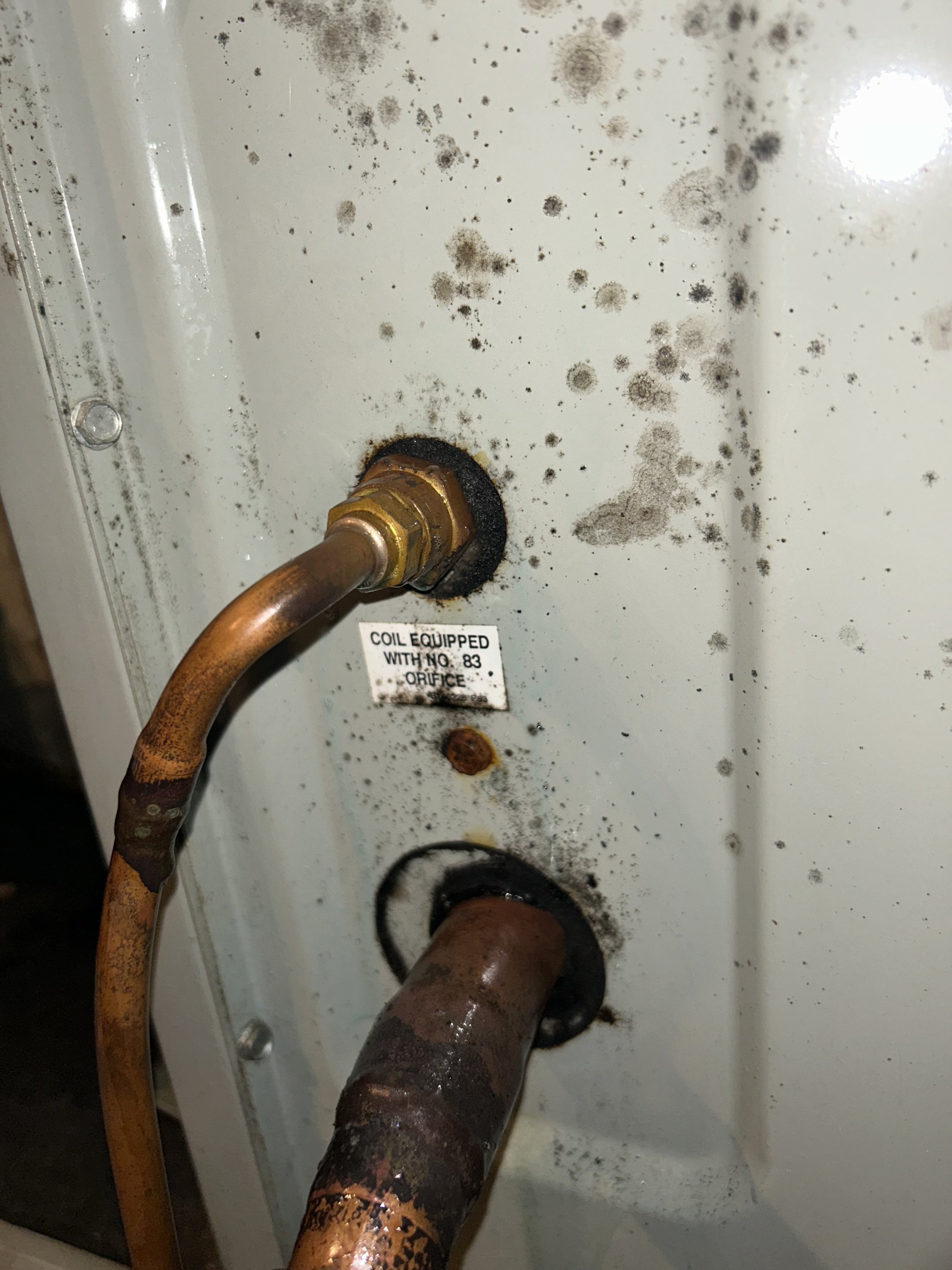

    I don't believe there is a TXV valve, I looked everywhere for it. I can take a picture of the air handler tomorrow as it's up in the attic now, but I believe it's a fixed orifice piston meter at the inlet of the air handler/evaporator. I believe it says something like 0.8 fixed orifice.
    The evaporator coil says its test pressure can handle 300 PSI, however the outdoor condenser said 166 PSI so I was playing it safe with a lower pressure.
    Should I try increasing it to 150 PSI? If I close the condenser's service valves, I could technically go higher to 200 like you recommended as long as I remember to release some of the pressure before opening the condenser's service valves again.
    Edit: Nevermind I actually found a previous picture I took. There is a sticker underneath that fitting that says fixed orifice 0.83 or something to that extent.

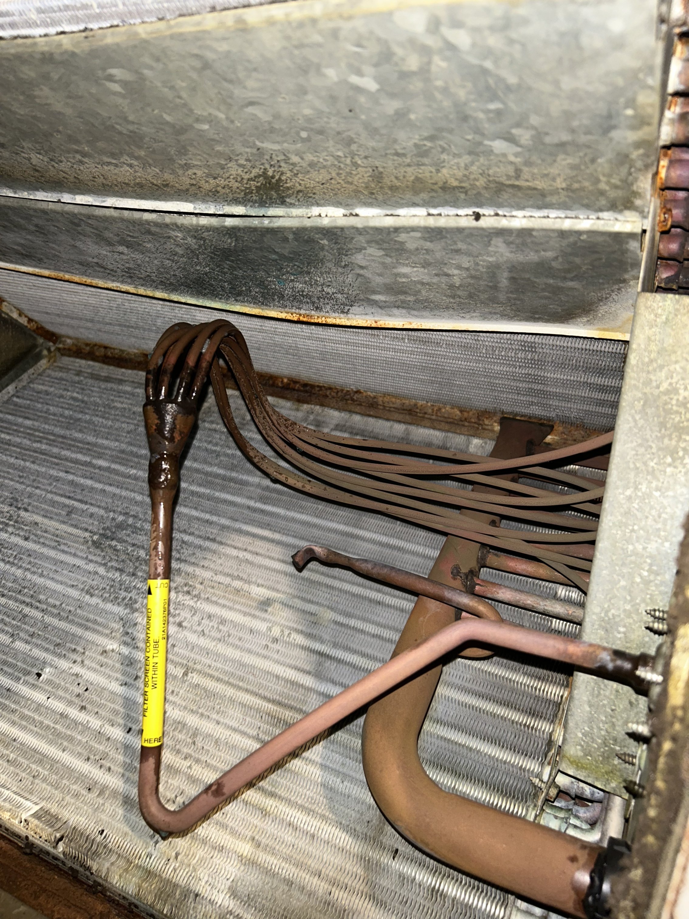

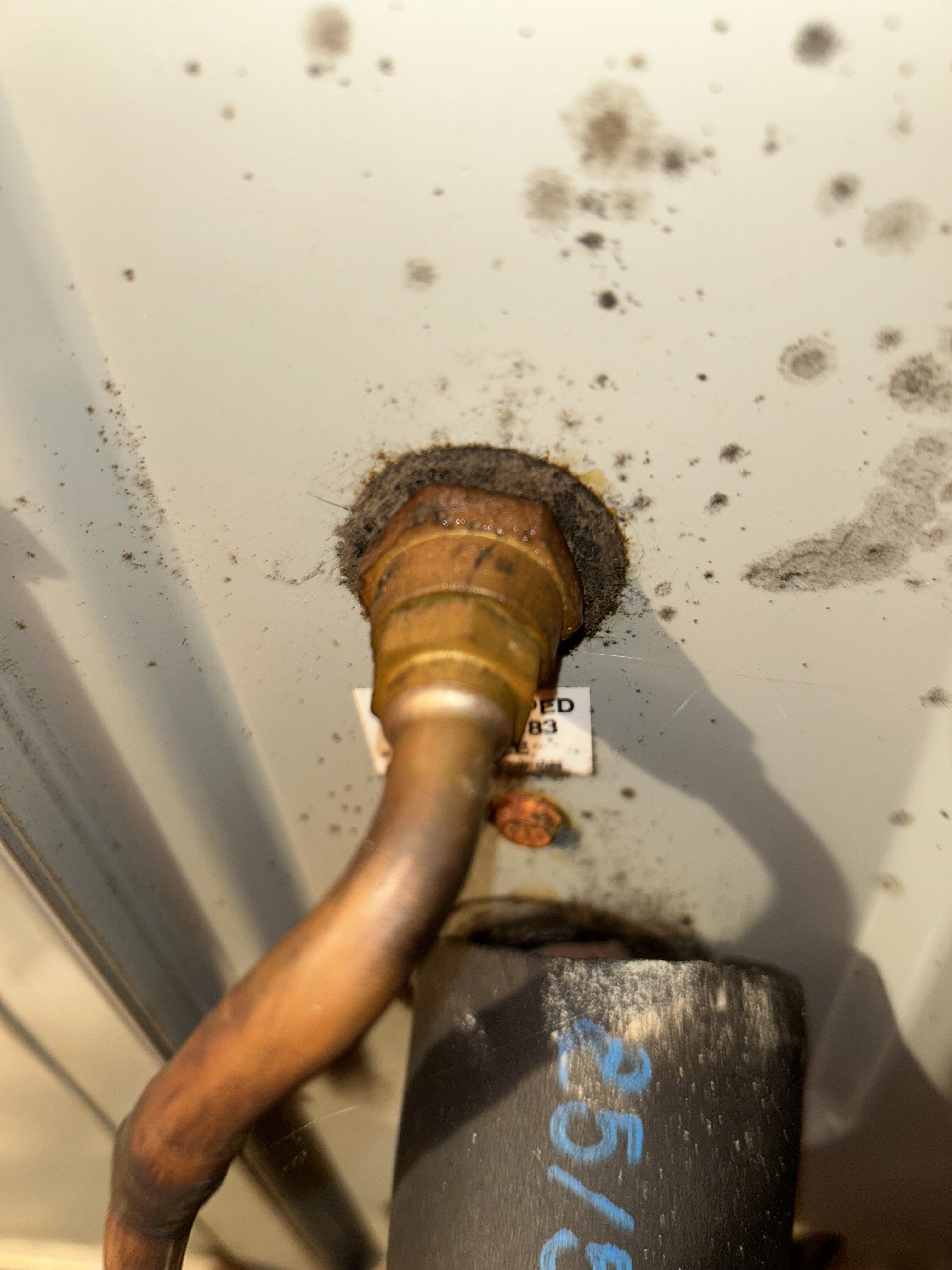

    One of the techs that had come by the other day said that the orifice entering the air handler was no longer to code. Stated it used to have a lot of issues with leaks and therefore is no longer allowed.
    I was hoping that it was the leak, but I didn't notice any bubbles around it.
    did yo spray some soap on that crusty area around the distributor?
    loamyroots11
    those tubes usually have a teflon gasket, that shouldn't leak if tightened properly. what did leak were quick connect fittings on linesets which i think went away in the 90's. i don't think they were inherently bad but frequently didn't get tightened until the metal parts sealed, the ones i have seen instructions for had o-rings to keep them sealed during piercing and had a metal seat that sealed them metal to metal if they were fully tightened.
    loamyroots11
  • That crusty area over the distributor tubing was actually frost as it’s no longer there, now it’s just normal clean copper tubing.

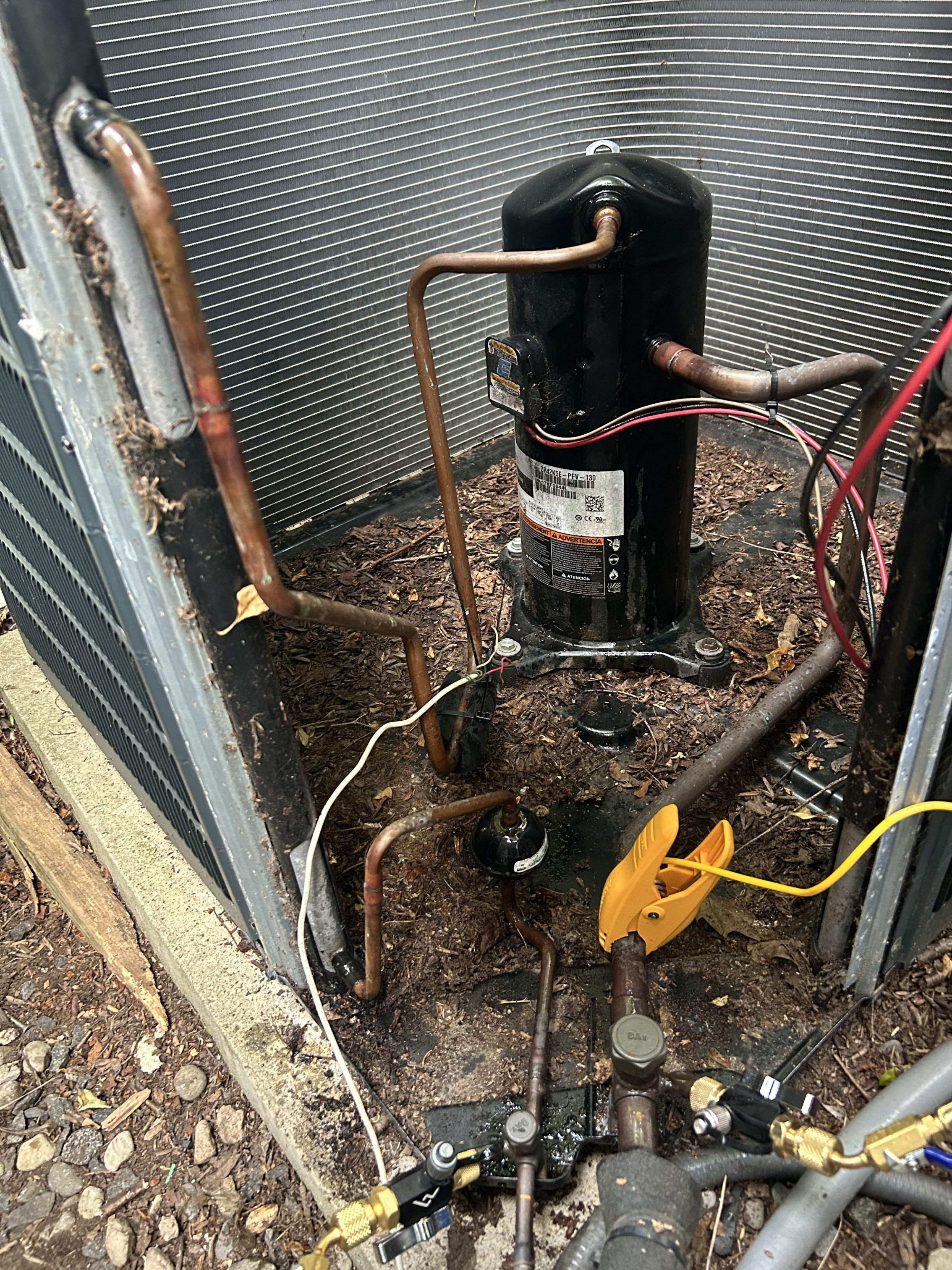

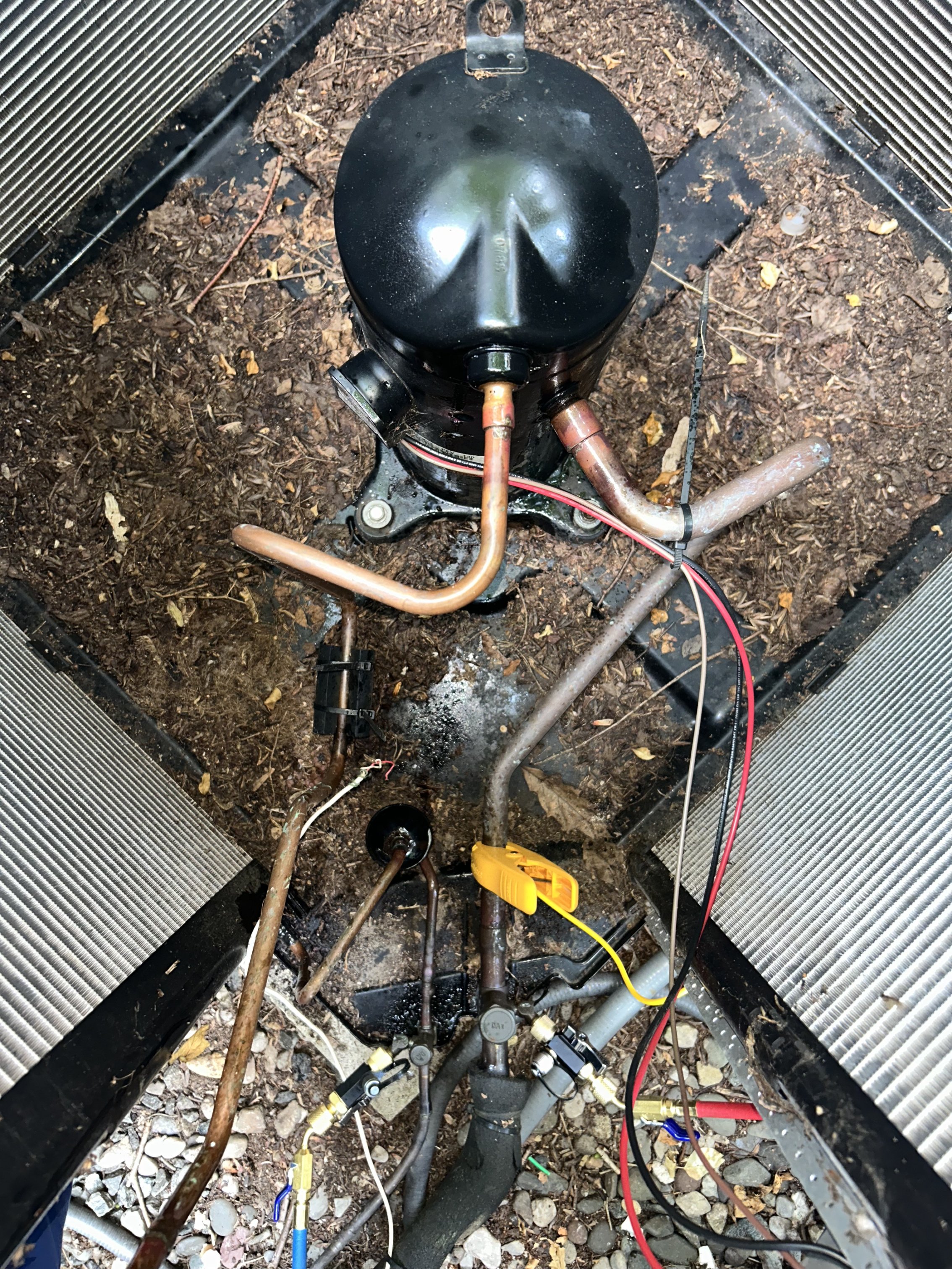

    So I pressurized the entire system to 150, however didn’t heat any obvious leaks.
    I closed off the condenser’s service valves and pressure remained constant for an hour. So it appears that the leak is somewhere on the condenser side.
    Unfortunately, I sprayed all of the connections throughout the copper tubing on the condenser side and no leaks were identified. I’m assuming that the leak must be within the condenser coil which would be unfortunate as I read that this is a micro-channel coil and therefore leaks in the coil are unrepairable.
    I can borrow an electronic leak detector this weekend to try and locate where the leak is within the condenser coil, but I’m not sure if it’s even worth the time now.

    the good thing about the condenser is that you can spray it with soap then hose it off, just spray the whole thing and you'll find it. keep it under pressure so the water doesn't get inside though it might require a good evacuation and new drier to get the moisture out now anyhow.
    i know radiator shops can seal off a bad tube in that style radiator, i bet someone has figured out how to do it with a condenser coil.
