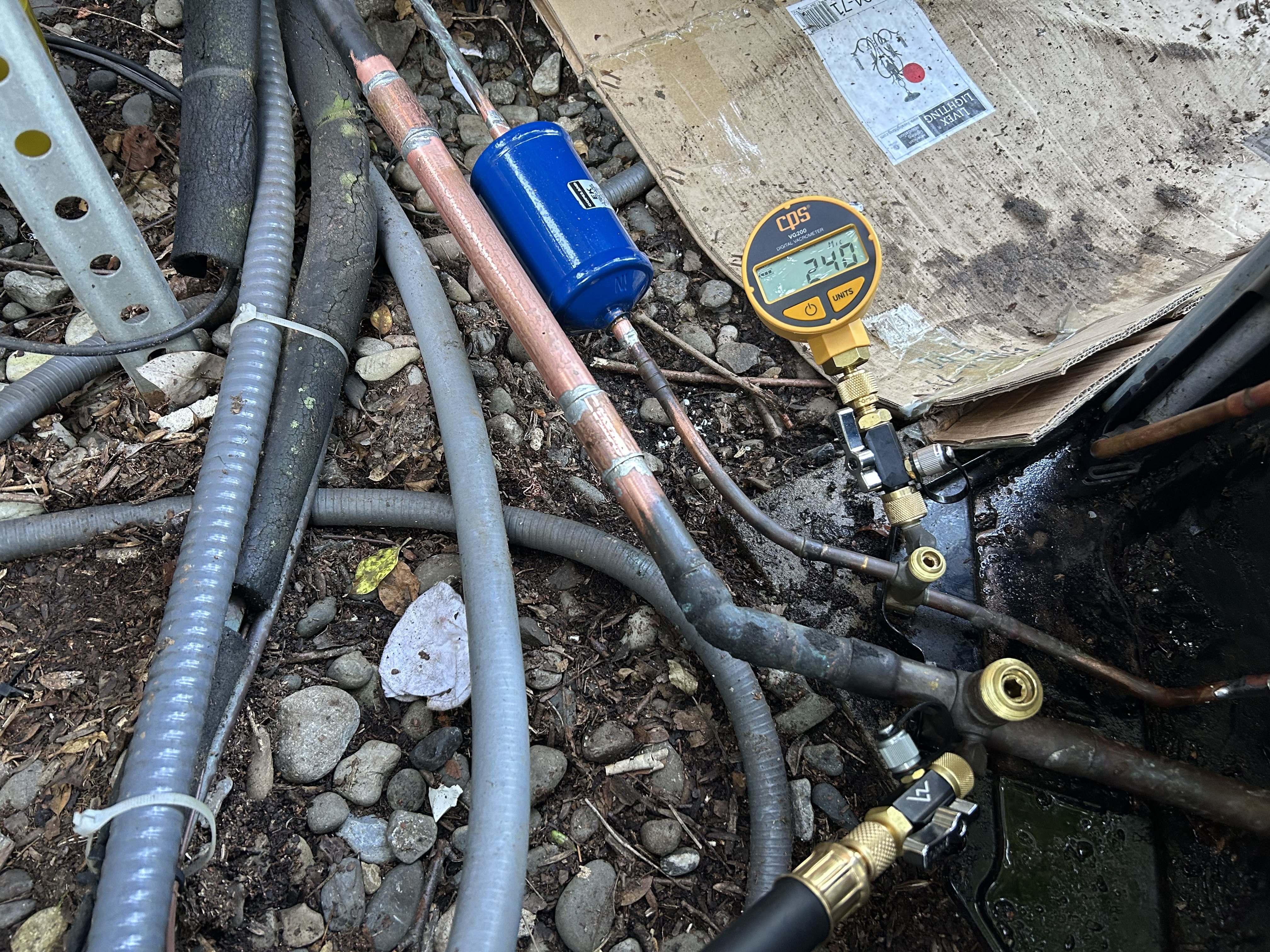

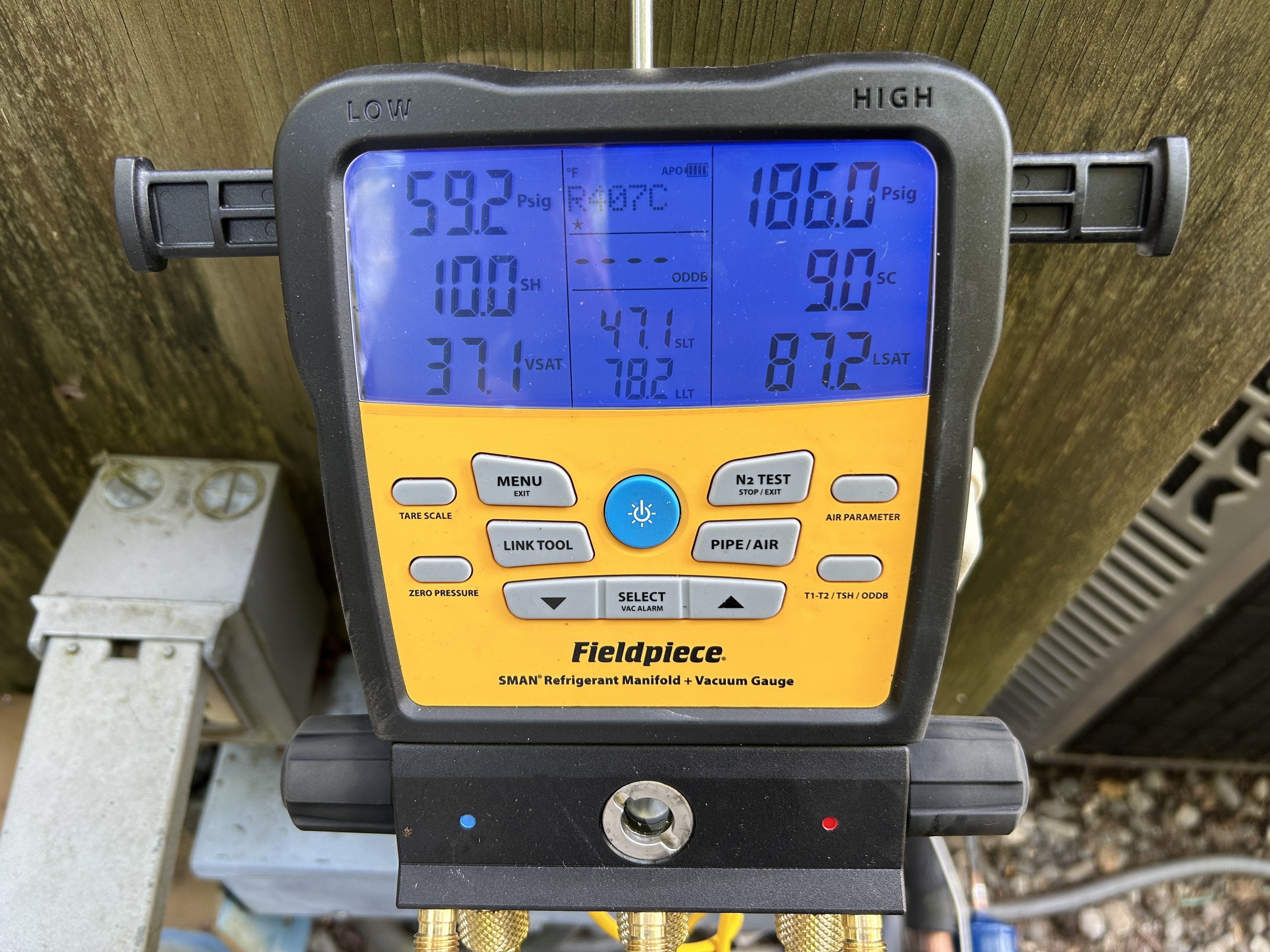

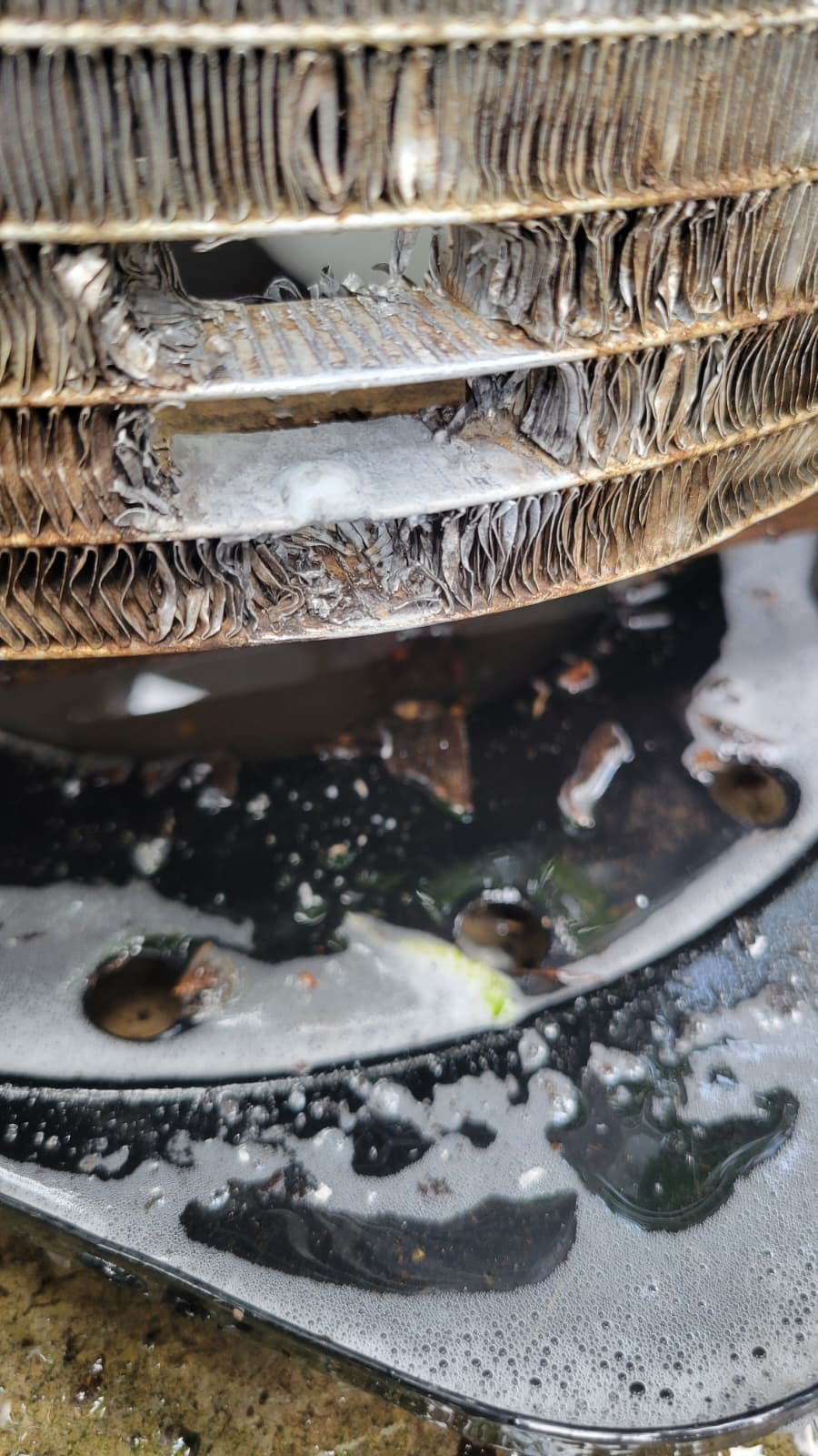

Just when I was glad I had everything up and running before this heat wave, life likes to keep things interesting.
The AC was working as of 2 days ago, bedroom would cool very well. I noticed last night that it was struggling to keep up with the temp, but I figured it was over 90 degrees out and let it be.
However today I noticed the room was stuck at 78 and wouldn’t cool to 75 despite running continuously. If anything it went up a degree to 79.
I went outside to check the condenser worried that I would see icing. Instead didn’t notice any freezing of the pipes, however I noticed that the outdoor condenser fan was blowing cold air rather than hot air.Quick online searching leads to either an issue with the capacitor, compressor not running, or low refrigerant. Will have to do some diagnostics tomorrow, luckily we get a break from the heat over the next few days.
it will usually cycle if it is the capacitor. the compressor will try to start and trip the overload after a couple seconds then after a minute to a couple minutes the overload will cool and it will try again. it will usually click when it trips and when it cuts back in. usually will see the lights dim and hear it hum when it tries to start and fails. looking at the indoor coil will tell you if it is cooling some, if yo don't see at least some of it sweating there's no cooling.
1 -
Most likely a capacitor issue. they seem to be the weak link on most compressor problems. I like to use the Turbo 200 or the Turbo 200x because they have a 5 year warranty. I believe they are a good quality capacitor and will last longer than the OEM capacitors. Remember the lowest bidder was the capacitor supplier for your equipment manufacturer.
