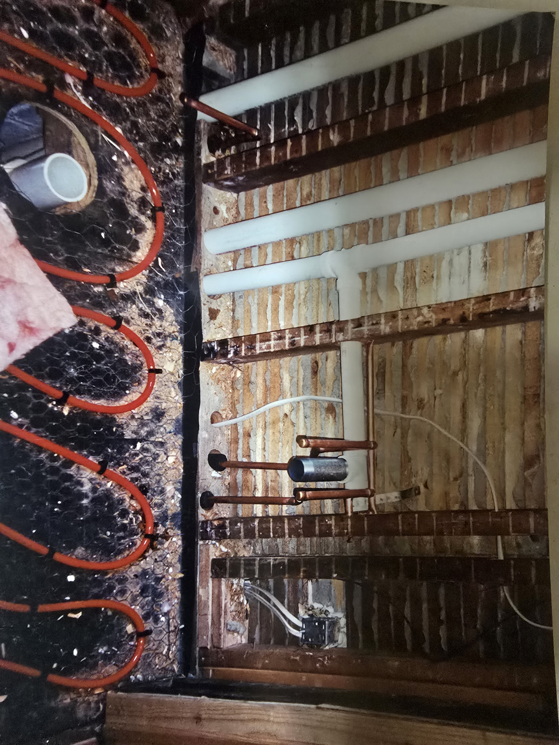

A pic of cell core PVC

Cell-Core PVC looks exactly like regular PVC, just much lighter in weight. Mad Dog

Foam core is a reference to manufacturing process. Solid and foam core look alike and perform very similar. With exception of weight and labeling, cannot tell difference through examination even on cut surfaces.
Due to lower density foam core transmits sounds more readily. I’ve also seen boiler specification that said foam core PVC cannot be used for venting applications.3 -
