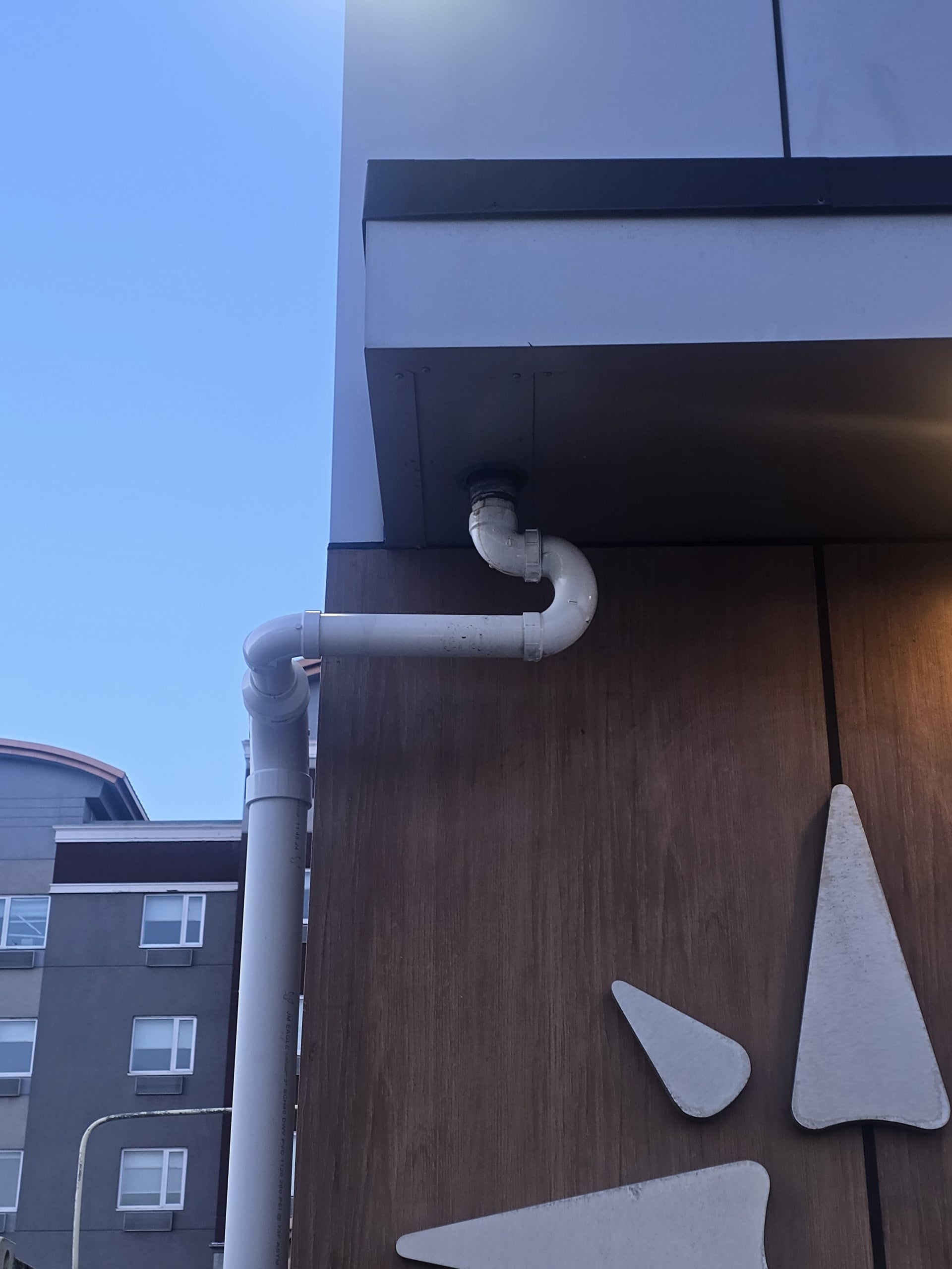

    Actually, it takes alot of practice with PVC to make it look good. You only have a short window of time to make sure everything is pitched correctly, skewed at the correct angles before the glue sets…Mad Dog

    Is that removable joints? Mad Dog
    mattmia2 Member Posts: 17,904
    I make marks to line up when I glue it. Sometimes i even manage to not remove them with the primer.
    PC7060
    hot_rod Member Posts: 28,078
    I don’t think so, I watched their video and it did not address removal
