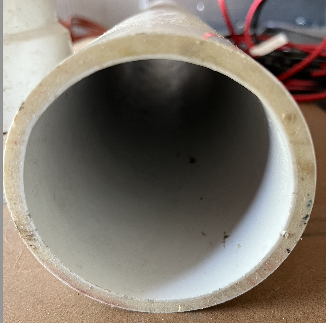

that is thinwall pvc, right?

I have 38 year old pvc in my house that looks like new on the inside.
