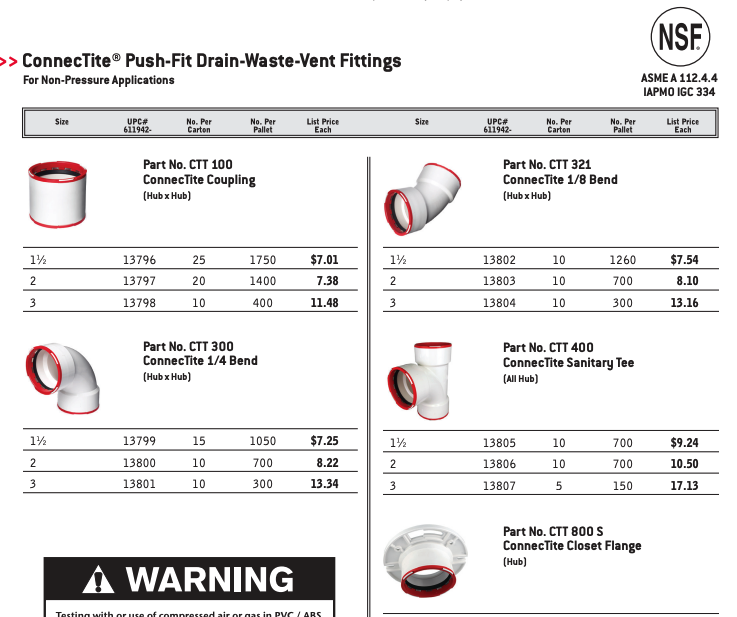

I don’t think so, I watched their video and it did not address removal
