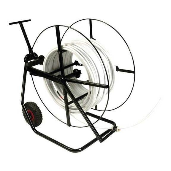

We started pulling the pex in today. We have about 2/3rd of a loop in and the tubing is getting some twists in it. What is a good strategy for dealing with that? We have staple up plates to go over it and thought we would stop pulling it in and start chasing it with the plates.
The pex is legendflex 1/2" from legend valve. It's a 3 layer pipe with the oxygen barrier covered with another layer. It does bend a tight radius and we are not having even a hint of kinking with it.

    You have to hold the pex in one arm & flip it as you go. You'll feel it fighting you as it goes down...that is the time to flip it. Mad Dog
    skyking1Intplm.
  • psb75
    psb75 Member Posts: 1,054
    Its easiest if you keep the roll of pex on an "unsspooling" reel. Rent or buy one, or make your own. The pex should NOT have any "stored twist" in it as you put it in place.
    skyking1EdTheHeaterMan
    Jamie Hall Member Posts: 26,234
    This. Never lift it off the coil — always unspool. This also goes, by the way, for electrcial wiring… rope… cable…
    skyking1EdTheHeaterManPeteA

    You can keep your spools & uncoilers...Ive used them all. Prefer my own arm...Done small and larger radiant & snowmelt jobs this way. Mad Dog

    Rent or borrow an uncoiler, it makes it much easier to work the pex.
    In a bind to do my own shop, I threw together this uncoiler. I made this with my shop stool and a bucket.
    Getting and keeping the pex warm helps a lot, even out in the sunshine for an hour makes it easier to "loop"

    A coupling or two is not a big deal. If you can use and expansion type coupling, I doubt you could even notice any pressure drop. Watts/ Heatway used to sell spliced Entran at a deep discount. The couplings were sealed under a shrink sleeve.
  • JMWHVAC
    JMWHVAC Member Posts: 83
    An uncoiler is NOT needed. We got rid of ours long ago. Pull off several coils, flip the roll, now the coils will be coming off the opposite side of roll and will "cancel out" the coils from the other side. It is the same principal as reverse wound boxes of wire. Most times I only flip the roll approx every 50 feet of tube but each person needs to find their way.

    The first snowmelt we did, the Rep put 3!!!! Uncoilers on the material list. They were NOT happy when we cut the fat outta their Golden Egg list...ha ha. Mad Dog
