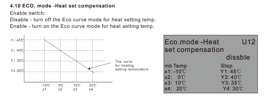

  • skyking1
    skyking1 Member Posts: 83
    I was not "chucking it in" I was going with a single source of information I fixated on. Radiantec uses staple up plus the foil plus the insulation method. I read all their info and was fat dumb and happy with it. Now I feel I have a better handle on it thanks to this site. I think the money up front for good heat extraction will pay dividends on lower SWT and higher efficiencies.
    The heat pump is an inverter unit and I think it will run an ODR curve very well indeed.
    ODR curve was just one bit of new information I picked up here.
    I found this in the manual and if I can tweak the graph points it will do what I need.
    I can work with the X-axis values as they are. My heating temp is 23F so -10 C is not terribad.
