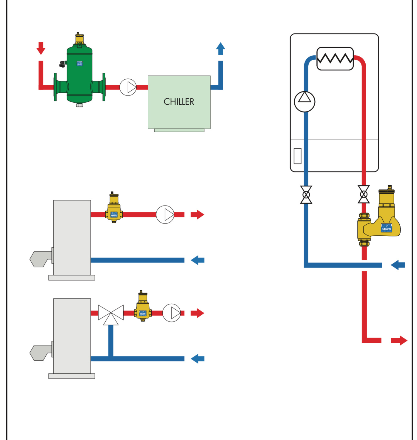

    I don’t see any air purger? Also have him support the expansion tank a bit more.
    When it fires from a cold start, time how long it takes to get the return to the boiler to 130F. You want that to happen within 10 minutes, ideally
  • where would the purger be located? It doesn’t fire from a cold start the low setting on aqua stat is 130.
    hot_rod Posts: 28,197
    an air purger would be best right at the boiler on the supply piping. For best heat transfer in the boiler, and in the radiators you want a completely air free system, micro bubbles and big bubbles.

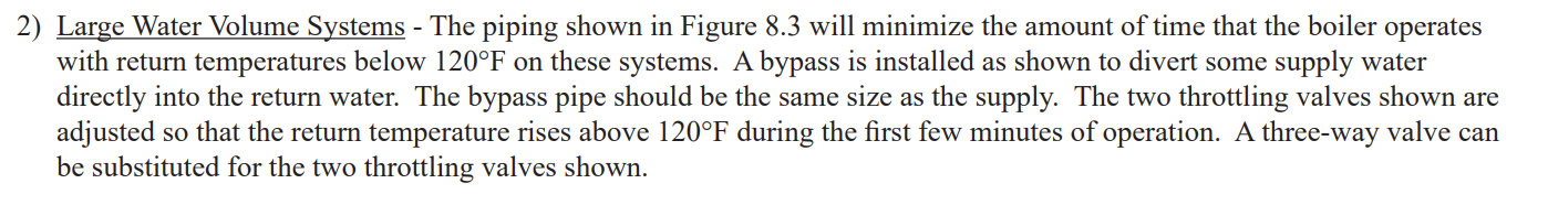

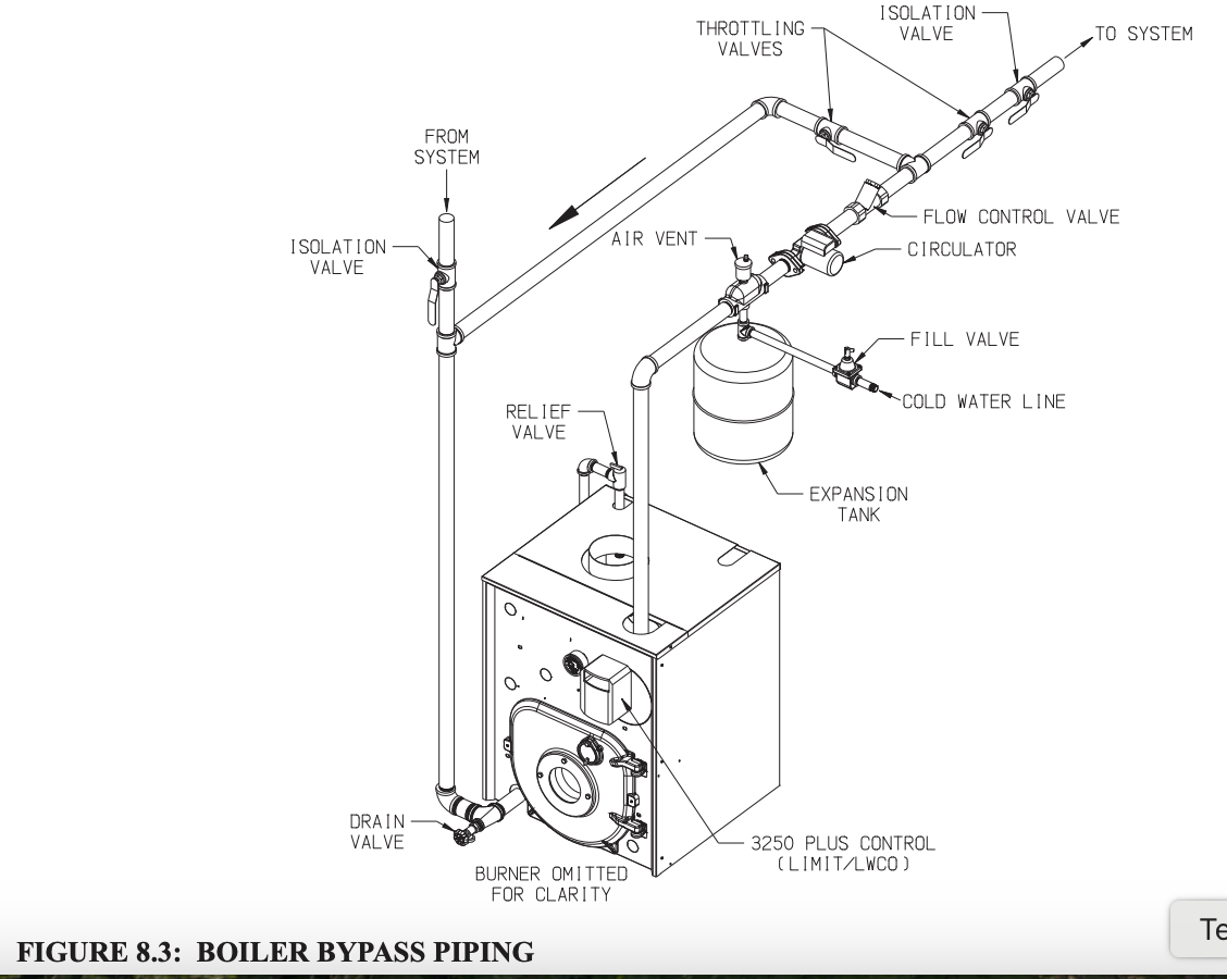

    @jakamini I stand corrected, there is no bypass plumbed in as I erroneously said. One of your photos has two pipes lined up one behind the other, and my eyes fooled me. The horizontal branch of the copper pipe coming vertically out of the top of the boiler is going to another supply main, not the return pipe behind it.
    The boiler installation instructions probably do call for a bypass. However, I have two Weil-McLain WGO-5 cast iron boilers that also were plumbed with no bypass, and they have run for 30+ years with no sign of condensation, even with low return water temps, most of the time sub-130 degrees.
    So if I were you, I wouldn't sweat it too much. On a call for heat, your boiler should run from a cold start at least 30 minutes at a time, during which time the flue gas will get plenty hot to burn off any initial condensation from startup, regardless of low return water temperatures.

    The installation instructions show a bypass and explain why it is needed. However..

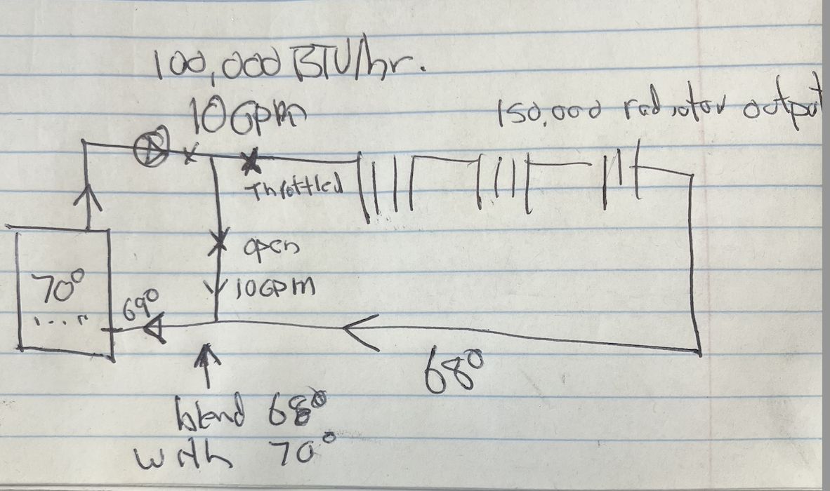

    That boiler could run hours in condensing mode if the distribution piping and the cast radiators are more emitter than the boiler can keep up with. Thermal equilibrium is at that low RWT.
    For example the return water may be 68° when a call for heat A properly sized boiler could maybe "lift" that temperature 5° or so. That indicates the boiler block is running around 70.
    Assume 10 gpm is being circulated. There is no way a bypass, even full open can raise to boiler to 130° if the boiler can only make 70° water.
    That is why the bypass needs to have a thermostatic function. Could be the aquastat as @kcopp mentioned, or a thermostatic valve.
    Two ways to confirm this. Calculate the radiators output, EDR. Or watch the boiler when it fires up, time the cycle, measure the return.
