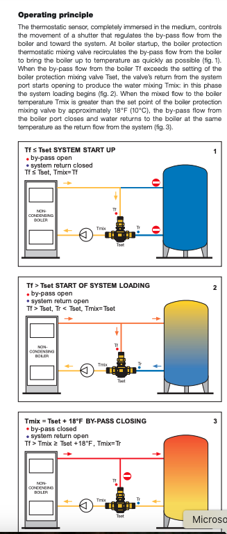

There is an approximately 18° hysteresis. So with a 115° element + 18° = 133° for the bypass to close off 100%
With a 130° element it takes 148° degree return to shut the bypass.
Living the hydronic dream1 -
In my system I have temperature sensors on the supply and return to the boiler return and supply pipes.
Spot-checking these, I rarely see the return temperature get up to 133F - which means that most of the time, the system is running with the valve only partially open. I must admit that initially this was a point of concern for me, however in practice it seems to work quite well. There has been no issue whatsoever in keeping the house warm.—Eric
