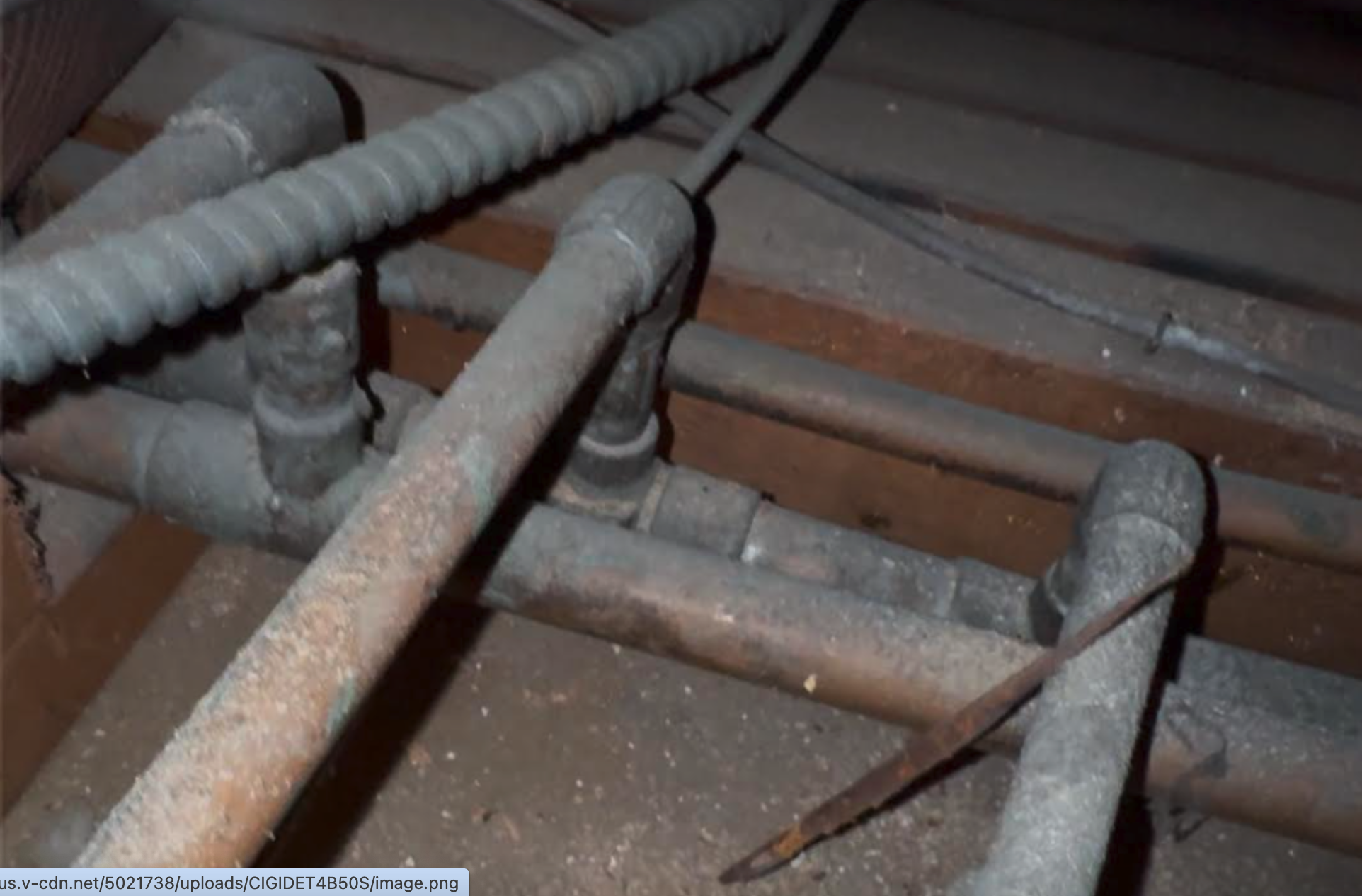

    this are the type of radiators that i have, i dont know how to get the EDR but i found the following
    6x 8sections - BTU @ 180°F: 3,056
    5x 16sections
    1x 36sections
    i check the expantion tank its 12 PSI, and my system is also at 12 PSI.
    my system looks like the one-pipe monoflo design that you suggested. i did not see those fittings that you showed me. instead i found the following. its not very clear. BTW i have two systems, its a 2 family house. i have to boilers, one boiler for the basement and 1st floor (12 radiators), and the other one for the 2floor (9).. thats why you see 2 pipes.. i believe this pipes are returning.
    its hard to tell since the house was build 1960, I'm going to try to take a better picture tomorrow.
    i think some of them look like this
    Thank you for the help

    EdTheHeaterMan Member Posts: 12,271
    You have the Diverter Tee system commonly known as Monoflo® (the same way the Royal brand gelatin, is called JELLO).
    Screenshot 2024-11-06 at 10.02.47 PM.png Screenshot 2024-11-06 at 10.39.57 PM.png

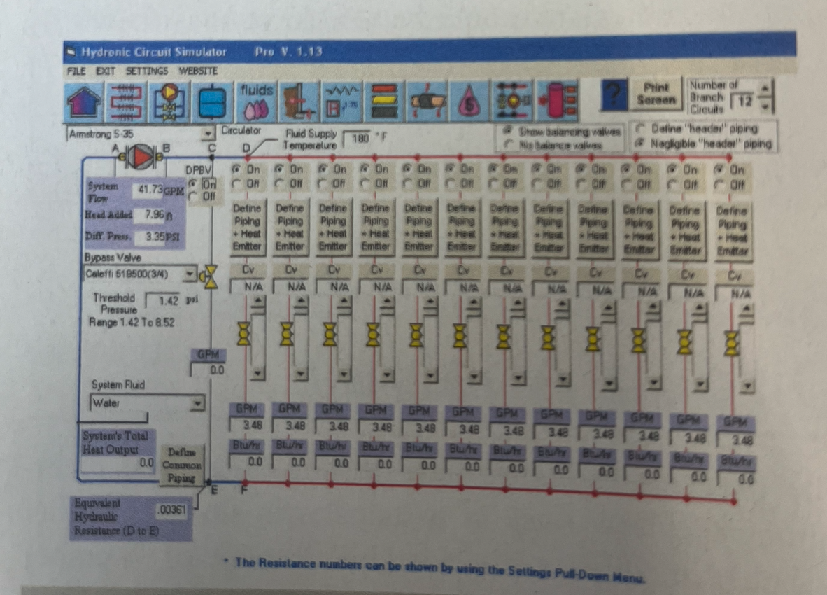

    Also a monoflo piping has the heat emitters in series, so the radiators at the end of the loop will see a much lower temperature
    There are quite a few steps involved in designing a diverter tee system. Modern Hydronic is a textbook with a chapter on the design of these systems.

    The Hydronic Design Software, circuit simulator, make this calc simple. Try the free demo at www.hydronicpros.com

    The unknown is still the size of those divertor tees?
    The branch looks to be 3/4? So the trunk is 1", which means 8 gpm or more will flow that loop easily. So 80,000 BTU/hr at 20∆.

    I really hope you are correct. However, the size of the BX tends to indicate otherwise. The photo is very deceiving.

    i didn't measure the pipe. i forgot. I only changed the pump to 0010. but the weekend in NJ was warm. i didn't turn it on. until last night. it seems i didn't purge the system correctly. i have air in the pipes this causing the radiator that was finally getting warm on my previous purge to be cold again. such a difficult system to drain. btw that pump is noisy lol
    0011
    my boiler had a B&G pump, which one was it i don't know.. it was changed to a 007. but it was not doing the work right. i order a 0010. but when i return it amazon told me it's not returnable item, but they gave me back the money. so 0010 its free.. my intensions were to get the 0011.
    MAIN LOOP 3/4 - PURPLE - (SAME LOOP FOR BOTH FLOORS)
    BRANCH 1/2 - GREEN
