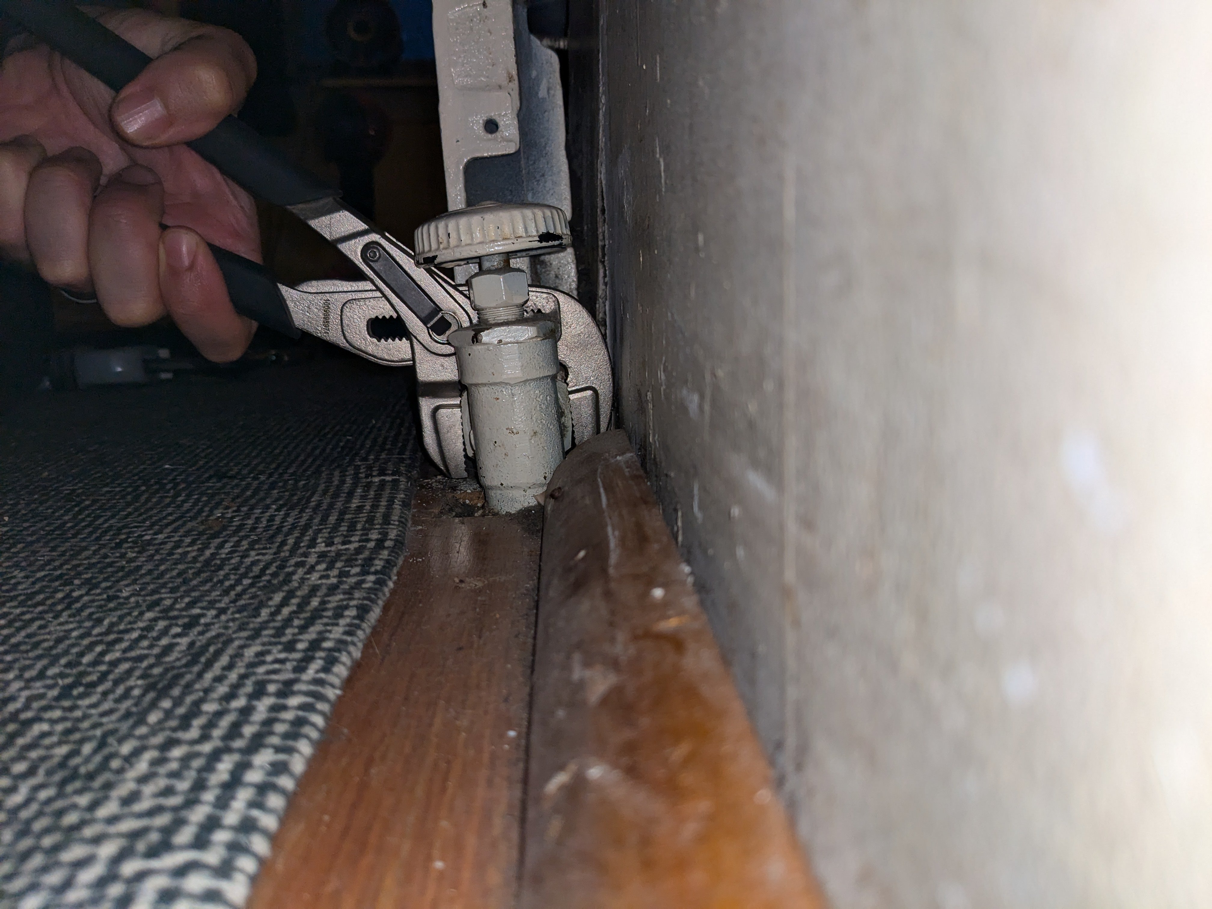

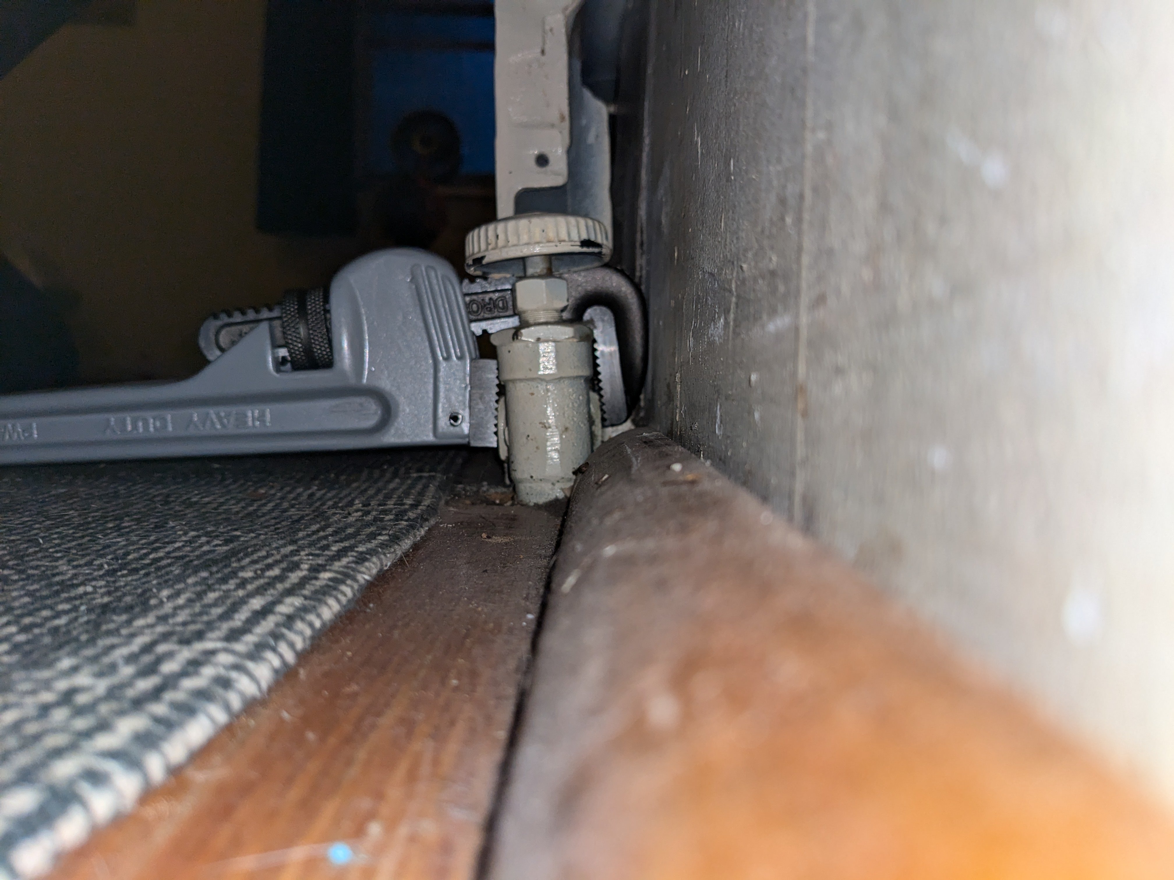

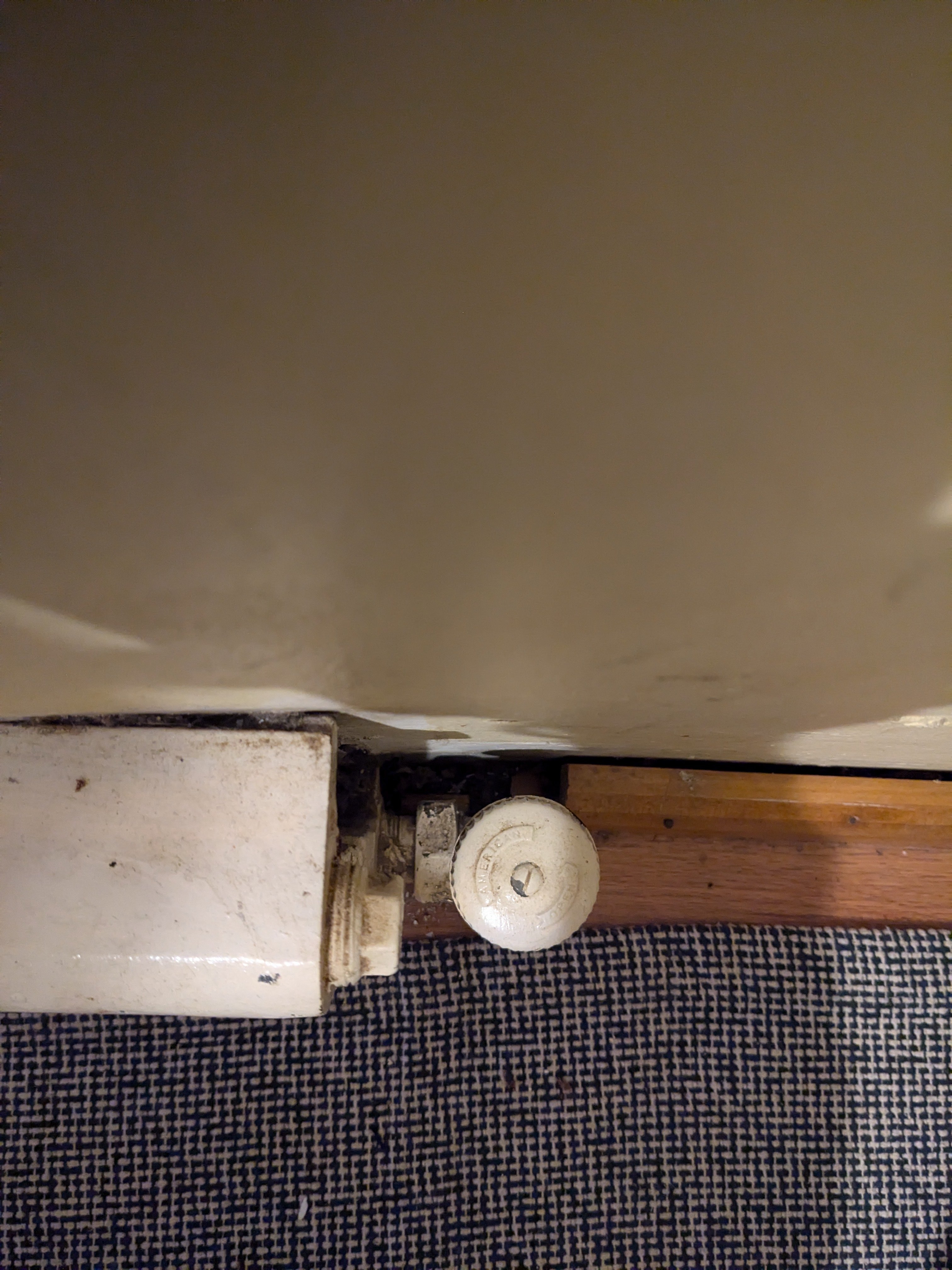

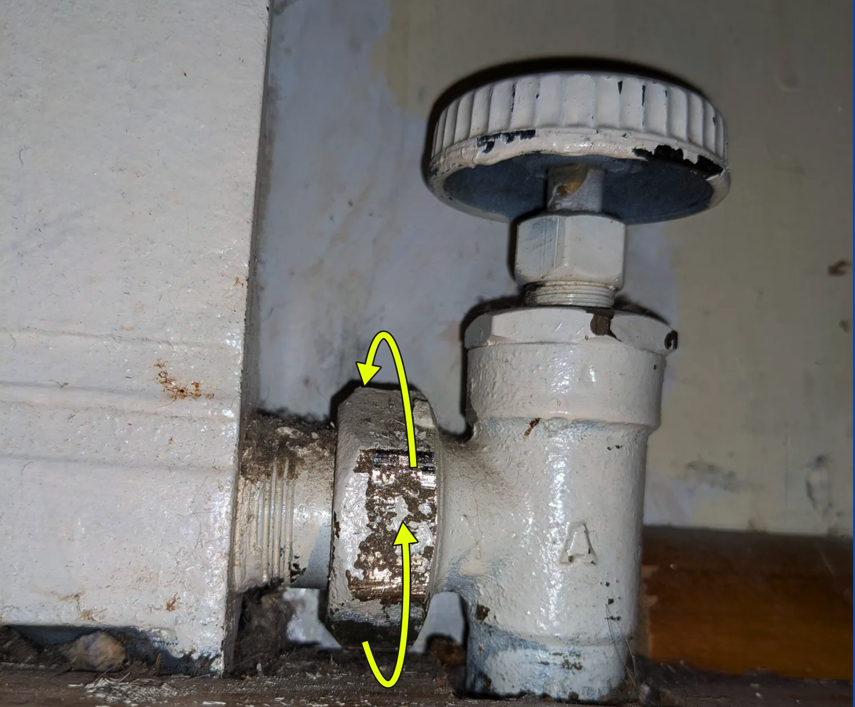

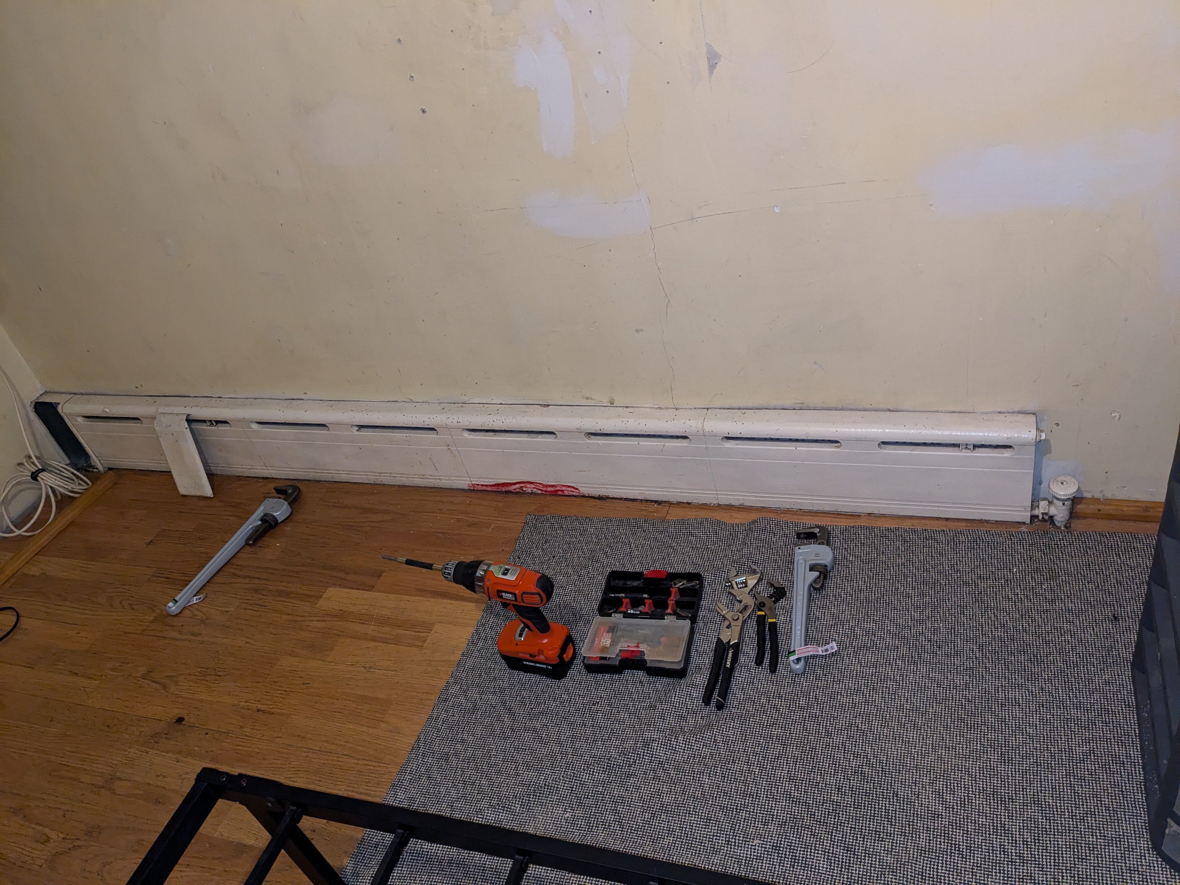

Hey there Heating Help,

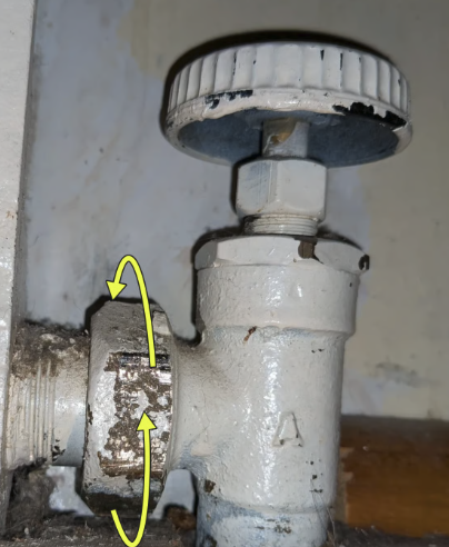

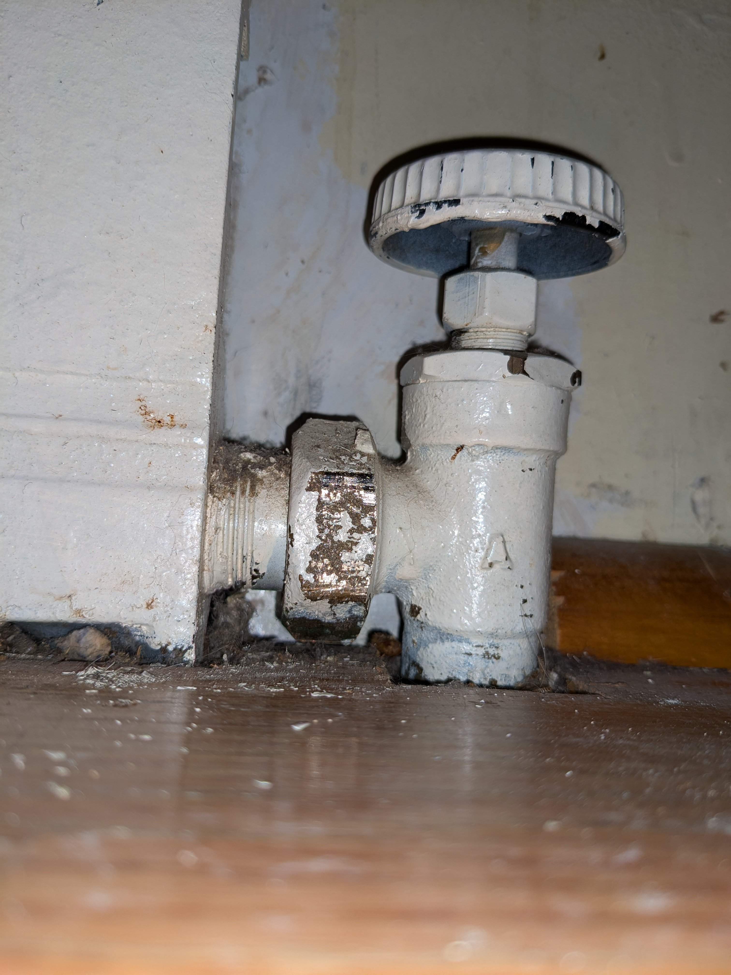

I'm learning a ton about the radiant heating system in my home through this site, and tackling my first project that requires me to touch the system. I'm currently remodeling a bedroom, and need to pull out the base-ray cast iron baseboard radiators so I can redo the walls, floors, etc. I was able to drain all of the water from the boiler drain valve. Now I'm trying to remove the unions at the baseboard inlet/outlet. The piping is very close to the wall (unsion is about 1/2" away from the wall). My pipe wrench has no space to turn at all. I was about to run out to the store to see what my options are, but I figured I'd ask here. Is there a special wrench that you all use in these situations? Or maybe another approach that I'm not aware of to remove this baseboard? Images below for context. Please feel free to correct my language if I'm using the wrong terms. Thank you for an awesome, very helpful site 🙏

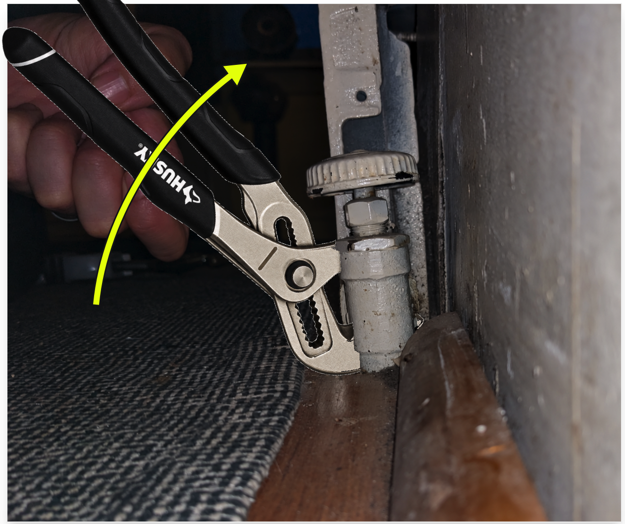

First of all it appears that you have your pipe wrence set to tighten the union nut in your photos. the union nut rotation for that valve is to go UP on the side facing you and DOWN on the side facing the wall
If you don't have a flat jaw wrench that will fit that nut, ChannelLoc makes a thin jaw that opens wide enough for that nut.

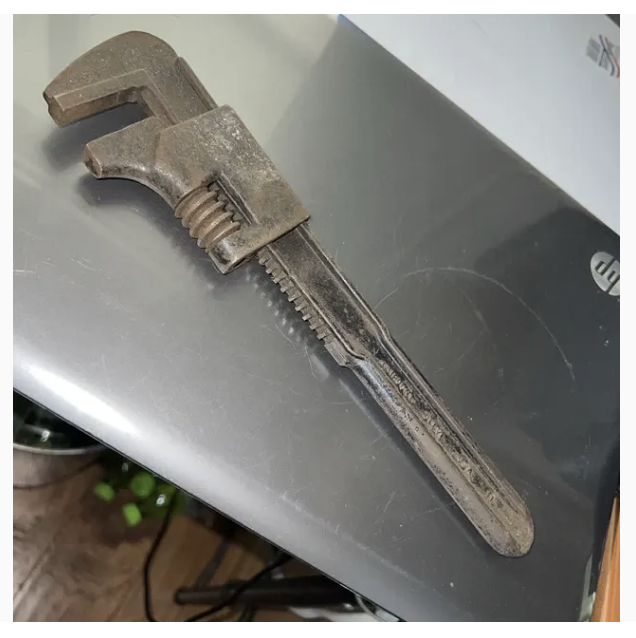

There are older flat jaw wrenches that were commonly used for that purpose.
This has a thin jaw to fit in that tight space. Some old man with an old tool box has one in his garage near you if you can find him.

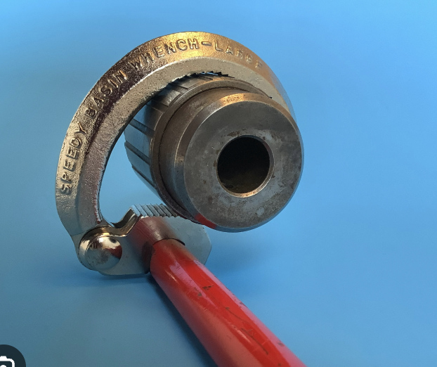

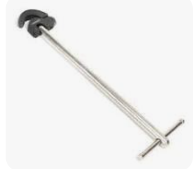

A basin wrench is another option

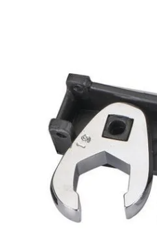

Crows foot

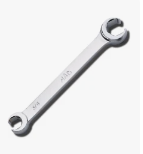

Flare nut wrench

The tool you want is called an angle head open wrench.
Anything other than a wrench with fixed flat jaws will make a mess of the nut, it's soft brass. The angle head wrench has two heads, each angled and each at a different angle. Since you can flip it over there are four possible angles, one of them will work. You move the nut a little, then move onto the next head. After a bit you've moved it 1/6th of a turn and you go back to the first one.

All of the above. I'm not in favour of Crescent (adjustable) wrenches, unless they are very good quality. As @EdTheHeaterMan notes, the threads are on the valve part of the union, so you are pulling up and pushing towards the wall on the wrench handle.

The nut to floor dimension is what limits your wrench choices. A cresent that opens that large may not fit around the nut?

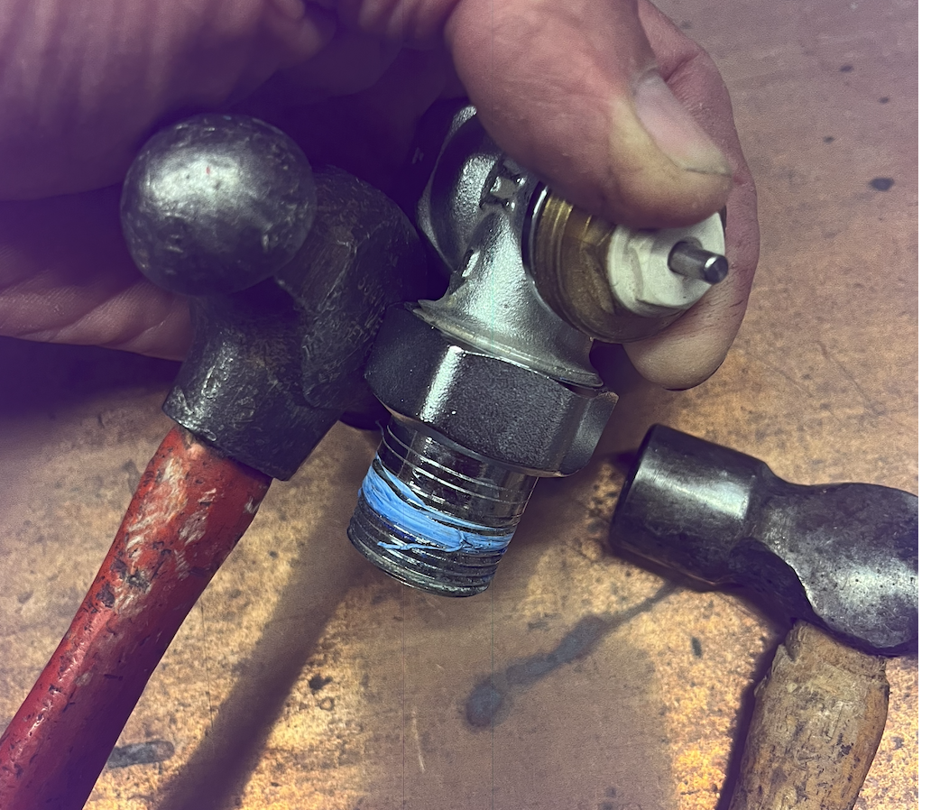

Tap around it with the two hammer method, or warm it with a heat gun, and you probably unscrew it by hand :)

@hot_rod you're correct about the nut to floor clearance. It's only about 1/4", so that's very limiting. For the two hammer method, can you point me to a link? or explain what that is?

I'll go to the store and check these out to see what feels feasible, or see if a friend has any of these tools. Another option, since I'm already doing this, is to take out the flooring and drywall first, to create more clearance around the nut, but I was hoping to just get the baseboard out before demoing the room.0 -
I agree with @hot_rod tapping a union with a small hammer will break the paint and rust loose and make it much easier to break loose.

Unless you happen to find a super heavy duty Basin wrench I bet you will turn a common Basin wrench into a pretzel before you ever get close enough to loosen that nut.

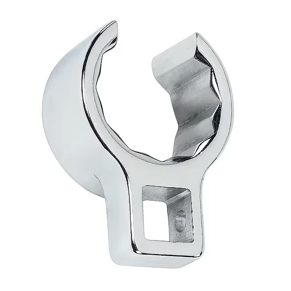

I'd use this type of Crow foot, not inexpensive for the larger ones and you would need the long breaker bar too.

All the tools are great. Just remember to push toward the wall when loosening. Push down toward the floor when tightening.
Came here to say that. To me it looks like you have the correct tools on hand. good luck and have fun.
Two hammer method. Hold one hammer tightly against the nut opposit6e them "backing hammer.
Tap lightly with the other. Every face if you can. This lossens and slightly expands the nut. Usually you can unscrew by hand.
Works on rusty nuts and bolts also.

I have found that somtimes there is a little give in the connected piping and you can actually lift the radiator 1/2" to 3/8"… just enough the get a wrench you already have in the correct position to loosen that union nut.

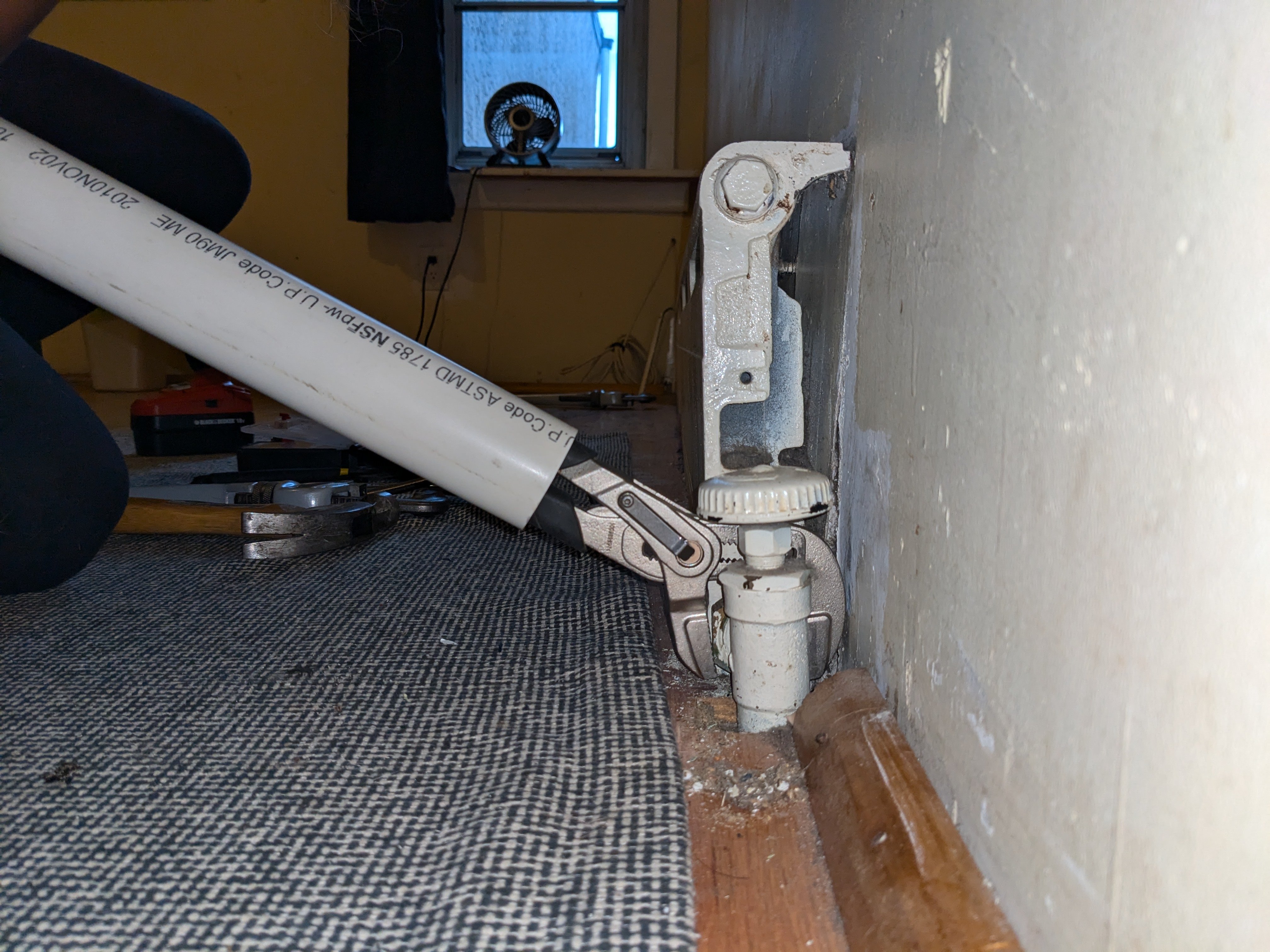

Just to give the follow up, I was able to loosen the nut with pump pliers and a cheater bar. I also tapped it with the hammer a few times beforehand. The stars aligned, and I had this 2' piece of PVC that fit perfectly snug over the pliers handle, and had about 1/4" clearance to break it loose. Then I was able to get the rest with just the pliers. Saved me a trip to the hardware store. Thanks for the replies everyone!

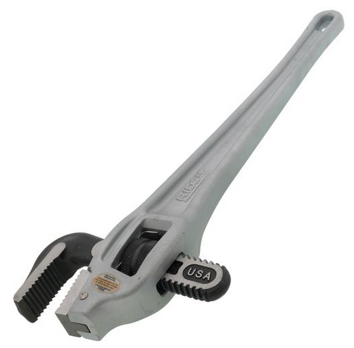

https://www.reedmfgco.com/en/products/wrenches/pipe-wrenches-heavy-duty-45-offset
https://www.reedmfgco.com/en/products/wrenches/aluminum-pipe-wrenches-heavy-duty-90-offset
Any of these style wrenches would work
