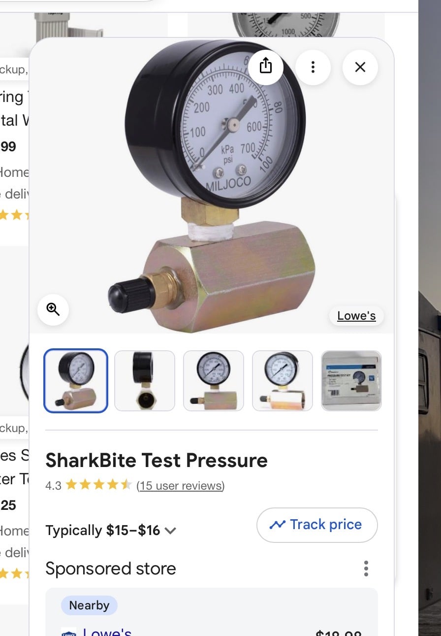

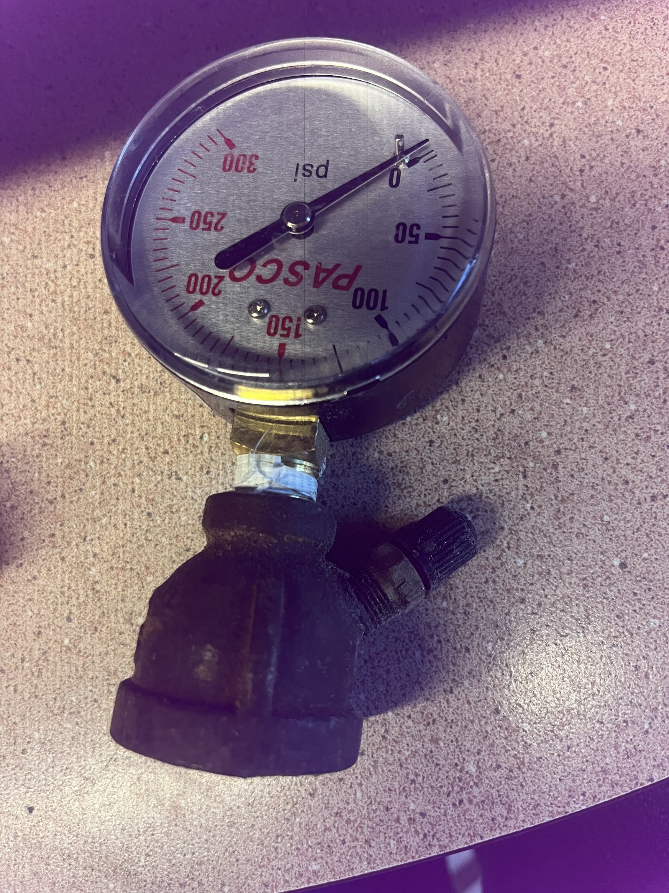

A test block like this may be the simplest, unscrew the expansion tank and install it there. If you can’t isolate the boiler get a 30 psi version of this and stay below that 30 psi relief setting.

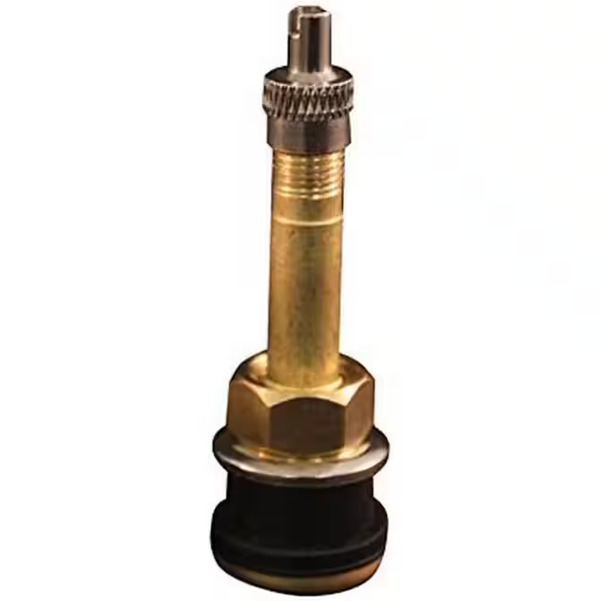

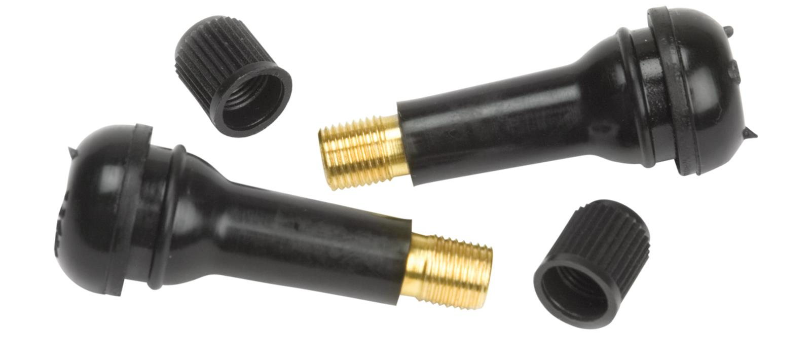

OK now you got me thinking. How about this. Take a cap and drill it. Put a valve stem in it. You can pick one up at any auto parts store. Place the cap on a nipple that will fit the pressure relief valve. Lift the lever on top of the relief valve and add some air. The aqua balance furnace has a pressure gauge on it. And i think I can just tighten the cap on the air separator to keep the air in the system. Bring it up to pressure and see if the pressure gauge on the furane drops after a few hours. Maybe let it be over night. No rush at the moment. And the expansion hasn't been installed yet so a cap on the nipple coming from the air separator.
you can get a test gauge that will screw on to hose thread that you can screw on to a boiler drain. you can also drill a hole in a plug and solder a schrader in to it, possibly one that you salvaged from an old innertube and stripped the rubber off of.
" Take a cap and drill it. Put a valve stem in it. "
Interesting idea. 29/64" or 0.453" or 11.5 mm.
There is this style too, more sturdy used for LT tires / wheels

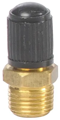

Also schrader valve to 1/8" NPT, at NAPA Autoparts stores and maybe also Harbor Freight.
1/8" NPT
