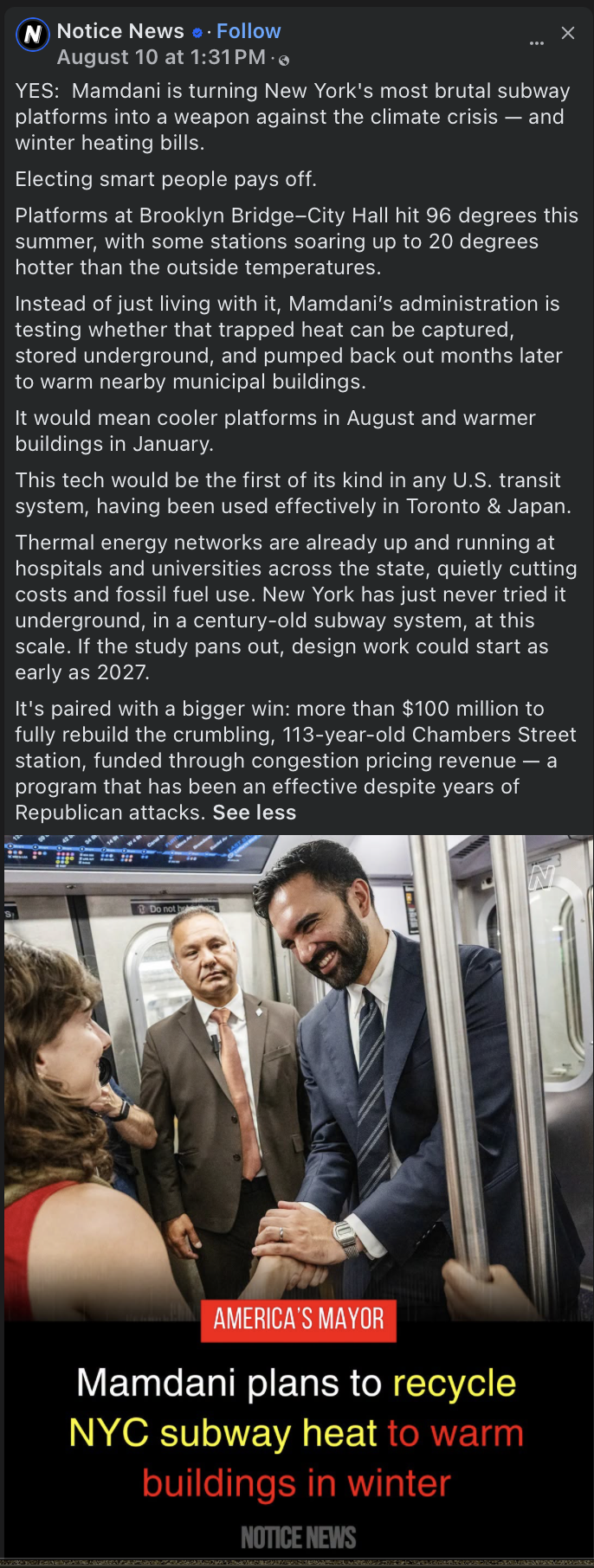

Does this sound viable?

    "Mamdani's administration is testing whether that trapped heat can be captured, stored underground and pumped back out months later."
    That sentence doesn't describe a ground source heat pump. With a ground source heat pump, the goal is not to store heat, it's to disperse it.
    Although I'm willing to accept that the person writing the press releases may not have a grasp on the technical details.
    If what they're talking about is a ground source heat pump, that's hardly new technology. Not saying it's a bad idea.

    The tech they are employing isnt new, and its not a GSHP, though it makes sense to describe it like that for simplicity, they would call the geo portion a geothermal network (its thermal storage), i don't think actual heat pumps are involved though. You see these usually on an institutional level, I think you need a large load like multiple buildings or a subway network to make it worth the time. The big claim from NYC is nobody has done this in a subway before, which imo is not really that important, and as someone that doesn't ride the NYC subway I will leave it to subway riders to decide if its too hot in the tunnels or not.
