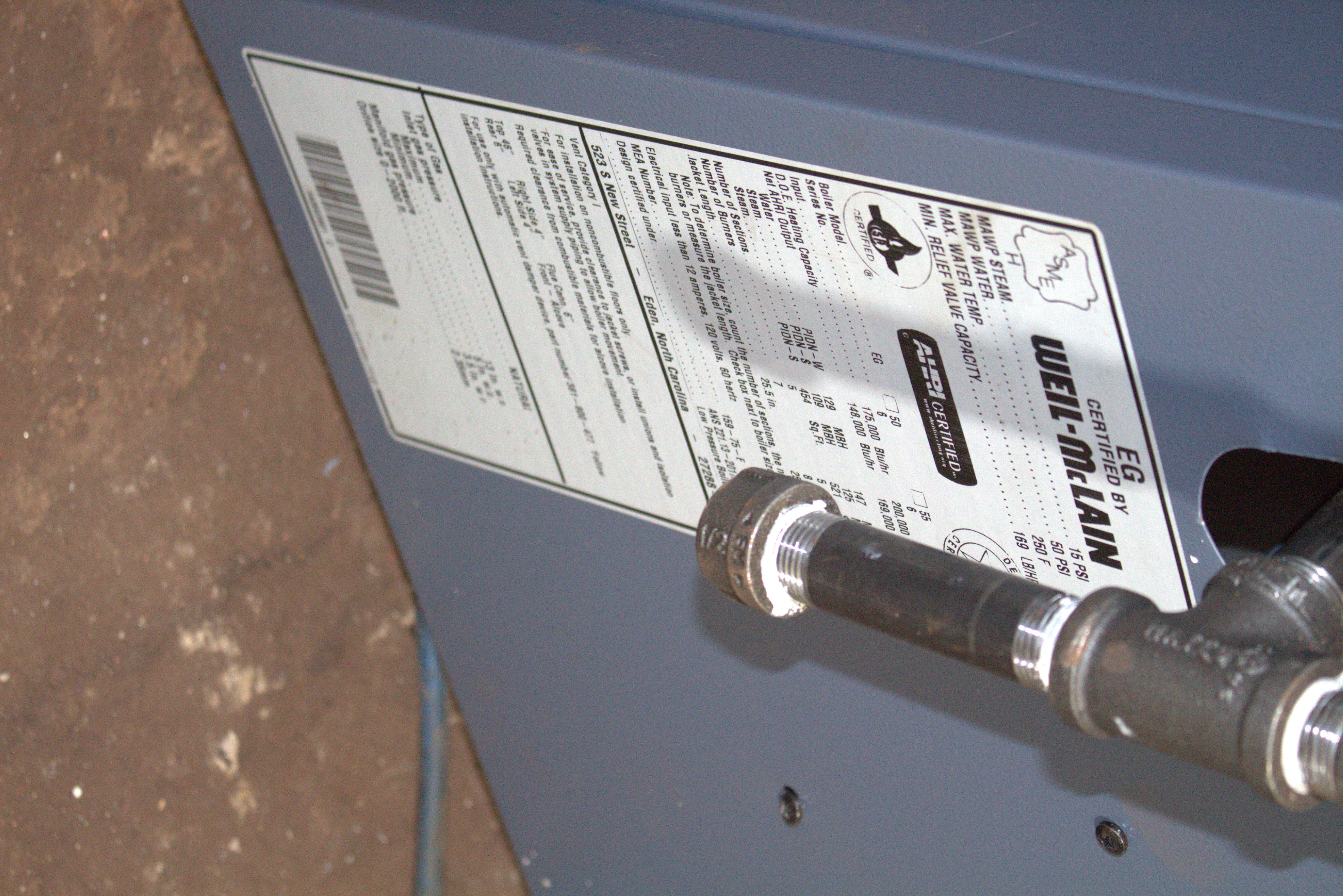

I just had a new Boiler put in, a Weil McLain Series 6 EG 50 or 55 box wasn’t checked don’t know which for sure.

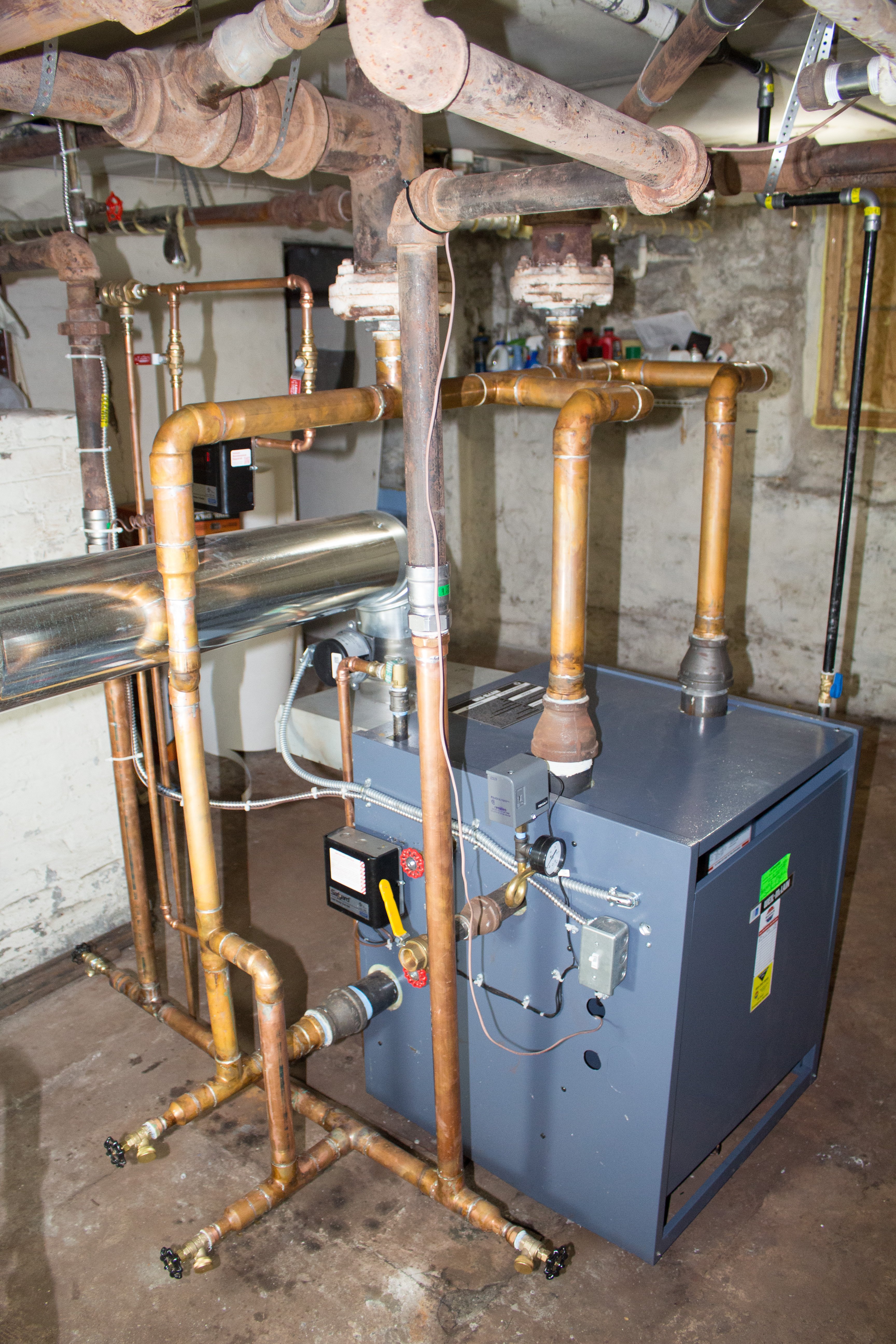

The system is a 1 pipe counterflow system with no mains (each run goes directly to one or two risers which lead directly to a radiator.) There are no main vents or riser vents. (keep being told dont need them)
The new near boiler piping is in copper…

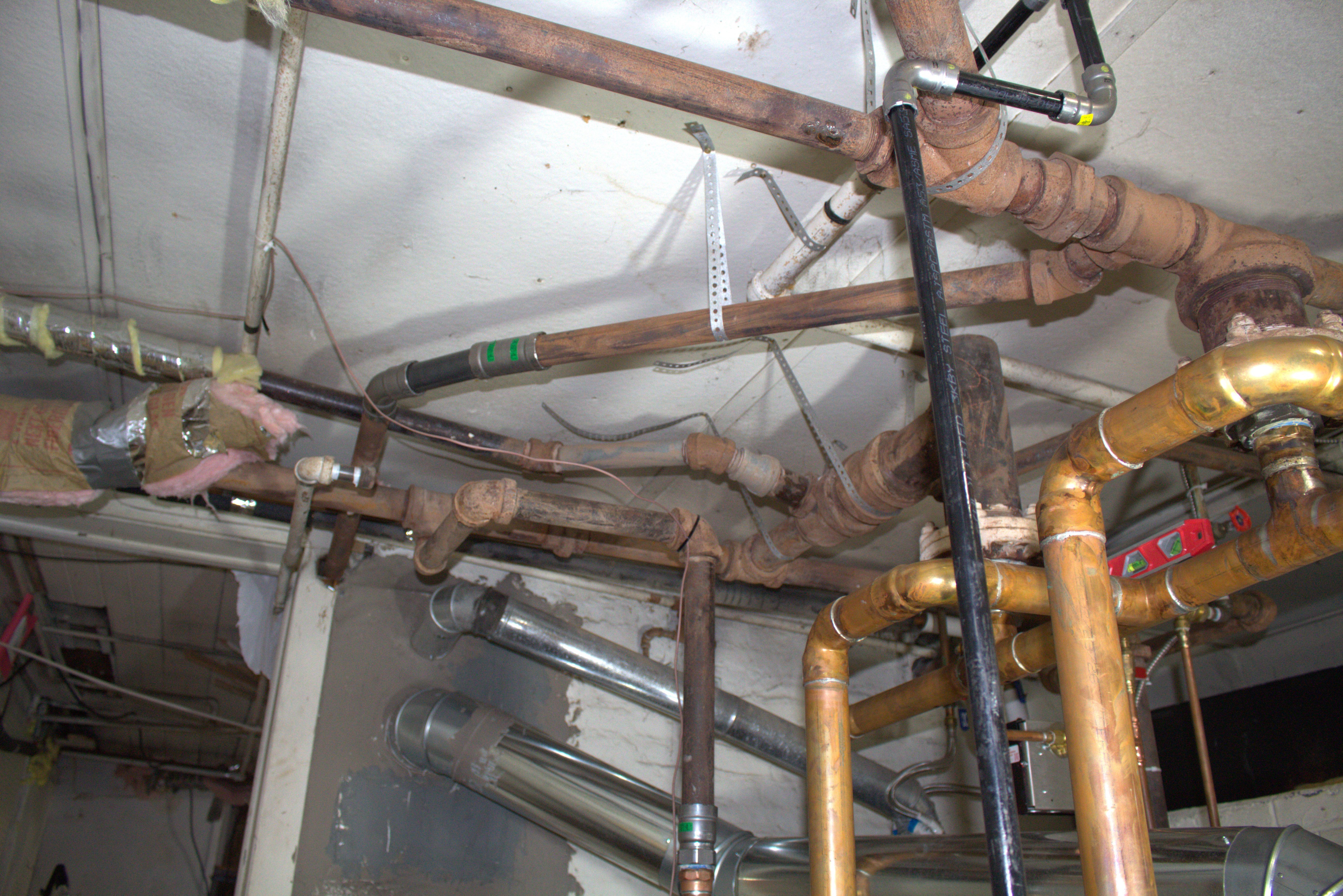

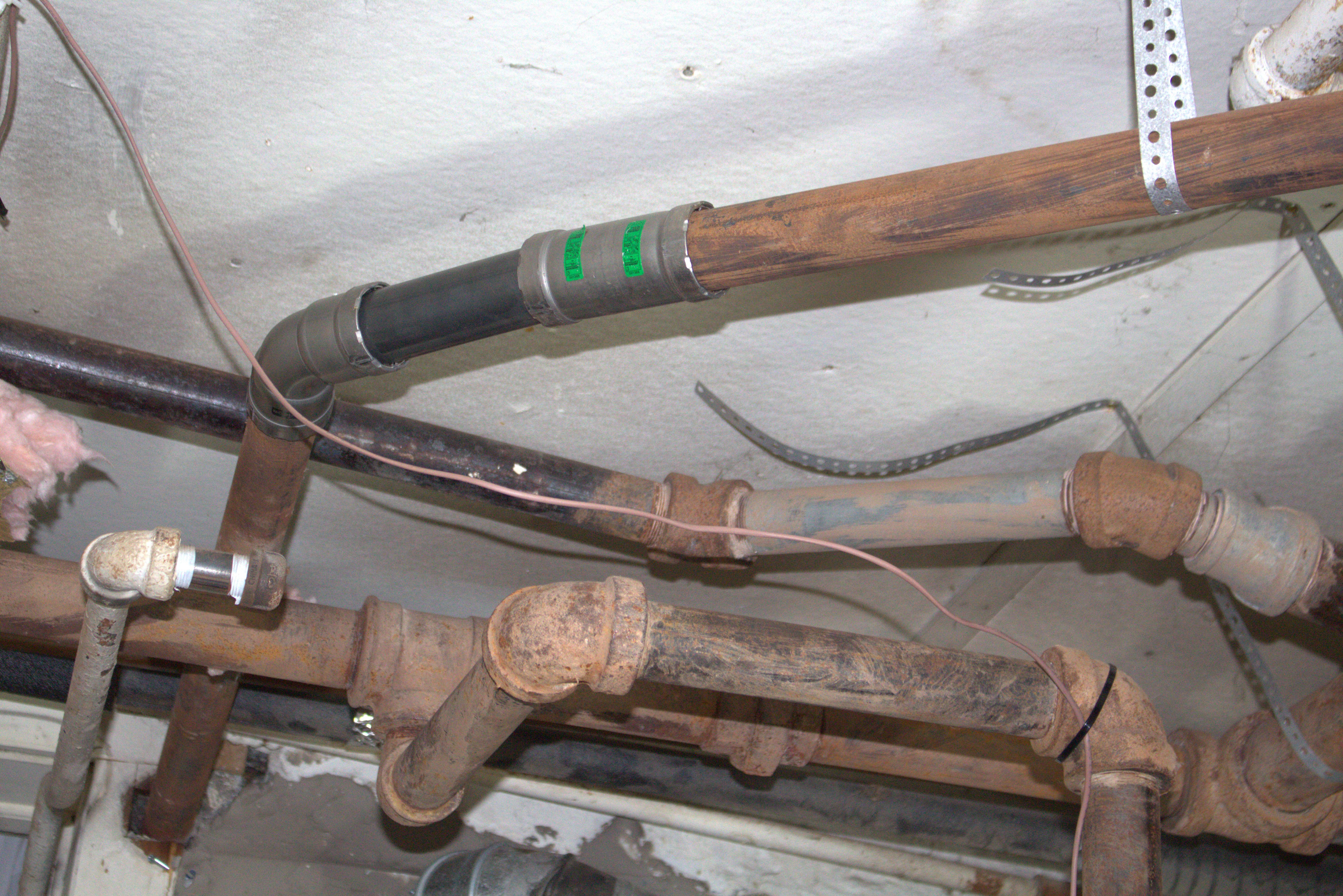

I have multiple concerns about the way it was piped and the slop of the piping as well as the size of piping used and that its copper, and that it was soldered not even braised.
I am including pictures, hoping to get some insight into if this system is okay or completely unacceptable.

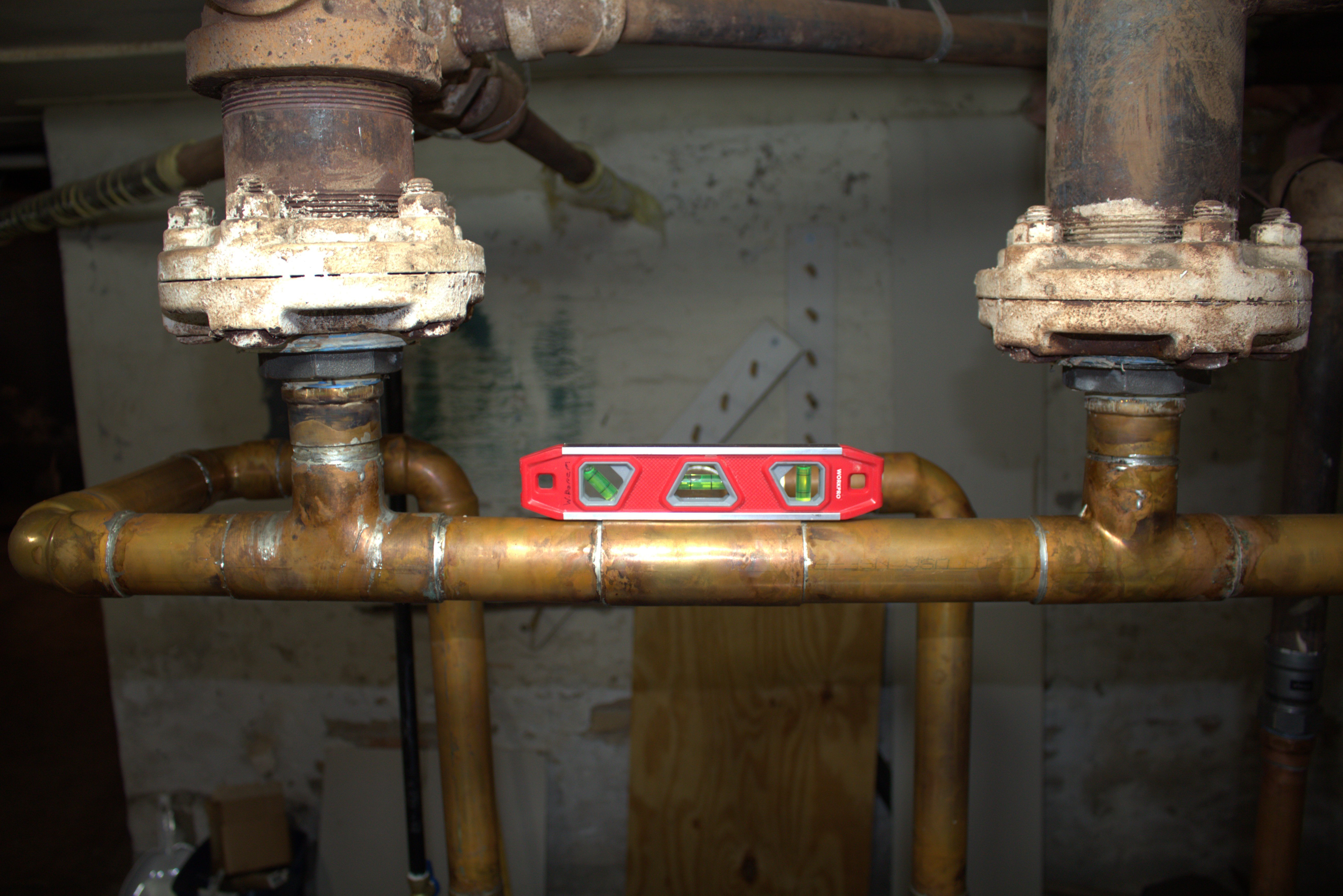

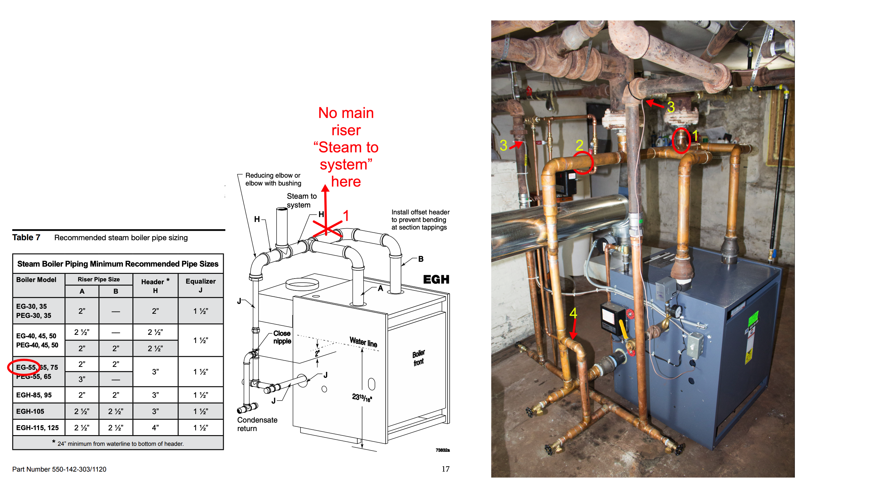

The header is 2 inch, when the Weil McLain Manuel says it needs to be 2-1/2” or 3” depending on if it is 50 or 55
Also says in the manual that when connecting to a counterflow system it should connect to the top and shows a picture will include also.

1 tag

3 exhaust vent touching steam, is this okay?

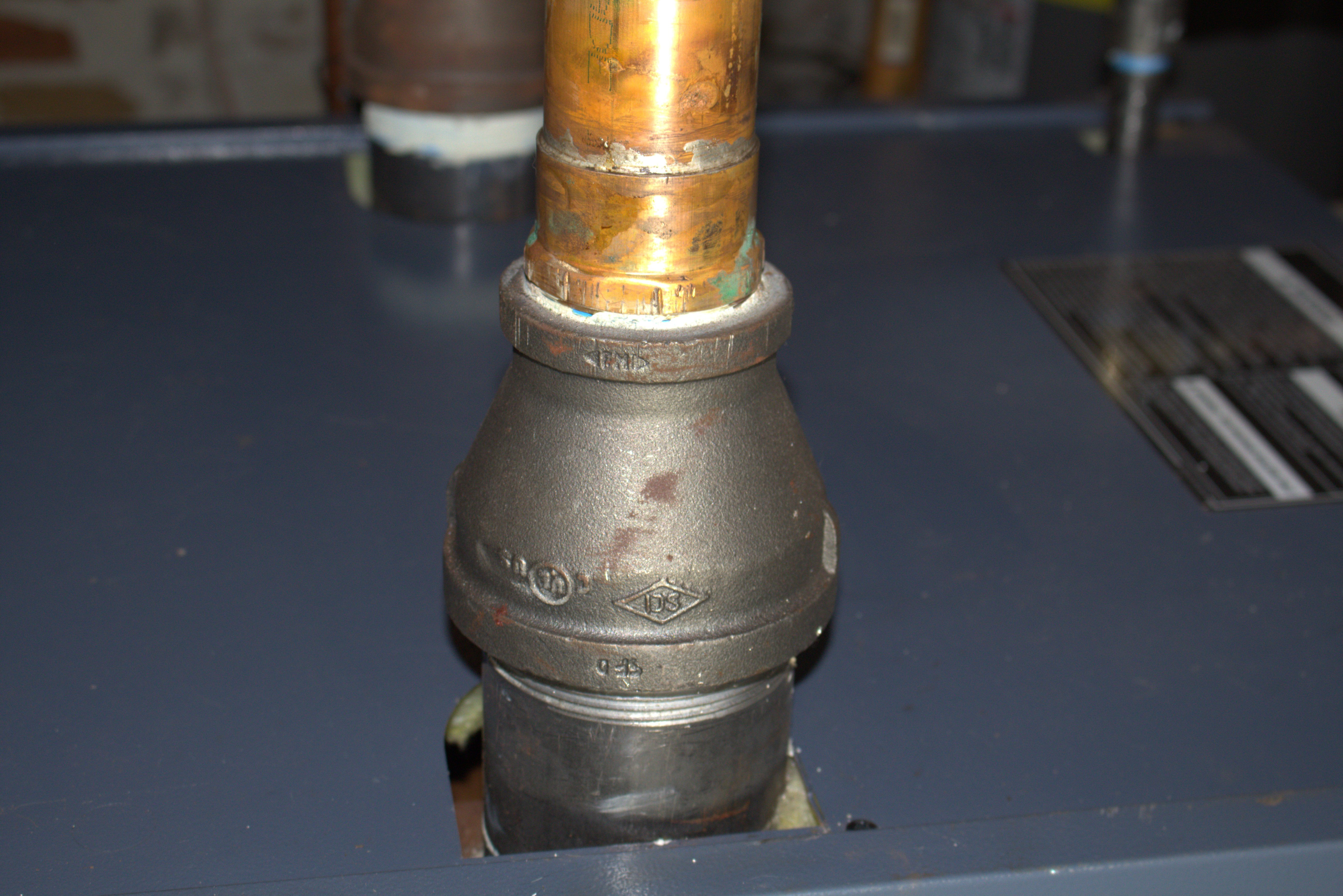

4 is this dialectric second one already looks rusty like iron to me? but was told its a dialectric union.

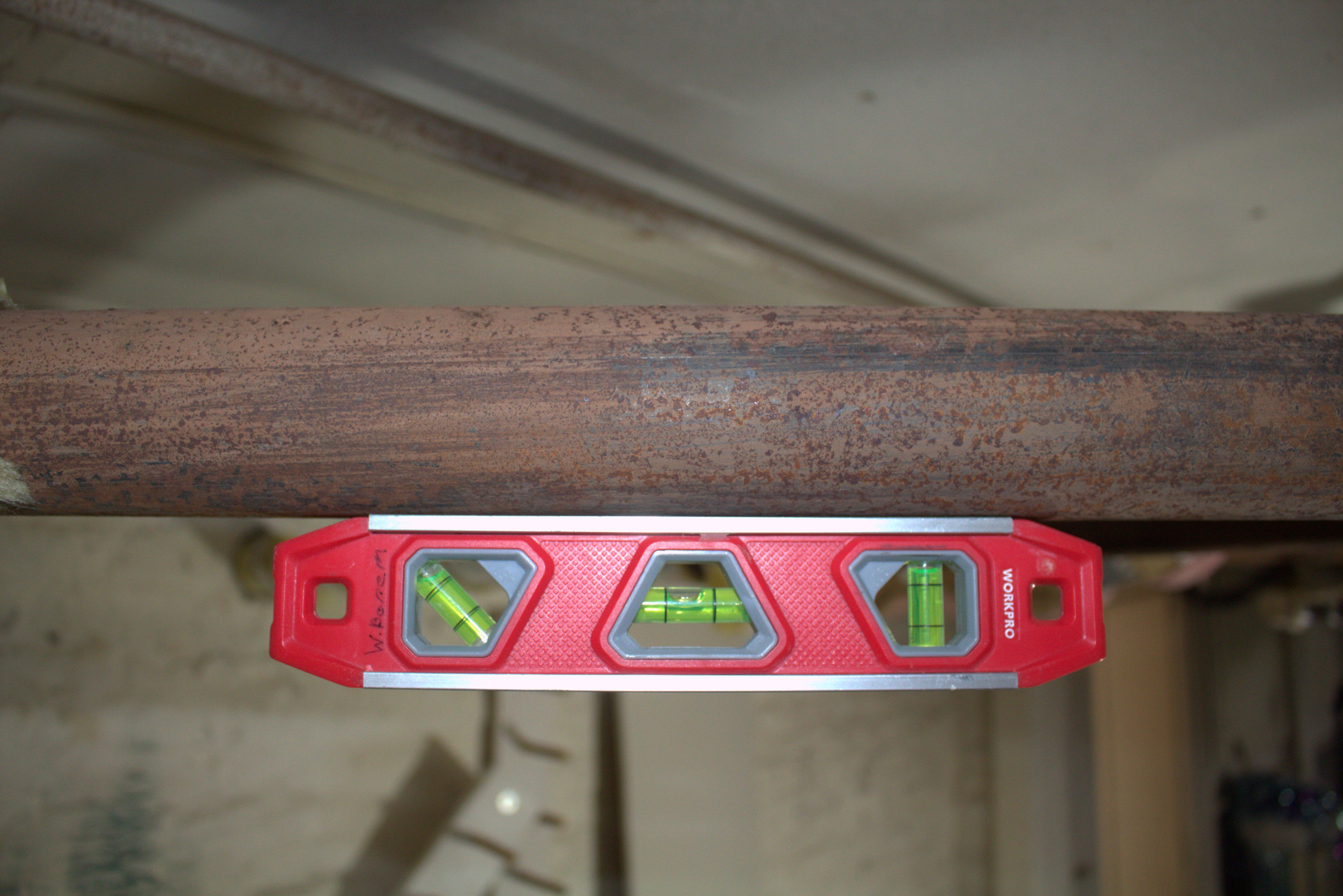

5 is this slope correct and right way?
6 pipe going to two of the radiators that wont heat. no slope?

no slope steam, resting on / touching gas line is this safe / code / acceptable?

    copper above the water line is incorrect. it has to be black iron above the water line.
    the header is too small, it has to be at least the minimum size specified in the installation instructions.
    about 30 other things that are wrong.

    @STEAM DOCTOR covered most of the ones we can see. We can't tell from those pictures how condensate is supposed to get back to the boiler so we don't know if that is even close. The way the power is run isn't really protected or supported. The nipple in the hartford loop is longer than it is supposed to be. Don't know what is up with the random capped pipes. The copper doesn't allow the piping and the boiler to expand at different rates so it will tend to pull the sections of the boiler apart. As @STEAM DOCTOR mentioned the order of the connections of the risers from the boiler and the risers to the system is wrong in addition to the copper pipe and the pipe size. The system needs vents in the mains to let the air out of the mains, they may have been in the old boiler piping if it is a parallel flow system. They also may be buried in a finished ceiling or millwork in the basement.
    The bigger issue is that a lot of decisions need to be made as you are laying out the boiler and piping and you need to understand how steam behaves as you do that, if they don't know why you need main vents then you won't know how to make those decisions.

    good point. That MC cable is rated for 90*C (197*F) That pipe can get hotter then that!
    pecmsg Posts: 7,634
    why all press fittings on the gas but solder on the copper?

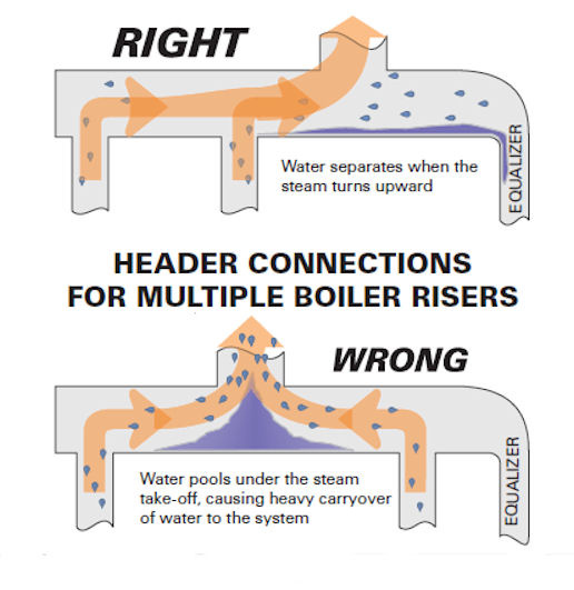

    There are two piping methods that cannot be used on near boiler steam piping: copper and welded iron piping. Both for the same reason: the piping won’t expand and contract at the same rate as the cast iron boiler block. This can cause the block to crack. Threaded iron fittings must be used to allow for the thermal movement of the block.
    And among other things, the take offs from the header must be after the risers from the boiler.
    You're right about the header.
    For the risers, you are good. The minimum piping requirements for the EG 50 are one 2-1/2-inch riser, OR two 2-inch risers, which is what you have. For the EG55, it's one 3" riser or, again, two 2" pipes.
    See Table 7 on page 24 of the installation manual:

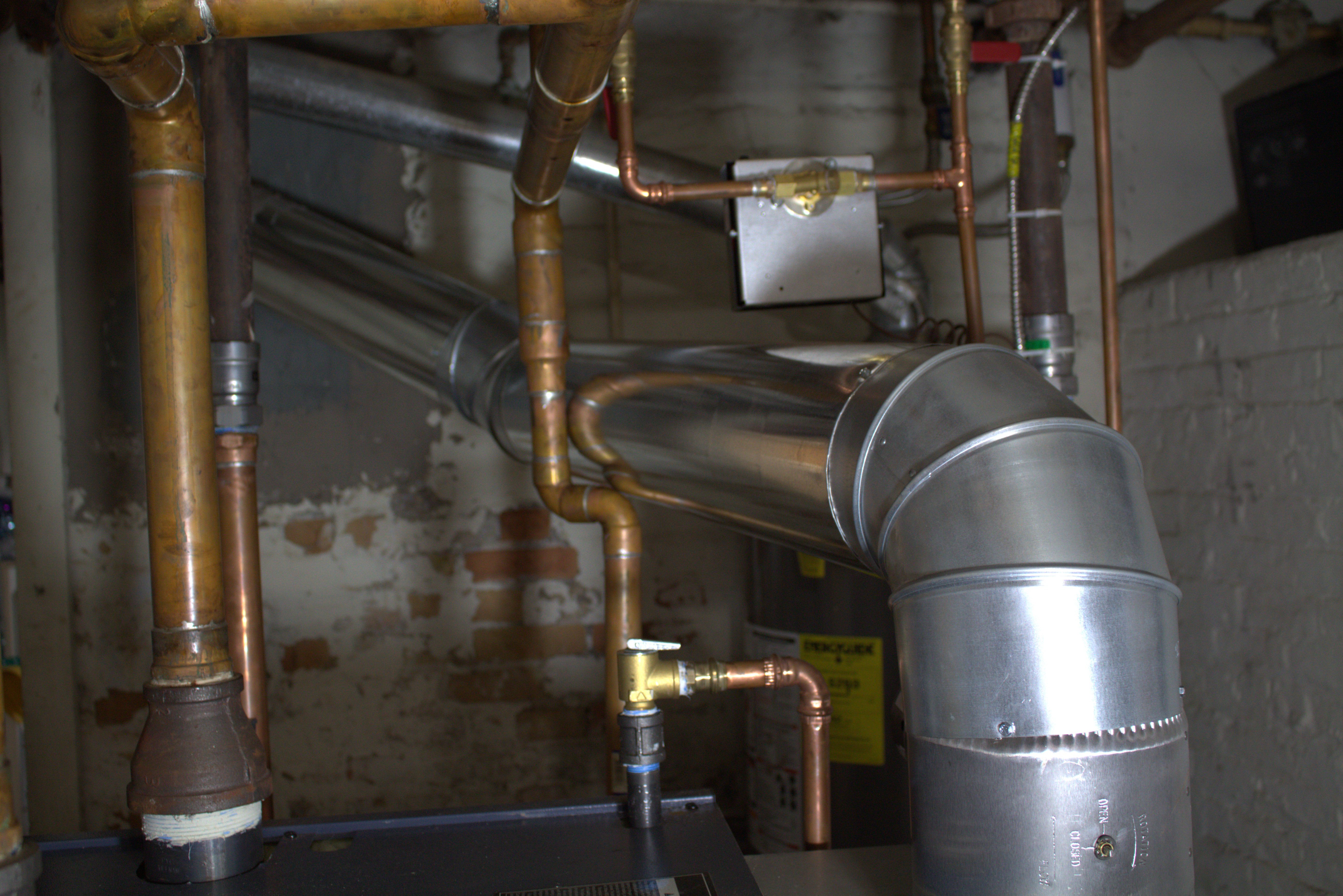

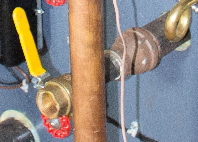

    We don't see enough of the boiler to tell if there's a skim port. It's not difficult to do and it may immediately -- and temporarily -- cure your water hammer problem. You'll have to repeatedly skim to clear your system permanently, ask me how I know.

    I didn't look carefully.. I believe there is a skim port in the second picture at the beginning of the thread.
    Getting a bucket under the spigot will take a little planning but it'll work.
    » the piping won’t expand and contract at the same rate as the cast iron boiler block. This can cause the block to crack.
    Not a fan of copper, but because of the swing joint design used here, there won't be undue force on the block.
    skim.jpg 124.9K
    you could extend the skim port with a nipple to get it over a bucket.

    Here are 4 obvious ones that are wrong just from looking at the instructions:
    1. This main takeoff is between the boiler risers. That is clearly not in the piping diagram that comes with the boiler, on page 17
    2. This pipe (the header) must be 2-1/2" diameter or larger if you have the EG-50 and must be 3" if you have the EG-55. see page 17
    3. That wire is on a dry return with a fastener. The dry return can get to be over 200° and the insulation on that wire us not rated for that temperature. See the part in the manual on page 4 about wiring and following NEC or local electrical code.
    4. That 4" (or longer) piece of copper does not qualify as a close nipple on page 17
    I can't be sure if the risers (A & B in the diagram and table 7 on page 17) are 2" pipe. That may be 2" copper from what I can see, but it must be at least 2". If it is not, that would be item #5 if those are smaller that 2" pipe.
    Other issues that may not be specifically mentioned in the manual, but are considered normal trade practice:
    1. Best practice for a steam boiler installation is to use threaded steel pipe above the water line. This boiler, piped entirely in copper, shows a disregard for accepted steam-fitting practices.
    2. Swing joints are customary on dual-riser piping designs. I am not sure that a non-threaded 90° elbow qualifies as a proper swing joint, since soldered joints do not allow for the same movement and flexibility as threaded joints. Those solder joints will fail prematurely. I would insist on proper swing joints when the header is repiped to the correct size.
    3. Banging is not an acceptable result of a new boiler replacement. If there was no banging with the previous boiler and there is banging now, the replacement boiler installation is the most likely cause of the noise.
    4. Based on the sizing guide published by Weil-McLain, your boiler may actually be properly sized. However, that sizing assumes that all near-boiler piping and steam mains are insulated. This should have been addressed in the installation contract. Even if insulation was not specifically listed, if the contract states anything similar to “installed in accordance with the manufacturer’s instructions and industry standards,” you may have grounds to require that the repiping and insulation be included as part of the corrective work.
    There may only be eight issues to point to instead of thirty, but those eight should be enforceable with proper representation.
    Hope this helps.
