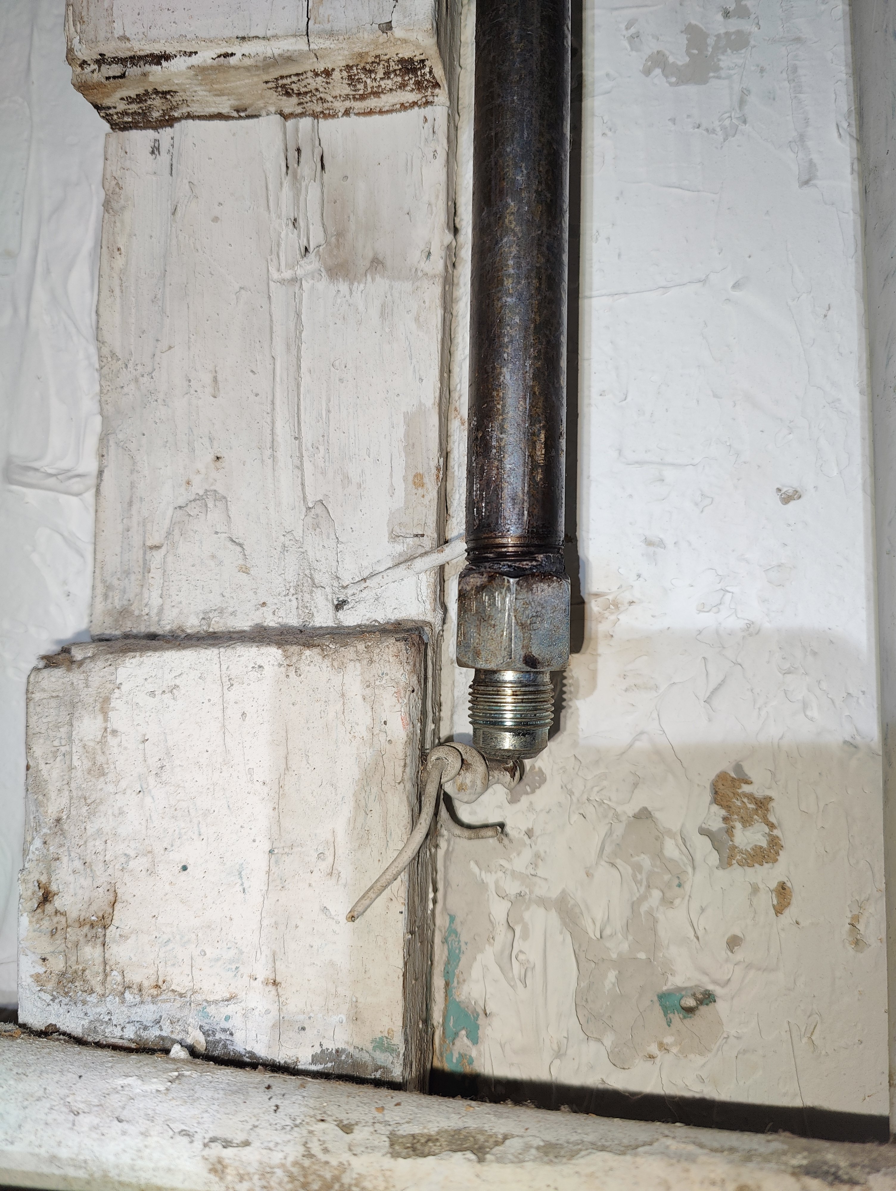

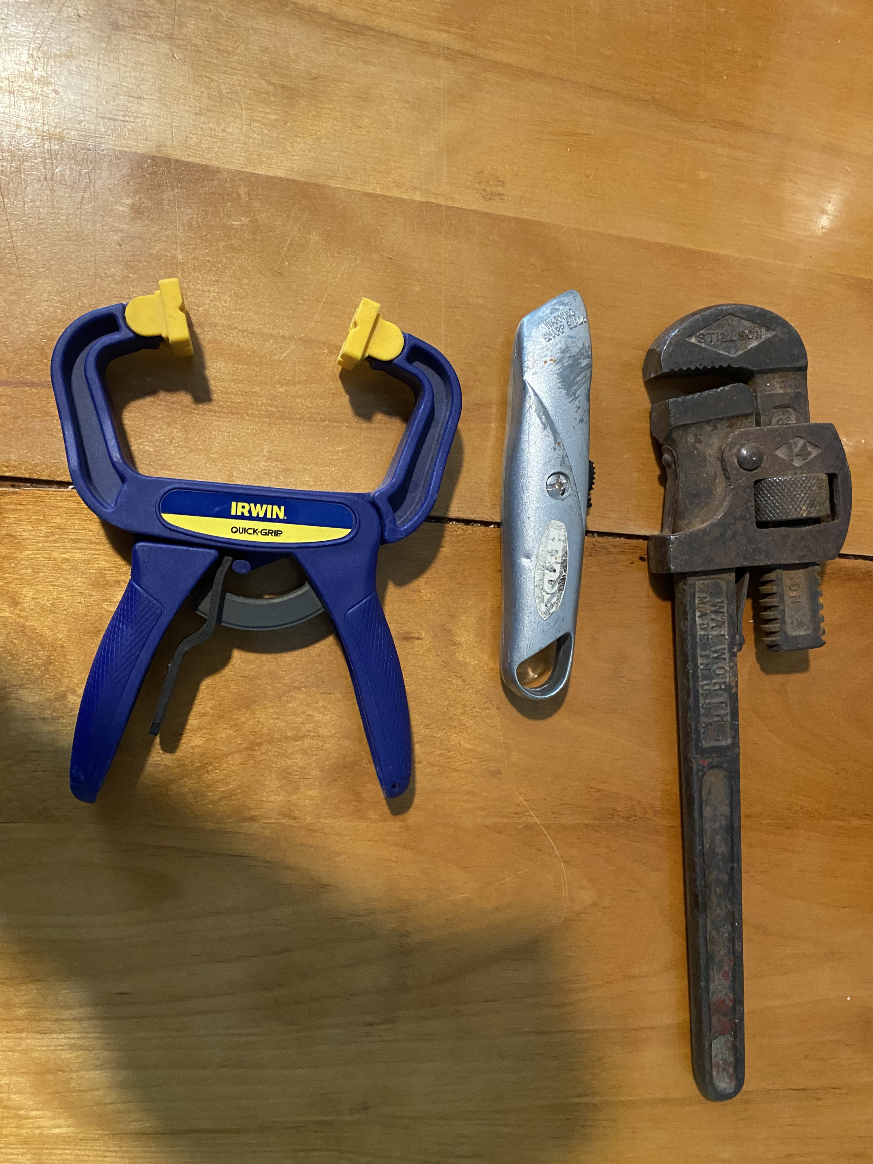

Previously I tried old black iron fittings but was not able to crack them open.
I thought this s.s. fitting should be easier to remove, but it's also very tight. I saw in other threads that ppl talking about the heating method. But heating it using a torch for a minute didn't help. I'm using an Irwin groove joint pliers and Ridgid offset pipe wrench on the hex.
Any trick to get it open?

    Two 24” pipe wrenches. Those channel locks aren’t gonna do it.

    pipe wrench on the pipe and a big crescent wrench on the fitting, that is probably plated brass rather than ss. or 2 pipe wrenches.
    if that is gas piping cap it before yo leave, don't want any accidents.

    Is this a two man's job?
    One alum 24" wrench is still too heavy.
    Does a pipe wrench grip well on the round pipe?
    mattmia2 Posts: 18,437
    the point of a pipe wrench is that the jaws dig in to and grip the pipe. adjust it tight enough that the back of the jaw starts to tough as it clamps down as you turn it, that will help support the pipe and it make it less likely to crush the pipe if you have to apply a lot of force
    you hold the pipe with one wrench and you turn the fitting with the other. if you arrange the wrenches right you can squeeze them toward each other instead of trying to pull each with a different arm.

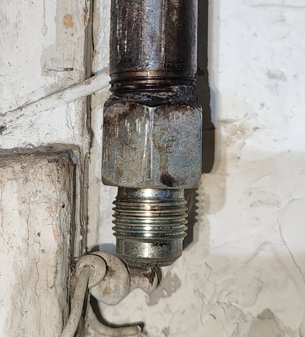

    There is something underneath that silver fitting (gas flare fitting, seems to be 3/4 in). You should probably get rid of that before you try to unscrew the fitting. Might get in the way

    If I can do it (at 84), you can. Use a 24 inch pipe wrench on the pipe — set it as @mattmia2 said, so that the slide of the moving jaw is touching the pipe as well as the jaws) and set it to pull towards you, so that the jaws tighten as you pull (if you can't get the pipe wrench in back of the pipe, then swing it over to the other side and push on it). Then a big crescent wrench on the hex. Do NOT use a pipe wrench on a hex fitting — for one thing, it doesn't fit on a hex (meant for round stock) and for another it tears up the fitting. And I do mean a big crescent wrench.

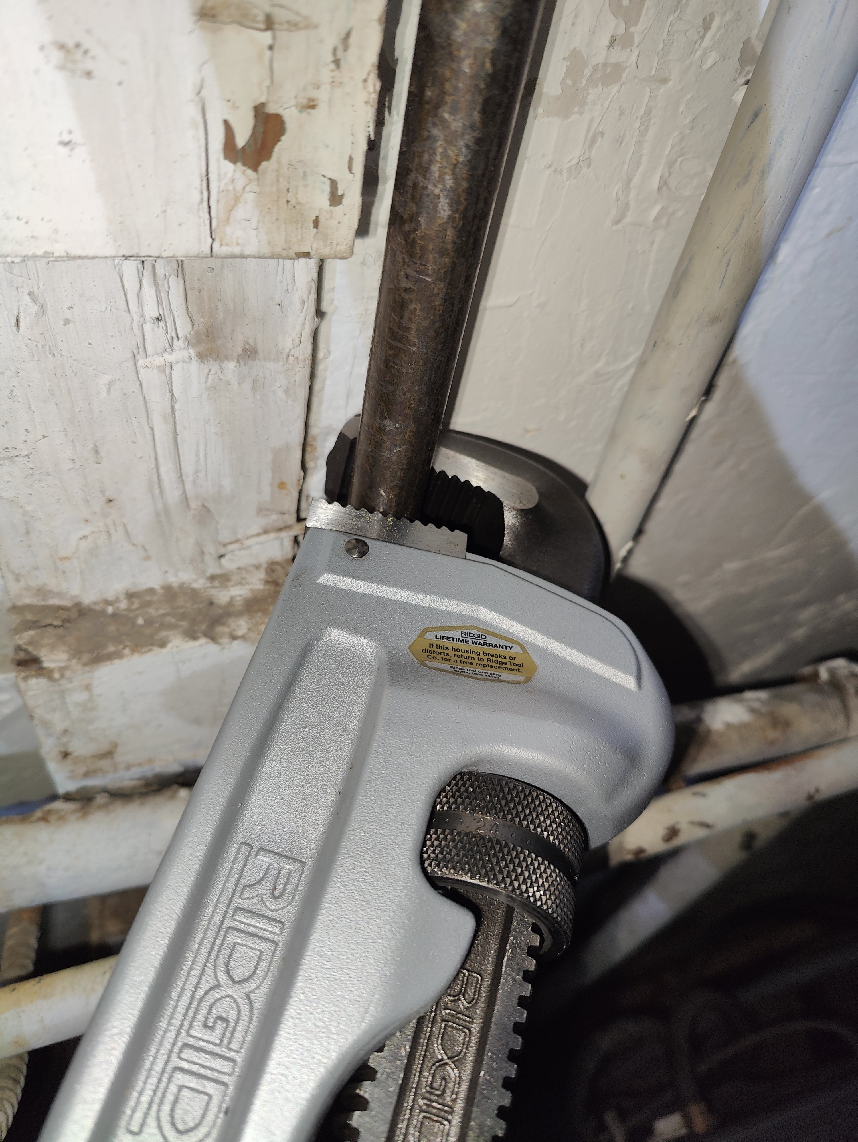

    Since the ridges on the lower jaw is skewed in one direction, the wrench oriented in the photo below should be kind of pushed towards the left to help the ridges on the lower jaw bite into the pipe surface. This is what you and @mattmia2 mean, right?
    Could you explain the meaning of: the slide of the moving jaw is touching the pipe as well as the jaws?
    I have set one wrench up in place. I don't see how I can continue setting up the second wrench while keeping the first wrench that way, without a helper?

    Hi, I'm thinking you need to turn the pipe wrench around, so it prevents the pipe from rotating the other way. After that a large (18" would be nice) crescent or monkey wrench on the gas fitting will do it. I like to place the wrenches so my hands are about the same distance from the pipe, and the wrenches are roughly one above the other. Guard your hands/knuckles and give it a balanced push-pull. If nothing moves, I've used the trick of putting a lever between the wrenches. This gives much more force to break things loose.

    Yup. That would be correct for tightening. For loosening flip the wrench over. The jaws should be lightly farther open, so the pipe slides into the opening farther so that it just touches the straight sliding part of the jaw where it comes out of the body of the wrench — but no further closed.
    And as @Larry Weingarten said, guard your knuckles. Some fittings will come loose abruptly (or the wrench can slip), though most aren't that cooerative.

    Oh I see your point. So the pipe should touch the vertical of the moving jaw. That's already the furthest position the pipe can go in, right? "But no further closed"? I think the point is the pipe needs contact the vertical slide, the moving jaw and the stationary jaw at the same time.
    But there is not enough clearance for the wrench to enter from the left side.

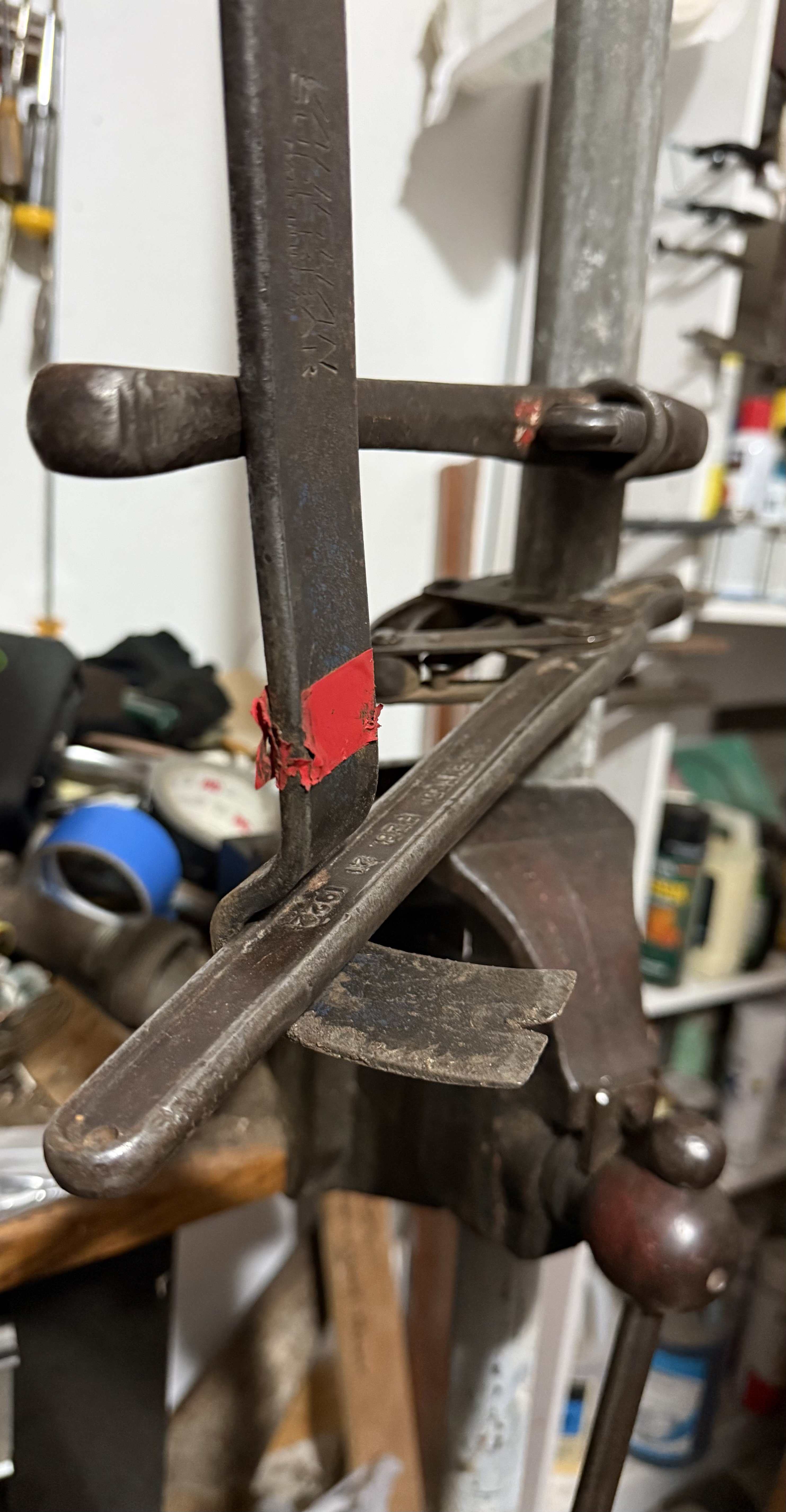

    @Larry Weingarten My mistake. There seems to be only one way to perform the juicer technique.
    What is a lever between wrenches? Could you post a photo of what this assembly looks like?

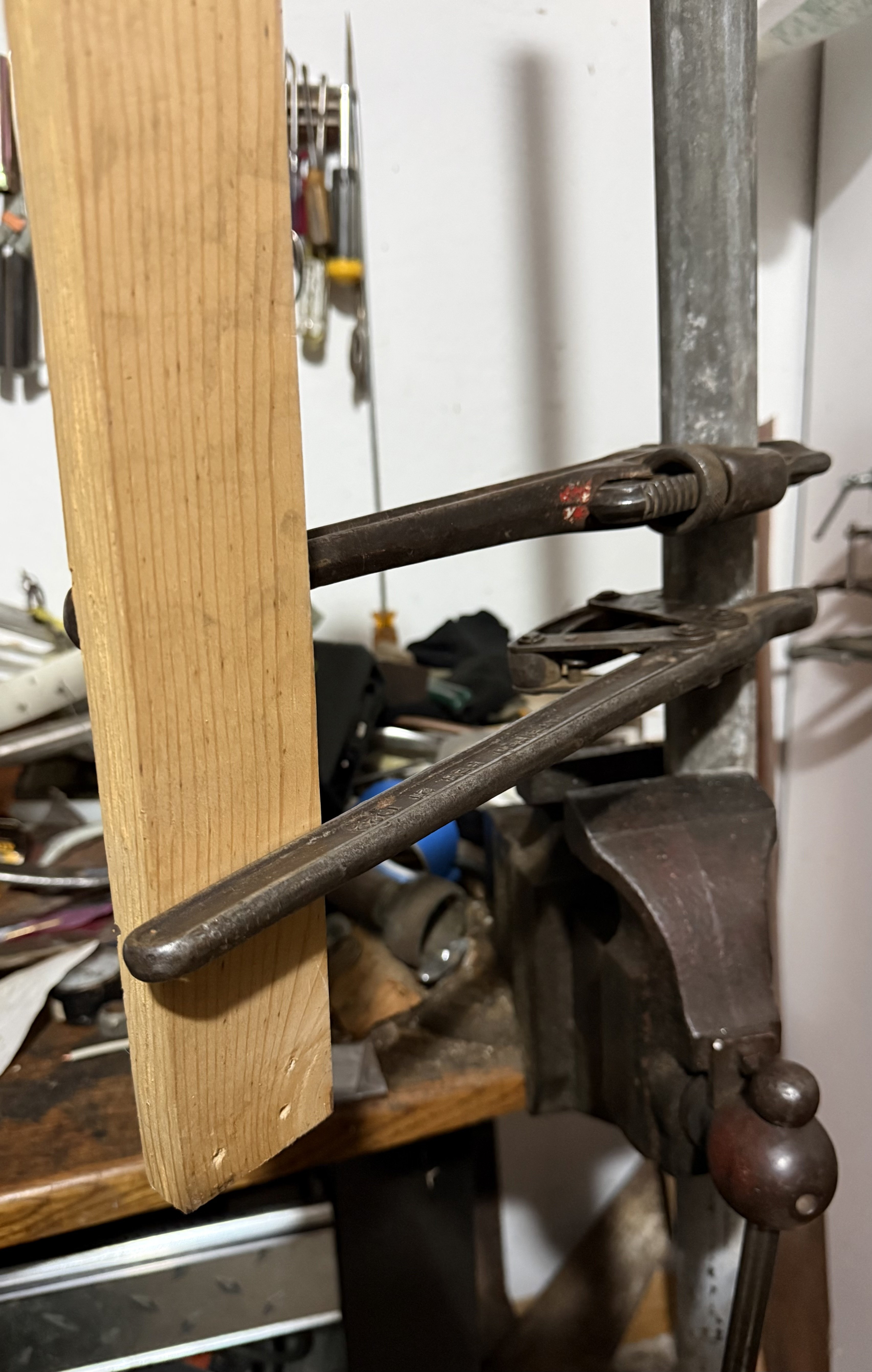

    Hi @azward , Here are two quick mock-ups. The pry bar is my preferred method, but the wood can work, and is a bit less likely to slip.

    Looking at your situation and at @Larry Weingarten example the wrenches they would be reversed, since the fitting you want to loosen is the lower wrench, if I understand what you want to do correctly.
    The way I would do it is;
    The upper 'back up' or holding pipe wrench would go between the pipe and the wall, use the wall to help you, with the wrench handle to the left, jaw opening towards you.
    The lower wrench handle to loosen the flare adapter fitting would also go to the left, if using a pipe wrench the jaw opening would go towards the wall.
    By using the wall to help hold the 'back up' or holding pipe wrench you can push on the loosening wrench with your body while squeezing the two wrenches together with your arms or adjust the wrench handles to use @Larry Weingarten's lever method.
    You can put the wrench handles to the right of the pipe but then you can't use the wall to help add a mechanical advantage.
    The way the wrench is placed in your picture you would be loosening the pipe in the fitting above the view your photos provide.

    the wood plate on the left side of the pipe, although 80% was chiseled away, still blocks the clearance for a pipe wrench. I wonder why the contractor didn't cut that section away completely

    yes the pipe is clamped to the wall
    yanking pipes could cause leakage at the connection fittings at a later time, right?

    you could temproarily remove the clip.
    depends on how hard and how you yank. usually they can move a little without causing a leak. try not to pull such that you unscrew other fittings.
