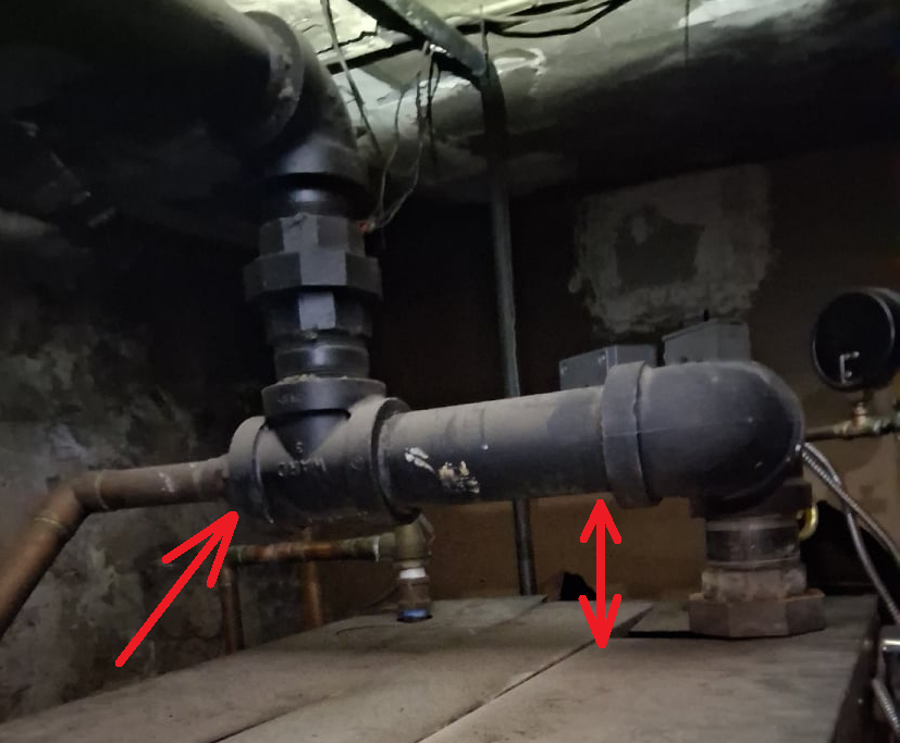

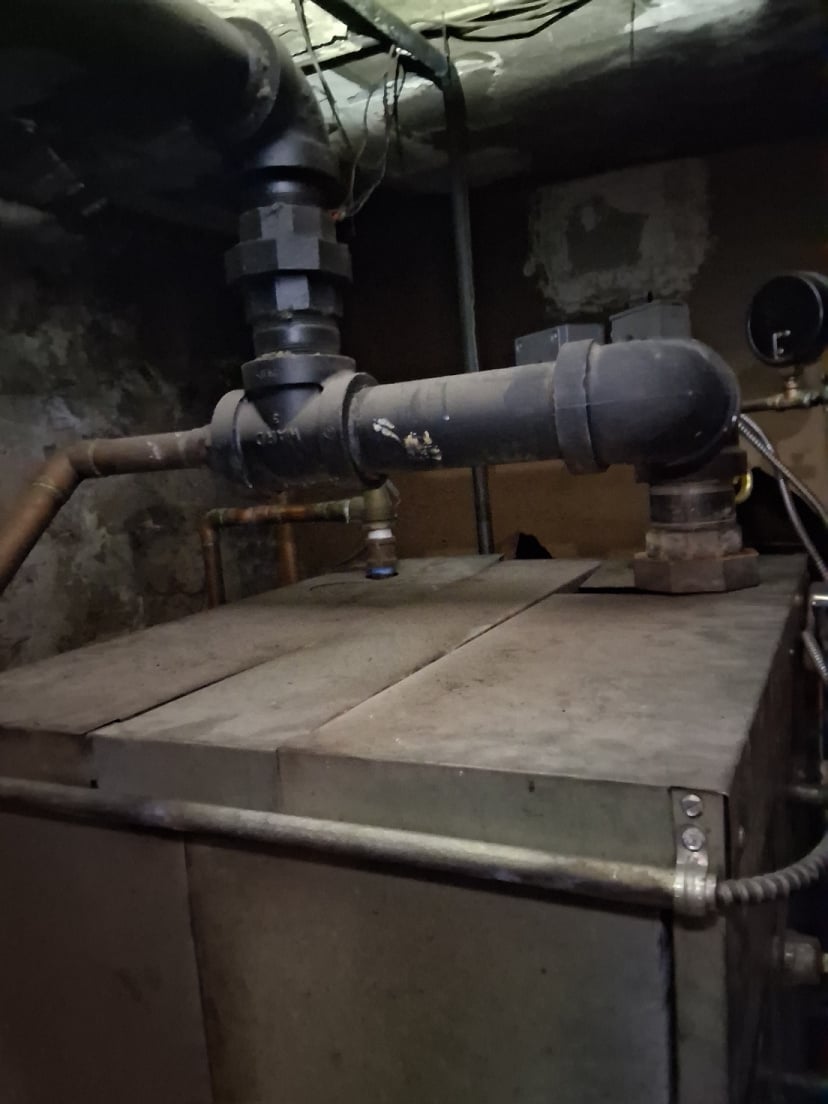

What is wrong with this steam boiler piping

    Header won't drain into the equalized properly. Header may not have the proper distance above the water line. A drop header may have been a better choice. However if you are not having any issues I would not worry about it. Is the main parallel or counter flow ?
    STEAM DOCTORMad Dog_2ethicalpaulEdTheHeaterMan
    it isn't right but it probably works fine on that 60-80 year old boiler with plenty of space above the water line.
    ethicalpaul Posts: 9,075
    Although, if it isn't banging, it isn't backing up, or at the very least if it is backing up, it's not causing banging. Is it banging?
    EdTheHeaterMan Posts: 12,940

    I think this is a trick question:
    What is wrong with this steam boiler piping?
    No Text, No explanation, No other information, Just a picture.
    And being the proverbial Irishman that always answers a question with a question…. My reply:
    "☘️ Whit aire ya talkin' 'bout? ☘️"
    So without context to the question, You need to tell me more about what is happening on the job.

    If the header is level and if it doesn't bang leave it alone the condensate is going back into the boiler. After a cold start very little condensate in a hot header.

    I was concerned as well about the constriction created by the smaller coupling going up to the system piping?

    I'm not sure I see a reducer between the main and the header, but it is normal for the header to be bigger than the main, the header slows down the steam velocity so that entrained water droplets can drop out but once those droplets are gone the steam can move faster.

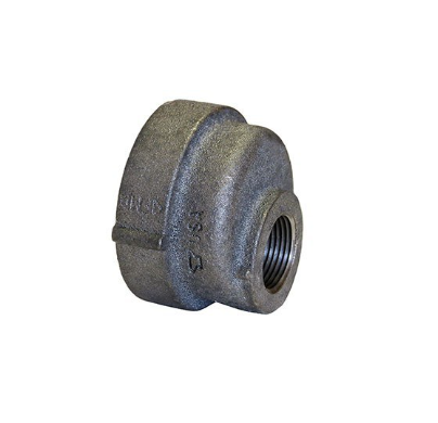

    If it is banging you should install one of these, an eccentric coupling to drain the condensation out of the header.

    Not convinced an eccentric coupling is best practice. An eccentric coupling would probably be better than it is now. I think an elbow would drain the best.
    I think you said that before. I'm not sure I see it. Can you provide a zoomed-in screen capture showing it or draw an arrow on the photo pointing to it?

    seems this union is too narrow?
    edited April 16
    The union itself looks fine, appears to be a 2" (or 3"?) from here.
    But are you saying maybe the union has a bushing in the top of it and a very small nipple, like about 1"?
    The photo isn't clear enough for me to know but yeah that wouldn't be ideal. Given the tiny tiny equalizer on here I guess this wouldn't shock me.

    There isn't enough light to tell but there isn't anything where I would expect the end of a reducer would be either so I think the union is the same size as the ells and nipples.
