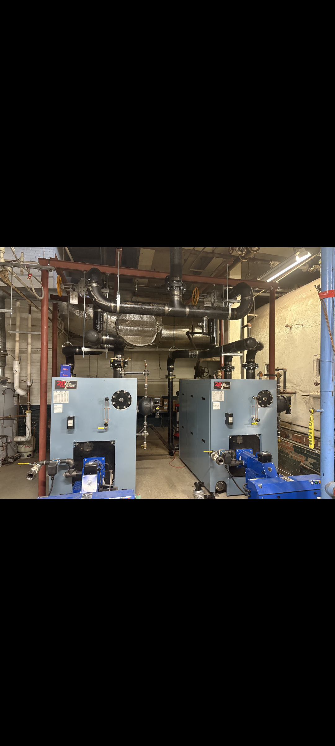

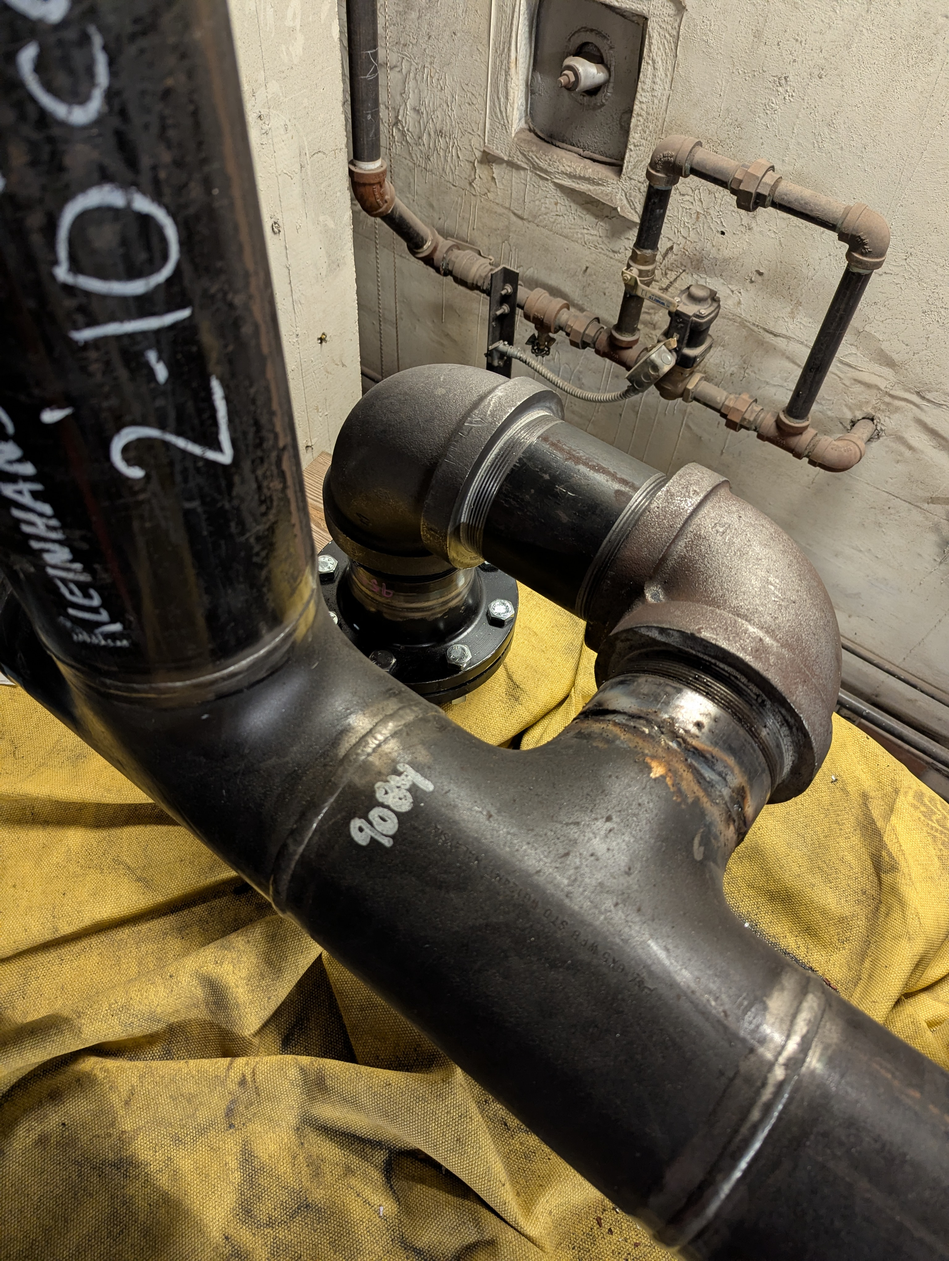

Is this the way they're going in now?
Double D
Double D Member Posts: 467
edited January 14 in Strictly Steam

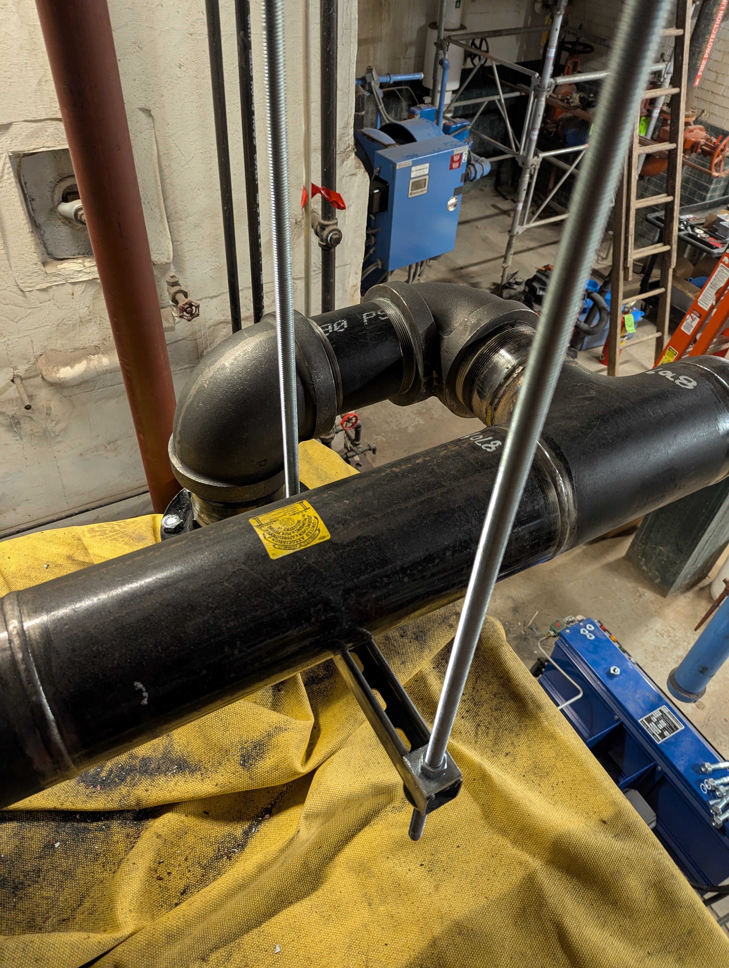

Does Smith allow all welded near boiler piping?
Peerless and Weil McLain let you know where in the near boiler piping they would prefer to see threaded.
Is there any info out there about the Smith boilers?
My guess is that header will be filled with water before the first radiator gets heat.
mattmia2Corktown
    mattmia2 Member Posts: 16,730
    it looks like someone gave them a drip but they didn't use it. probably very likely all the water will end up in one boiler or the other too.
    Double D
    EBEBRATT-Ed Member Posts: 20,163

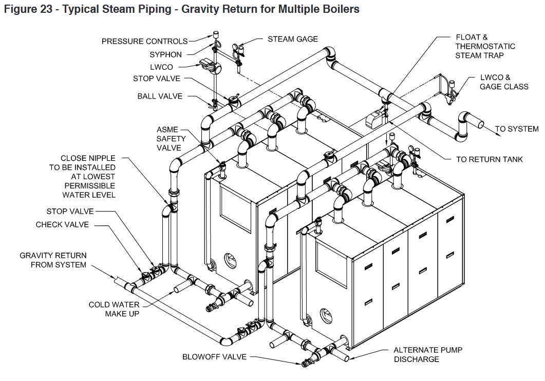

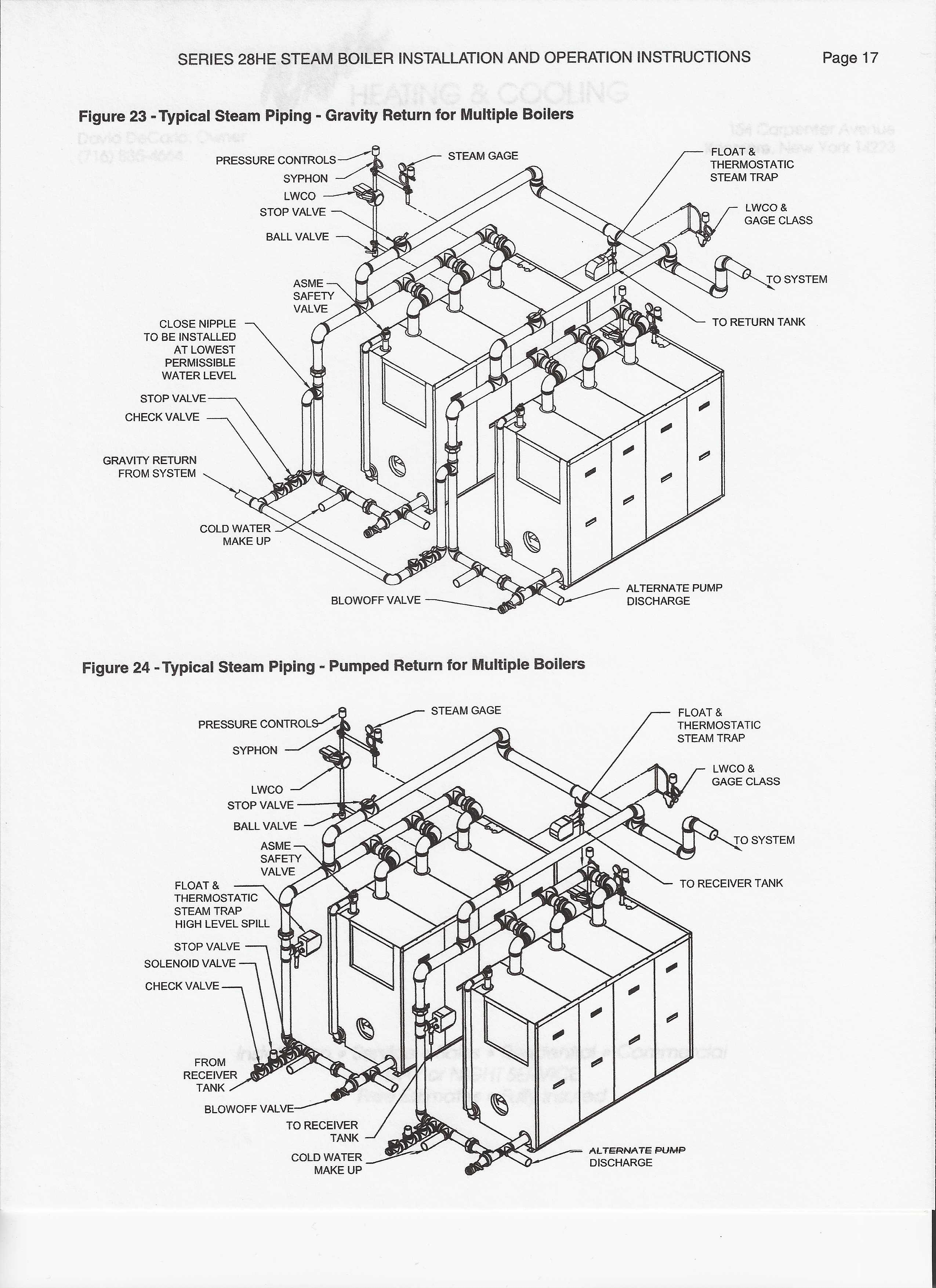

    The Smith 28 series has 5" risers. The header size varies but is at least 5" with more than 1 riser. This varies with the # of sections
    Smith doesn't mention threaded or welded piping but the manual appears to show threaded fittings with a union.
    I don't even think they make 5" unions so that is wrong. 5" flanges are available.
    In spite of what many on here will post 99% of all contractors are not going to thread 5" or 6" pipe..Just not going to happen.
    There drawing does show 2 elbows at the top of each riser also something that is seldom done.

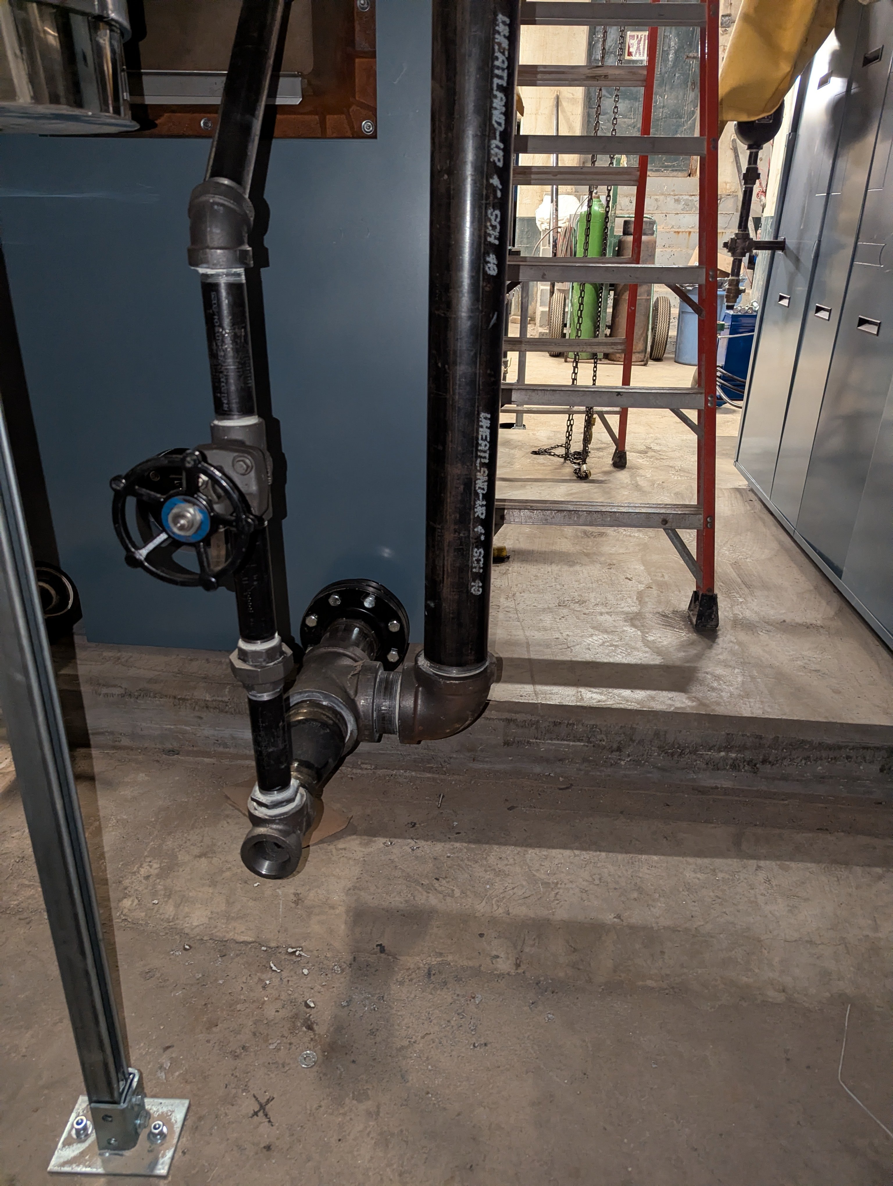

    On a pumped return for multiple boilers, what is the purpose of the F&T on the equalizing line?
    HVACNUT Member Posts: 7,434

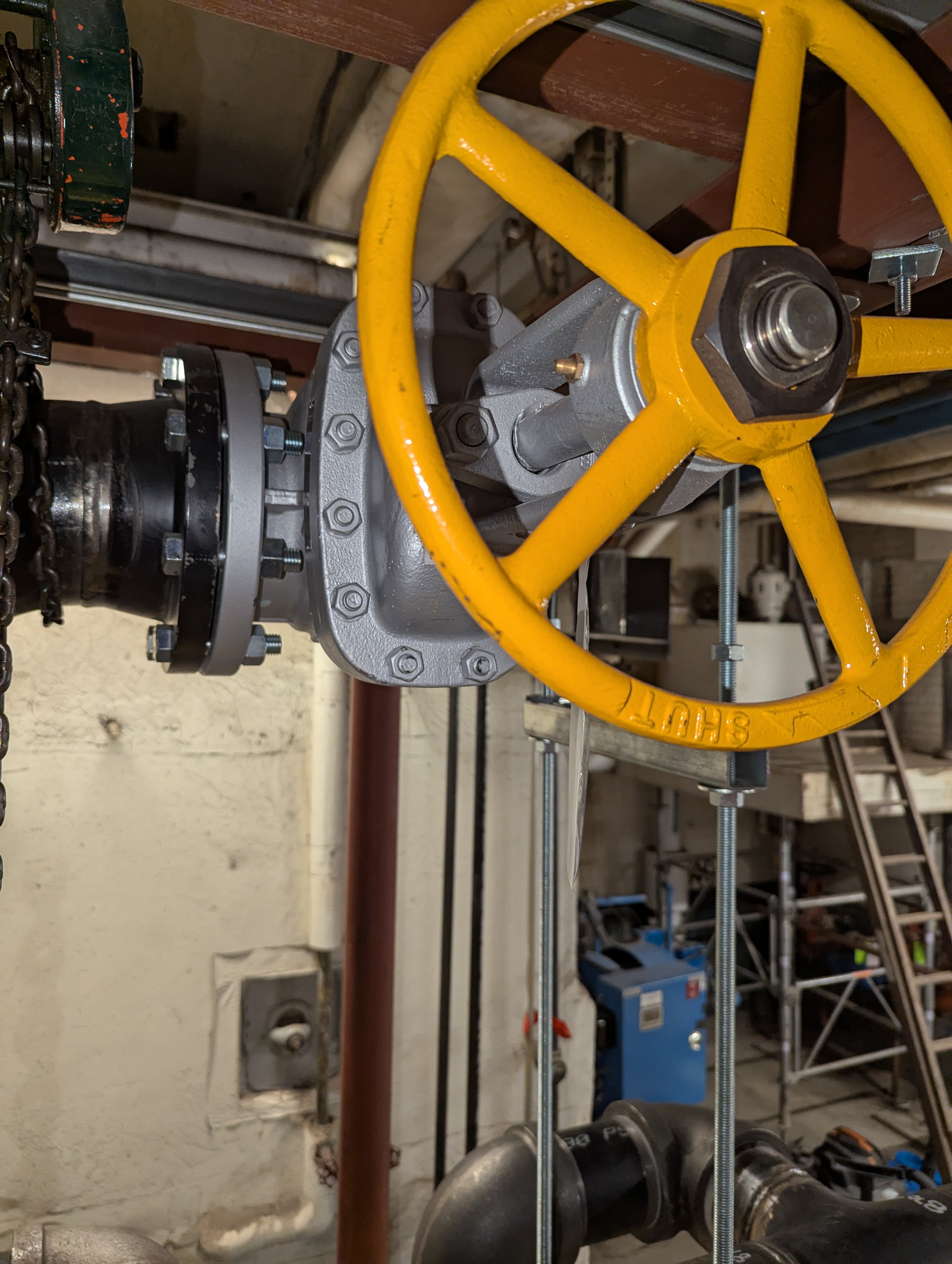

    I wonder how much those yellow handled valves are, and are they necessary. Are they for balancing?
  • dabrakeman
    dabrakeman Member Posts: 1,007
    Is this actually running right now? Colliding steam going into the main riser is wrong and it does seem that drip needs to be hooked up per the manual.
  • Double D
    @dabrakeman
    This boiler installation in not finished. They have some corrections to make before they run it. My guess is the colliding header would be full of water before the first radiator gets heat.
    probably isolation so you can run off of one boiler while servicing the other.
    HVACNUT
    109A_5 Member Posts: 3,976
    I'm thinking they are more orange. I bet they are expensive. Looks like it is a King valve.
    No F & T traps in the equalizer like the manual shows.
    If they don't put the F & T trap (or some type of drip) in under the paralleling header, yeah it will fill with condensate, faster if they don't insulate it. looks like there is a plug there now.
    They still have lot of work to do. Orange? No. I'll give you Mustard color though.
    edited January 15
    A trap on the equalizer is an overflow trap. It is used when you have multiple boilers connected to the same system where the boilers alternate or one acts as a standby. With the valves open to the header on both boilers and one boiler operating the idle boiler act as as a condenser and fills up with water to an overflow condition if the burner fires you could damage the boiler. The overflow trap should be piped to put this condensation back into the boiler feed tank.
    The stub is on the main header for the trap to drain the header. The supplies to the main header should not be colliding but if only one boiler runs at a time its fine.

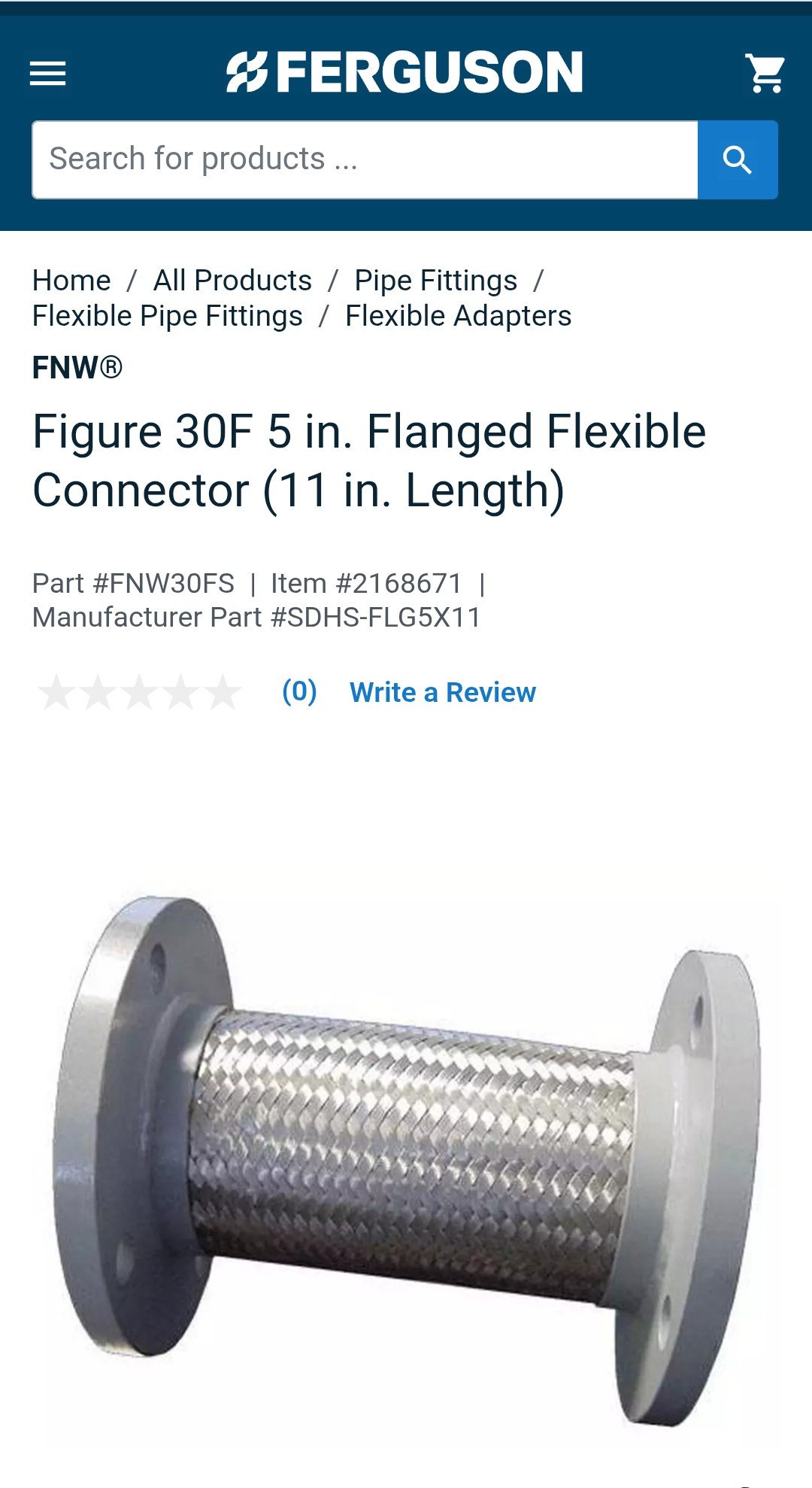

    Rather than using 5" threaded 90s on the boiler risers, the mechanical contractor is suggesting unsing these. One on each boiler riser and one on the equalizing line for each boiler.
    I've seen the these used on hot water heating but never on low pressure steam. There are flex connectors rated for low pressure steam.
    Does anyone see any problem using them?
    " Rather than using 5" threaded 90s "
    So they are going to use a straight flex coupler and bend it to 90 degrees ? If so is there a bend radius specification ? In general that seems like a bad idea.
    Or is the flex coupler pre made as a 90 ?
    edited January 18
    Don't let him use those they will fail. They are made for linear expansion and contraction not bending and twisting.
    they probably choked on the price of a 5" 90 or they can't get them.
    Look online and search for 5" threaded elbows.
    You will be looking for a while, probably not available.
    Most contractors weld everything 2 1/2 and up
    ethicalpaulbburd
    you can put the flex coupler in a straight section of vertical pipe where the pipe needs to move for expansion, i wouldn't want to see them used as a 90 regardless of if they are preformed that way or not

    pecmsg Member Posts: 7,053
    I'd be looking for a different contractor!

    We use these all the time to help reduce vibrations and very slight misalignment on pump piping, these are not meant to bend more than a few degrees. They are for very minor offsets, small expansions, contractions, vibrations. Do not even think of trying to use them as a bent 90!
  • Double D
    @pumpcontrolguy
    I'm not thinking the mechanical contractor was going to try using them as 90s, one on each boiler riser and one on the equalizers drop. He would like to leave his 2 welded 90s in place.
    If it were me, I would be using the treaded 5" 90s. The flexible connectors wouldn't be an option for me.

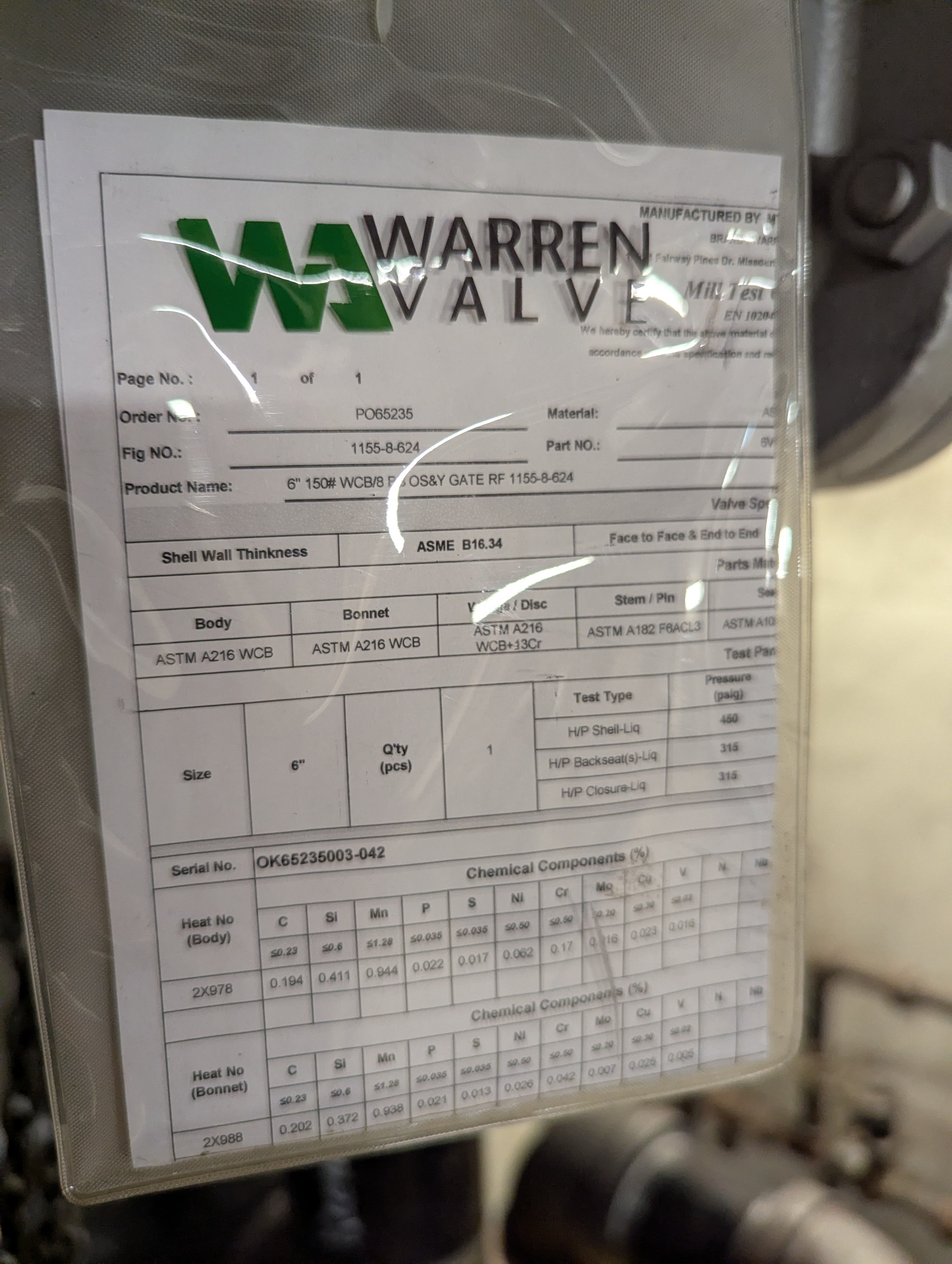

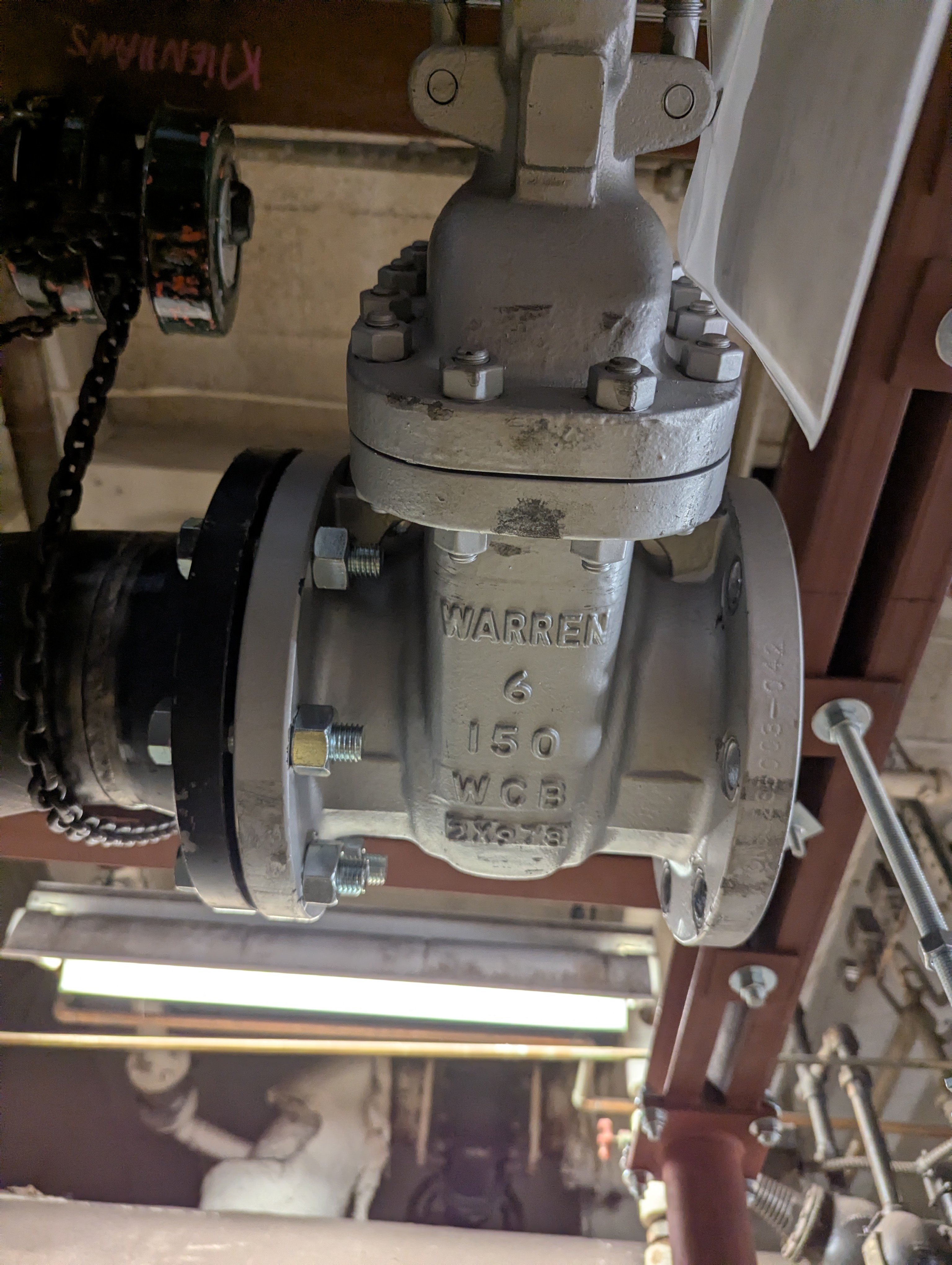

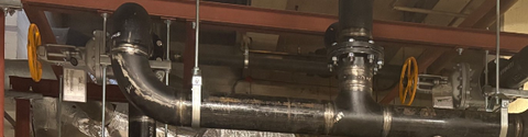

    I stopped by the job to get some close-ups of the king valves they were using in case anyone is interested.
  • Double D

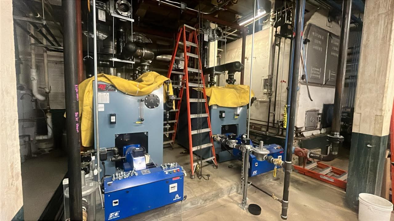

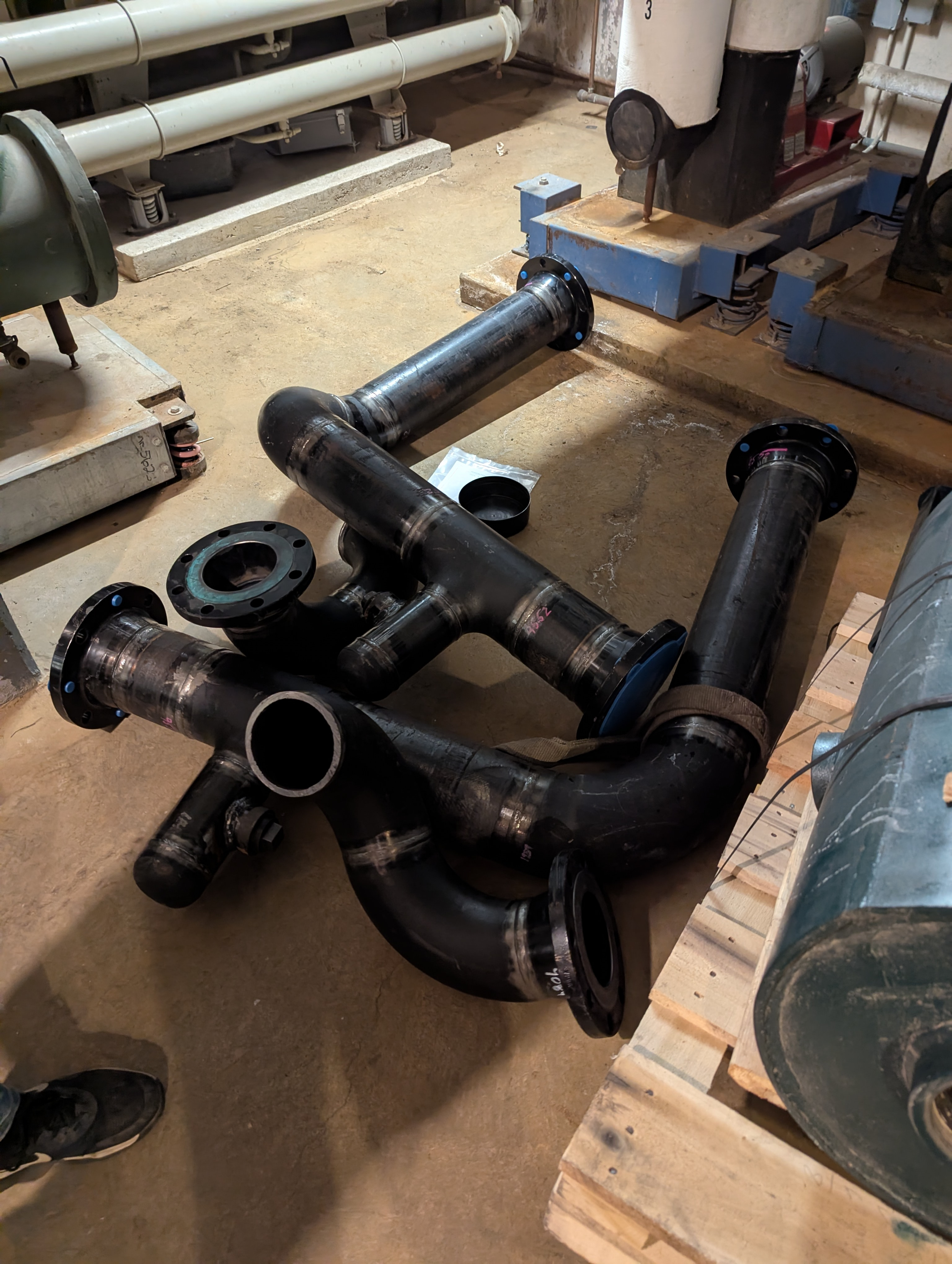

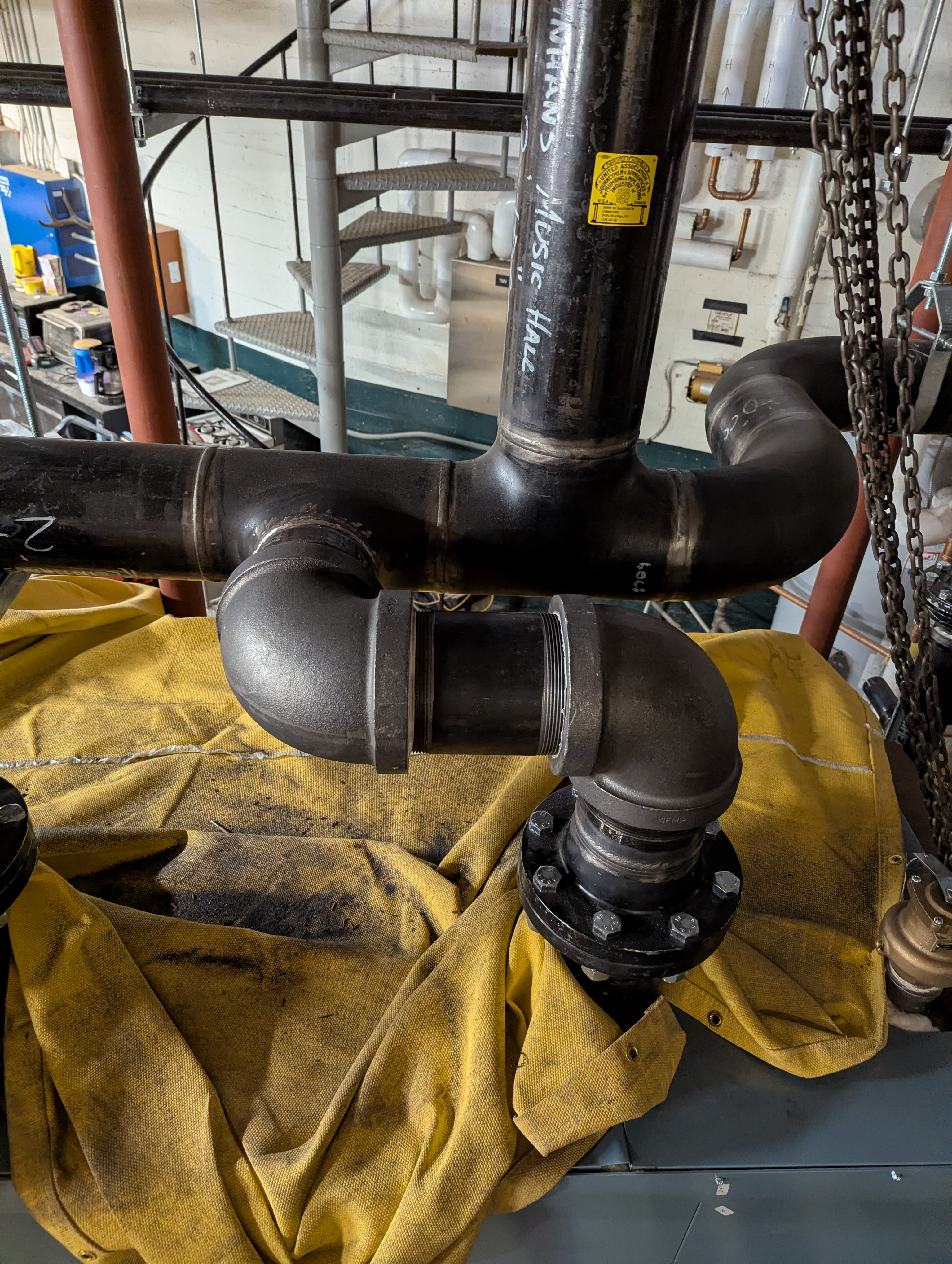

    They removed the piping to the colliding header and put it in a pile outside the boiler room. They also removed the welded 90s on the boiler risers and used threaded 90s. The welded equalizers were also removed and replaced with threaded pipe & fittings. Time will tell but it appears they are going to take the 6" from each king valve and bring them straight up into the existing 12" header.
    1000018098.jpg 1000018100.jpg 1000018093.jpg 1000018094.jpg 1000018092.jpg 1000018089.jpg
  • Double D
    As I suspected, they are going to pipe the boilers into the existing header eliminating the factory recommended common header. Should I suggest getting something from the manufacturer or does this write-up sound like something that will work? It appears to have been drafted by a sales rep.
