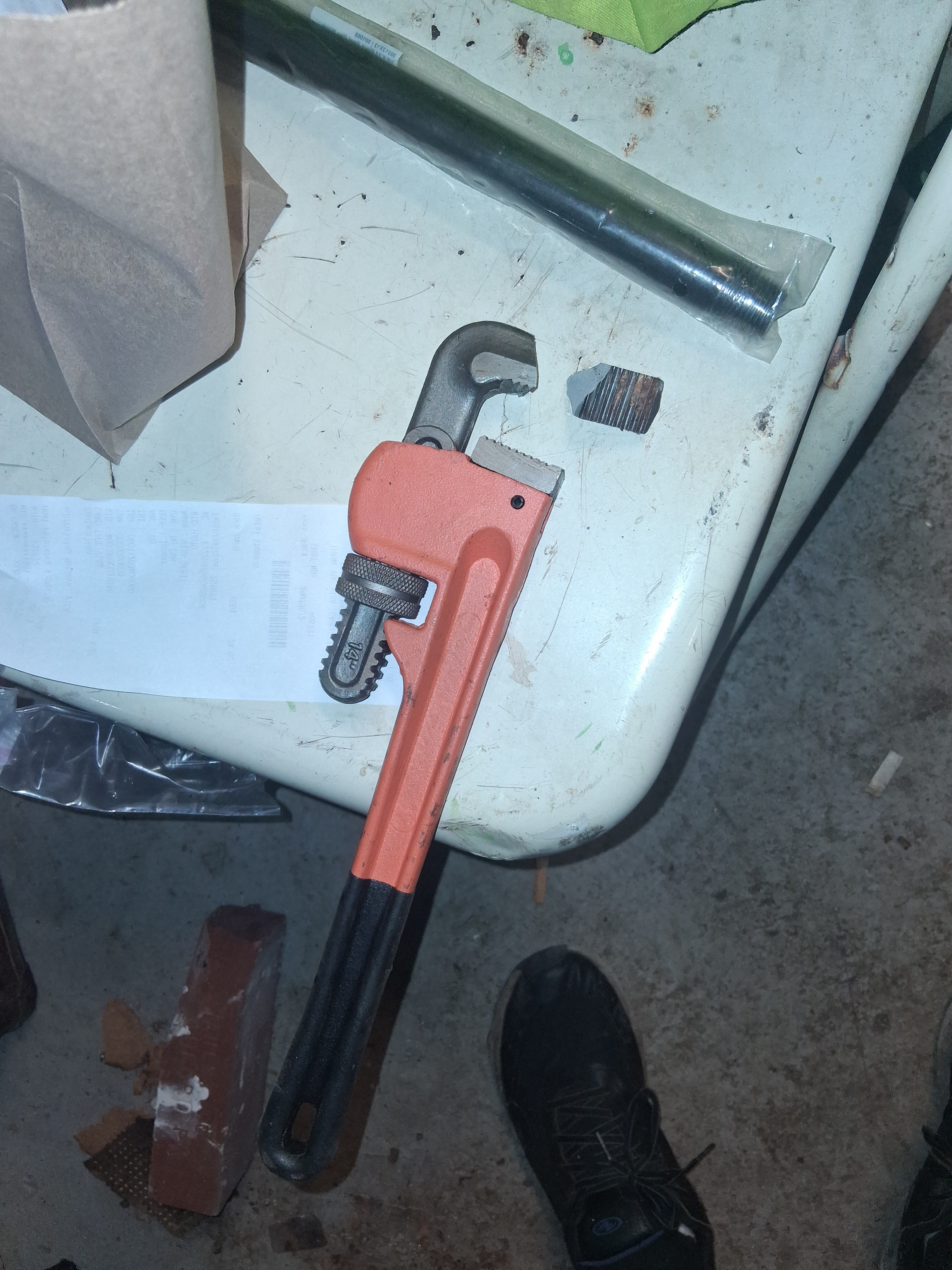

    So much for the big wrench theory! LOL I soaked that plug with PB blaster for a while and broke two wrenches and a finger trying to get that sucker out. Now that was just a test to see how much of a nightmare, I am looking at when the time comes to go from the new pipes to the old. Plan B is a saws all and a 2 inch and 1 and a half inch NPT cutting die and a couple of unions to patch in the old to the new. Unfortunately, I came across some information that suggested attempting to cut threads on what "MIGHT" be cast iron pipe is a bad idea. Plan C is to cut the pipe where i want the old to meet the new and use a dresser coupling. Now I am not an experienced plumber when it comes to dealing with 100-year-old heating systems, but I am going to guess that using dressers couplings is not a standard practice when it comes to dealing with these situations so any opinions on this subject would be greatly appreciated. Thank you.

    i also don't think that is where the most stress is if the bite is such that the back of the jaw is bearing on the pipe. usually you bend or break the handle before the jaw

    " So much for the big wrench theory! "
    I don't see any big wrenches !!!

    I wouldn't even try a wrench on that, it's been there too long and looks happy where it is. I would cut off the square drill a hole large enough to fit a sawzall blade and cut out a pie piece. Break the rest. Don't cut too deep.
    Ironmanscatgo
    Drill and cut and it will come out. But it would be easier to remove the insulation and cut the 90 off.

    I’m not sure why you’re trying to remove that plug, but I would get back to where you can remove the entire fitting if necessary.
    And I’ve seen the handle of a 5’ Rigid pipe wrench bend from four men with a cheater pipe on it, but I’ve never seen a Rigid jaw break. You get what you pay for and that’s why quality contractors buy quality tools, not Chinese junk.

  • Hi, One more possible approach is to remove the insulation, then evenly heat the fitting around the plug. You might get it to expand enough so the plug will finally come loose… with the right wrench of course 😎

    heat doesn't just work because things expand, it also drives the water out of the iron oxide crystal which is what holds the crustal structure together. it turns the rust in to a soft powder.
    being slathered in what appears to be asbestos furnace cement complicates this
