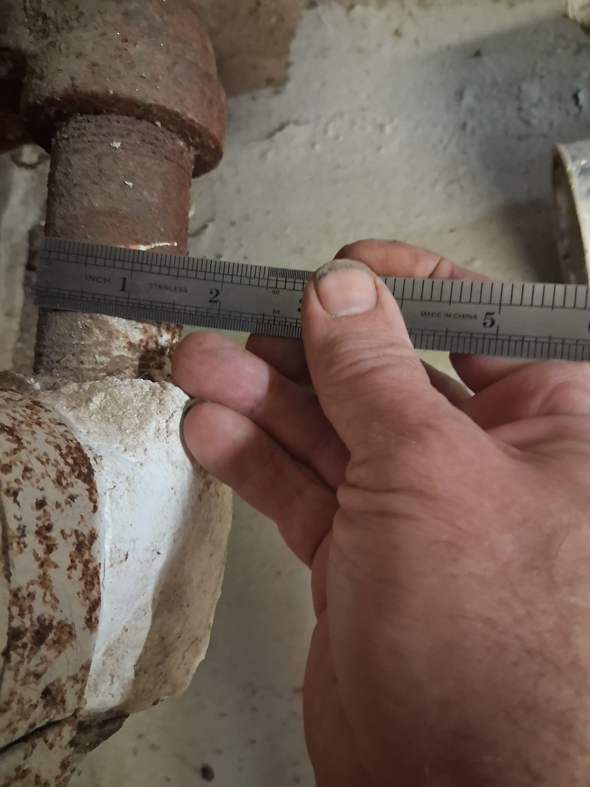

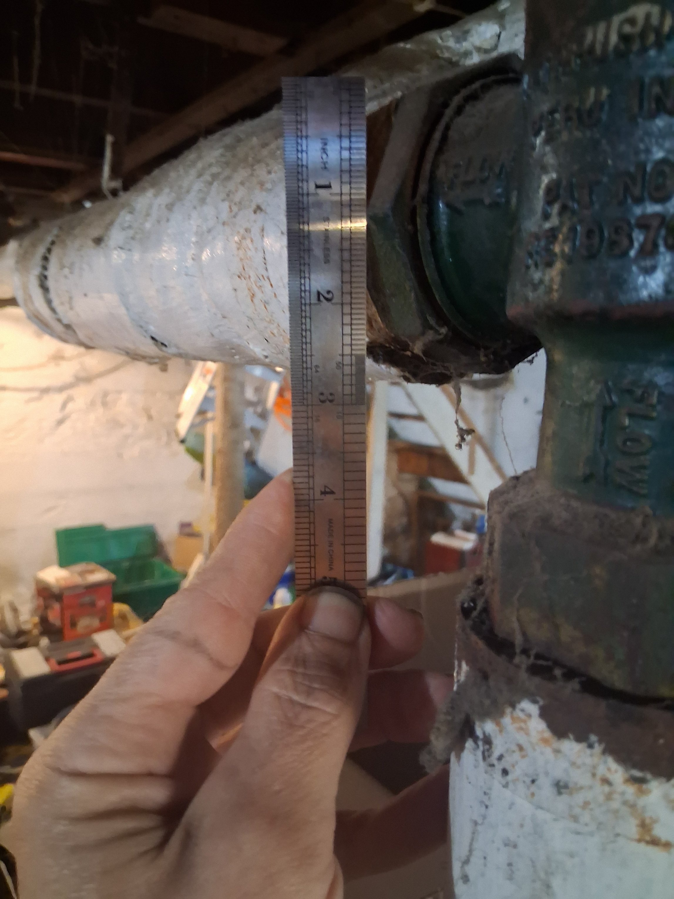

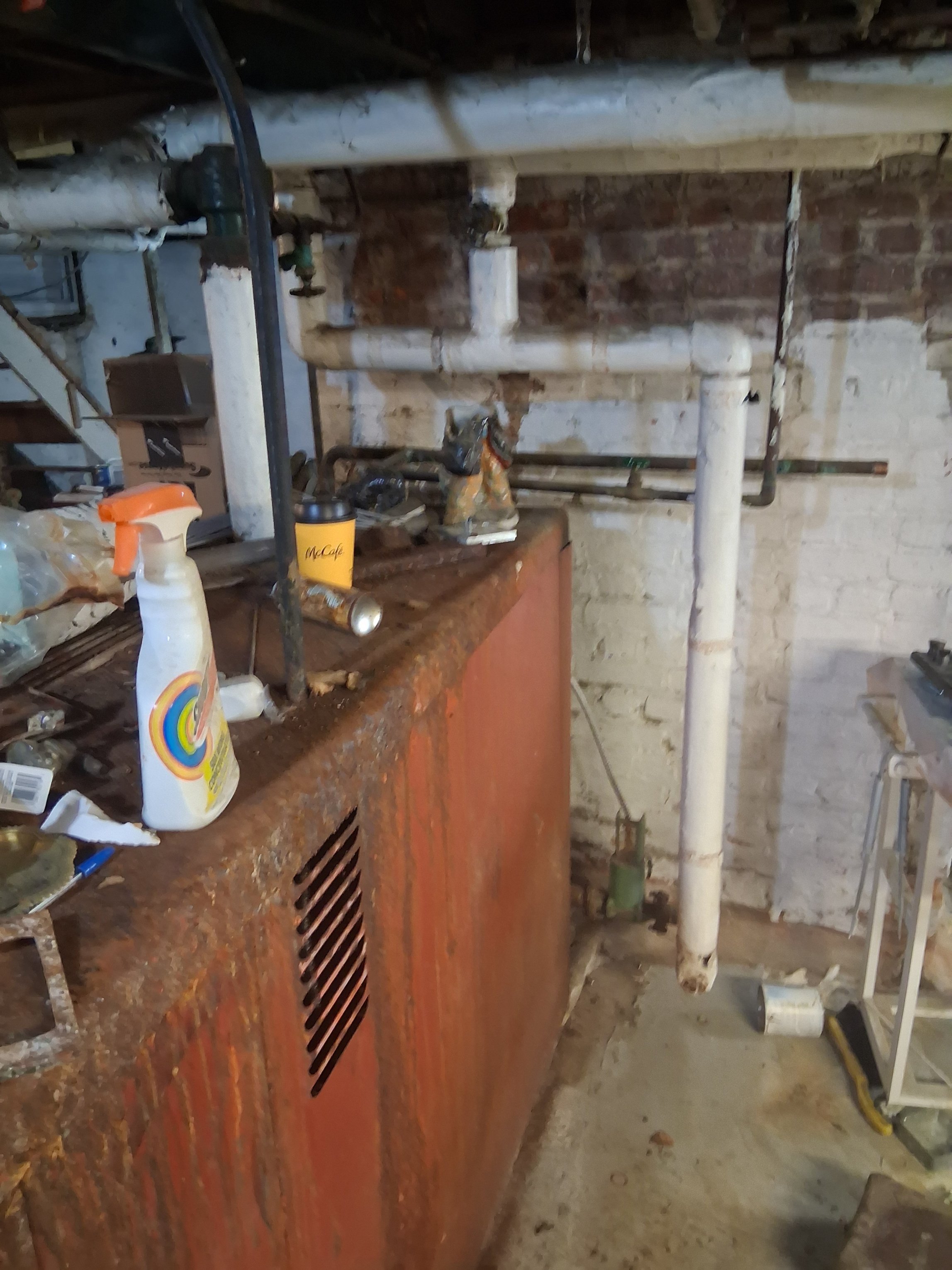

I am going to install a weil mclain aqua balance 120 heat only condensing burner. I got the manifold for the unit that has a 1 inch supply and return pipe. The plumbing on my 90 year old furnace has a return pipe of about 1 and a half inch. The supply pipe looks like it is as big as 3 inches. To jump from 1 to 3 inch on the supply doesn't sound right. Will this cause problems?
I wonder if the original system was gravity hot water and later converted to pumped?
No, the change in pipe size by itself won't cause any problems. But… if it was originally gravity and is now pumped, by may have some balancing problems.

That looks like an old gravity flow system that’s been/being converted to forced flow. We do a lot of these and the basic rule of thumb that Dan taught us has always worked: divide the size of the gravity piping by half, then go one size smaller for your new, near boiler piping.
One thing that’s very important and that you must address: the old piping and radiators can contain a lot of sludge and rust. You must get it out because it can destroy modern circulators and clog water tube heat exchangers and other components.
We start by flushing the system with water until it returns clear. Expect to use a lot, maybe hundreds of gallons.
Install a Dirt Mag or Sep4 LLH. Add a cleaner like Fernox and check the system after a couple of weeks of running. Repeat flushing as needed.

Thanks. I just hit the basement and took a closer look. It was the huge nuts on the union that is on both ends of the flow control valve that threw me off. First chance I get I am going to remove some of the insulation so I can get a more accurate measurement. And the circulator pump that is on there now is a taco 007-f3. The specs on it are 23 GPM and everything is keeping me toasty warm. Its possible that things might even get a little better once I dump a couple of gallons of Sentinel X400 System Restorer in the present setup. The only reason I am dealing with this whole situation is because the last couple of winters I got gas bills that were 500+ bucks for at least 4 months during the heating season and not much lower than that for the rest of the winter. That's not going to jive with my retirement plans and is somewhat kicking my azz right now. While we are on the subject of plumbing PB blaster has always worked great for me on automotive situations but i did notice when you spray it on a hot pipe int tends to evaporate kind of fast. I do plan on spraying everything I am going to have to touch at least once a day for about a week or two, but I never had to deal with 98 year old iron pipes. am I heading for a major nightmare when I try to patch into the old pipes?
