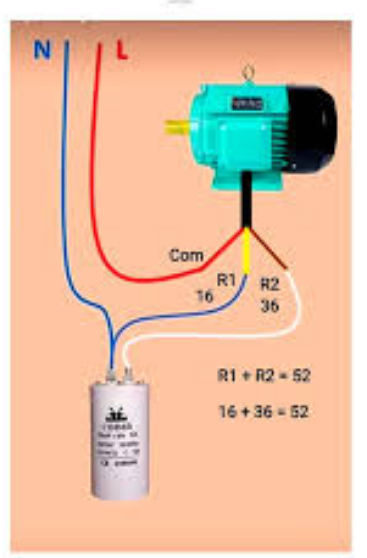

Replacing thermostat circuit board in a Taco 006 with a 5 wire fan capacitor?
Jells
Jells Member Posts: 649

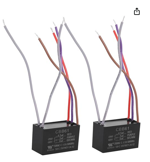

I'm adding a relay unit with C wire to enable a smart thermostat, and one way to do it is pull the board from the Taco and replace it with the relay, but I still need a starting cap. Will a fan cap like these work? I have one sitting around. My recollection of electronics says yes as long as the Mf rating matches and the voltage is high enough. But how do I wire it in? The Taco has a red, black and yellow from the motor. Obviously I ignore the red & brown wires, but then what? Or does it need to be a 2 wire electrolytic capacitor?

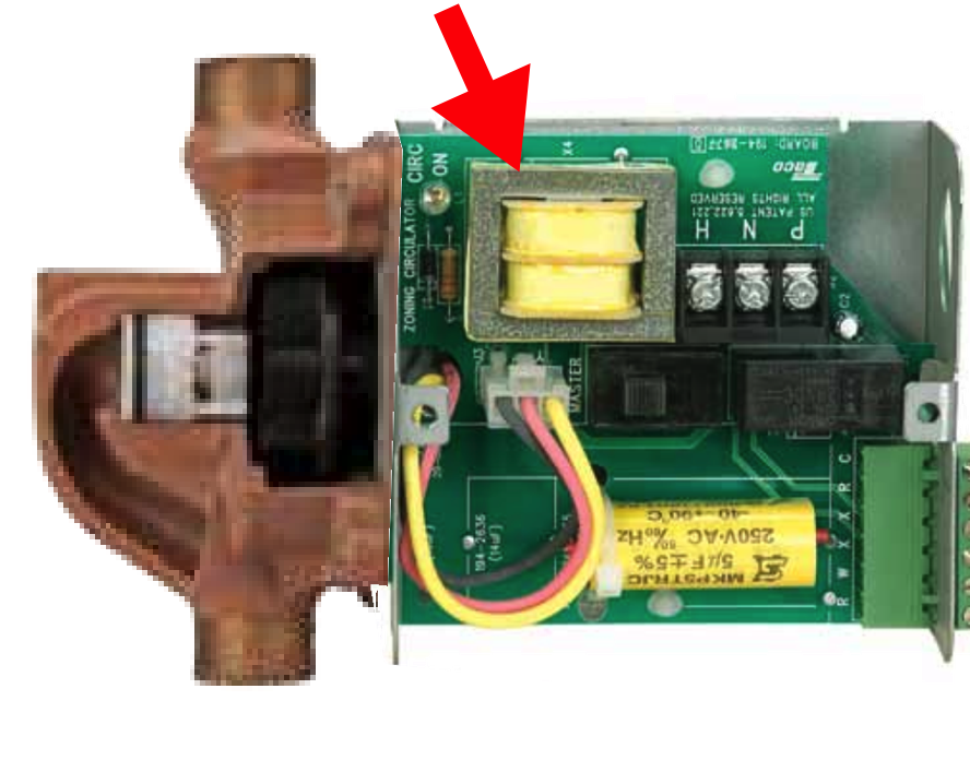

    If you are talking about the Taco 006 ZB-4, I am not understanding why you need to remove the circuit board?!? If it has a printed circuit board on it, then that IS the relay you need to operate the smart thermostat.

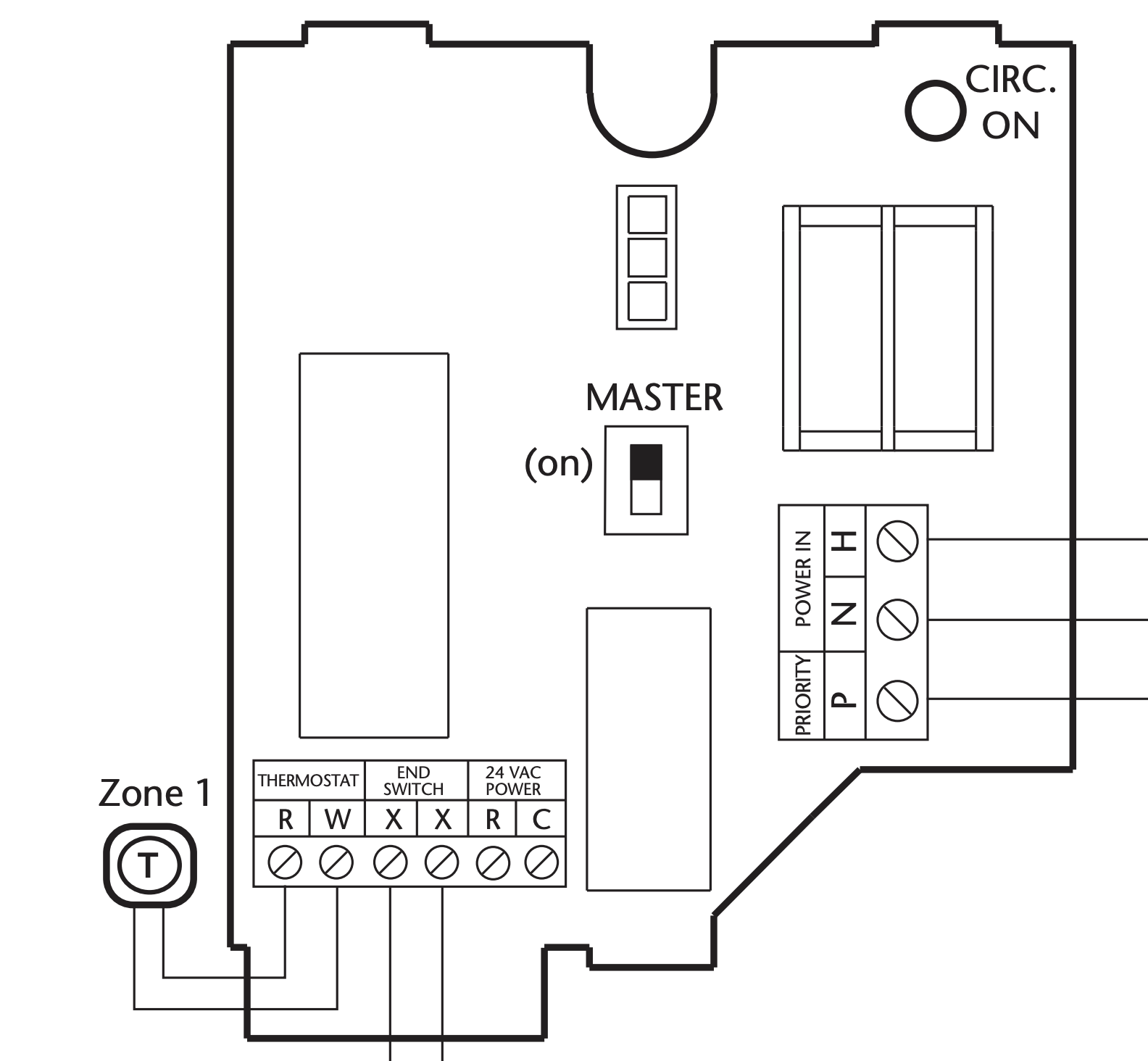

    Across the bottom row of terminals are the place you connect the R from the thermostat, then the W from the thermostat. Then X X are connected to dry contacts to operate the burner when the zone relay in the 006 gets a call for heat. next is the the R for the transformer which is the same wire as the R to the thermostat behind the board. Then the C for the transformer that gets connected to the C on the thermostat.

    What's the VA rating on the transformer on that board?
    There's a Common available, but can the transformer handle it?

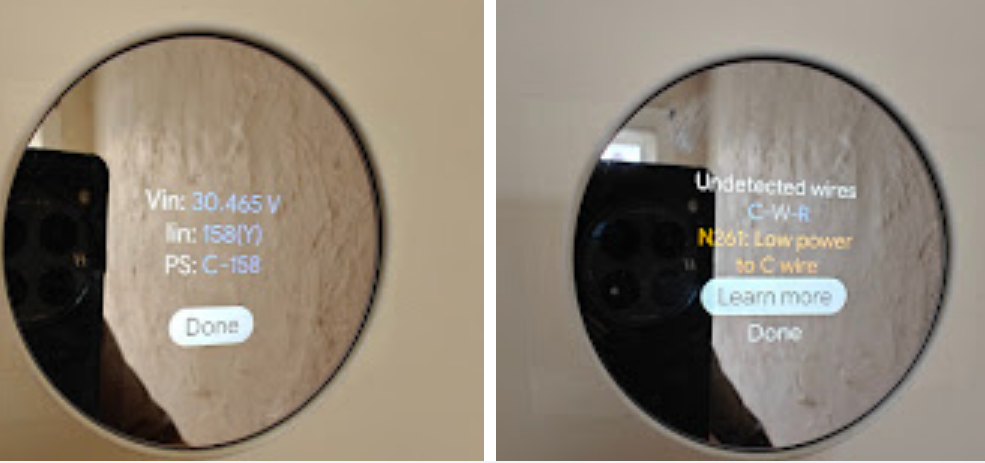

    I am getting an error using the onboard C wire even though it registers voltage. I've triple checked the connections on both sides, even pulled out the R from the Nest connector and touched it to the W, and the Taco started. Dunno.

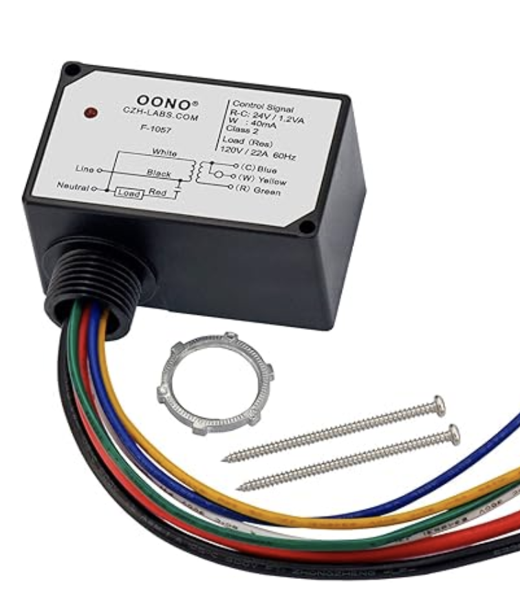

    @109A_5 Yes, I've used a packaged unit with relay and transformer to control a circulator, https://www.amazon.com/dp/B0C4LXXYHK. it's designed for resistive heating but works great for this. But that one was external, I didn't mess with the Taco's board that wasn't a relay board anyway.
    @mattmia2 note the photo of the 5 wire cap. you choose which of the 3 capacitances you want, and seems like maybe the 2 gray are continuous, so it's really only 4 wire, and you only use 2. But my question stands, if I want to replace the board with a capacitor, how would the wiring go? Is it like the diagram below, but with the R2 from the motor being the black wire?

    @Jellis said: "I am getting an error using the onboard C wire even though it registers voltage. I've triple checked the connections on both sides, even pulled out the R from the Nest connector and touched it to the W, and the Taco started. Dunno."
    Then the transformer on the Taco on board does not have sufficient power to operate the NEST Thermostat. Use an separate transformer and isolation relay to power the Nest. The relay contacts can close the R and W on the Taco PCB. No need to reinvent the wheel, Isolation relays are used by Nest Pro installers all the time. I have several posts about using an isolation relay in this diascussion I started a few years ago:

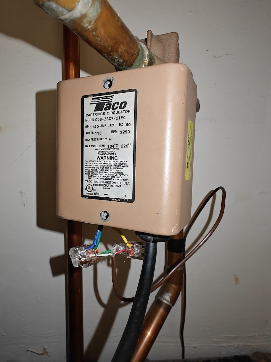

    Basically, the OP has a circulator with the control relay (PC board) built into it. But the transformer in the circulator control relay is not sufficient to add the mirrored cereal bowl smart thermostat to its list if amp draw. The capacitor, which is part of the OEM control relay PC board, is not part of the OP's replacement control relay. So the OP needs to source a retrofit run capacitor for the circulator. Yes, this is what we've become. I want to know if the finished product at the very least fits in the original Taco electrical enclosure. Or will it be Dr. Frankenstein meets MacGyver?

    Thanks for seeing through the haze and summarizing! Yup, all fits fine. Only ugly is the 3 low voltage leads coming out of the enclosure to connect to the thermostat wire. I double and triple checked the damn Taco board, the Nest kept telling me my white was disconnected when shorting the red to it started the pump. ??? Whatever, it's done, it works, it was short money for the parts, like $35. It lets me look like a good landlord providing fancy thermostats, given out free by my utility!

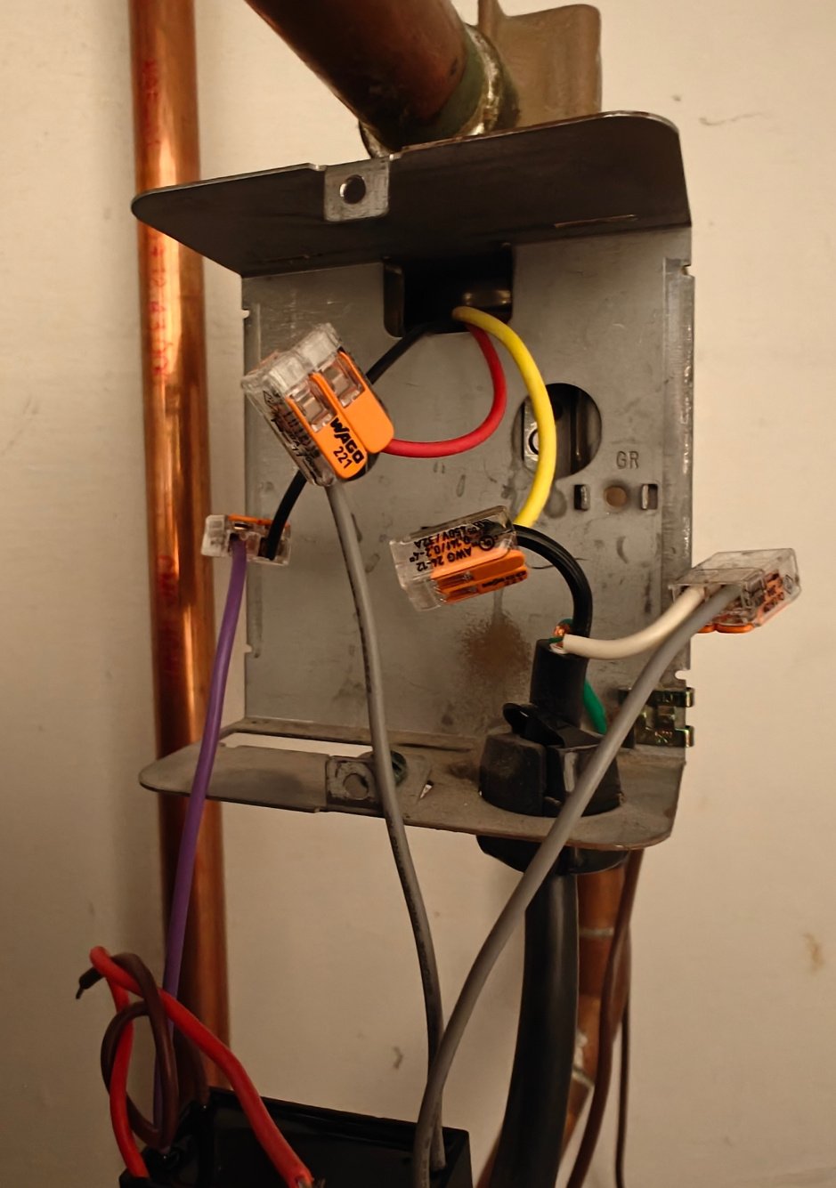

    Yeah, I missed the broken insulation on the line in, but there's nothing conductive flying loose around the enclosure, there were exposed conductors on the circuit board I removed too!

    Then just add the Cap https://www.supplyhouse.com/Taco-007-002RP-Taco-Capacitor-for-Select-003-008-Models
    Or find a lower price equivalent. Nevermind… I see the original post with the three different uf value capacitors with the same enclosure. The purple and one of the grey wires = 5uf. Does that Cap have the same or higher voltage rating? Did you cap off the2 unused leads separately?
    @Jells, Can I ask you what relay you are replacing the Taco PCB with? Since you already own the relay, I have a feeling that you may have been able to add that relay/transformer unit to the Taco 006ZB-4 without removing the Taco PC Board that included the Taco capacitor.

    I had linked it far above in the thread, but I can understand not wanting to rummage. https://www.amazon.com/dp/B0C4LXXYHK
    What I can't understand is all the people in this thread acting like old women, afraid of anything different that they don't understand, of skinning the cat a different way. Yes, I could have taken that unit and mounted it externally to the Taco, using the relay circuit to simply close the Taco's thermostat circuit. But it would have been clunkier than doing what I did, and not been all neatly contained in the original enclosure.
    The original Taco board had a transformer, a relay, and a capacitor. I replaced it with... a transformer, a relay, and a capacitor!
    Edit: yes, I clipped the leads for the other two capacitances and screwed on small wire nuts.

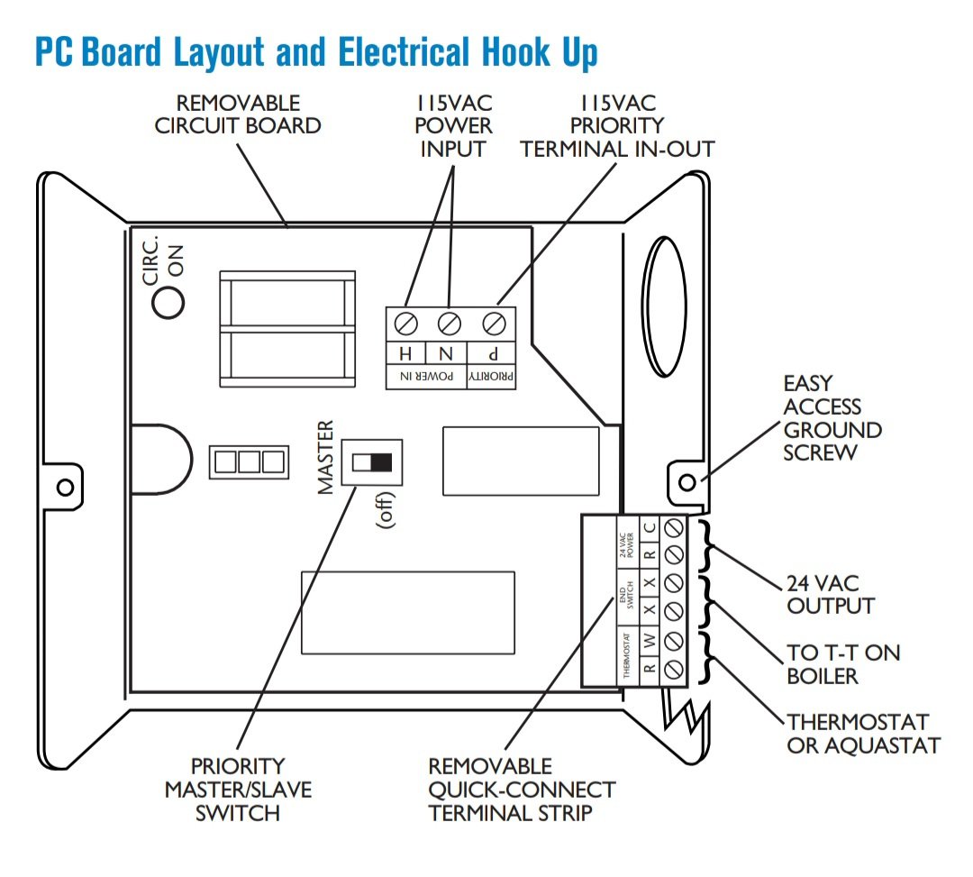

    The problem with removing the PCB to get rid of the transformer, you loose the Capacitor. The Nest likes this transformer relay combination, but the Capacitor is missing so the motor won't operate.
    So adding a $10.00 Capacitor and a $30.00 relay/transformer thing gets the system to operate. I just think that a $25.00 relay would be a less expensive, less time consuming, and a less liability way to do the job. But that is just my opinion. The different relay/transformer combination would allow for low voltage to operate the Taco PCB. The Combination relay/transformer that @Jells purchased does not have the ability to do the low voltage contacts, only the line voltage circuit switch is available to turn on the circulator motor. And it all fits inside the electric box on the pump housing.

    If I came across this in the field, my repair would include replacing that circulator, along with the parts to do it right. You might be able to get Chuck in a truck to fiddle with it, but can he offer you the warranty that I do? Or the insurance, or bond, or licensing?
