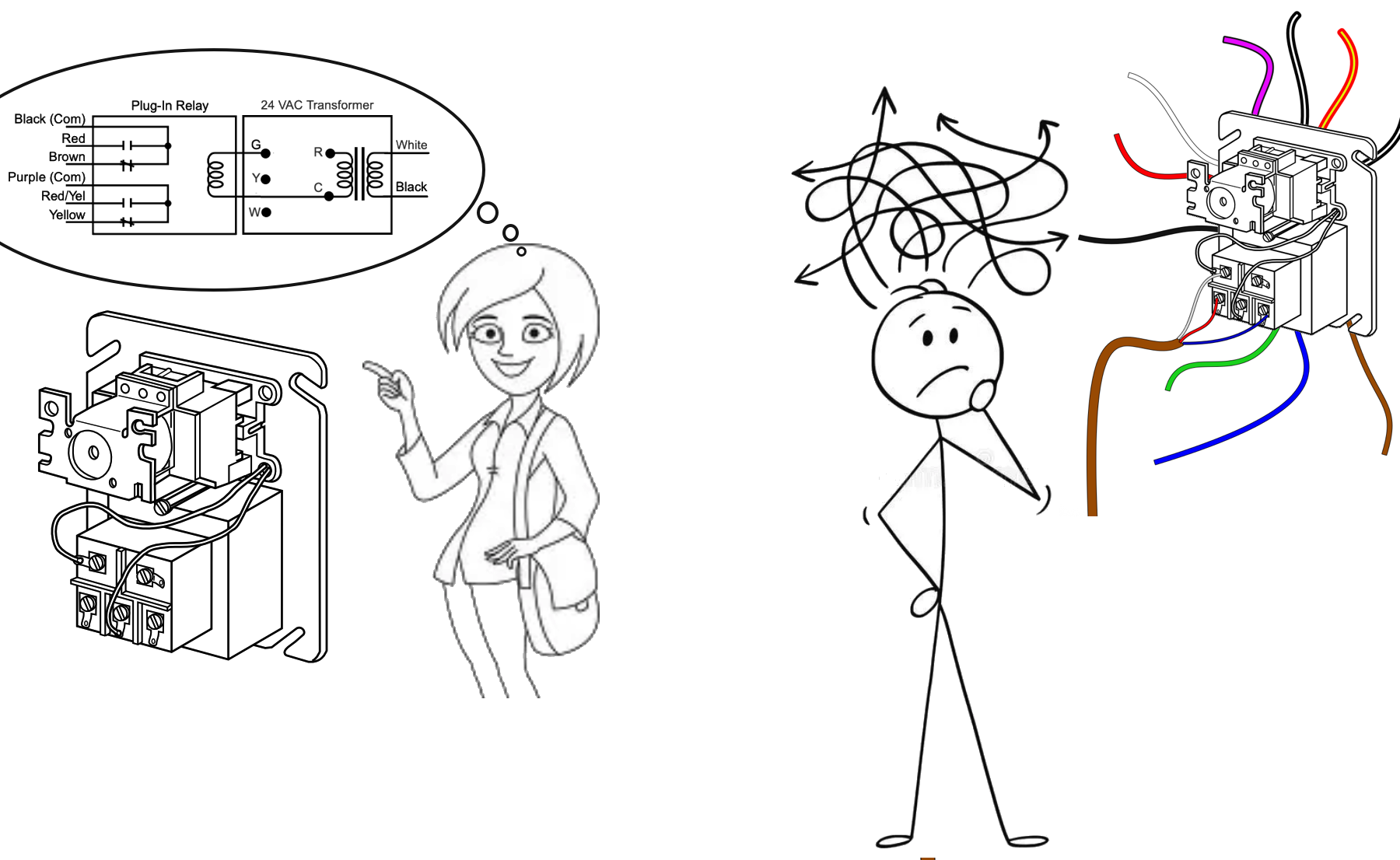

How Do I Connect This Wire?
EdTheHeaterMan Posts: 12,940
I have made several wiring diagrams in the recent past in order to help others solve a problem they encounter. Some are simple, others are more complex. Digital electronics and technology are built into just about everything from our cars, to our front door locks and cameras, to the thermostats that we use to keep us comfortable. I think that stuff is great, but I would not know the first thing about a chip or a diode or a triac or transistor or any other pieces of these electronic wonders, gets put together. I am strictly an analogue relay and switch kind of guy. So when it comes to HVAC controls and how to make them work, I break it down to the simplest common denominator. What gets turned on and what gets turned off based on what you are asking the equipment to do for you.
The NEST thermostat is one of those marvelous pieces of technology that has no contacts, switches or relays inside it, but somehow it opens and closes circuits on analogue type HVAC equipment just like a conventional set of contacts on the older thermostats, in order to turn a gas valve on and off, or a compressor contactor to energize and close a set of contacts or to de-energize when we get to the proper comfort level.
A fellow wallie
@MikeAmann, gave me this great idea to post a discussion with some of my wiring diagrams after one of my ideas helped solve an issue for him. So here it is,
As I post different solutions to common problems and maybe some rare occurrences too, I will copy and paste them here. And I am going to start with one of
@pecmsg's favorite subjects, the one that seem to come up more often over and over The Dreaded C wire for the NEST thermostat and other smart thermostats.

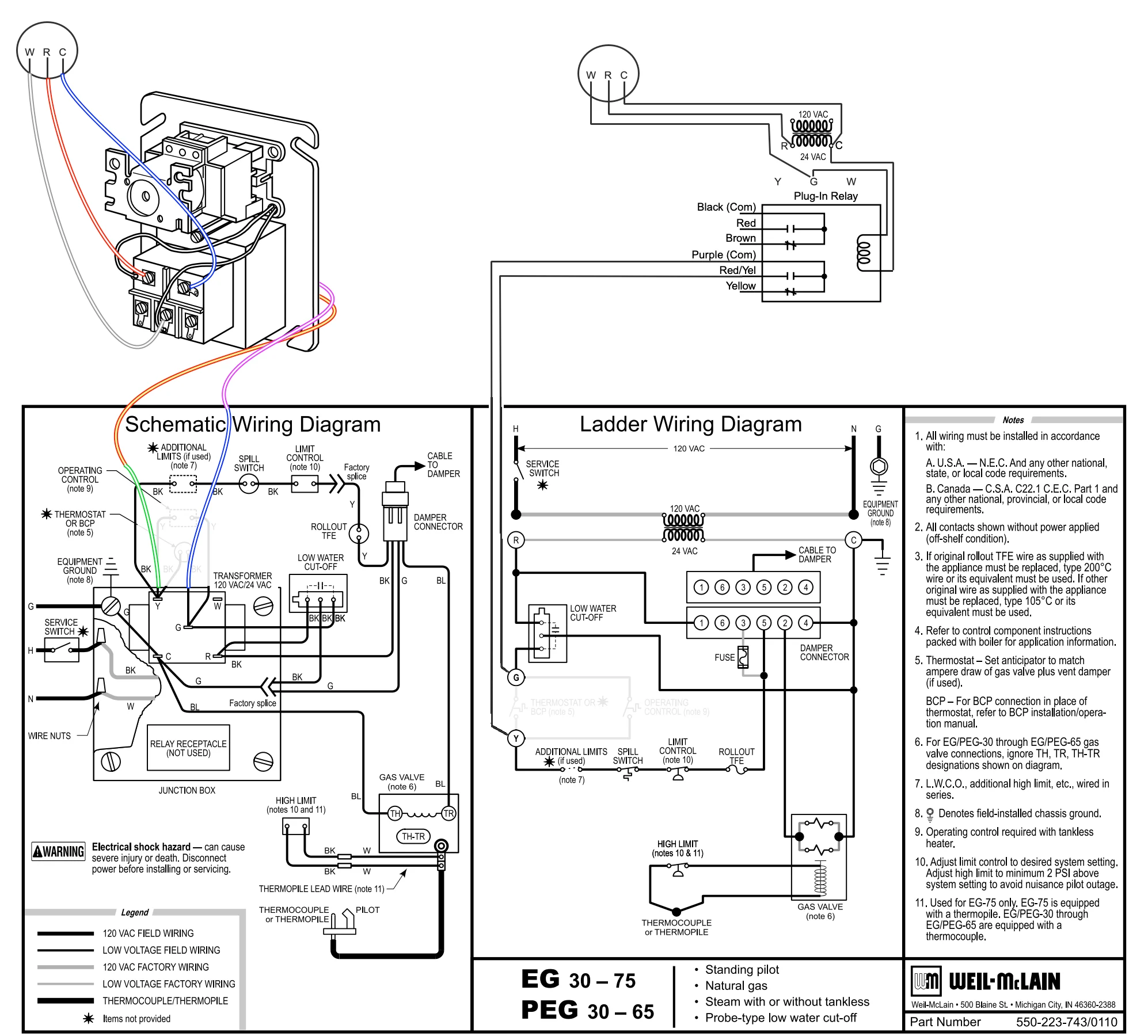

  • Weil McLain Steam boiler with NEST, No Relay needed
    FROM:
    https://forum.heatinghelp.com/discussion/188201/adding-c-wire-to-weil-mclain-steam-boiler
    Here is the updated wiring diagram if you feel competent to rewire the low voltage exactly in order to keep the limit and safety controls operational in accordance with industry standards.
    The easier way might be to use a separate transformer to power the thermostat and an isolation relay to perform the thermostat function in the existing wiring location.
    reggiPC7060Robert_H

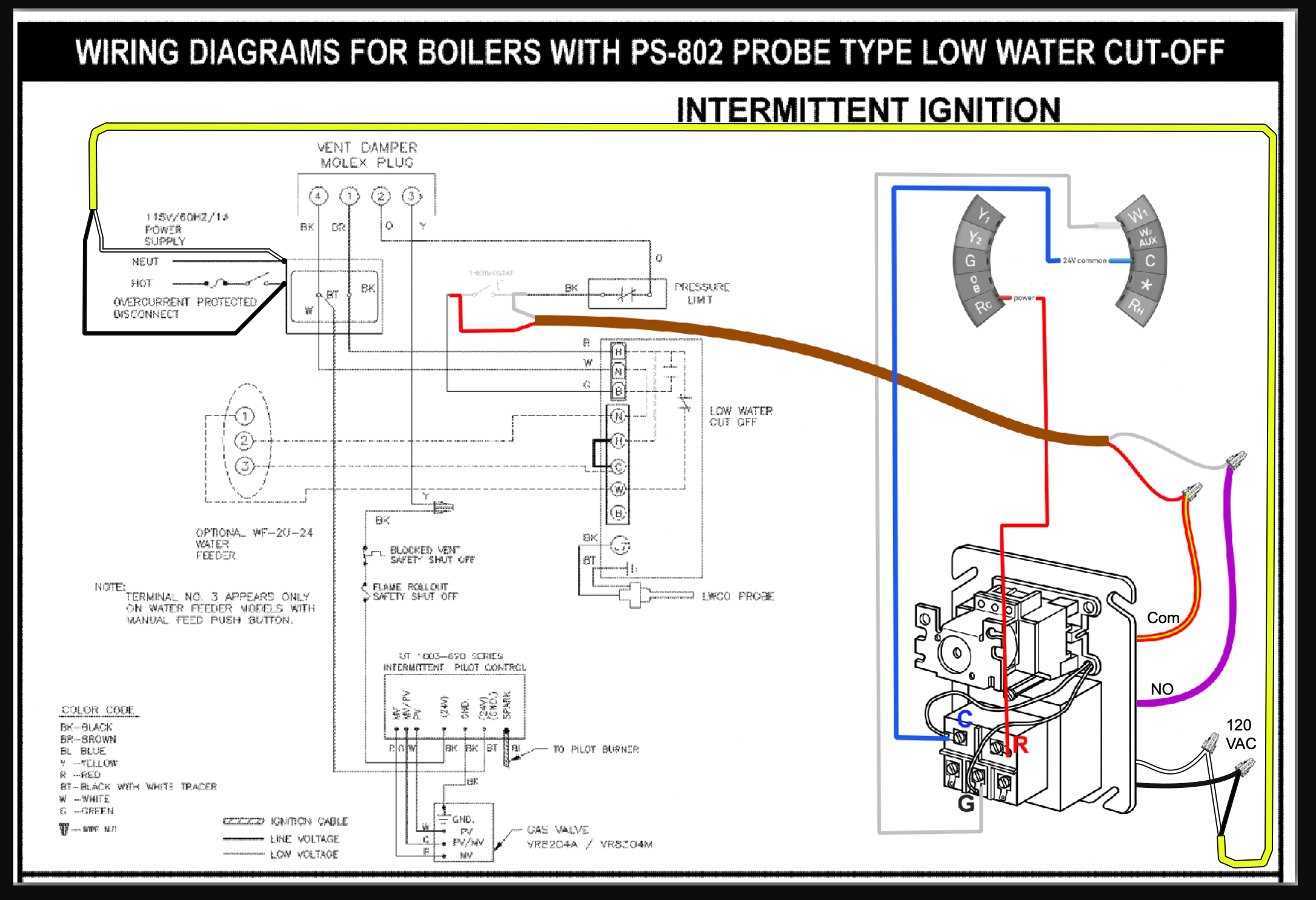

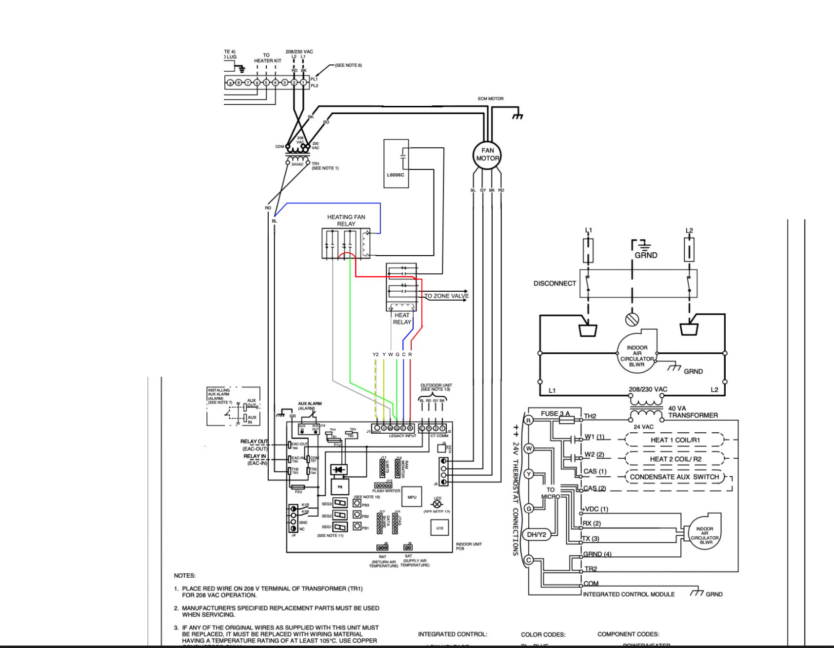

  • This gentleman had a problem with his thermostat (so he thought) because the fan would blow cold air for extended periods of time during the heating season. A professional tried to make some type of control adjustment to operate a Hydronic fan coil with his new variable speed air handler. The problem was the time between heat pump operation to hot water in the duct coil could take up to 4 minutes before warm air started flowing.
    This diagram was the result of my research and trying to solve the same issue at my son's home.
    https://us.v-cdn.net/5021738/uploads/editor/ox/52djtnnkjm67.jpg
    Here is the discussion where that diagram originated:
    https://forum.heatinghelp.com/discussion/comment/1714548#Comment_1714548?

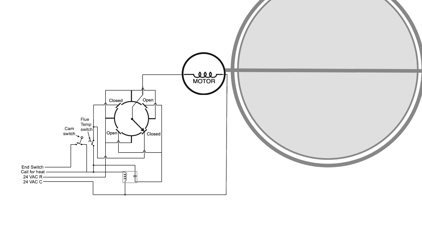

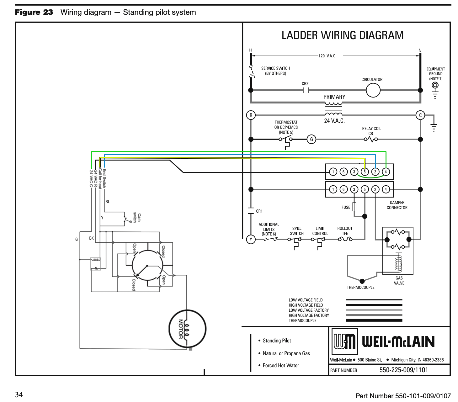

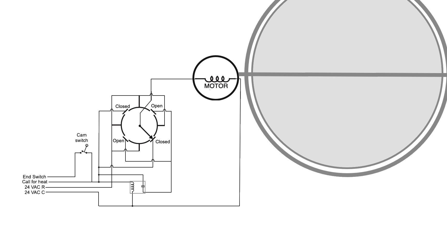

    Here is a possible wiring diagram that MAY help you. Post picture of the inside of the L8148E control you have, and the make & model number of YOUR boiler. It looks like a Hydro Therm but I may be wrong
    The basic concept (Operational Logic) of an automatic vent damper is to close off a natural draft chimney in order to reduce the down time loss of heat from the boiler and inside the home safely. You don't need Draft Exhaust if there is no flame, because there is no dangerous exhaust when the burner is off.
    This must be done Safely by not allowing the burner to operate if the damper is closed. No path for exhaust equals no burner operation.
    To accomplish this Safely, the motor mechanism must have 24 V power always. This is to be able to close once the controls and safety devices determine there are no exhaust gases that require venting. The Motor is actually connected to what we call an Actuator. This is the motor and some switches, thermostats, and relays that by design, regulate when the damper may close. In the case of Field Controls and other control manufacturers like United Technologies, and Honeywell, the Molex plug terminal 1 and 4 are the terminals that have constant 24 volts for damper actuator operation. Once it is safe, 24 volts on terminal 1 and 4 will operate the motor until the damper is closed. The internal switches and relays will stop the motor from operating once the damper is in the closed position.
    In this closed position the gas valve can not get power to operate the burner as long as the damper is in the closed position.
    On a call for heat, IF all the other safety devices are satisfied that it is safe to operate the burner, the #2 terminal on the Molex connector will be energized with 24 volts and the damper motor will start to turn. The motor turns until the damper is in the full open position. Once fully open, the internal relays and switches stop the damper movement and the damper will stay in the full open position. Another set of switches and relays will then energize 24 volts to the #3 terminal on the Molex connector. This then sends power to the gas valve to open and allow the flame to establish. As long as there is a flame or other source of exhaust gasses (or perceived exhaust gasses... by high temperature in the exhaust pipe may be one way to tell) The damper can not close.
    Most automatic vent dampers operate on this principle. Some have a spring opening and electric close, but most brands have a damper plate that rotates in the same direction making a 180° revolution every cycle or a 360° revolution every 2 complete burner cycles
    Regardless, what ever brand or design of vent damper you have, the safe operation MUST be maintained by proper wiring, and free unobstructed path for the damper plate to open.
    All the Professionals on this site fully understand this Sequence of operation (or Operational Logic) for vent dampers. Not all would like to deal with manually wiring of the device and prefer to just "Plug and Play" using a new control on a new damper ... where the now universally accepted "STANDARD DESIGN" makes wiring effortless and fool-proof in most cases.
    I hope this helps you with your particular situation. If you feel up the the job, you now have all the information you need. If you are not comfortable with control wiring or do not fully understand the safety and importance of getting this right, then PLEASE GET A PROFESSIONAL that understands how this should work. Where do you find this technician? Go to you local Plumbing and heating or HVAC wholesaler and ask the counter man, "Which one of your customers is good at control wiring?"

  • This post from January 2024 has the typical Steam Boiler wiring diagram that uses the "Fan Center" type transformer with a relay socket that is not used, since a steam boiler does not need the relay to operate a circulator (or fan for that matter). The following diagram is the same thing when use on a water boiler that does use the relay to operate the circulator. this one has the vent damper circuit, but it is not the important part of the diagram. the C wire is the important part of the diagram
    You can see that the Burnham and the WM are very similar diagrams. The important part of the diagram when you need the C wire is that the R on the transformer is connected to the R on the thermostat that requires the C wire. When the thermostat only had two wires, the labels on the black wires from the R and the G terminals were marked T T because it didn't matter wether the R on the thermostat went to G or R on the transformer. When you introduce the C wire, YOU MUST MAKE SURE the R on the thermostat is connected to the R on the transformer. After that it is easy top get therest of the wires connected.

    Here is one that I really liked working on. Someone wanted to connect a TAM7 air handler (American Standard/TRANE with Variable speed fan) with the AS Hydro Coil kit for heat, to a Navien ModCom combi boiler
    First diagram I did some crazy relays to operate the two circulator pumps and came up with this in order to prevent the fan from blowing cold air when the boiler stopped the CH circulators for priority on the DHW. this shows only one for the two Taco SR501 relays and the R4222 general purpose relay to stop the two pumps from operating, is also missing
    Then I looked closer at the Navien NCB wiring and found that the boiler control could handle up to 3 circulator zones. I was able to accomplish the same thing without the Taco Switching relays and made this diagram.
    Now the circulators for both air handler zones will stop for DHW priority while the AH terminals stop the fan on each air handler using the general purpose relay (Like an R8222A) And The OP liked the drawing but followed up with the fact that the first floor air handler was 2 zones by way of a duct damper zone control. So there are 2 zones on one air handler and one zone on a second air handler. All connected to a ModCon boiler that has ODR and DHW with a priority. And you don't want to blow cold air thru the duct work on a call for heat while your teenaged daughter takes a 20 minute shower. (yea I know 20 minutes is short for a teenager)
    So I came up with this one:
    Now connect the thermostats to the zone control for the first floor duct zones. The zone damper will connect to the TAM7 air handler that is turn will connect to the boiler control with the Hydro Coil accessory, using the boiler zone feature to connect the circulators for zone 1 and zone 2. On the second floor connect the thermostat directly to the TAM7 as shown in the diagram in the middle of this post. then follow the same diagram to connect to the boiler zone 2 with the Hydro Coil accessory.
    Now if someone does this for their customer and does not make this diagram so that it can be posted with the equipment somewhere, then they are no completing the job properly. How is the next guy supposed to figure this out?
    I hope this helps someone with a variable speed air handler that wants to connect to a hydronic heat duct coil using only one thermostat that will figure out everything by just setting the heat/cool switch and setting the desired temperature. That is all the customer wants to do. They don't want to become an electrical engineer in order to switch over from winter operation to summer operation.
