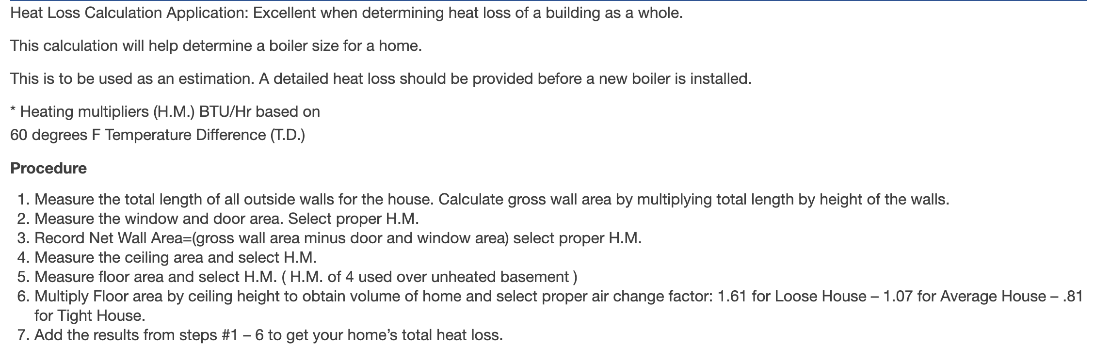

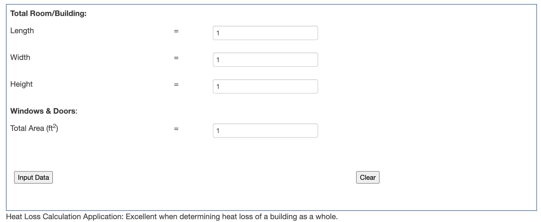

    How dose this look for a more accurate information? What would be the width? Each room?
    Heat Loss Calculator | U.S. Boiler Company
    hot_rod Posts: 28,705
    This particular U.S Boiler calc is looking at the home as a whole, measure outside walls, windows, doors. Follow the Procedure paragraph
    A more detailed load calc would be room by room. So use the same input data sheet and use the room dimension. A 10X 10' bedroom 8' tall for example.

    Can some one explain the math they want on windows? ft2? one window measures 41x51 inches. Just round off to feet? like 4ftx4ft

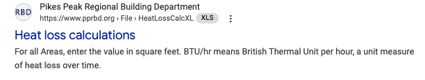

    Here is another option, in an Excel sheet format, try several of the options offered on this thread to you find the one that works best for you.
    They are all based on a Manual J formula, some allow you to enter more details and get a more accurate number.
    The infiltration will be a guess unless you have a blower door test done. But easy enough with a spreadsheet to change ACH and see how it changes your load number.
