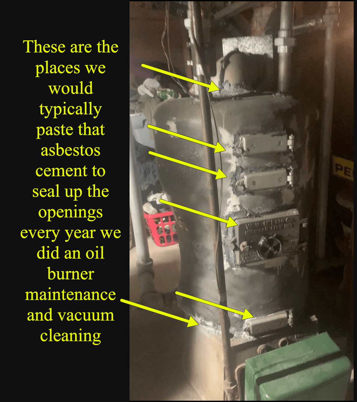

    I used to breath in Asbestos Dust while emptying 50 lb. bags of dry furnace cement into a 55 gallon drum so the service technicians could fill their metal cans with that stuff. We would then mix it with water and plaster it onto the smoke pipe at the base of the chimney and to seal the front doors or old boilers like this one.
    I don't have a diagnosis for the covered breathing disorders but If I got the right doctor, I might be able to ger some payments form the Asbestos Bankruptcy Trust, Mesothelioma Compensation Trust, Asbestos Settlement Trust, or Occupational Exposure Compensation Fund. I was as young as 14 years old when I went to the family business and was exposed to that stuff. And I only got paid 25 cents an hour. Those were the days!

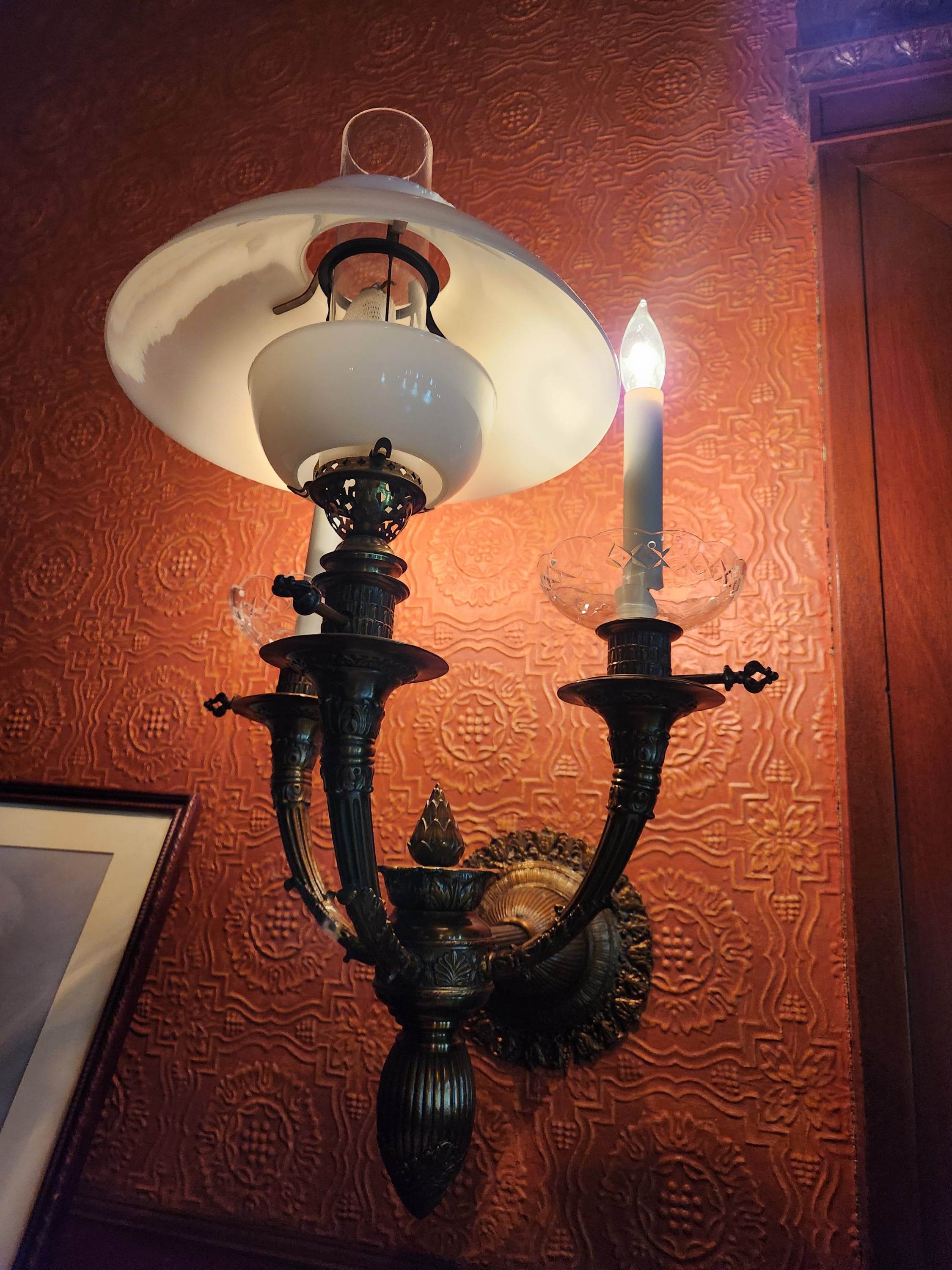

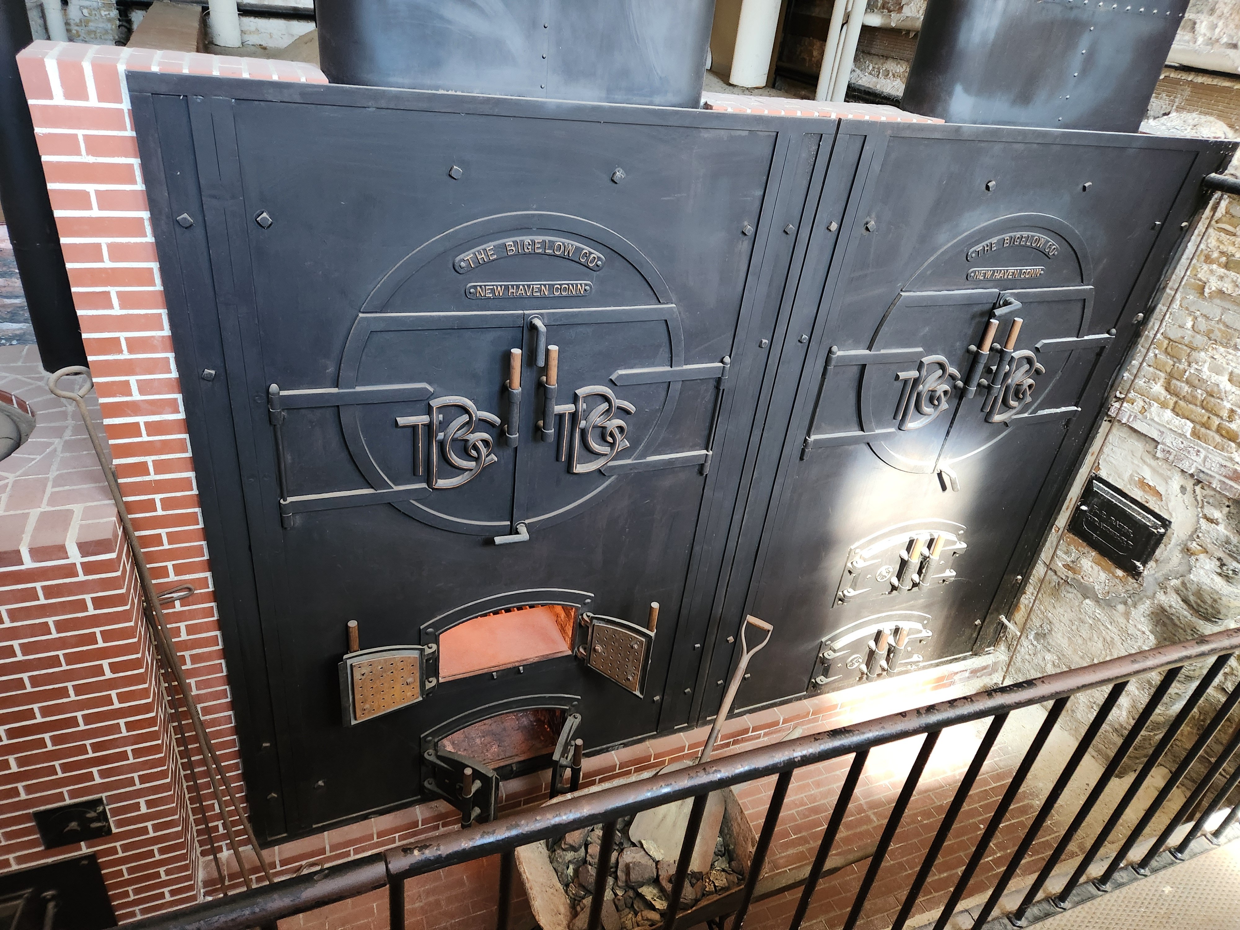

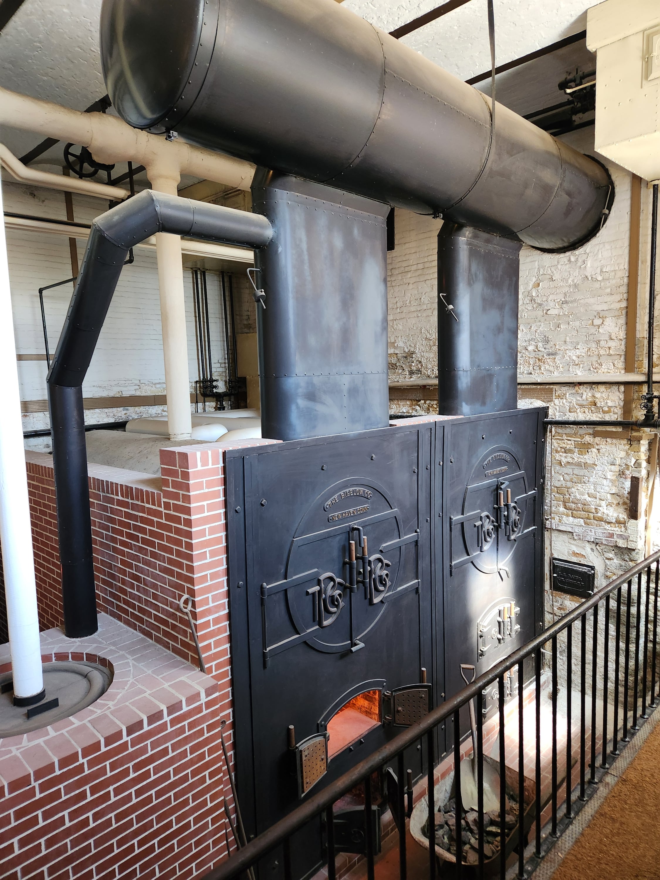

    Incidently, heres a few pics from that J.J. Hill home...pictures of the two coal furnaces in the basement. All gravity heating system, including a system that heated the ice build up on the roof and gutter system. The light fixture is a " dual-fuel" sconce light in the dining room. It has both electrical bulbs and natural gas " mantles" to provide light. Many people were skeptical at the time about this " new fangled" thing called electricity.
