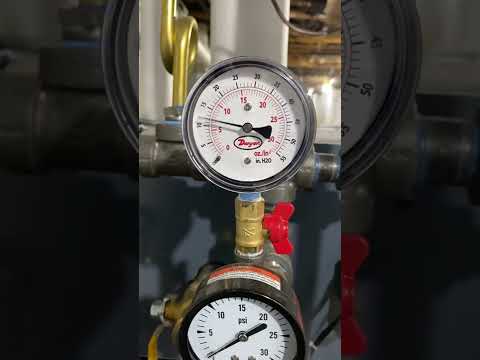

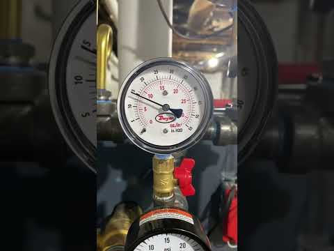

    Congrats on doing what he should have done! I like that gauge. It looks like .5 psi in that last video, right? How long did it take to get to that pressure?
    Did you or the plumber measure your radiation prior to selecting the boiler?

    It’s an old mixed use residential/commercial building. Old boiler was a slant fin 225,000 btu. It was feeding all three floors at one time but eventually the ground floor rads were removed and capped which made the boiler grossly oversized. It’s funny how “pros” just kept replacing throughout the years with the same sized boiler. New EDR calculation after swapping out one small rad with a bigger one is just under 290.
    Decided to go with a Weil McLean EG-40. 125,000 btu
    Now to answer your question. It depends on the set back and how long the boiler has been off. But after skimming, The gauge wouldn’t budge. I thought I bust it or something because it took a good 30 mins to even register on the gauge. Once it reached 1 oz, it took about 11 minutes to reach 16oz. Funny thing is, gauge was at zero oz but stream made its way to the end of the main in about 4 mins once I could feel the header was steaming. 4 mins at less than an oz on a 55 foot main told me the 2 number 2 Gordon’s were doing their job adequately.
    Once it cuts out at 16oz I have the cut in at 2oz. Originally I had it at 8oz to 1oz cut in but once I insulated the piping it really started to short cycle. 3-4 mins. I cranked up the vaporstat to 16oz that brought my cycle times to 9-11 mins. The reason I have the cut in set so low is because I’d rather save the wear and tear on the controls and gas valve by increasing the firing cycle to about 10 minutes.
    I still think the boiler is a hair oversized. I still have 2 issues left. The top floor rads start to hiss at around 4oz. I read on here that the Gordon’s are good to about 2 psi without noise once steam hits the vent. Second issue, I get these weird phantom slight water hammering noises up to 45 minutes after the boiler cycles off which has be baffled.

    Sounds like you have a great handle on it now. I agree probably just a little oversized, but very manageable, especially if you stay away from setbacks you probably will see very little pressure on there, which is good.
    If the slight hammers are happening that long after the end of fire they probably aren't hammer (since the steam is long gone at that point). Possibly contraction sounds or ? Or maybe someone else has knowledge of what might cause sounds after firing like that.

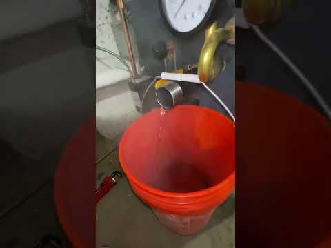

    Nice! I have a similar situation. How long did you skim for?

    Probably a couple hours. Till the water wasn’t so yellowish.. in that video I felt I was skimming too hard so I reheated the boiler a bit and slowed down the flow considerably and kept reheating the water.. I also flushed out the wet return for the second time and completely drained the the boiler. (Which I hate doing because of all the oxygenated water being re-introduced)
