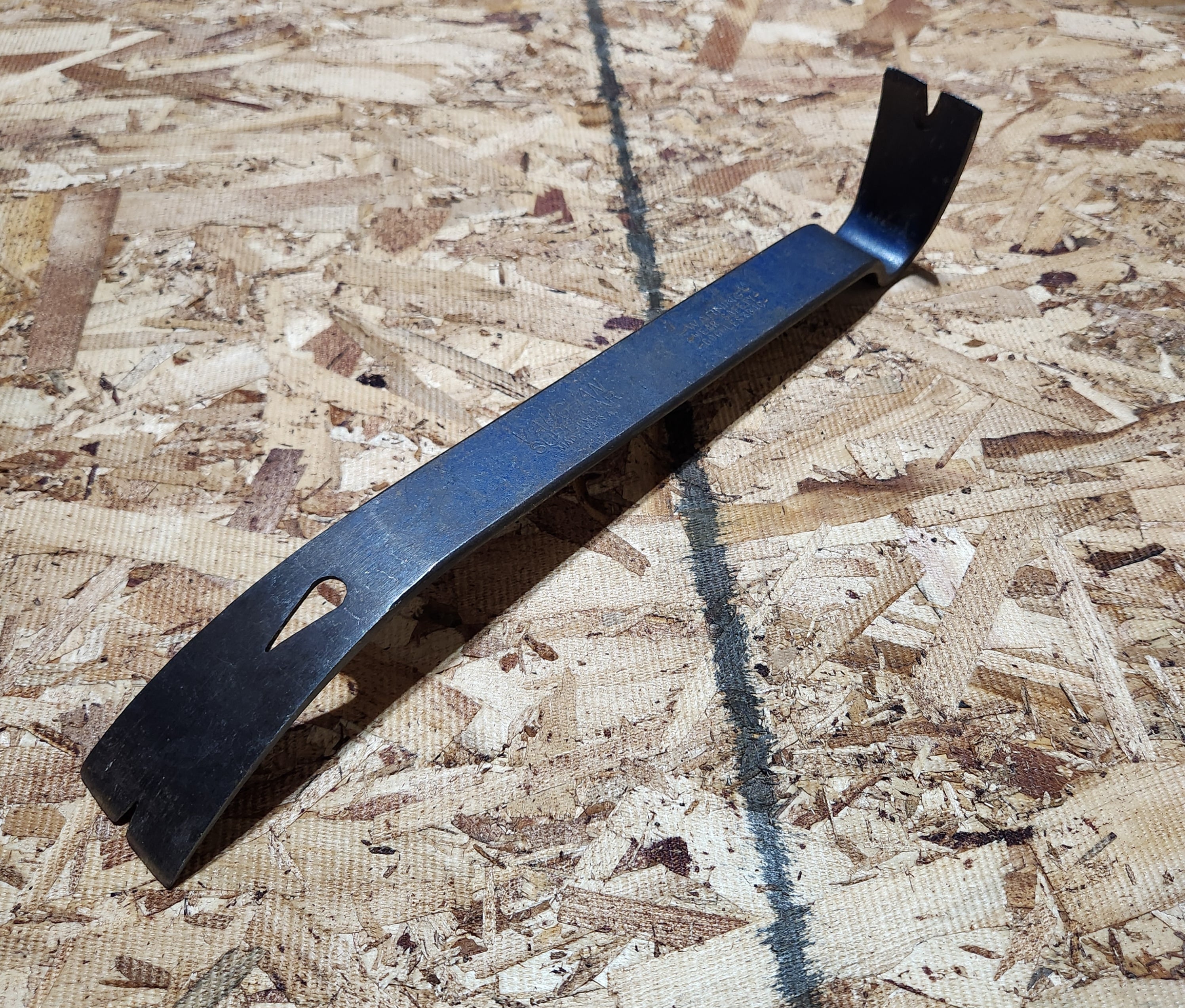

I am going to be working on a project where I need to remove some plywood panels and trim boards that are all attached with nails about twice the size of what is needed. I am thinking of buying a slide hammer type nail puller. Do any of you have experience with this or something else that you'd recommend? This seems both easier and less tendinitis inducing than a hammer and a cat's paw. Is there an air hammer version that works well?
some of it but it will get covered over.
they are around 7d common nails.
the plywood is probably 3/8" but there also some trim boards involved too.
i need to remove some of my porch ceiling to move the posts a bit to give me room to pad them out with trim boards to make them look bigger. i also need to remove some rotting t-111 board to replace it with sheathing and fiber cement shingles. i want to essentially wrap/replace the 1969 "modern" style porch with fiber cement products in a way that is more appropriate to a 1924 house.

If the work is overhead and you're by yourself, get a couple of Superbars and keep prying from a seam. Maybe a long wedge.
It might leave some nails behind, but they'll be easy to remove.

I use something like that tool — only about a hundred years old… and it works well. But if I'm just pulling something apart, my go to is the Superbar which @HVACNUT showed. Oddly enough — particularly on trim pieces which I might want to reuse — it actually does less damage to get it under the wood — between the wood and whatever it's attached to — and pulling that way, rather than trying to get under the nail head. Any mark left is on the back of the wood that way, and you can pound the nail out from the back once you get the whole mess off.

there are way too many nails and a lot of them are close to edged where they will just pulverize the wood if i do much prying on the wood. i have a wonderbar and a medium stanley pry bar and a 18" or so crowbar type bar. the 18" bar is really what it takes to easily pull those nails, they are pretty solidly in there. if i ever deal with my attic there is plywood over ceiling joists that are too small for a floor which also has a million nails in it which would have to come up to make a floor that could actually support living space. i'm more looking for if there is a nail extractor that is a better design than this. i suppose i could also blunt off an air punch and drive them all the way through.

Sometimes it is easier to hammer the nails through the plywood. You can pick up a pallet de-nailer or grind the tip on an old framing nailer to drive the nails through the plywood.
Pull them out, drive them through or cut them off.
The best tool and the best method depend on the type of wood, the type of nail and the situation.
If I'm trying to save the piece I'm removing, cutting the fasteners is almost always the least damaging. Possible tools include a sawzall, an oscillating tool with a metal-cutting blade, a grinder, diagonal cutters or an 8" bolt-cutter style cutter.

Usually I just bang the nails back into the framing. If you actually have to get the nails out, this is my favorite tool:
Too many nails, I have longer pry bars, 3 foot and longer. If you are trying to remove and save a piece with too many nails, that gets more surgical and tedious.
Sometimes if you have the needed access you can pry or pound part of the wood away from the framing member an 1/8 to 1/4 inch and the nail(s) will come up with the wood, then pound the wood back against the framing member and the nail does not go back into the framing member so the heads can be easily grabbed and pried out, very situational dependent method.

that is more or less what i did once i got an edge up but i could only pull a nail or 2 at a time then i had to move the bar in and loosen one or 2 more and once i got in the middle of the sheet there wasn't any space to lift the bar. a longer crowbar would have helped. also if i can pull most of the nails while i'm planning then i should be able to do the posts a lot faster.

@mattmia2 , the pics show a Wonder Bar, won't work, poor choice. Your pic of the slide tool will work, but leave two deep marks under the nail head in the plywood and I have snapped the heads off nails with it. I have done a lot of general construction and we use a Cats Paw to remove nails with the least damage. It is the most manageable tool especially working overhead. Many styles available.

It worked great. working overhead is always a pain, but otherwise it took the ails out without switching tools 5 times per nail.

@mattmia2 , what tool did you use? Inquiring minds want to know.
