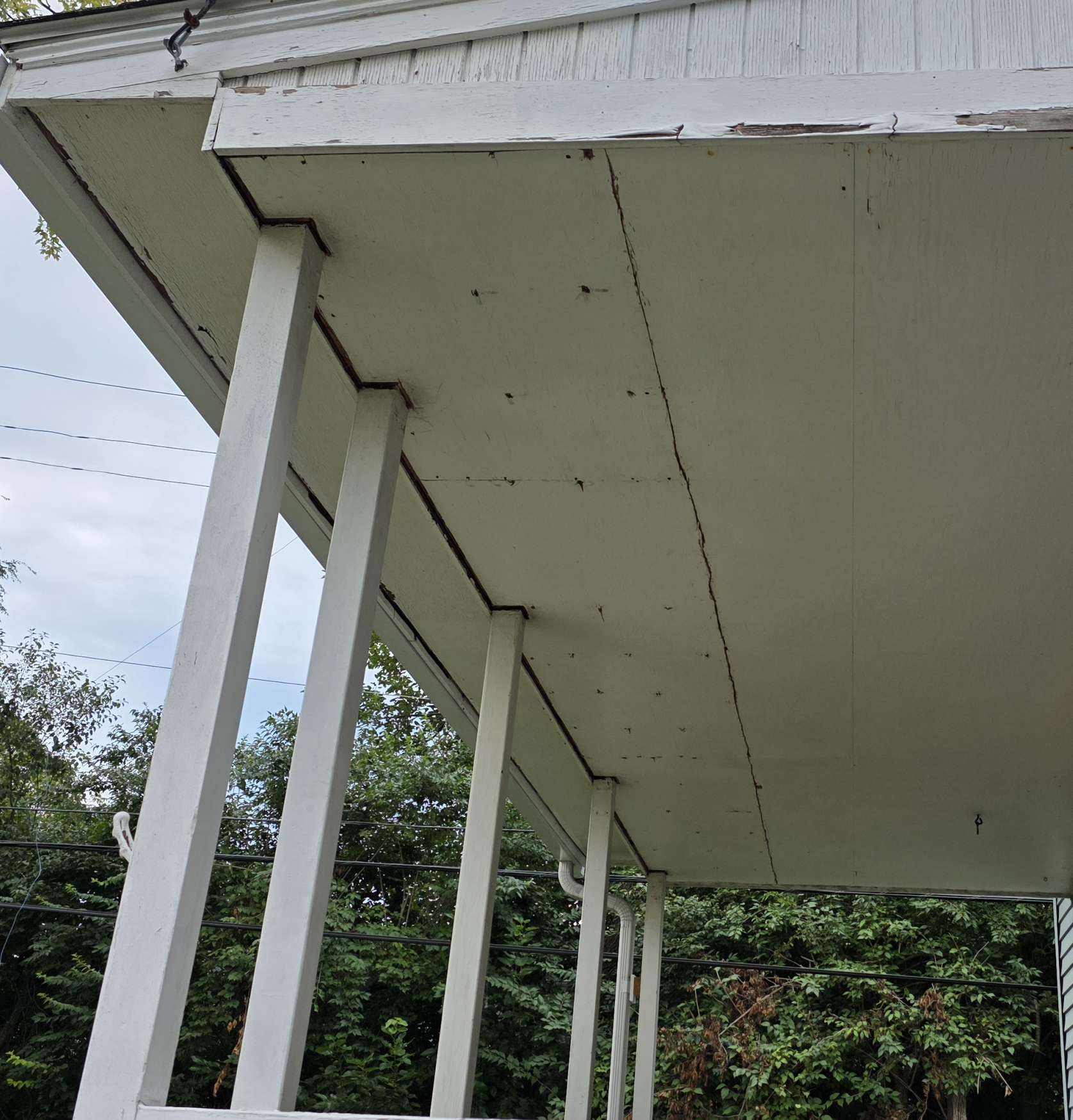

    i need to remove some of my porch ceiling to move the posts a bit to give me room to pad them out with trim boards to make them look bigger. i also need to remove some rotting t-111 board to replace it with sheathing and fiber cement shingles. i want to essentially wrap/replace the 1969 "modern" style porch with fiber cement products in a way that is more appropriate to a 1924 house.

    it is also overhead which makes holding the cat's paw and swinging the hammer more challenging

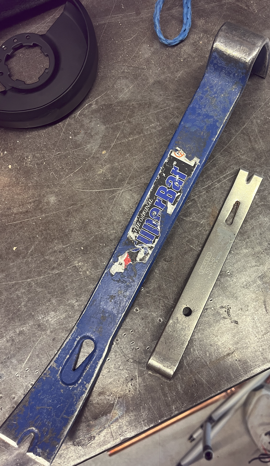

    hot_rod Posts: 28,699
    It seems like a heavy tool to use overhead?
    I agree with the SuperBar tool use, if you can get it behind or close to the nails.
    The small one is a Stanley brand.

    there are way too many nails and a lot of them are close to edged where they will just pulverize the wood if i do much prying on the wood. i have a wonderbar and a medium stanley pry bar and a 18" or so crowbar type bar. the 18" bar is really what it takes to easily pull those nails, they are pretty solidly in there. if i ever deal with my attic there is plywood over ceiling joists that are too small for a floor which also has a million nails in it which would have to come up to make a floor that could actually support living space. i'm more looking for if there is a nail extractor that is a better design than this. i suppose i could also blunt off an air punch and drive them all the way through.
    i only need to open up an 18" or so strip to get to the beam that supports the front to notch and lag new posts in to it.
    i wish they used as many nails laminating the 2 pieces of 2x that make the beam together as they did on the ceiling.

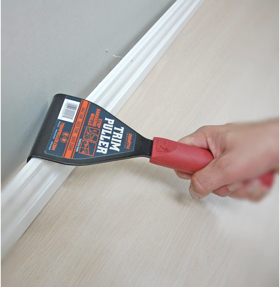

  • PC7060
    PC7060 Posts: 1,980
    edited August 10
    My favorite trim removal tool, but don’t twist like photo shows. Defeats purpose of wide surface.

    @mattmia2 , the pics show a Wonder Bar, won't work, poor choice. Your pic of the slide tool will work, but leave two deep marks under the nail head in the plywood and I have snapped the heads off nails with it. I have done a lot of general construction and we use a Cats Paw to remove nails with the least damage. It is the most manageable tool especially working overhead. Many styles available.
