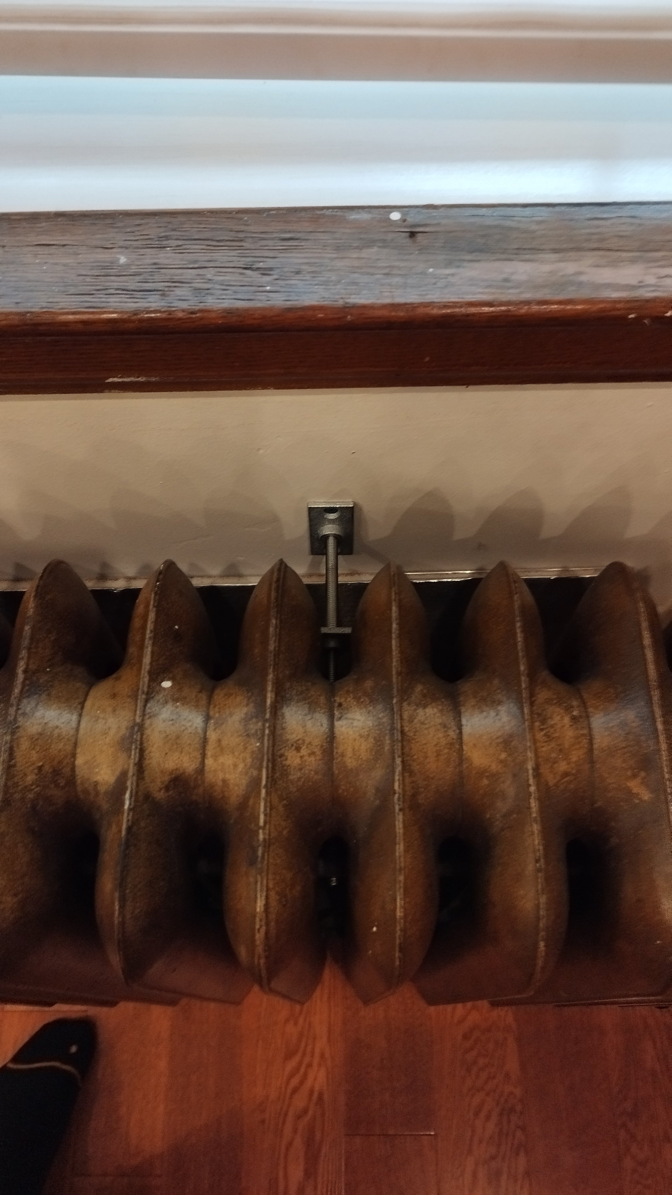

Hi I just had my 1906 asbestos caked boiler and pipes removed from my basement. Old gravity hot water 2 pipes to each radiator system. I will be installing a new high-efficiancy boiler with pumps and two zones. As part of the prep, I need to get these pipe ends able to accept the new PEX. For those who have done this before, would it be easier for me to try and remove, I.E. unthread the bit of pipe they left, or to cut new threads on the stub outs? I tried one with a maybe 18" pipe wrench I have and it didn't budge. I have not tried heat or a bigger wrench yet. Harbor Frieght has a pipe threading kit for about $75. Here are some photos, and some photos of the boiler that was removed. I have about 16 pipes I need to address. 1-1/4" I think.

    Cut notches and chisel. Under 10 minutes for those who do this regularly.

    You could rent a Megapress tool and use this fitting.
    https://www.supplyhouse.com/Viega-25145-1-1-4-Viega-MegaPress-Adapter-Press-x-Female
    Either way, I'd cut back further and remove those unions.

    Never seen those. Interesting. Pricey little devils. I might try heat and brute force first. Some radiators are on the floor above, so I could always cut the pipes off there, open the union, and thread a new piece of 1-1/4 down the hole, add a new elbow and reducer to the PEX size.

    unscrew back to the ells, get rid of the union two hammers, one for backing and tap around the fittings to help loosen them

    Did exactly this a while back on a 100 year old system. Pipe wrench with a 6' cheater bar got them out. Did bend the pipe wrench a bit on one of the pipes.
    Remove the elbow and install adapter for there. Does feel wrong to connect a 5/8 pipe to a 1" riser but works great. The new piping completely eiminated the cold rad at the end of the run issue the house originally had.
    That steel piping was keeping your rads from tipping over originally. Depending on how much pipe you have left in the wall, you will most likely have to anchor the rads to the wall. Threaded rod with ceiling flange hanger plates between the rad columns works well.

    Good point about them tipping over. They are taller radiators.

    Cut a "tooth" out of the piece and pound it out with a Lump hammer....Don your safety goggles. Mad Dog

    I'm seriously considering that Megapress system. I tried one of the fittings with some penetrating oil overnight, then Mapp gas heat today with a 36" pipe wrench. Nothing. Not a bit of movement. I have a total of 14 fittings, all stuck up high in the corner and in hard to reach places. They were cut at all sorts of angles, so I would have to recut them nice and square, which is not a big deal. May be worth the money on those Megapress fittings ($35 each) just to get it done. Alternative is all kinds of grunt work, some I would have to cut at the radiators, etc. All sorts of messing around.
    hot_rod Member Posts: 27,862
    The less yanking you do on that old piping the better!
    Many plumbing suppliers rent or loan the press tool if you buy fittings from them.
    Get some coarse open mesh sand cloth and get the outside of the pipe as smooth as possible for the press fitting.
    EBEBRATT-Ed Member Posts: 20,491
    For the first floor I would go all the way to the rad. Put new drops in with copper or black and connect the pex to it. It will take less time.
    Second floor it's unlikely you have no elbows between the ff ceiling and the second floor so snaking the pex through the existing pipe is probably not happening. In that case thread, mega press or unthread back to a fitting

    I'd give one pull with a cheater bar first. If it doesn't budge then go the destructive route.
    mattmia2 Member Posts: 17,486
    just cut them out, don't bother trying to get them to unscrew. cut the nipple to within an inch or so of the fitting, cut 2 slots almost to the threads in the pipe, break the section in between out with a caping chisel or a punch. that will release the tension and it will unscrew easily. you can do similar to cut the fitting off a pipe too. or you can shatter the fitting if it is the right kind of iron.

    Those old pipes that are inside the walls and connected to cast-iron radiators are not going anywhere. You need a 6-foot pipe wrench to move those threads, and for the most part, those elbows are held in place by the attached pipe.
    You could use even more leverage than that with this tool, which was made specifically for that purpose.
    That wrench is not cheap, but if you look on eBay, you may be able to get one at a very reasonable price. Use it for all those pipes, then sell it on eBay when you are finished with it.
