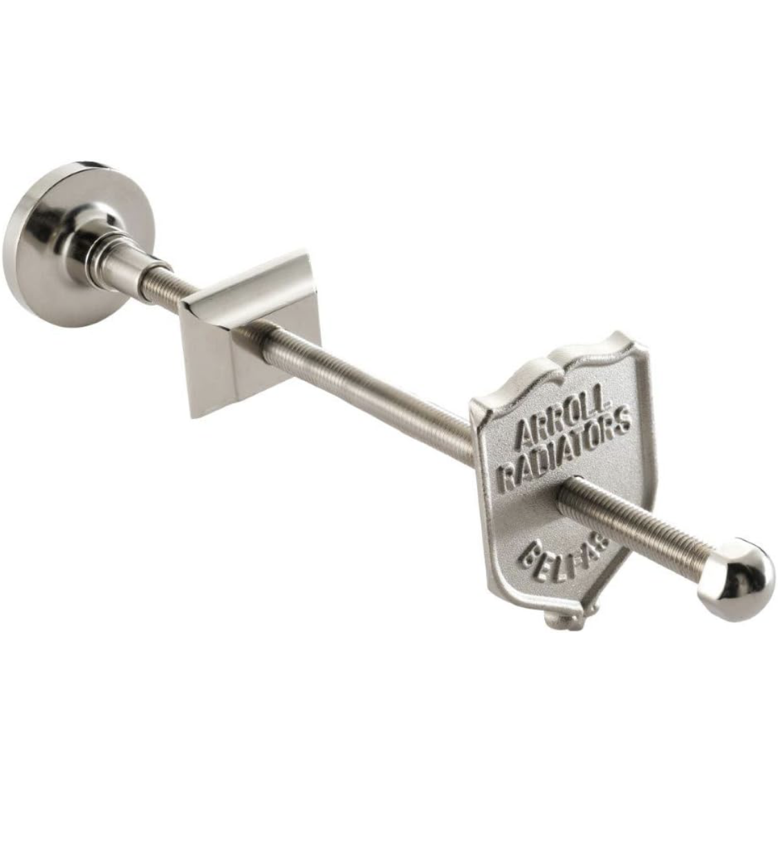

That steel piping was keeping your rads from tipping over originally. Depending on how much pipe you have left in the wall, you will most likely have to anchor the rads to the wall. Threaded rod with ceiling flange hanger plates between the rad columns works well.
Good point about them tipping over. They are taller radiators.
