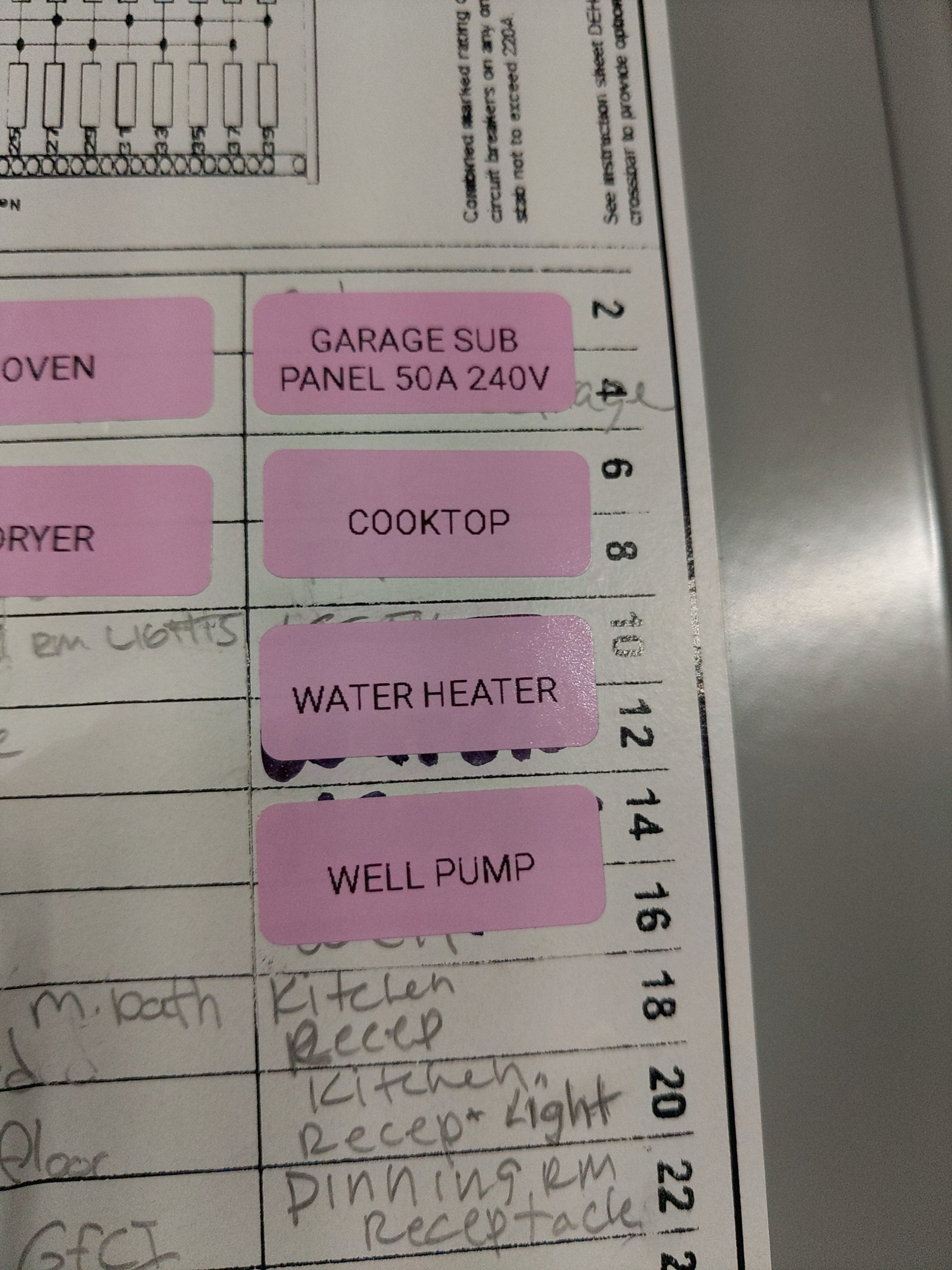

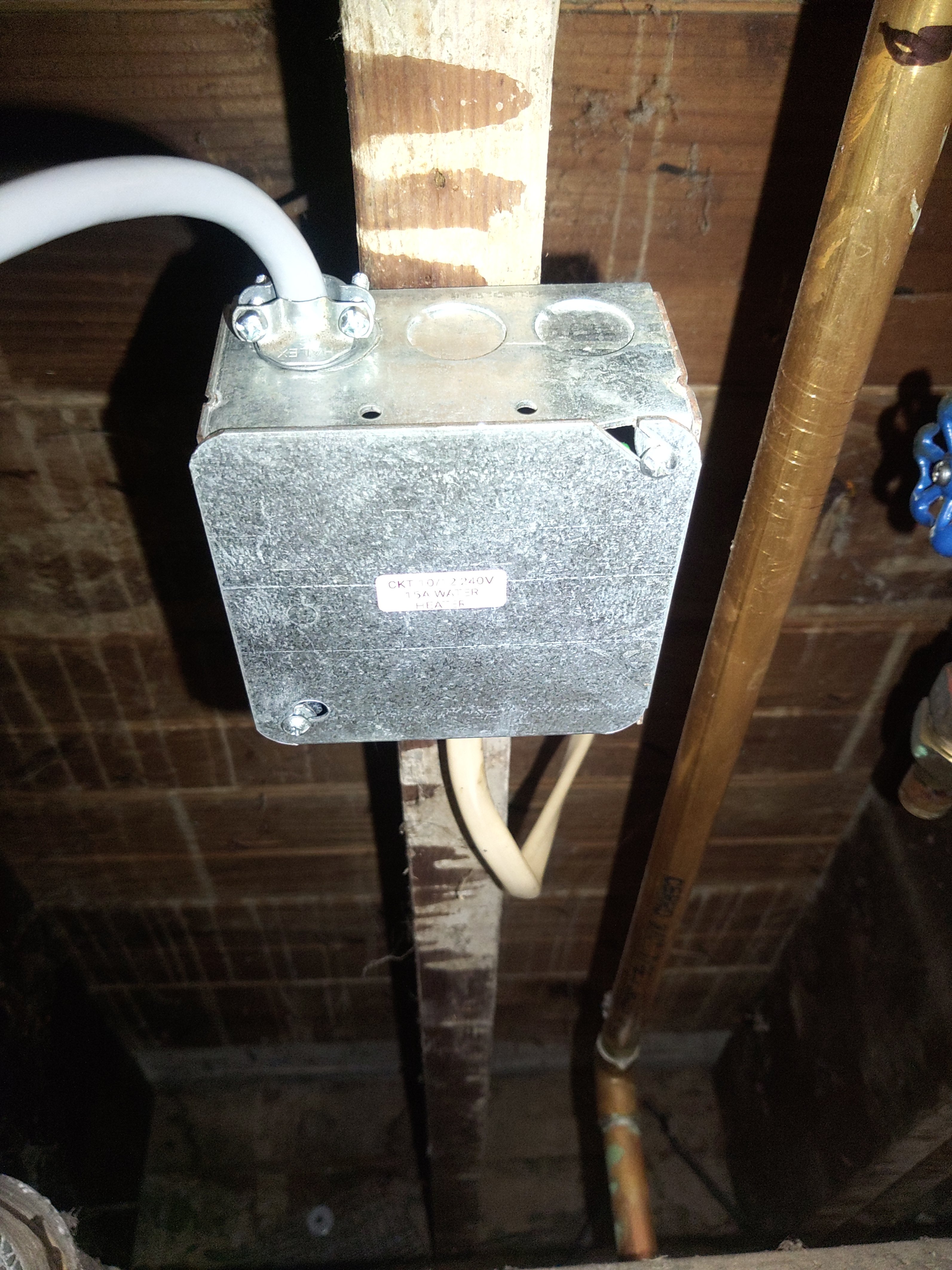

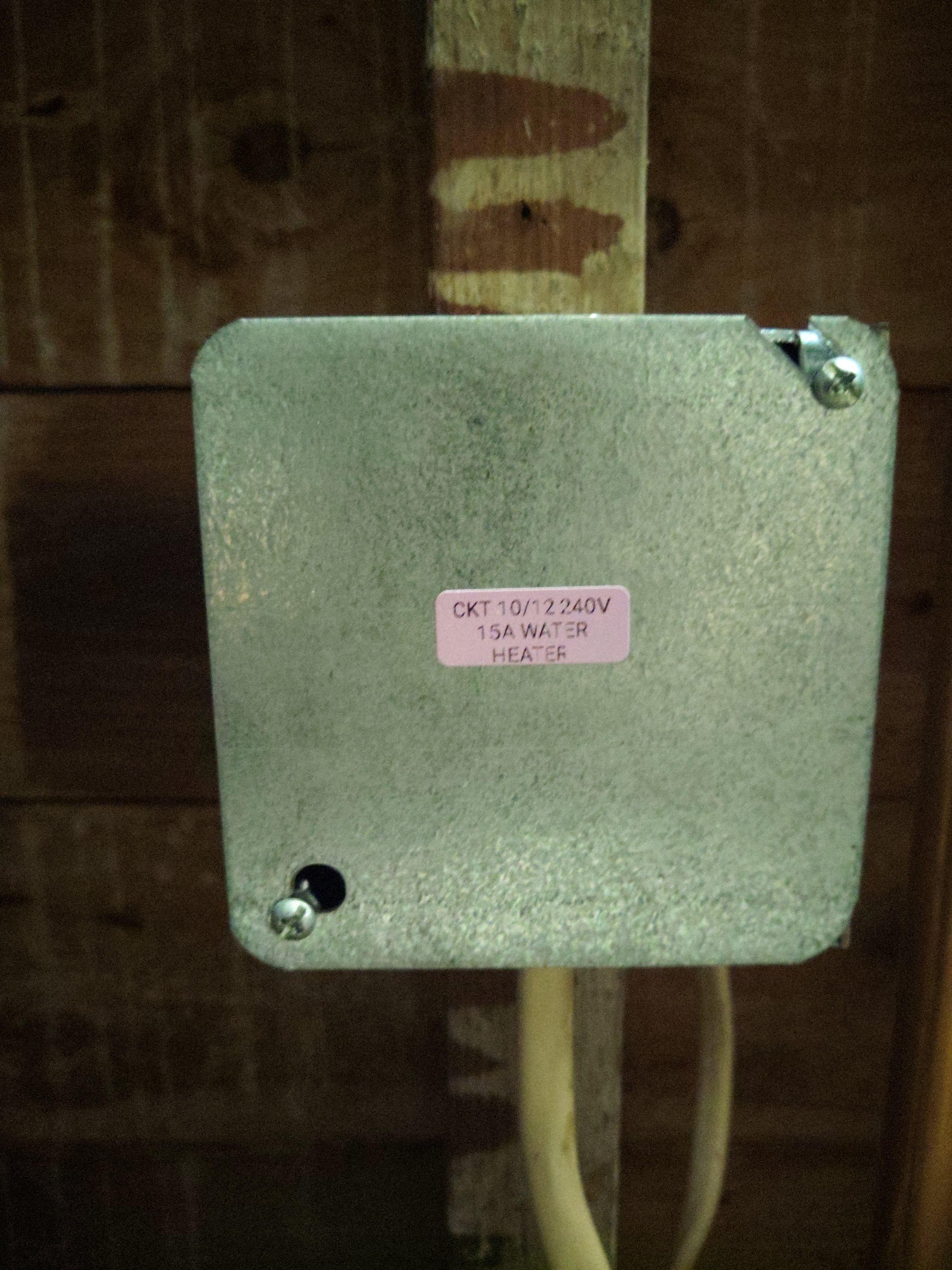

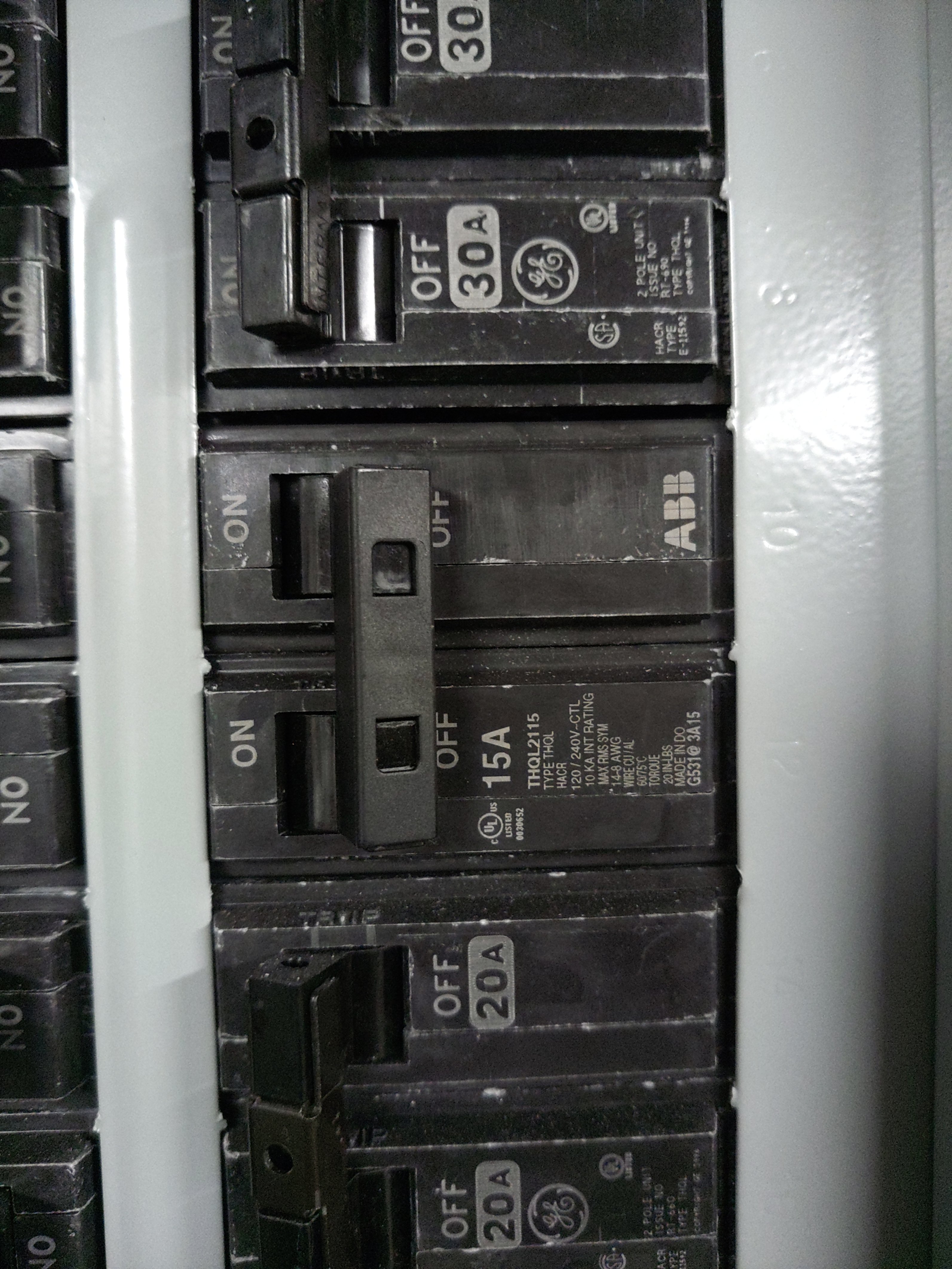

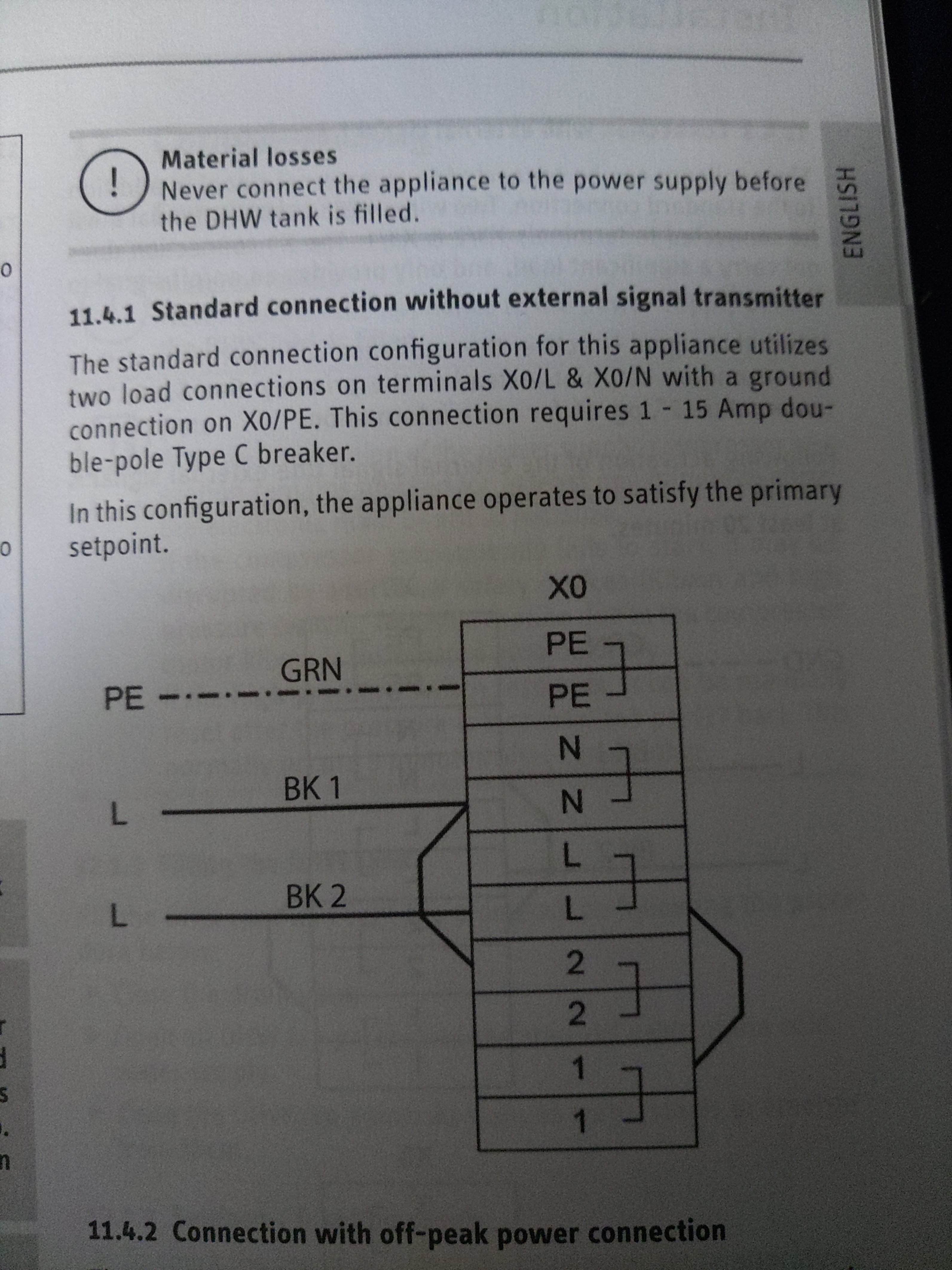

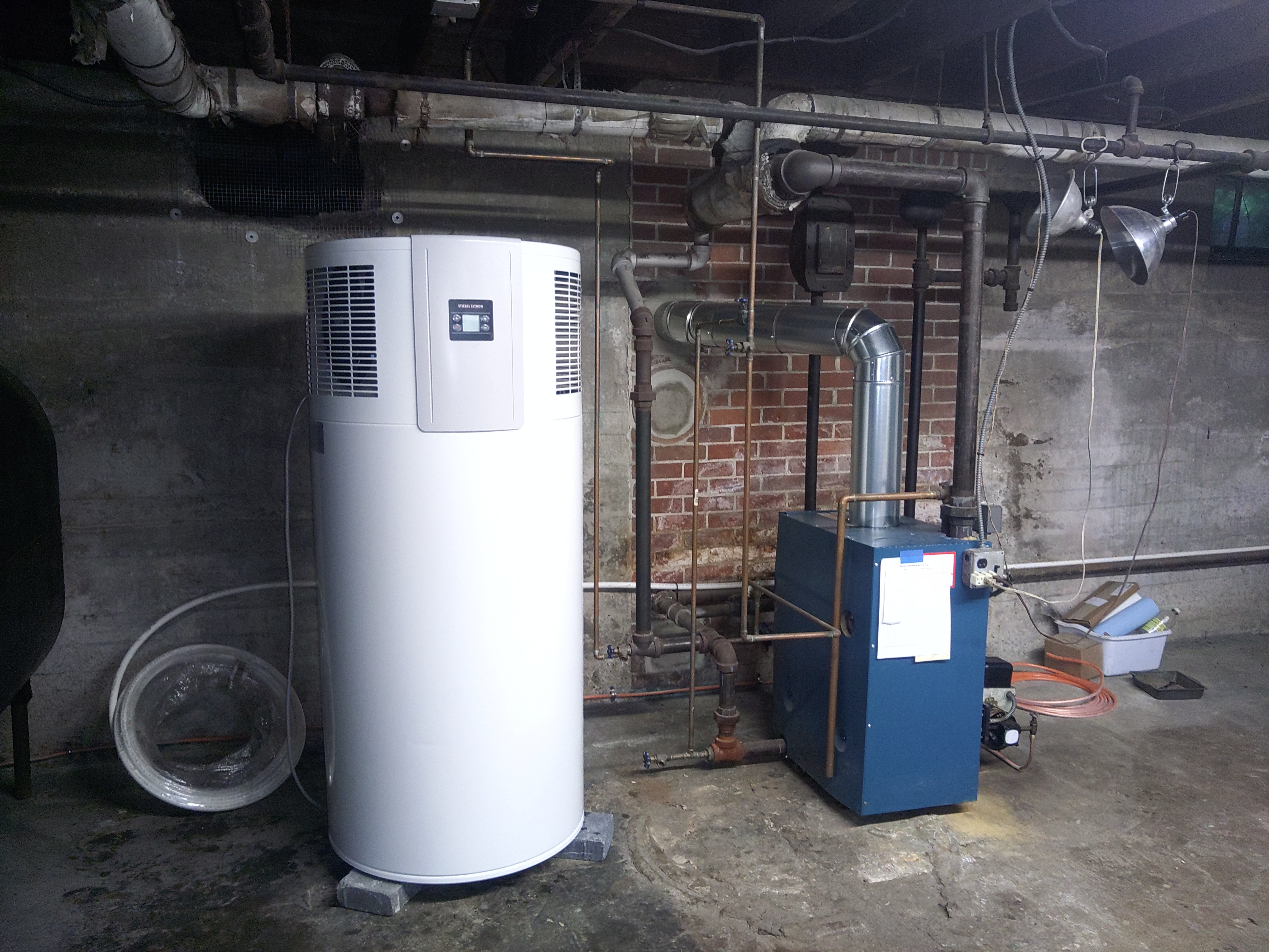

Electrical is all done. 15 amp breaker installed in the panel and 10/2 that was run over for a previous electric tank water heater connected to said breaker and I installed a metal junction box as the unit comes with a power cord pre-installed.
Was able to get the unit safely down the bulkhead steps after work and set up on some pavers that Mom gave me. Wasn't too terrible to get down especially with the help of my neighbor and his son with his appliance dolly. Hopefully this weekend I'll have my friend come over who is a plumber to help me pipe it in.

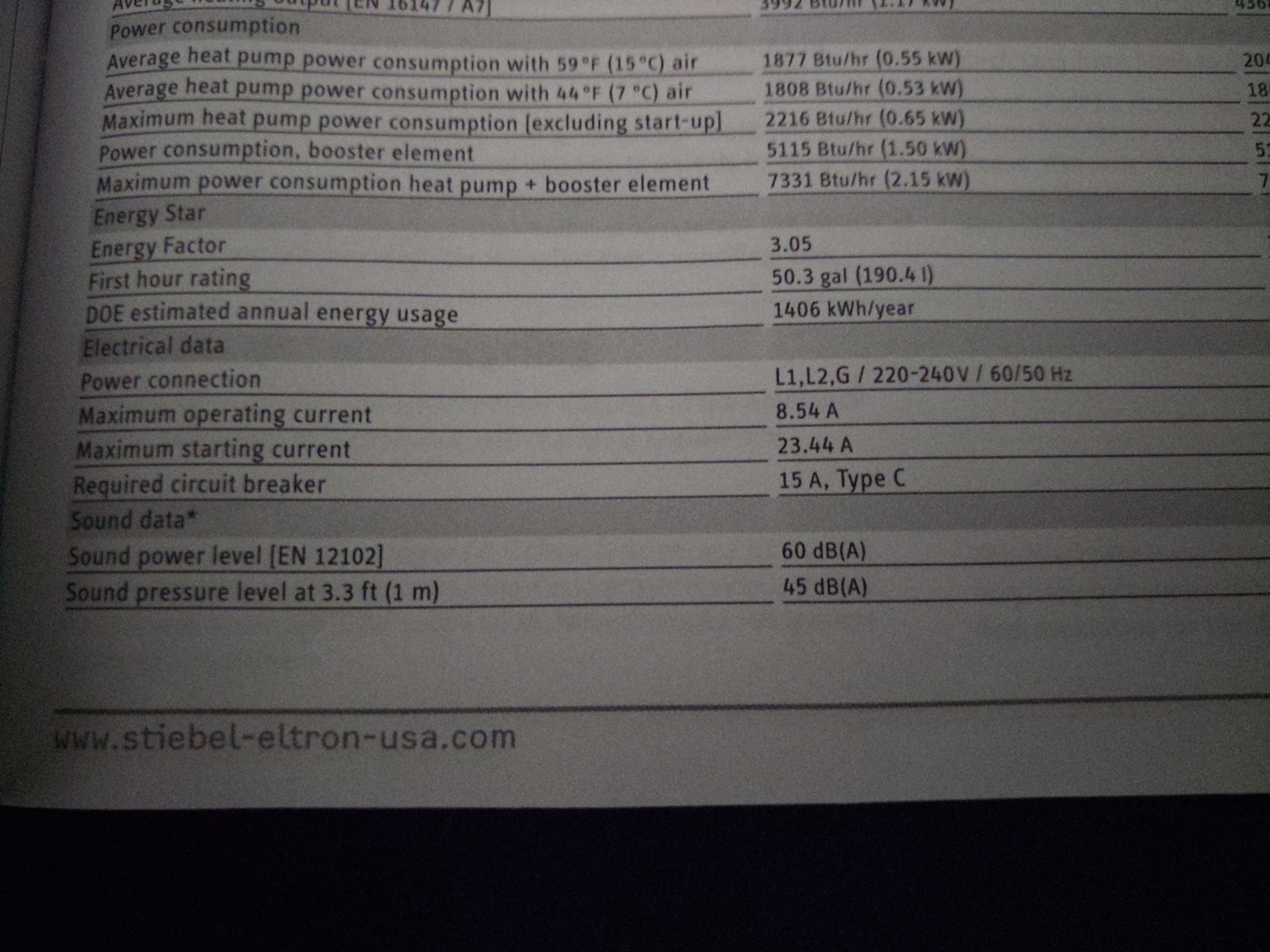

it is heat pump only, it doesn't have backup resistance heat?
It has a 1500W booster element only, only requires a 15A 240V circuit. So in theory yes, heat pump only.
Electrical and condensate connections complete. Now I just need to coordinate with my plumber friend to have him help me pipe the hot and cold connections along with adding an expansion tank.

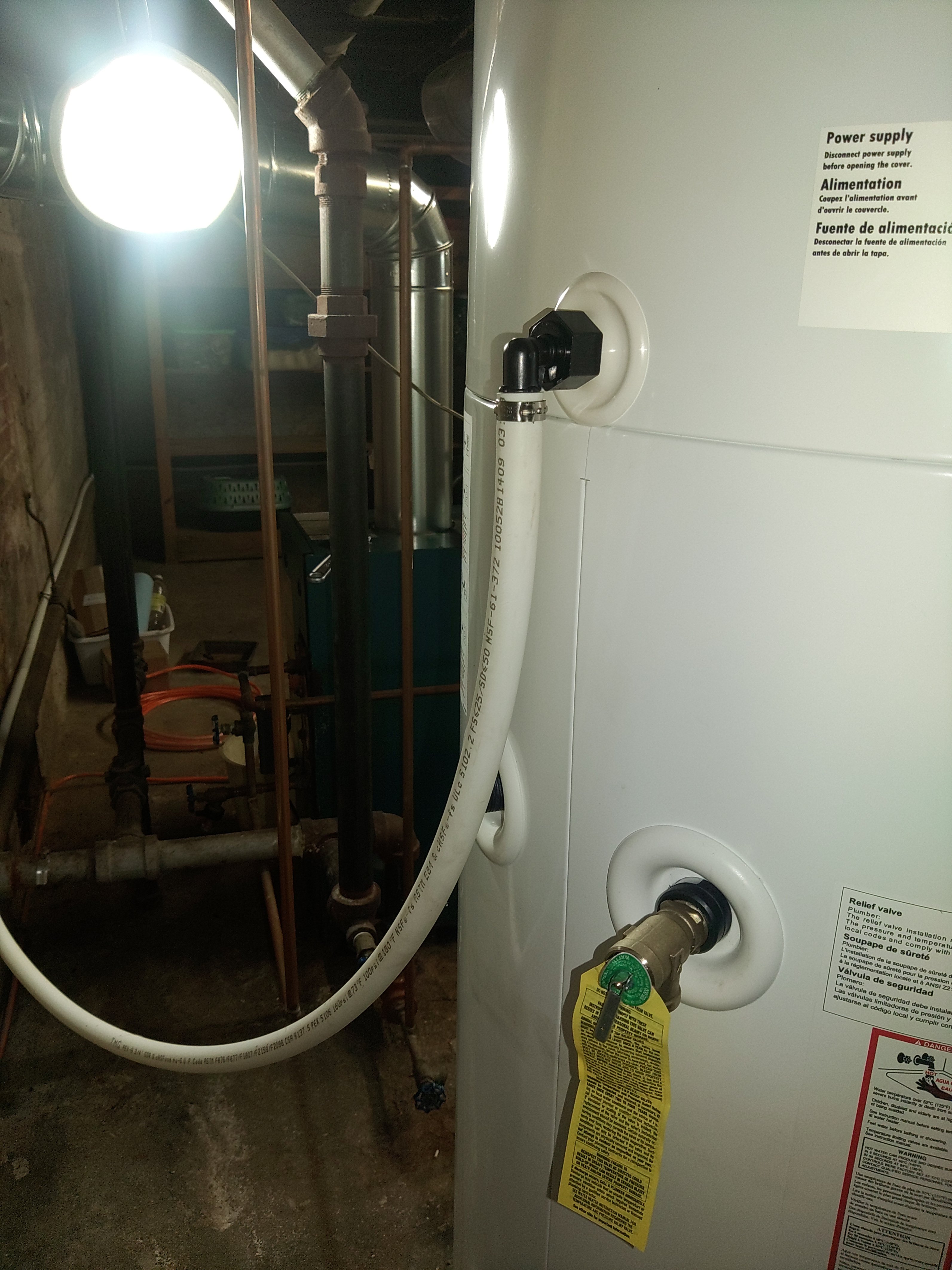

Practiced my sweating skills the other night and built and installed the T&P pipe. I'm also considering omitting the service valve on the hot side for simplicity. Mom and Dad's water heater doesn't have a valve on the hot side, just one on the cold side.
Put the valve in. I won't install a water heater any more unless it has cutoff valves & a bypass as well. It's just that much easier.
i like to use npt valves and adapters on the copper, that way you only ruin the $1.50 adapter if you cook it while sweating it, not the $30 valve. Especially a good idea if you are just learning to sweat pipe.
I'm actually having a licensed plumber friend of mine help me with the hot and cold connections, and he's very experienced with sweating copper.
