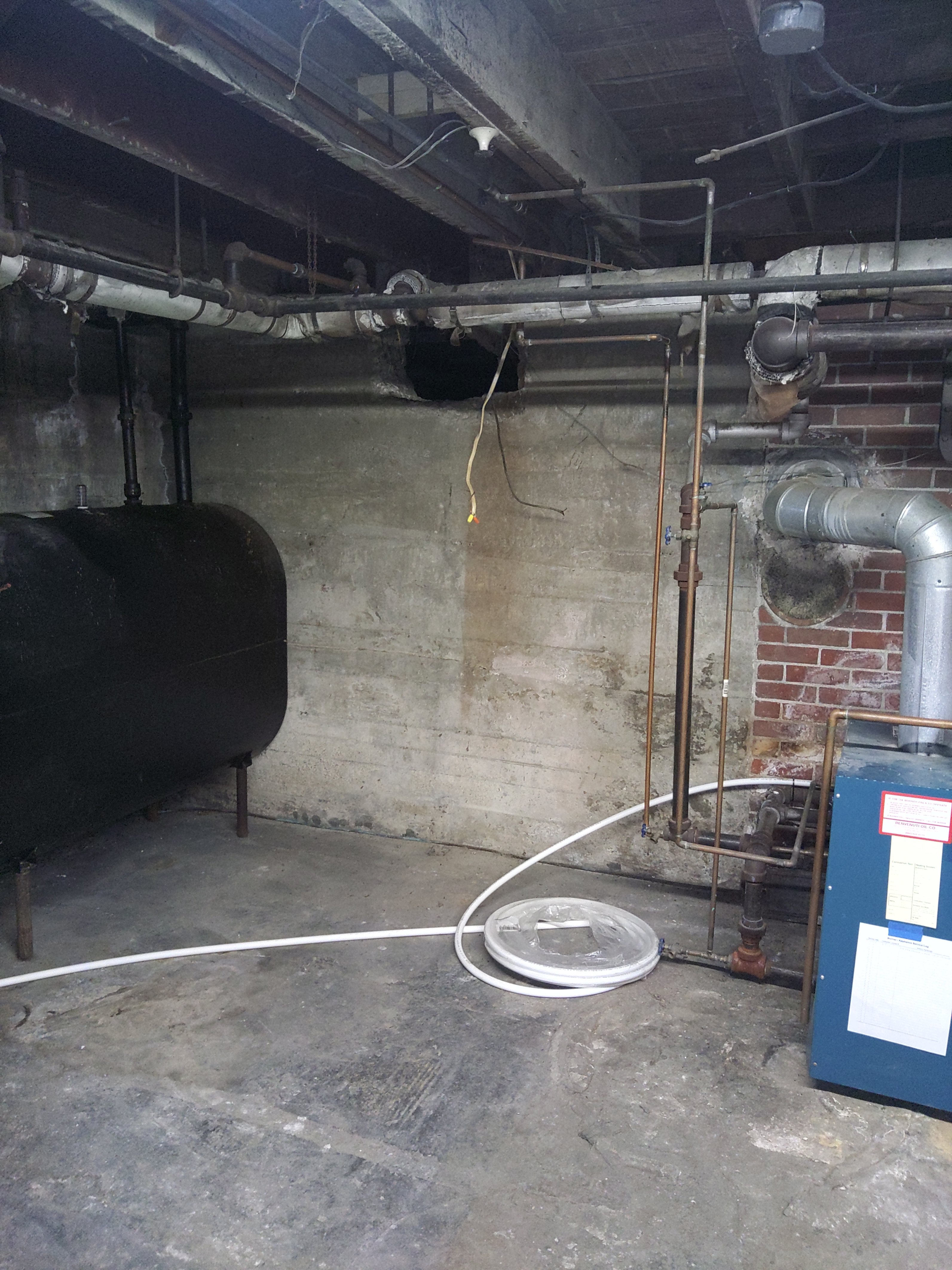

    currently making my dhw with a tankless coil in an oil fired steam boiler, no storage tank. It's only me living here with an evening shower daily and laundry / dishes once a week or so. It would live in the basement in between the oil tank and boiler. In the winter it would benefit from the oil burner exhaust/boiler heat I'm thinking. When it's steaming hot water is great, when it's on standby at 175°, hot water isn't so great, I also don't want to burn oil in the summertime for hot water anymore.

  • Planned installation spot :

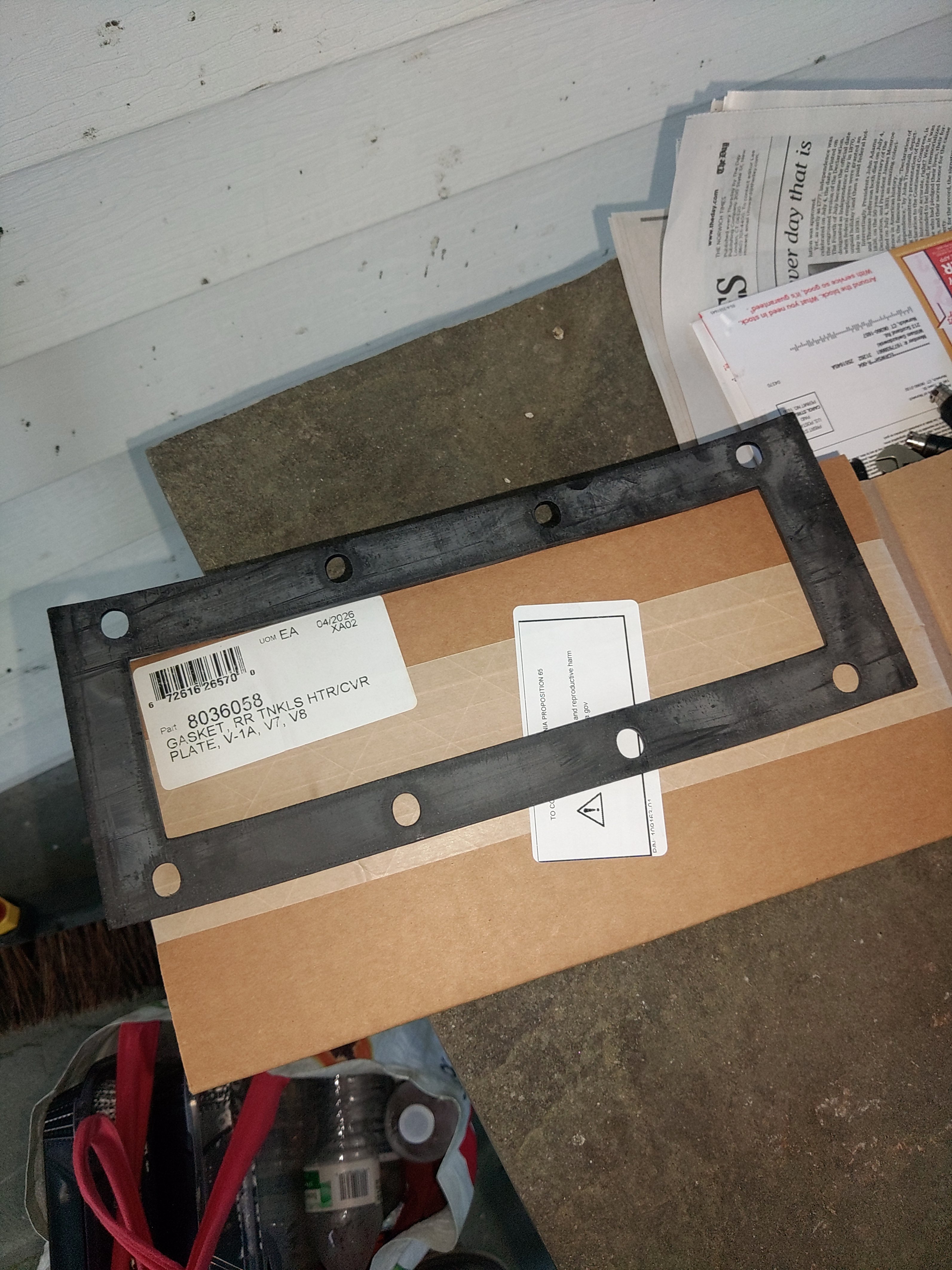

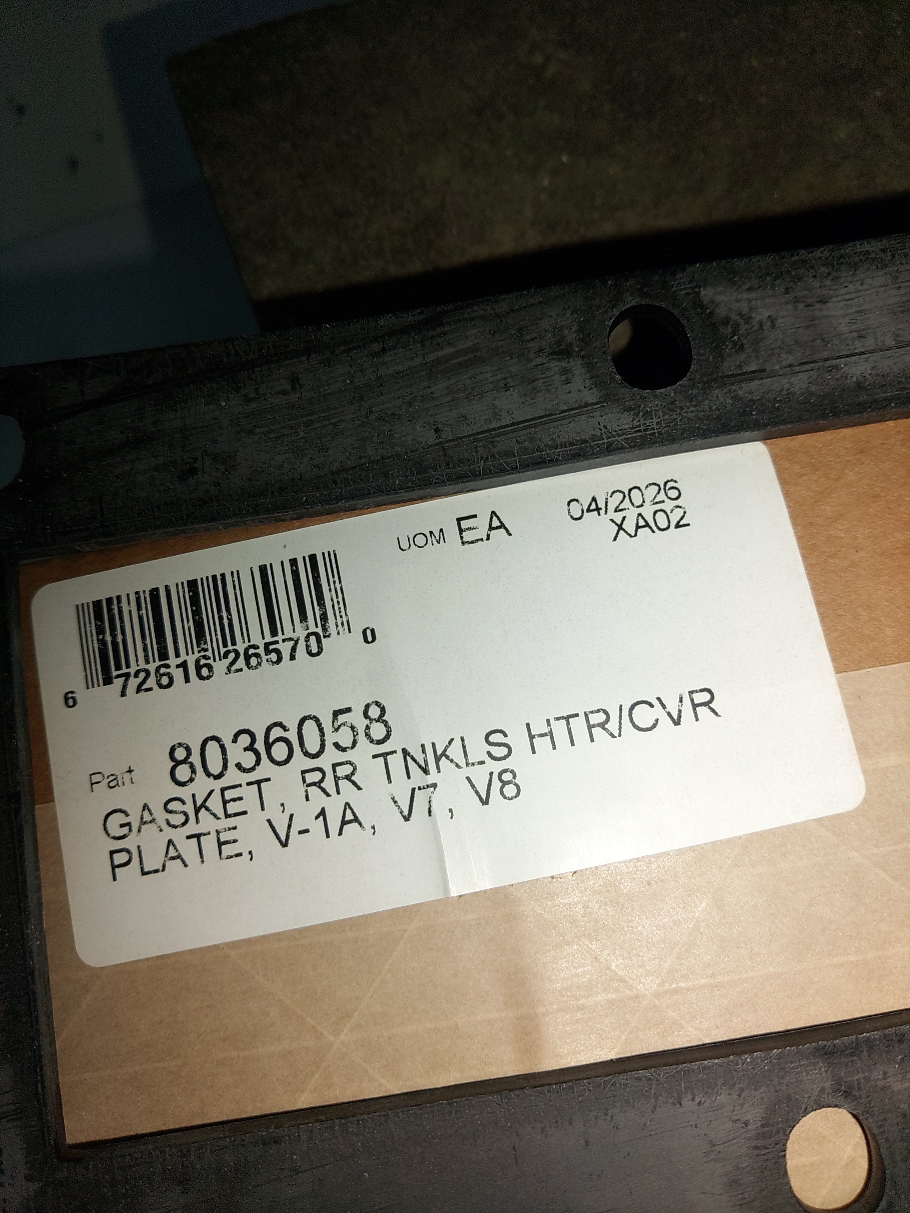

  • Finally back on this project, ordered the tank last Sunday and I got a phone call from the trucking company yesterday morning and the driver will be here between 10:00 a.m. and 2:00 p.m. Monday. I also ordered a replacement gasket for the domestic coil in the boiler as when the boiler was shut down at the beginning of April for a day for a new chimney liner, I did find that the gasket leaks pretty good. I'm hoping I can get it apart without too much trouble. I did strip some of the jacketing off of the boiler and if it comes down to where I need to drill out the tankless coil bolts I do have access to the back side of all eight of them. I also have all of my paperwork in order to submit to Norwich Public Utilities for the rebate with the exception of a current utility bill which I should have shortly.

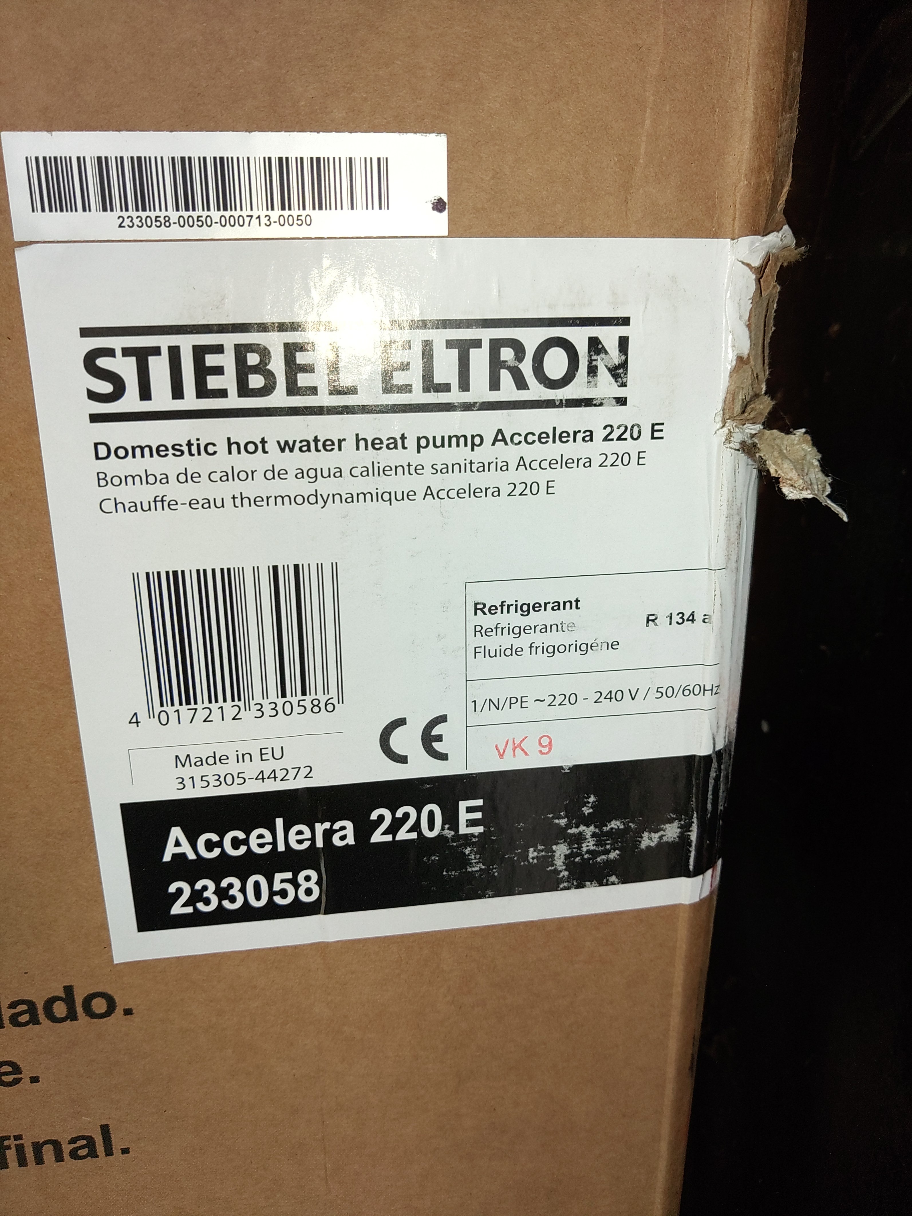

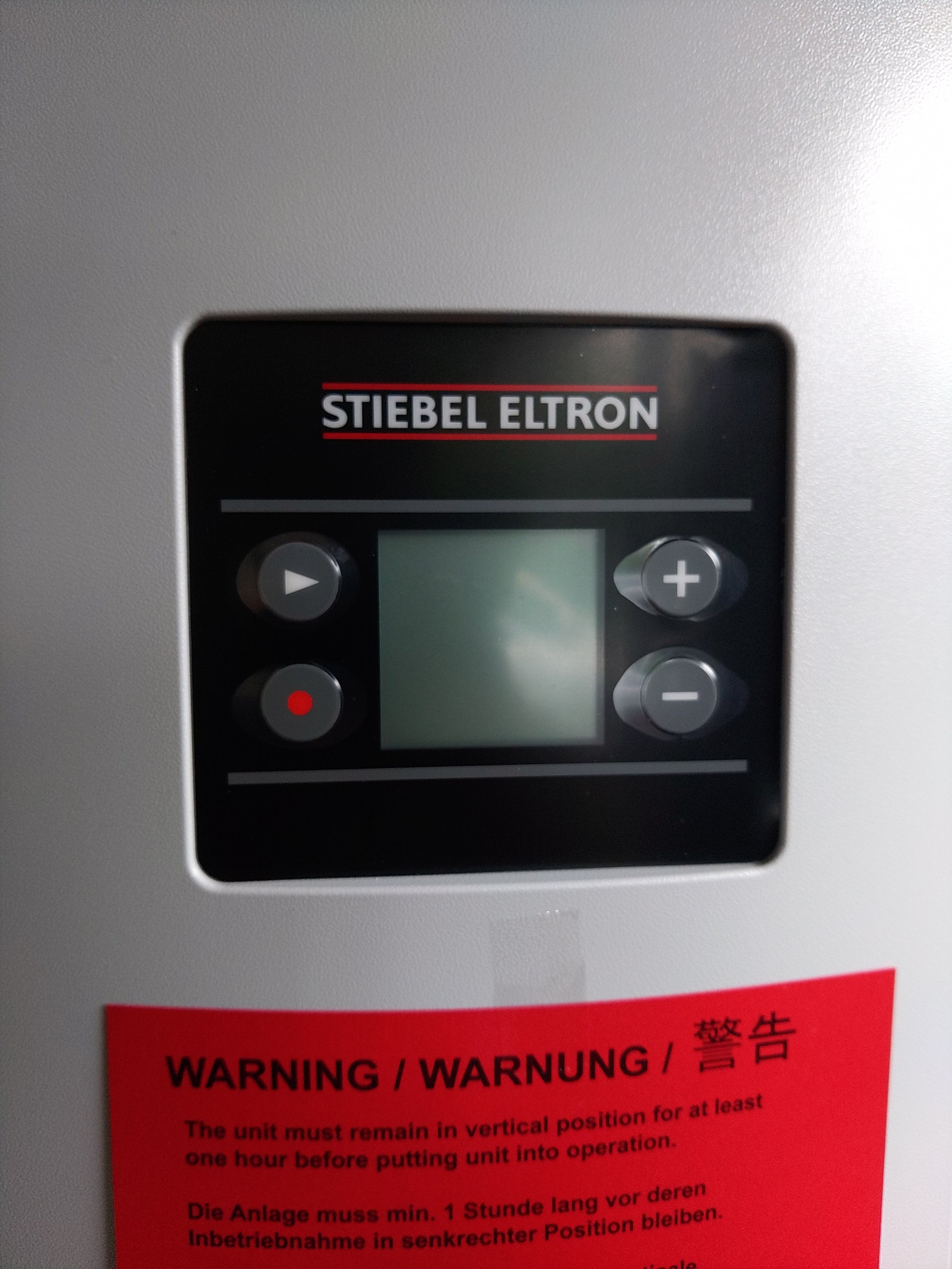

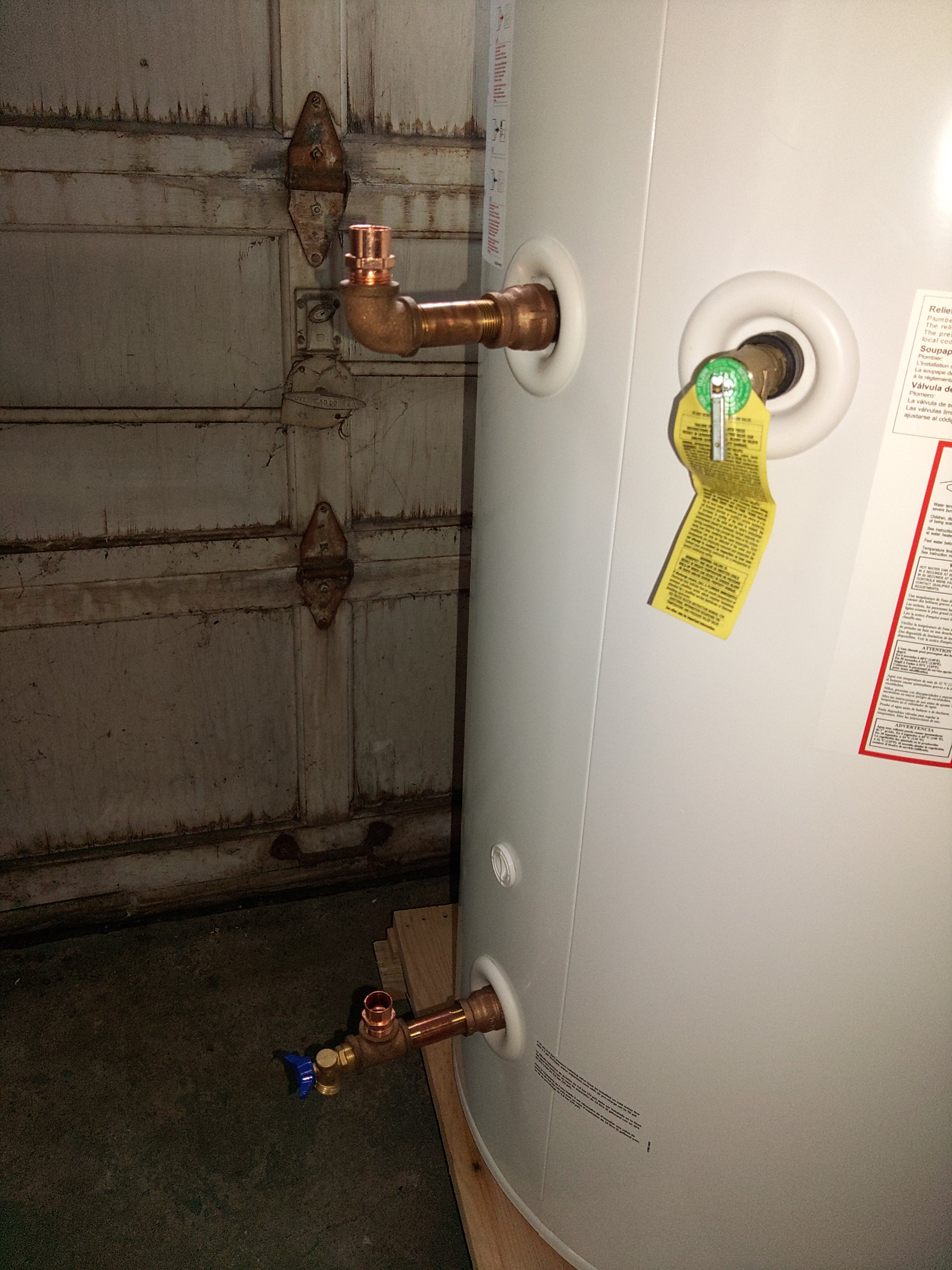

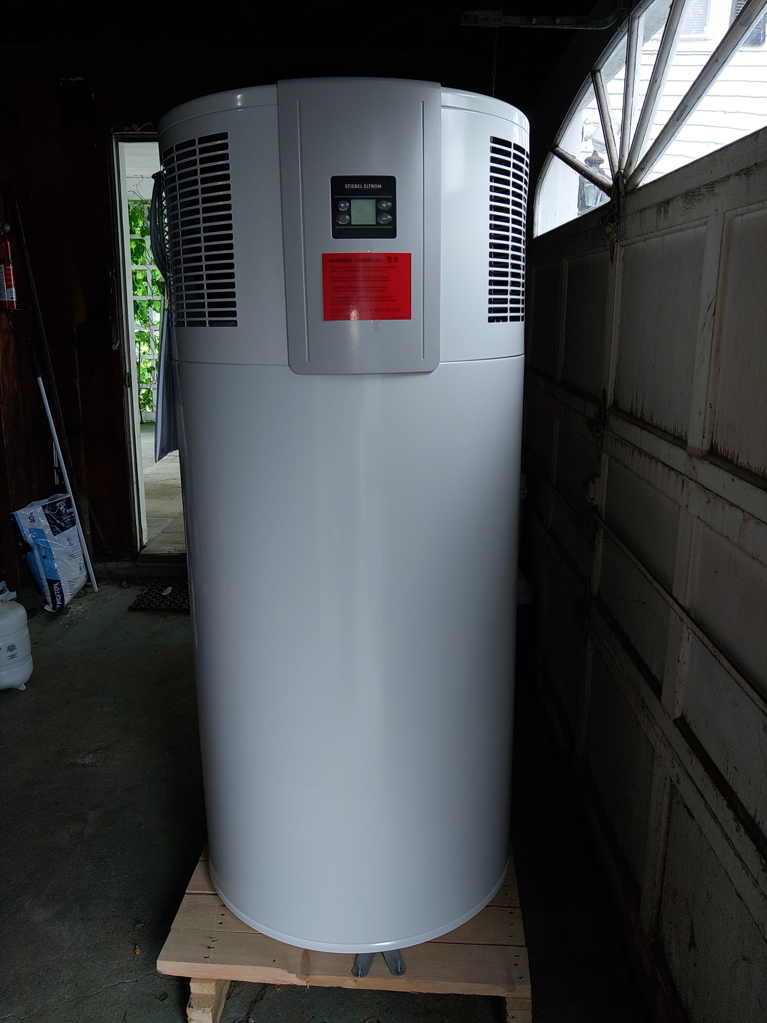

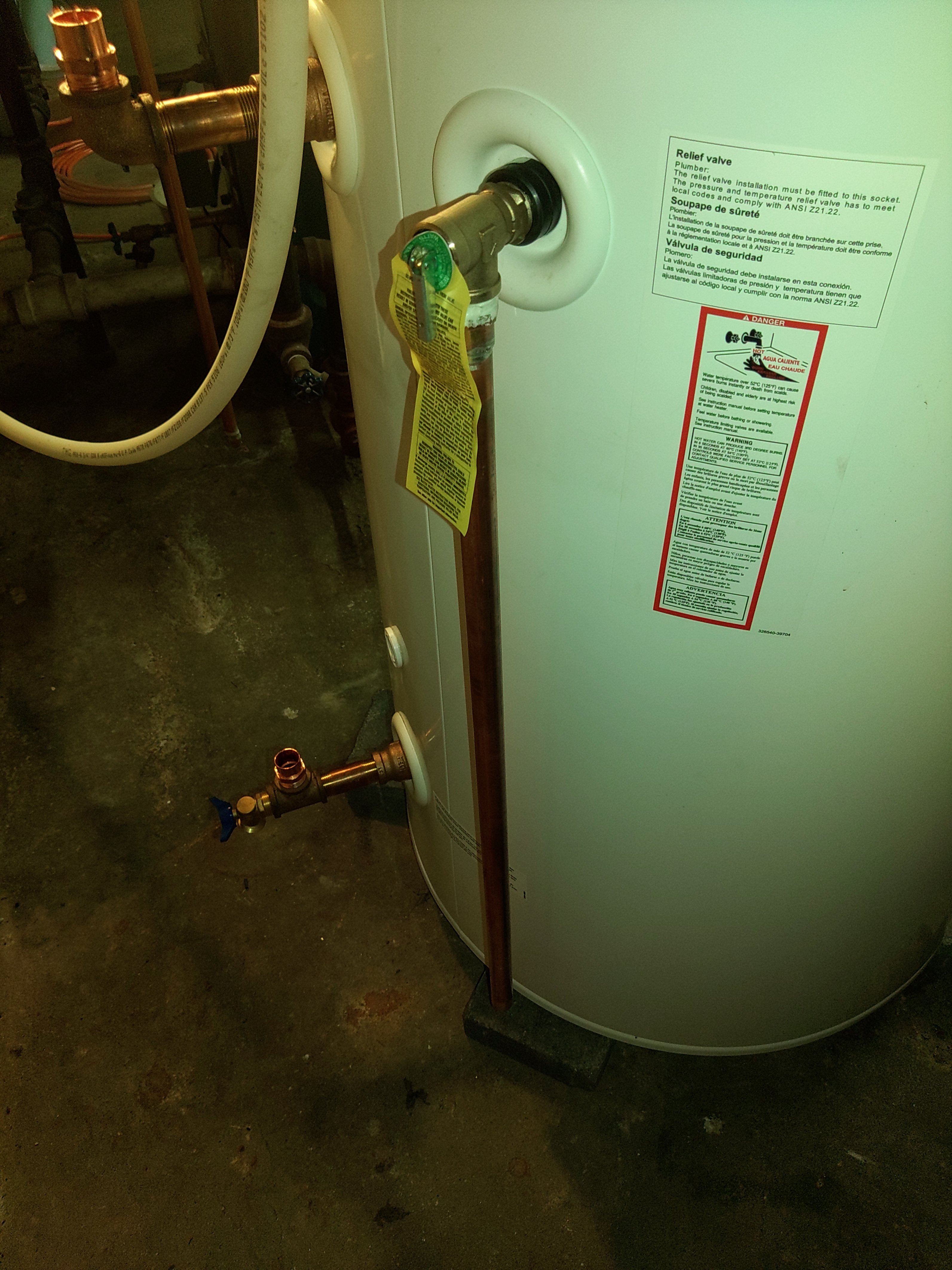

    Tank arrived this morning and when I got home, I dry fit the hot and cold connections. The next obstacle to overcome will be getting it over to the bulkhead through the breezeway and back planting bed and then down the bulkhead steps because it's quite a big unit.

    appliance dolly with stair crawlers.
    use stainless or brass bolts and antiseize for the tankless cover. re-torque it after a couple months.
  • Larry Weingarten
    Larry Weingarten Posts: 4,212

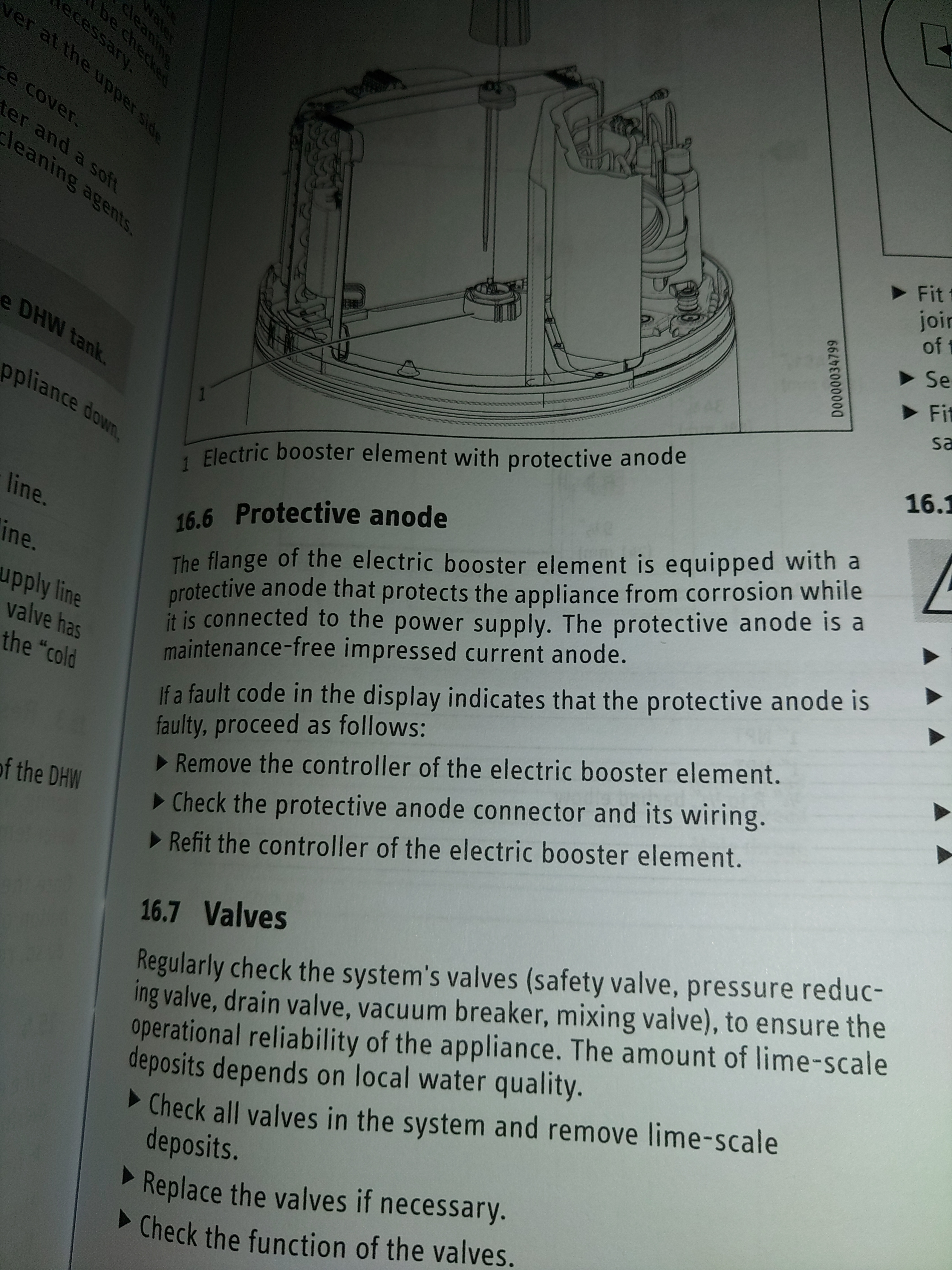

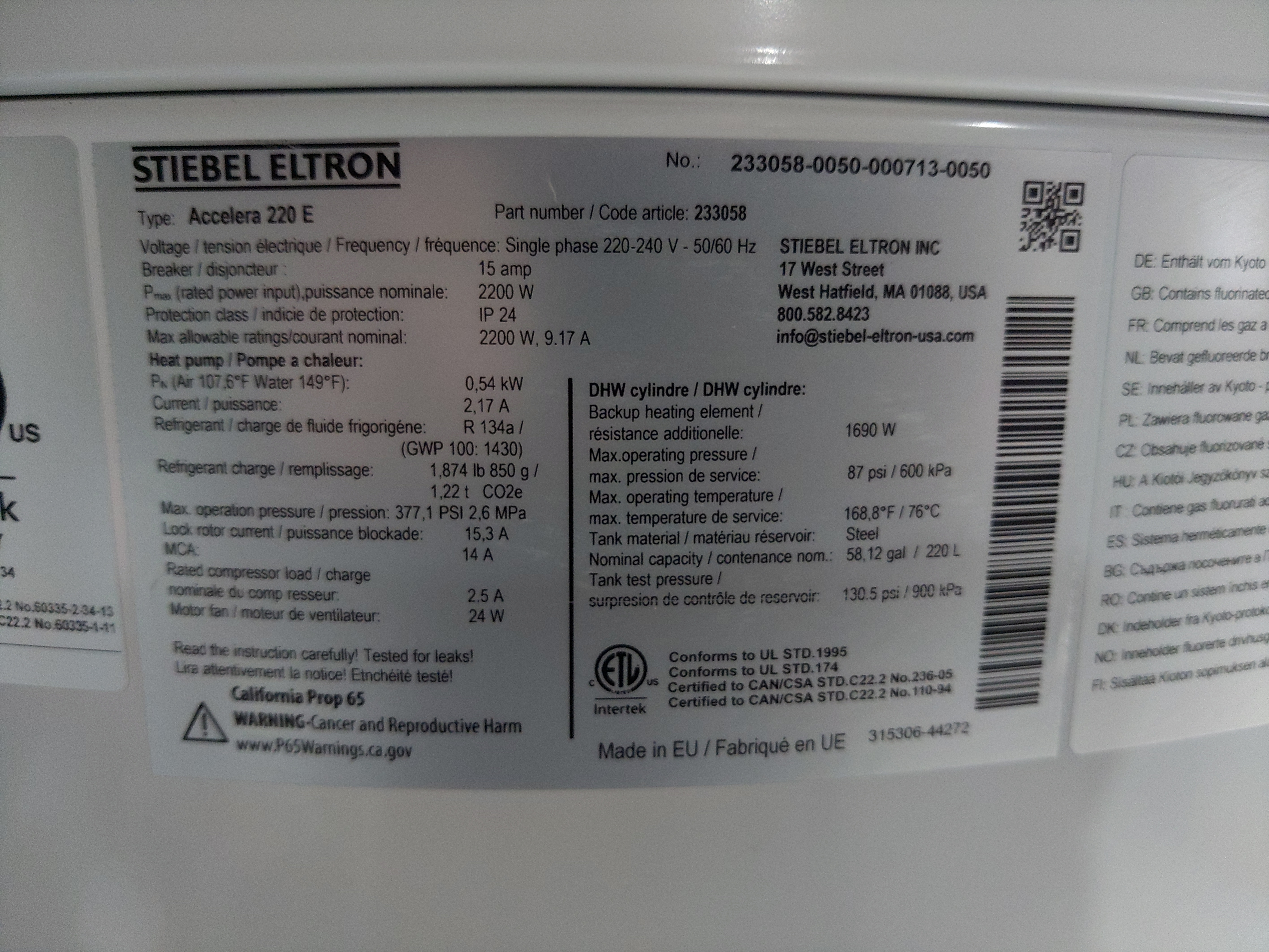

    Hi, What sort of anode rod does your unit have? Often with new tanks, I remove the anode, add teflon tape to the threads and reinstall it. This way, it will be much easier to service later on. I'd prefer to see a powered anode or a magnesium anode… not aluminum.
    It's much easier to do this work before the tank is installed. 😉
    Yours, Larry

  • Larry,
    I'll have to read through the manual and other literature but I believe it is a powered anode.
    Matt,
    My neighbor across the street works for a local beer distributor and he has a very good hand truck on his van so we're going to use that. I knocked down a bunch of vegetation in the back planting bed as well. I'm also going to use some planks or pieces of plywood over the crushed stone just to make things roll easier as well. I know I also have to pull the inner bulkhead door off at the bottom of the steps as it won't open up far enough to allow the unit to go in, there's a steam pipe that runs close to the door. And I appreciate the tips for the tankless cover. Once I extract the bolts I'll head down to the hardware store or my work and grab stainless ones with lock washers and good anti-sieze.
    mattmia2 Posts: 18,437
    if you don't use a dolly with built in straps, use a couple ratchet straps to attach the tank to the dolly so it doesn't roll, tip, or slide off.
  • Thank you Matt, I'm well aware of that and I have plenty of rope, straps, etc
    hot_rod Posts: 28,776
    i think that tanks comes with an electronic anode? Check yours to confirm

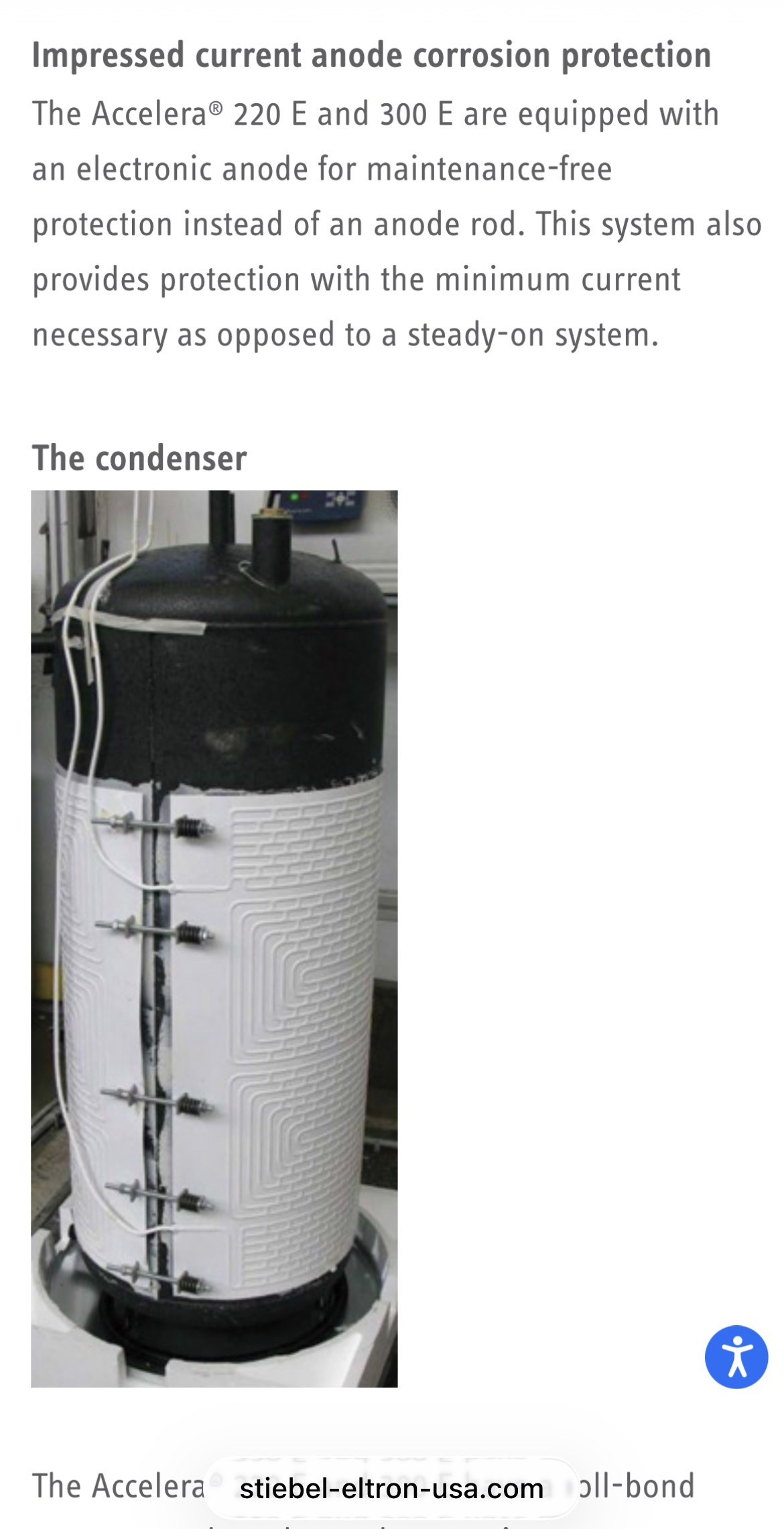

    do the competitors also have the condenser from the back of a 1950 ge wrapped around the outside of the tank or is the condenser inside of the tank?
  • mine is the 220E so it's got an electronic anode and the condenser like in that photo, one thing that sold me on it was the much better engineering than a "hybrid" water heater.

  • @Larry Weingarten and @hot_rod
    The unit is equipped with an electronic anode that is part of the 1500 watt booster element per the installation and operation manual.
