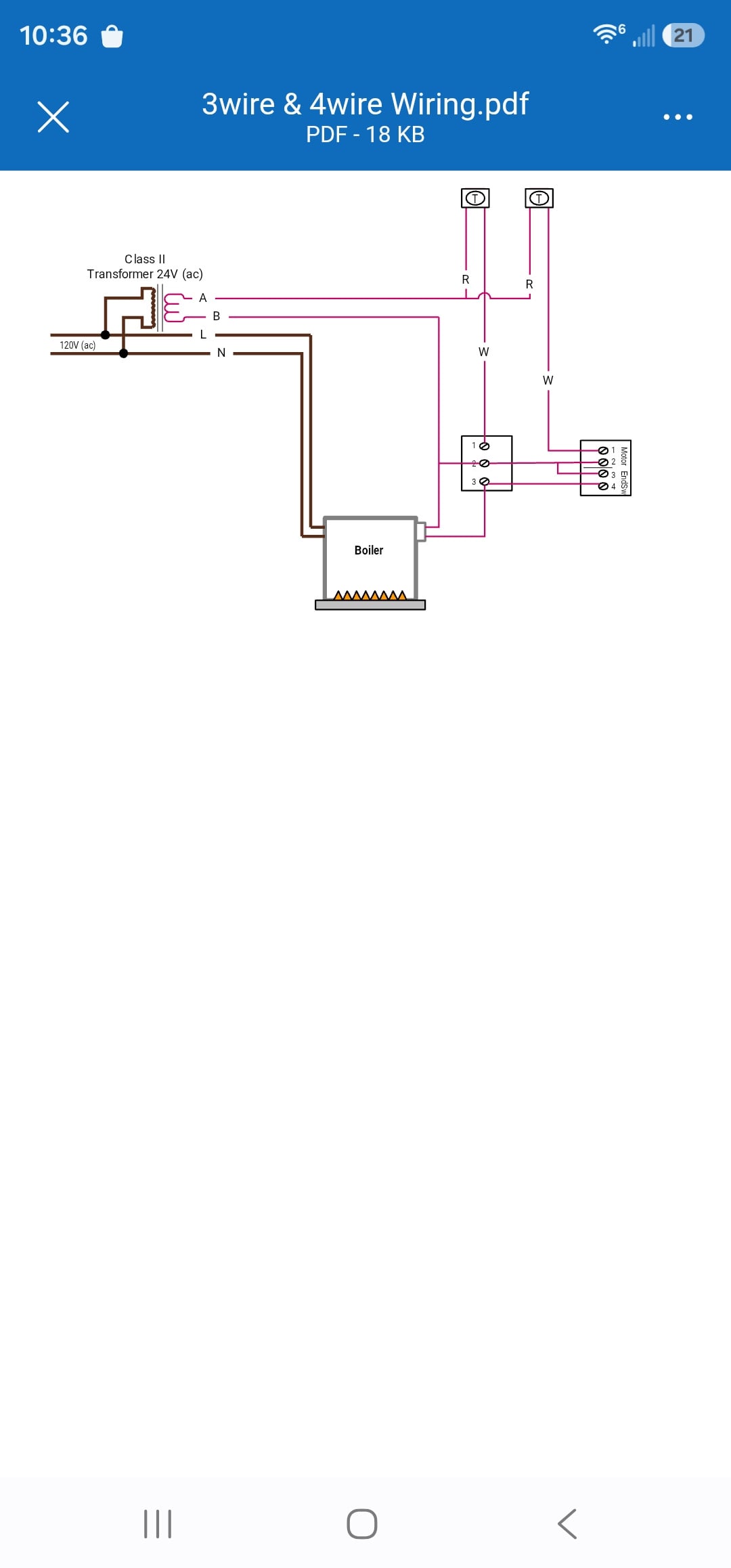

    This is how I might see your Isolation relay design:
    This works just as well with the additional relays. However in the next diagram you will see the common mistake where the zones are connected identically and wvwn with the isolation relays there is still a short circuit when zone thermostat all the way to the left is calling for heat.
    This is how @Steamhead might reconnect a thermostat on a repair to a system I installed . That is because Steamhead is correct in his diagram, where R on the transformer is connected directly to #1 on the zone valve the way he was taught many, many …many years ago.
    If all the other valves were connected the same way, with R connected directly to #1 on each zone valve, then there would be no problem.
    The problem arises when @Steamhead comes across a system wired the way I teach it, where R on the transformer is connected to R on the thermostat, and he does not double-check to see how all the other valves and thermostats are wired.
    Then @Steamhead ’s correct way of doing this somehow causes the transformer to fail, even with isolation relays in place, as shown below.
    I’m not saying that @Steamhead is wrong . I’m saying that when troubleshooting three-wire zone valves, the way you were taught is not necessarily the same way everyone else was taught.
    There is more than one correct way to wire zone valves. You just need consistency across the entire system that you are working on.

    Well, that diagram won't work, but that's not what I meant.
    As long as there is only one transformer feeding a group of ZVs, the outputs from terminal 3 on all of them can be grouped together and routed to the same isolation relay. The problem comes, again, where you cross-connect different transformers. Each group of ZVs that share a common transformer would need their own isolation relay. The NO contacts on each relay would then connect in parallel to TT on the boiler, so any one of the isolation relays can start the boiler. This is essentially what a zone valve panel does.
    The idea, again, is to make the installation foolproof. You never know who's coming in after you, and you don't want them blowing transformers and controls. Customers don't appreciate that.

    Same difference, @Steamhead , whether you have one relay for each valve or one relay for all of the valves. The wires must be consistent across the system.
    I like to use R on the transformer to R on the thermostat. You like R on the transformer to #1 on the zone valve. Both work fine when they are consistant
    If you mix both of our methods on the same system, you will have smoked transformers, regardless of the relay.
    All the relay does is move the problem. It makes sure the inconsistency does not damage the control’s transformer, but the wiring inconsistency is still there.
    The best way to solve this problem would have been for Taco to determine, 50+ years ago, that the transformer R, or non-grounded source, gets connected to R on the thermostat in their diagram.
    But that will never happen, because it would make too many existing systems obsolete. It would, however, make adding smart thermostats that need a common, or C wire, much easier to retrofit.
    Anyone who comes across a system wired where R from the transformer is connected directly to the zone valve needs to have the system completely rewired so every zone valve is connected the same way: R on the transformer to R on the thermostat, W on the thermostat to #1 on the zone valve, and the #2 terminal, common both circuits in the valve head, on the zone valve connected to C on the transformer.
    It all fits together perfectly when it is done that way.
    But if you have a six-zone-valve system, that is an expensive rewire just to add one Nest or ecobee thermostat to your home.

    Well the way I see it, all @EdTheHeaterMan, @Steamhead, @EBEBRATT-Ed, @hot_rod all have valid points.
    IMO you don't need a relay to make the circuit work properly. Any more than you need a relay to add a new TV to your home. The circuit comparison is more similar than you may think.
    What I don't like about adding things that are not actually needed for proper operation is it complicates the wiring and increases the cost, initially and to run, and more stuff to fail. Making it more complicated is just making it more complicated for the next guy. If you left a perfectly good working (neatly wired) circuit and the next guy screws it up, well that is on them, not you. Also LED indicators like the RIB has can and do fail, trust your meter that you verified before each use and not the indicators.
    To me if you are going to go with the added relay circuit topology, use a zone valve controller, since it simplifies the wiring, provides isolation and activity indication, but it has a cost.
    The one thing I find sad about the original @JohnNY post is this circuit is not that complicated. I hope that electrician never has to troubleshoot Polyphase equipment issues.

    You can wire anyway you want that works. I have wired them with relays and without.
    What I am saying is that by using relays it more closely follows the wiring of a 4 wire valve where the valve power and its opening and closing is controlled by 1 circuit and the burner control is isolated by an end switch or in the case of these Taco valves by a relay.
    I am simply trying to "dumb it down" as the average "technician" on the street is not going to have a clue what to do with these valves especially with multiple valves on one boiler.
    Strangely if I remember right Taco does not describe the operation of the valve or its (two transformer) integration in the install instructions.
