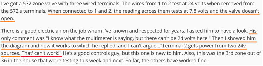

I've got a 572 zone valve with three wired terminals. The wires from 1 to 2 test at 24 volts when removed from the 572's terminals. When connected to 1 and 2, the reading across them tests at 7.8 volts and the valve doesn't open.
There is a good electrician on the job whom I've known and respected for years. I asked him to have a look. His only comment was "I know what the multimeter is saying, but there can't be 24 volts here." Then I showed him the diagram and how it works to which he replied, and I can't argue…"Terminal 2 gets power from two 24v sources. That' can't work!" He's a good controls guy, but this one is new to him. Also, this was the 3rd zone out of 36 in the house that we're testing this week and next. So far, the others have worked fine.
But we know, of course, that it does.

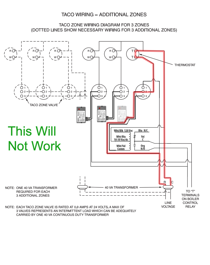

    This is where the confusion starts: "Terminal 2 receives 24V from R on the transformer."
    Don't think of it that way. That's how transformers get the factory-installed smoke to leave them.
    Think of Terminal 2 as a common, or C terminal. When you look at it that way, it always makes sense. The problem is that not everyone thinks that way, and that's where the trouble begins.
    When you come across a Taco 570 Series three-wire motor, where the transformer's 24V R is connected to #2 or common (C), things can get confusing. Eventually, when diagnosing a problem involving a transformer with R connected to the #2 or C terminal on a zone valve motor, you can end up connecting an R and a C from a transformer together.
    We all know what happens when you connect R and C together on a transformer and then apply 120V to the primary winding. the factory installed smoke is released.
    So think of the taco 570 series motor like this. R from the transformer goes to R on the thermostat. That makes sense all the time weather toy are wiring a heater or air conditioner or heat pump. R is always connected to R and if you use a Red insulated wire that makes it even easier to remember.
    Now that you have connected one of the transformer wires to R on the thermostat, you need to connect W (the heat terminal on the thermostat) to something. That should be terminal #1 on the Taco 570 motor. This means that whenever there is a call for heat, the thermostat will send 24 VAC to the Taco motor.
    However, that does not make a complete circuit for the Taco motor. You need a return path for the circuit to be complete. This is where terminal #2 becomes a Common (C) terminal. All you need to do is connect terminal #2 on the motor to C on the transformer. This completes the circuit.
    That is really all you need to know about the Taco 570 series valve motor. There is more to learn, but if you want the basics to get it right every time, remember this:
    Transformer R → Thermostat R (use the Red insulated wire)
    Thermostat W → Taco 570 Motor Terminal #1 (use the White insulated wire)
    Taco 570 Motor Terminal #2 → Transformer C (I like Blue for this, but use what ever color you have left in the bundle if spaghetti because electric is colorblind)
    Once you have this circuit in place, you can then use terminal #2 (Common) and terminal #3 on the Taco 570 motor as an end switch, independent of the thermostat circuit.

    Well, @EdTheHeaterMan , that's basically the mirror image of what I posted. I've seen it done both ways in the field. You can fry your transformers either way. This is why I always use isolation relays.
    @Jamie Hall , in general a 40VA transformer can power three 570s.

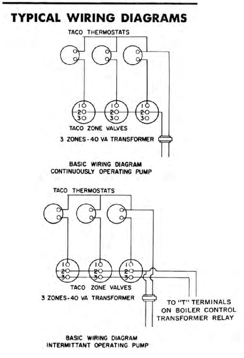

    if i have a chance i'll draw the schematic with the 2 current paths, that is why it can work with 2 xfmrs. you can think of the heater in the heat motor side as a resistor or coil or light bulb for electrical flow purposes, that diagram of what is going on inside just makes it more confusing. unless you're doing something like calculating average power used or trying to troubleshoot one that is sticking you don't need to know about that, just that you give it power on 1-2 and eventually 2 connects to 3 when the valve opens.
    The answer in on the 3d page of this Taco brochure.
    I used to struggle with this myself.
    it's just cleaner and simpler to have a 4 wire valve with 2 valve wires and 2 end switch wire
    The brochure explains
    it perfectly

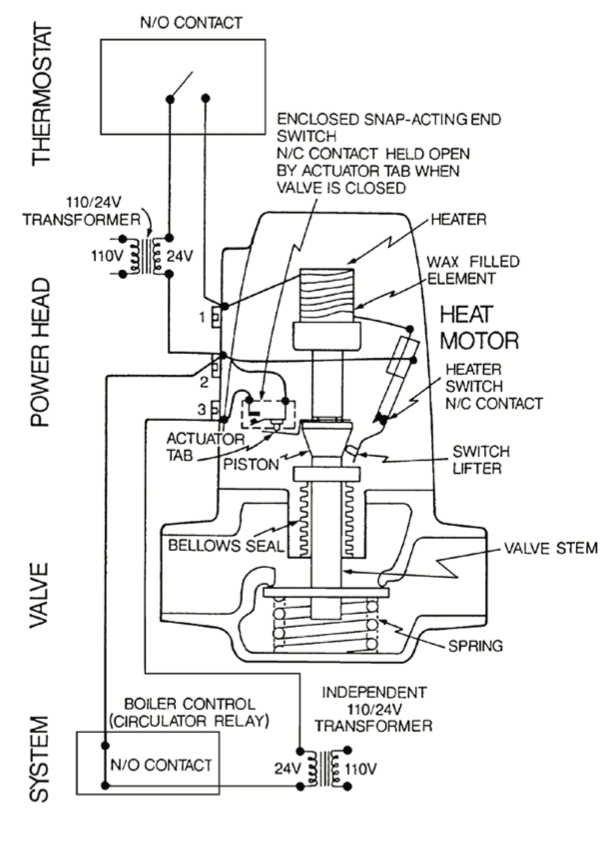

    It operates differently than other thermal actuators or zone valves. I believe the stroke switch opens to drop power to the wax motor or it would over-stroke. Possibly the wax or oil inside over-heats? It pulses power about every 17 seconds.
    When powered it pulls .9- 1.1a . Va= volts X amps .9a X 24V = 21.6. So 3 on a 24 transformer is a bit over.
    If you cut open the side of one you see where the terminals wire to, and it makes more sense.
    Also watch the stroke and end switch working. A clamp on amp meter shows how the power constantly cycles to the wax motor. Yellow wires to heat motor, black to end switch.
    The 250Ma thermal actuator, helmet heads, ZVs or manifold actuators have an inrush and settle down to a constant 125Ma draw.
    Spring return ZVs the syncrous motor stal;s when fully open and becomes a 5W heater. So a hot motor does not indicate a failed motor.

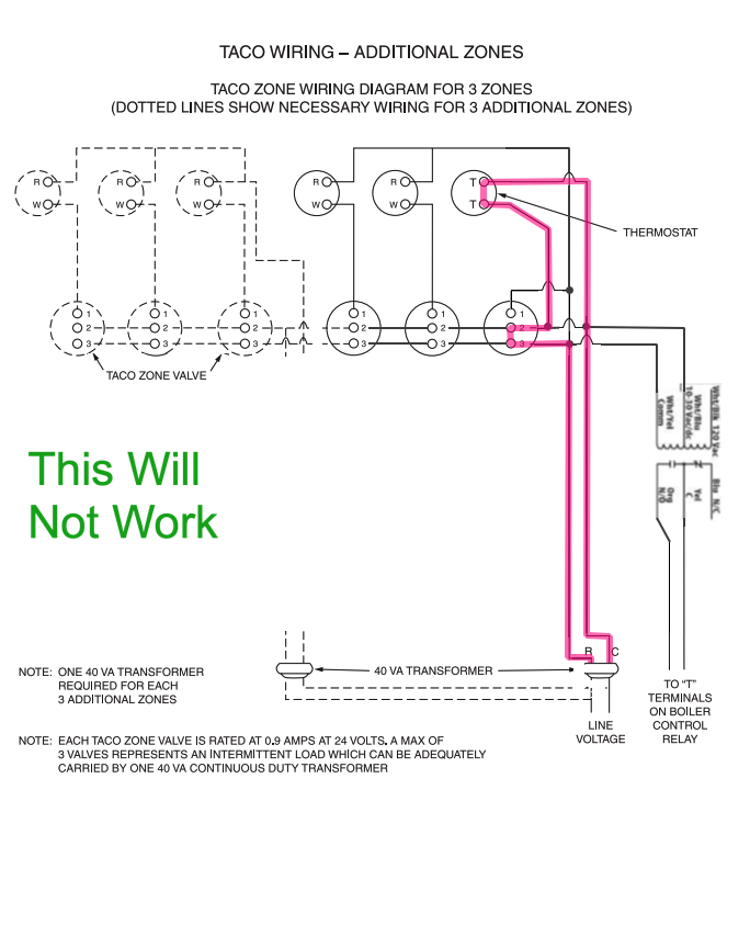

    @JohnNY said "But T-T on a boiler are not dry contacts. They are energized in the burner circuit. Of course, Steamhead's addition of a relay, RIBU1C/S I'd imagine, would provide dry contacts. So, I guess that's the best way to install the 570 series. Thanks for weighing in, Joe, and everyone else.
    @JohnNY I don't believe that T T on a boiler are dry contacts and @Joe Mattiello didn't say they were. He indicated that dry contacts connected to #2 and #3 on the 570 were "dry contacts" that are used to operate the T T on the boiler.
    @Steamhead said: "Well, @EdTheHeaterMan , that's basically the mirror image of what I posted. I've seen it done both ways in the field. You can fry your transformers either way. This is why I always use isolation relays."
    Actually you can't fry a transformer "either way" as long as you are consistent with the way YOU wire the zone valve. Where you end up frying a zone valve is when YOU are inconsistent in wiring zone valves on the same system. I have explained it in detail here:
    Somewhere in this comment it states that as long as you use the same wiring design throughout the system (either C to #2 or R to #2), you will be fine.
    The problem occurs when someone uses the opposite design from yours, and then you come along to "fix" the problem and wire the system your way, while all of the other zone valves are wired the my way. That is when you can fry the transformer.
    The reason is that your way is right in your mind, and you may fail to recognize that the other method (which is also right in my mind) was used throughout the rest of the system.
    If one valve has R from the transformer connected to terminal #2 and another valve has C from the transformer connected to terminal #2, eventually all of the #2 terminals will be tied together as part of the end-switch circuit used to operate the T-T terminals on the boiler.
    When power is applied to the transformer, the R and C circuits become connected together through the #2 terminal wiring, creating a direct short circuit across the transformer. The result is a burned-out transformer.
    The key is consistency, and in my little brain R-to-R, W-to-#1 and #2-to-C makes the most sense when you look at the big picture.
    @Steamhead , please don't take offense to my use of "your way" and "my way" as implying that one method is better or worse than the other. I was simply using those terms as an easy way to distinguish between the people who wire the valves one way and those who wire them the other way.
    My point is that either method can work perfectly well, provided the same method is used consistently throughout the entire system. I chose the terms "your way" and "my way" only to make the explanation easier for others who may read this discussion in the future.
    Here is the diagram that fails from my January 15, 2024 post that shows the flaw when you are not consistent. across the top are three different ways to wire a 570 that will work just fine when done consistently on a system:
    See how three correct methods when used on the same system will fry the transformer? R to # 2 and C to #2 on the same system will eventually cause R and C to be connected without a load between them so the smoke is let out.

    This part of the Taco document below explains it. If this this does not makes sense to you, you need to better understand how transformers provide Galvanic Isolation.
    The " 1 and 2, the reading across them tests at 7.8 volts " is may either be a circuit defect (if it is not working correctly) or the result of a power robbing thermostat that probably does not have a C wire installed. The 7.8 Volts may also may be result of slight leakage current due to the Capacitive Reactance of the wiring and transformers involved, commonly called a Ghost Voltage.
    The heater (wax motor) does not need power 100% of the time the keep the zone valve open the switch provides the appropriate duty cycle to the wax motor so the valve remains open and the wax motor does not overheat causing damage.
    Just to be clear there is two switches one between terminals 2 and 3 the End Switch and a second switch that controls the heating duty cycle of the wax motor with slight valve pintle movement.

    The duty cycle switch is opposite the micro/end switch. It is more like a reed switch or contact points. It rides against the cone shaped end of the wax motor "piston"
    The micro/end a switch rides against a tab to activate.
    I agree the few You Tube videos I watched are not exactly correct in their explanation. Several seem to think a single switch is inside?
    This is why, for me , dissecting a mechanism better helps see what is going on.

    Screenshot 2026-06-06 at 9.24.15 PM.png Screenshot 2026-06-06 at 9.24.44 PM.png
    How many of these zone valve can you run on a relay panel before its transformer is overloaded?
    Steamhead Posts: 19,007
    The TACO 6-zone panel (ZVC-406-5) has an 80VA transformer, so it has enough juice for 6 zone valves.
    edited June 7
    That's because terminal 2 is typically connected to R on the transformer. With the thermostat contacts open, the lead between terminal 1 and the thermostat will show 24v to ground (or to C on the transformer) since there is no path to C through the thermostat. But when the thermostat closes, the lead between 1 and the thermostat will show zero, because the load (the heat motor) now absorbs the voltage out from 1.
