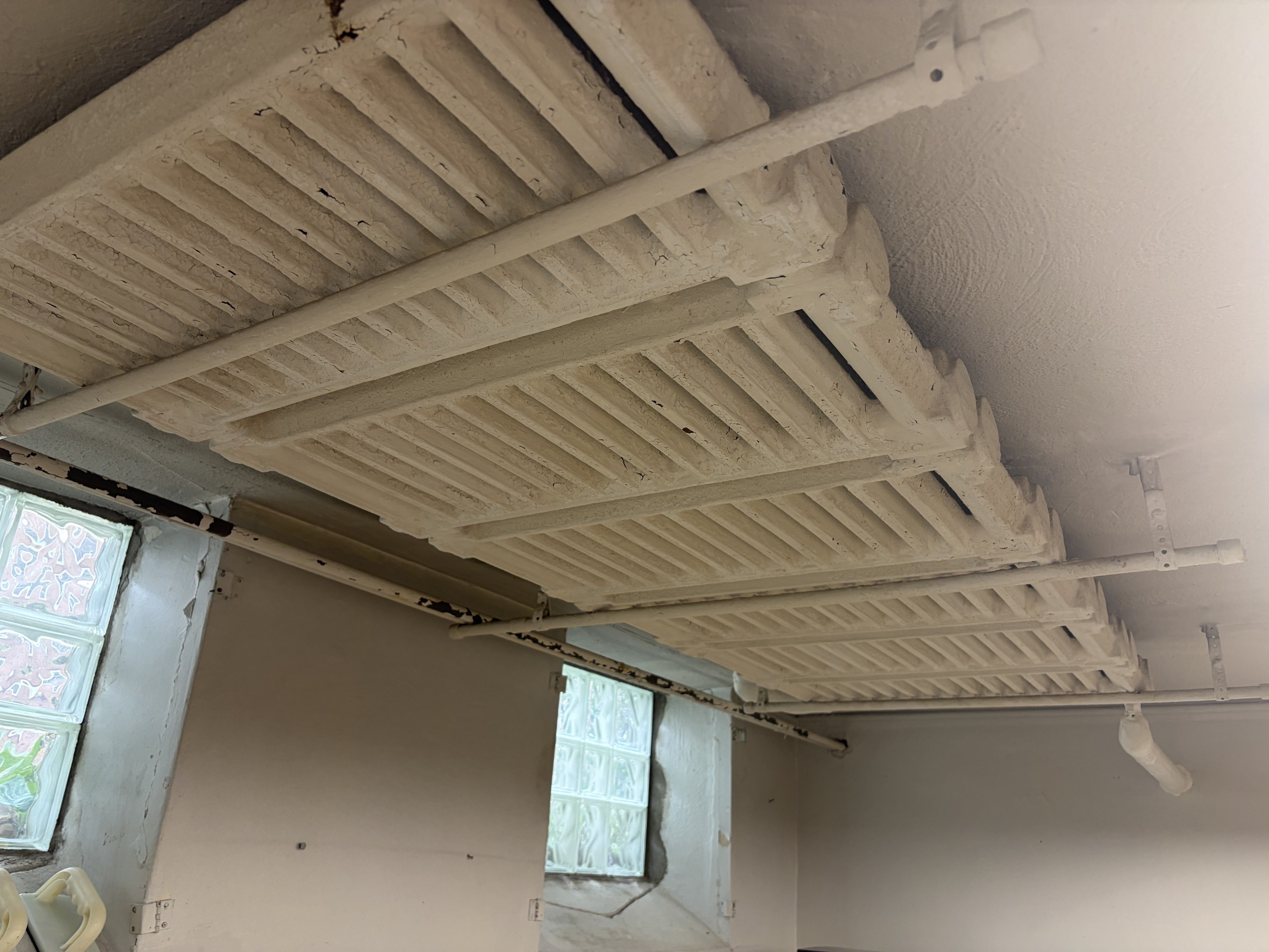

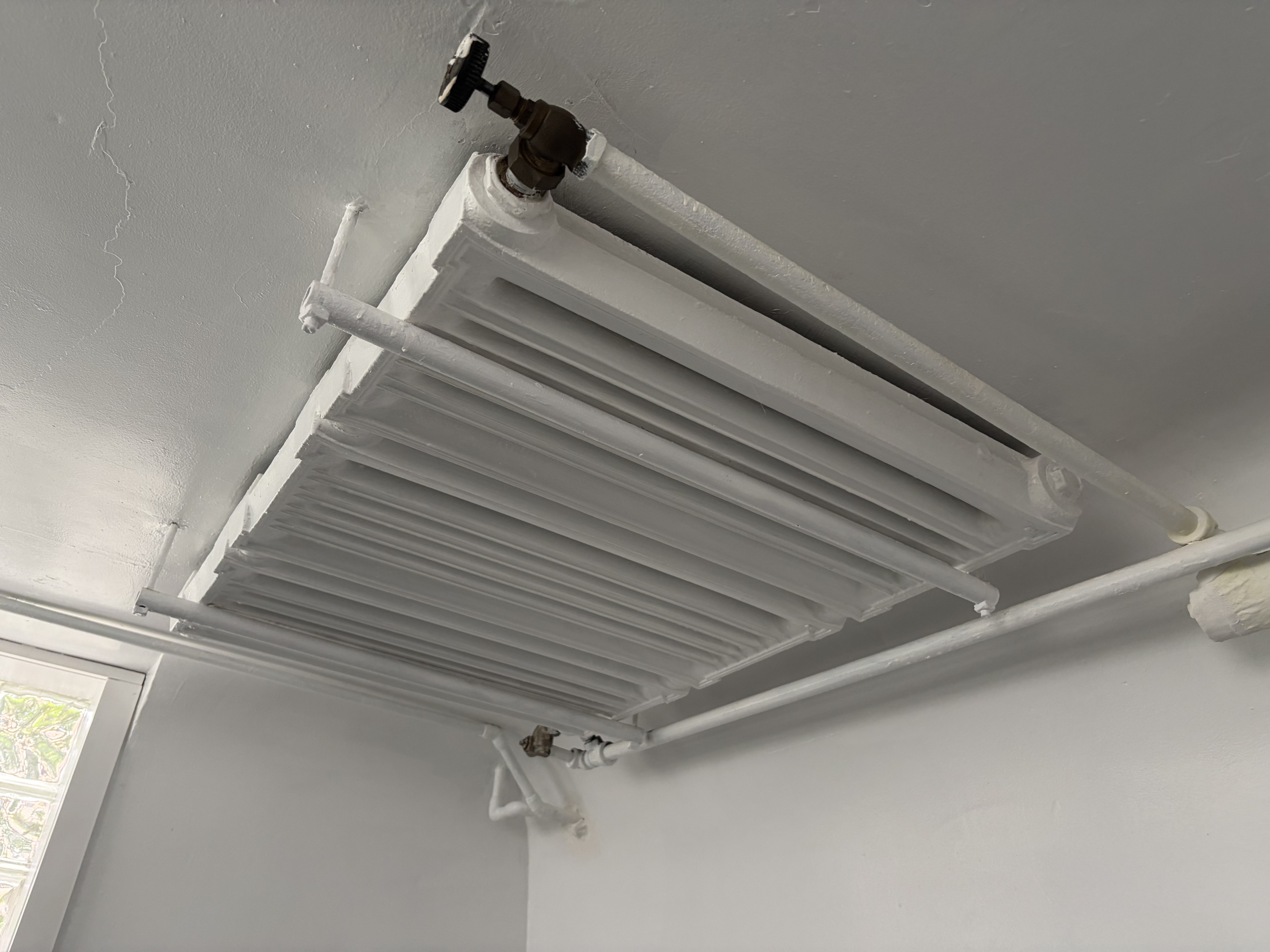

    I had a houseful of these to deal with a couple years ago. But different. And when I cleaned them out (using dental instruments) the house had balanced heating for the first time in 30 years. Or so said the customer.

    mattmia2 Member Posts: 17,354
    edited June 10
    I just noticed the one on the ceiling is missing the vapor valve, you need to do something about that like put an orifice plate in the valve union or replace it with a vapor valve.
    This is the new orifice valve that is still made. You can find some, especially Hoffman vapor valves on ebay
