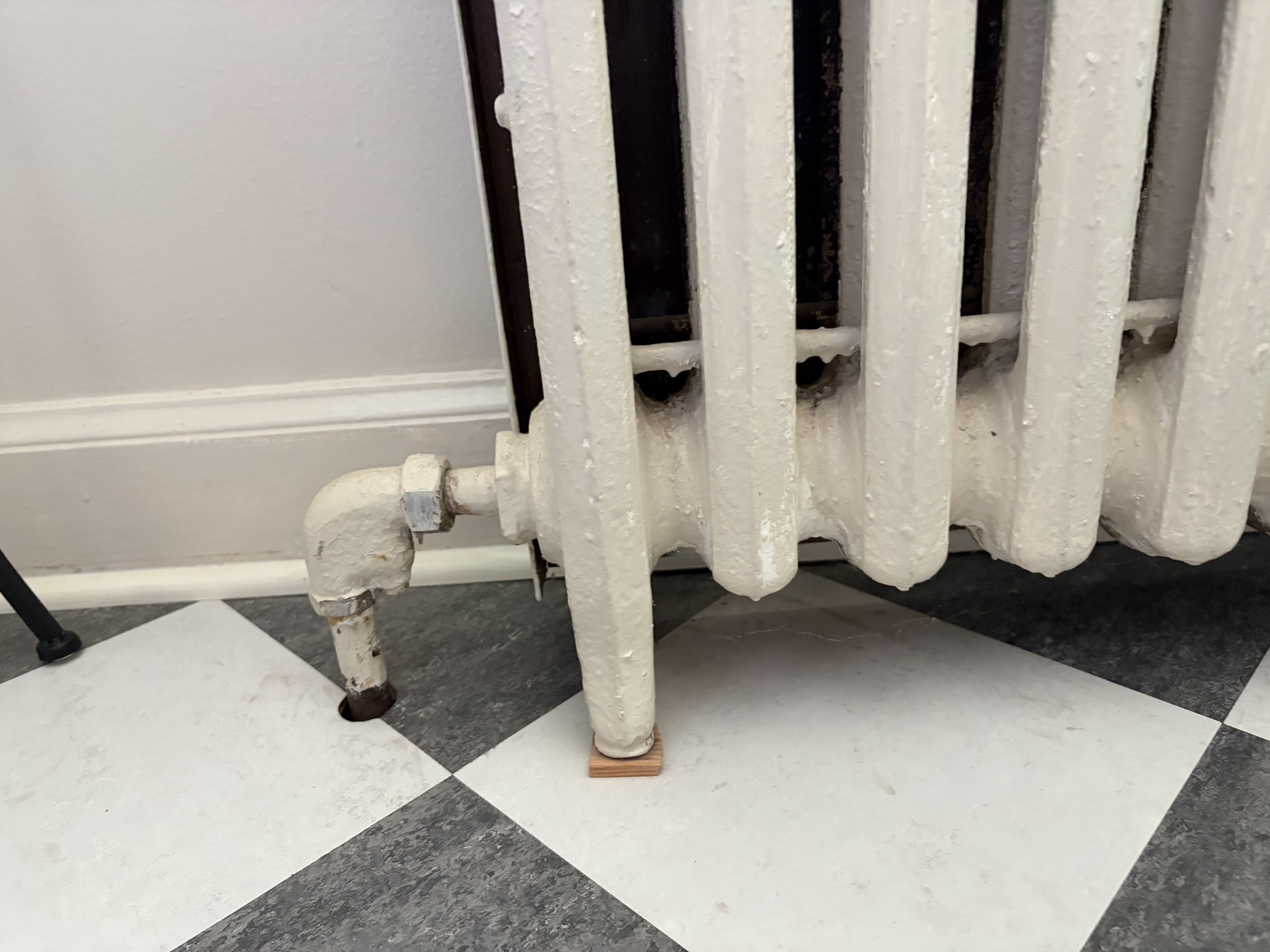

Is this a steam trap?
I have a house built in 1930 with two-pipe steam. A contractor said he didn't think this radiator (and a couple of other similar ones) had a steam trap. But I'm wondering if this elbow-shaped piece is actually a steam trap. Thanks in advance!

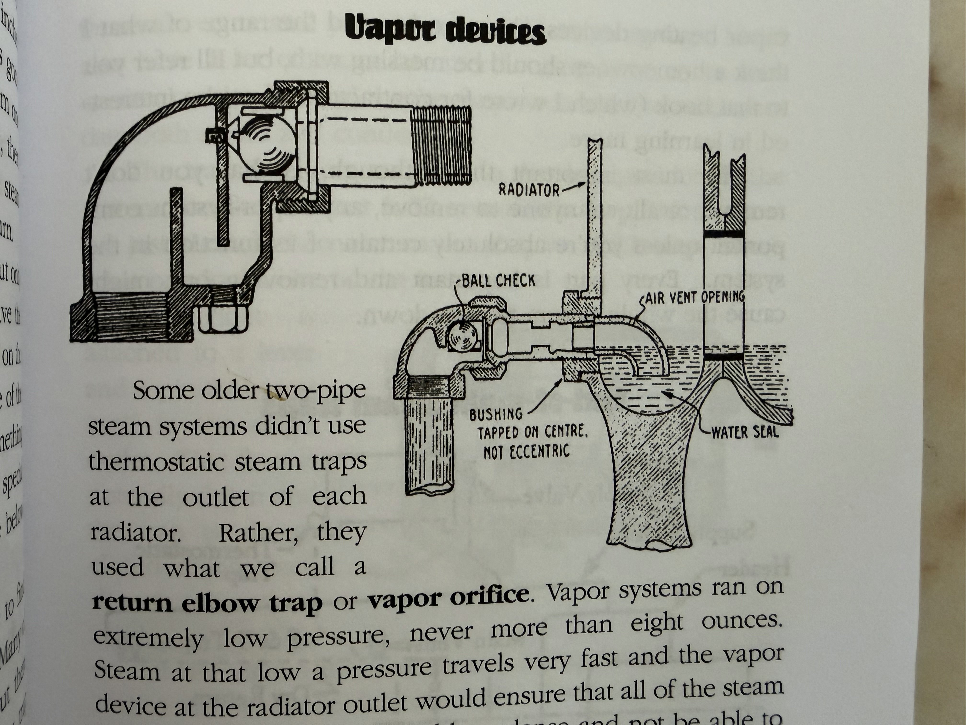

    it is a vapor system, it doesn't have traps. that is i think a water seal, maybe it is a broomell system.
    don't let them touch it unless they understand what a vapor system is.
    the boiler through correct sizing and a vaprostat keeps the pressure low, under about 8 oz/in^2 and that vapor valve on the radiator meters the amount of steam that is let in to the radiator to less than what the radiator can condense so it is all condensed to water before it gets to the outlet of the radiator.
    keeping the pressure very low, a few piping things and possibly some specialties at the boiler are critical to making that system function properly.

    It's an O-E Vapor system. That return fitting is a water seal with a small hole in it to let air escape from the radiator. You can find it chapter 15 of @DanHolohan 's excellent book "The Lost Art of Steam Heating"- the latest version is here:
    https://www.heatinghelp.com/store/detail/the-lost-art-of-steam-heating-revisited

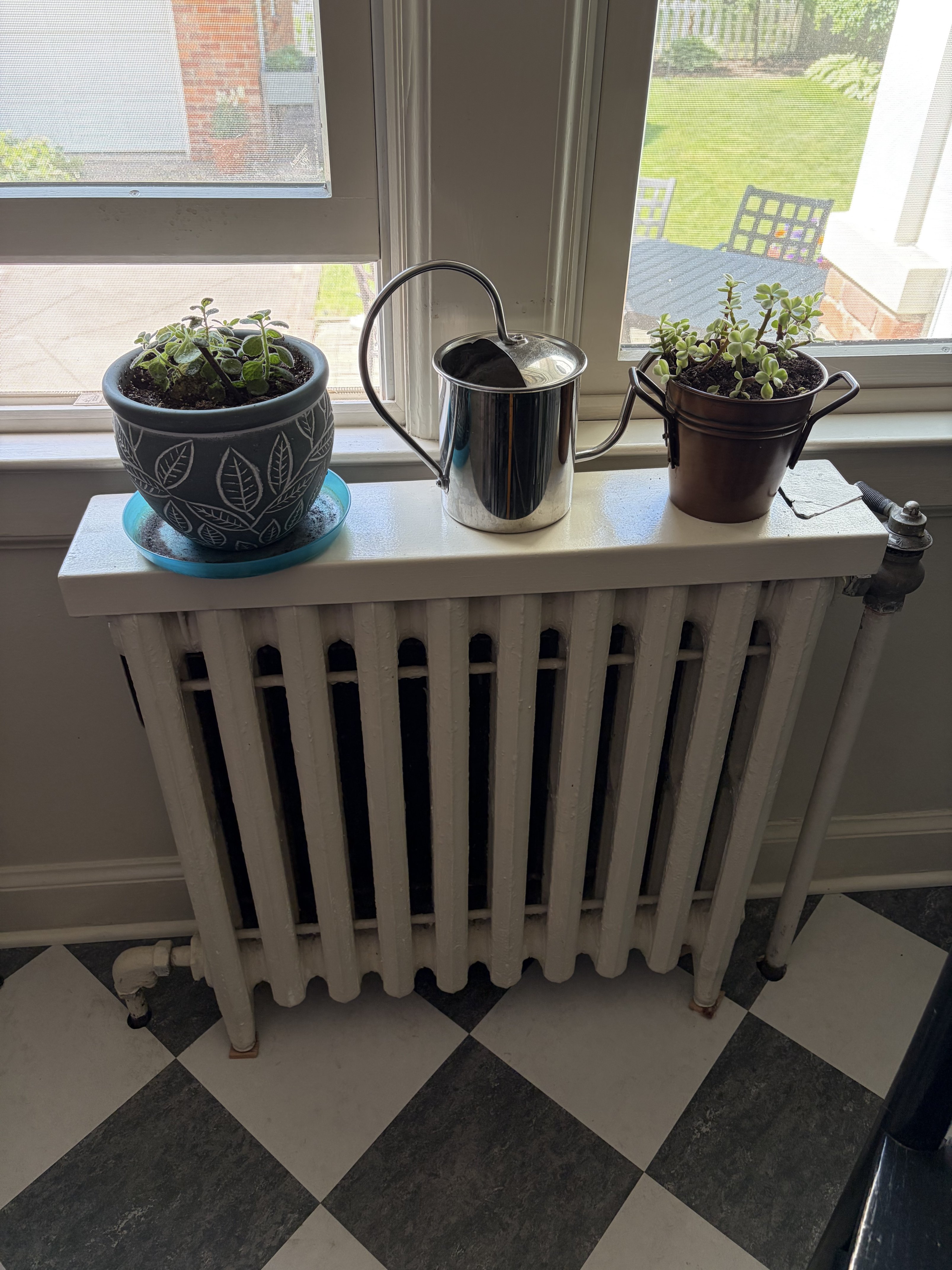

    First, here's another radiator with a different-looking trap. FWIW, this one has never gotten hot since we've been here. Followed by photos of the boiler.

    does the radiator that won't heat that has the trap still have the vapor valve?
    with the insanely high pressure it is very likely you have steam in the returns and that steam is closing the trap from the return side before the radiator can vent and heat. also possible the steam in the return itself is keeping the radiator form being able to vent.
    feel the returns, they should not be steam hot. they may be hot but they shouldn't be as hot as the returns.
